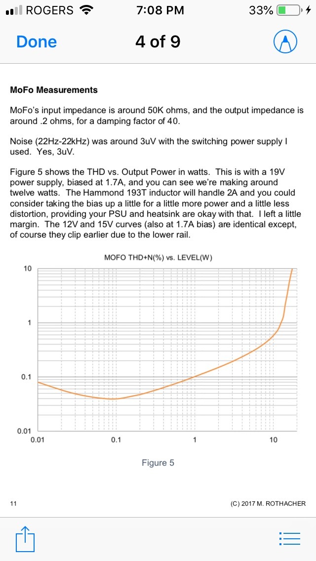

Hi
I’m about to order everything from Digikey but then was thinking about the power supply. I’d like to build 2 mono bloc and each of them would be powered via a 19Vdc laptop supply. I did this for my regular MoFo and had great results.
Can someone confirm if this amp would work properly at 19V (bias at 1.6A?) instead of about 24-28Vdc. Also, would the expected output power be similar to the MoFo (10W is plenty for me, picture attached) and last, would I need to change any components values if I use my 19Vdc supply.
Thanks a lot for your time.

It will work just fine, Eric! Eventually, you might thirst for more power and then you can increase bias and supply.
Great news Rahul.
So, I don’t have to change anything? Should I set my bias greater than the sweet spot you had found at 1.4A ?
Thanks for your help 😀

My supply was slightly higher than 19V but there is so much device to device variation that it is not worth worrying about it. The triode character will come through in spades. Even after all this time, if I want to really listen, I come back to the TDV.
