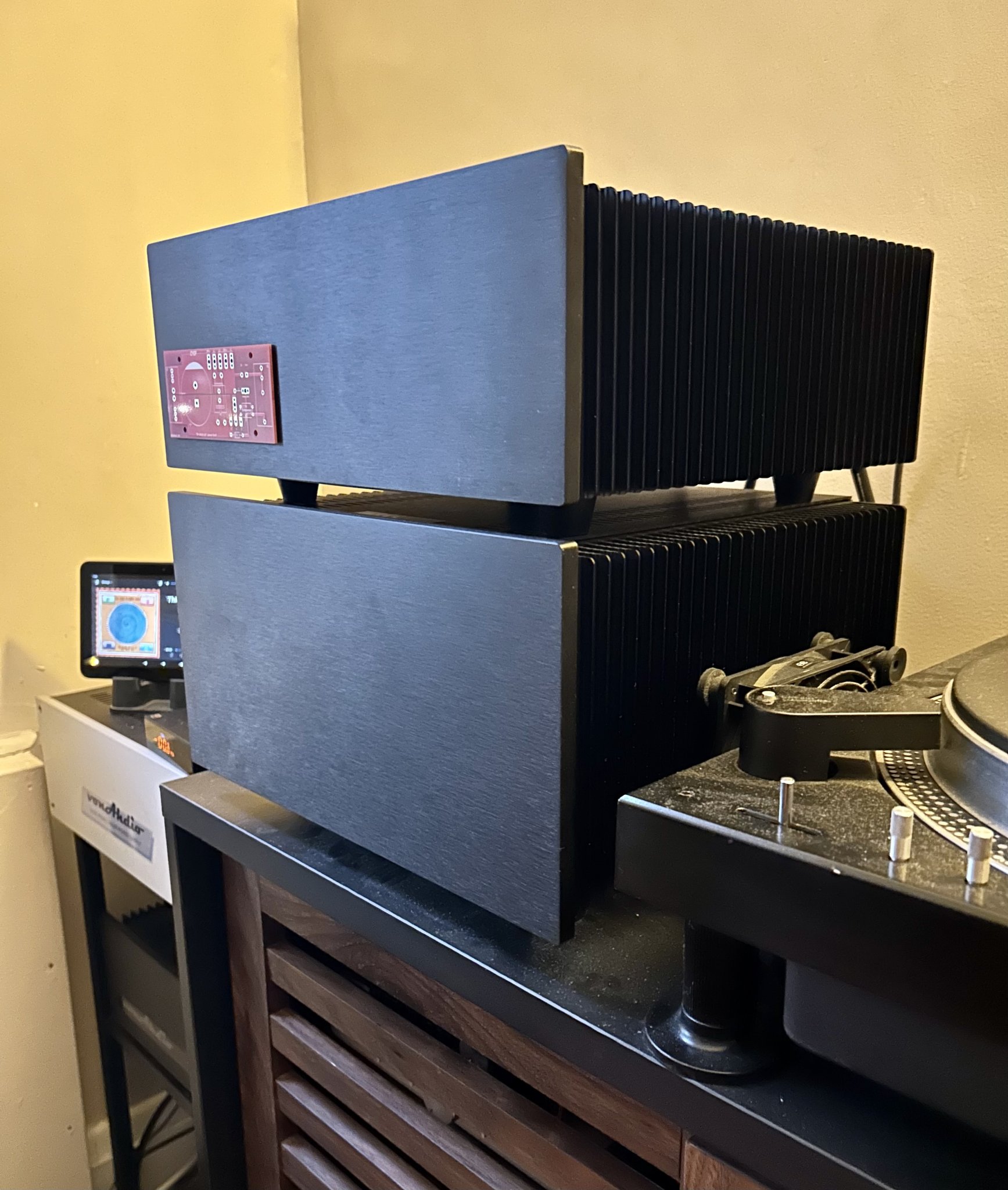

TDV vs. Scryer, you ask?
I have both running daily, lately — Scryer in the main system and TDV in a secondary system. These are each with 2087Cs.
Just plopped the TDV on top of my Scryer in the main system to compare. No preamp. My DAC has to run full-out to get to the level at which I was just using the Scryer.
I agree with Cody’s assessment. The differences are subtle. I’d say the Scryer has more precise edges around the instruments as I listen, which I enjoy very much. The TDV has an undeniable smoothness to the whole spectrum, in a good way — an effortless reproduction of the signal. For sound quality, flip a coin to choose between them. Toe-tapping fuel in spades for both. In this particular setup, I would choose the Scryer, just barely, based on my own preferences.

Perfect summary! On another note, I love your TDV faceplate 😀… the Scryer has more precise edges around the instruments as I listen, which I enjoy very much... The TDV has an undeniable smoothness to the whole spectrum, in a good way — an effortless reproduction of the signal.
Thank you. I love the TDV identifier, too. I‘ve been meaning to order some ‘vonAhdio’ decals for the Scryer and TDV, but that spare red PCB is cool.
