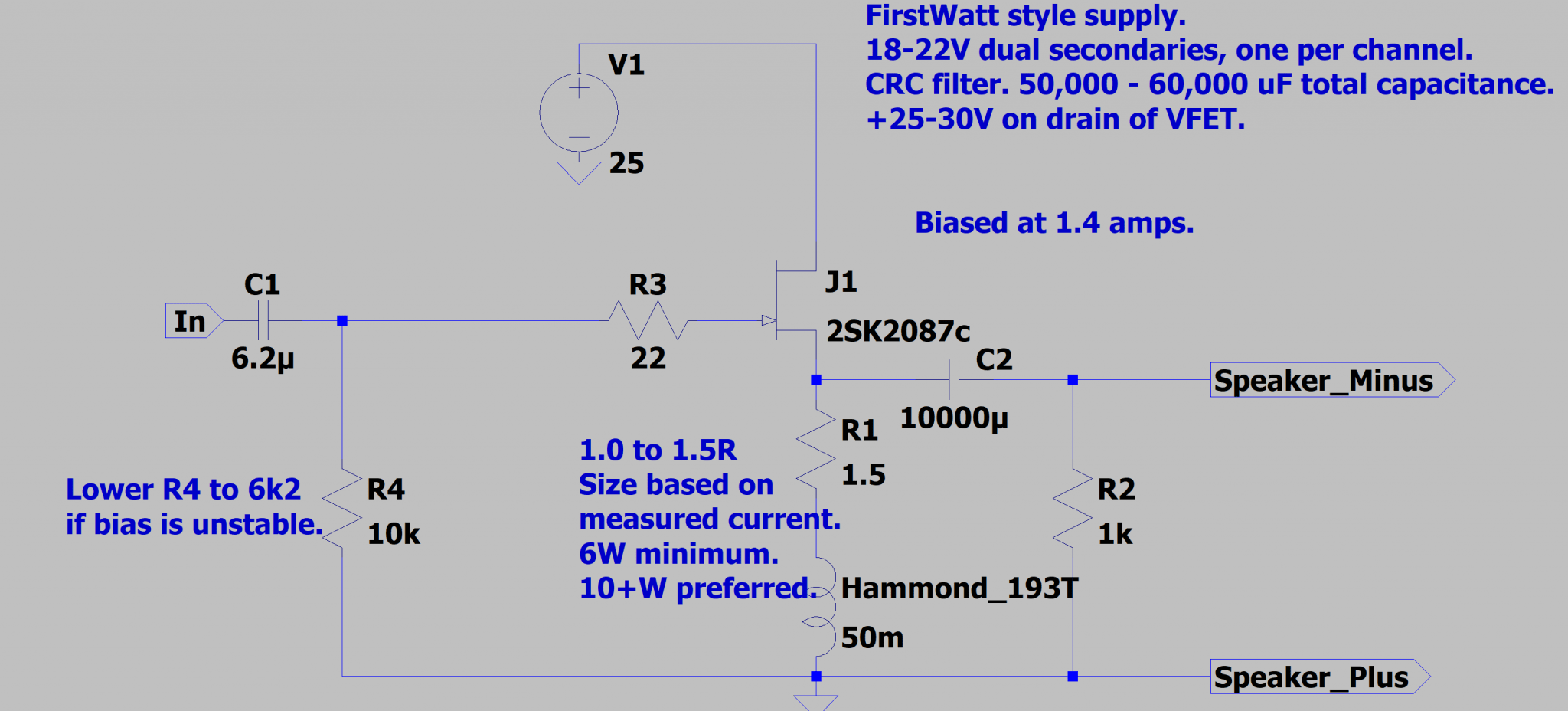

I have been increasing the current on one of the amplifiers.
I am up to 2.9 A with no signs of protest from the amplifier.
There is slightly more heat.
I am using an inverter for my AC and it tells you the power consumed. What is interesting is I would have expected more power to be consumed. My other amplifiers are around 2.55 A. The display shows no increase.
I do not doubt this is not the most accurate gauge but wouldn't one expect to see some change?
One thing I have noticed and this might be the key - when I turn on the amplifier the current is high and continues to settle down over fifteen minutes. I quit monitoring after that so for all I know it may continue downward further still.
If that is the case does this indicate something I have done wrong or some kind of weakness in my implementation? Is it typical for the current to settle downwards over time?
I am using a 400VA transformer - two 15 volts secondaries in series - 40mF, a .1H choke then another 40mF - I would think the power supply should be up to this.
All advice and counsel would be appreciated.

Could be the temperature coefficient of the device at play. Also, what choke are you using for the load? You might double-check that its equipped to handle the extra current without saturation.
I am using the Lundahl LL2733 - recommended current 3.4 A. Saturation 5.4 A. It does not get much beyond lukewarm. i think the choke is happy.
Using the same choke in the power supply.

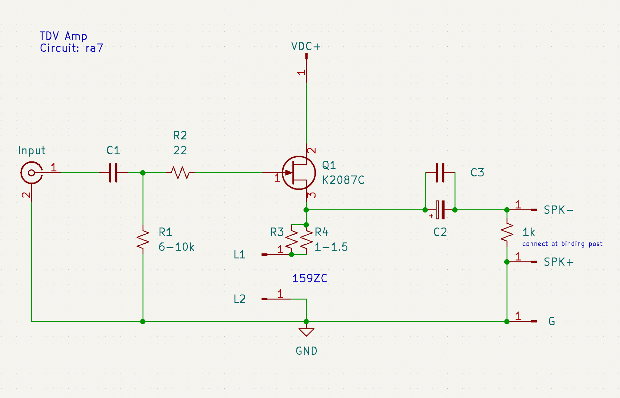

How about this as an explanation:
I am using two different resistors - OHMITE Brown Devils and OHMITE WH in parallel to get to the value I need.
The WNs were recommended by Mr. Yazaki of the SPEC CORP as a good sounding resistor. The BROWN DEVILs were seen in many old tube amplifiers.
I am guessing the two resistors with their different temperature coefficients could be the problem.

You could also try lowering the value of R1 (R4 in ra7’s original schematic) if the bias is unstable. I went the opposite direction once to see how high I could take it. Wasn’t long before the bias would simply not settle and wanted to run off. That value is going to be different for every SIT, so perhaps the SIT in this specific channel has more gate leakage and requires a slightly lower value? Worth trying if the bias resistor test doesn’t help.

Is your supply up to it? If the transformer sags under load, your power input, which you are measuring, might stay the same. This can happen because we are talking about big current.
Sorry Rick, I think I misunderstood. I was thinking that the channel was seeing a steady increase in bias current.
What happens to the voltage at the supply output when you increase the current?

I think the temperature coefficient of the resistors, as you have guessed, whether it is negative or positive would be the main cause of the current differences.
Paralleled resistors, if they have significant inductance will behave differently if in close proximity of each other as the magnetic fields will interact and that would affect the total AC impedance. I would think that a single resistor close to a ferrous object would also measure differently than if it is in a different location.

In terms of the Dayton DATS measurements of an inductor, it is possible that the capacitance associated with the inductor reduces the level of the AC signal across the inductor and it interprets this as due to the resistance of the inductor. So the result is a lower inductance measurement and a higher resistance value.
A transistor with self bias is kind of a balancing trick since lower source resistance increases current initially, but then Vgs starts increasing (I * R) and also, Vds changes due to current x power supply impedance and the and the source voltage and everything goes round and round until equilibrium is reached. This is definitely not a linear system; simulation with LTspice would be informative.
