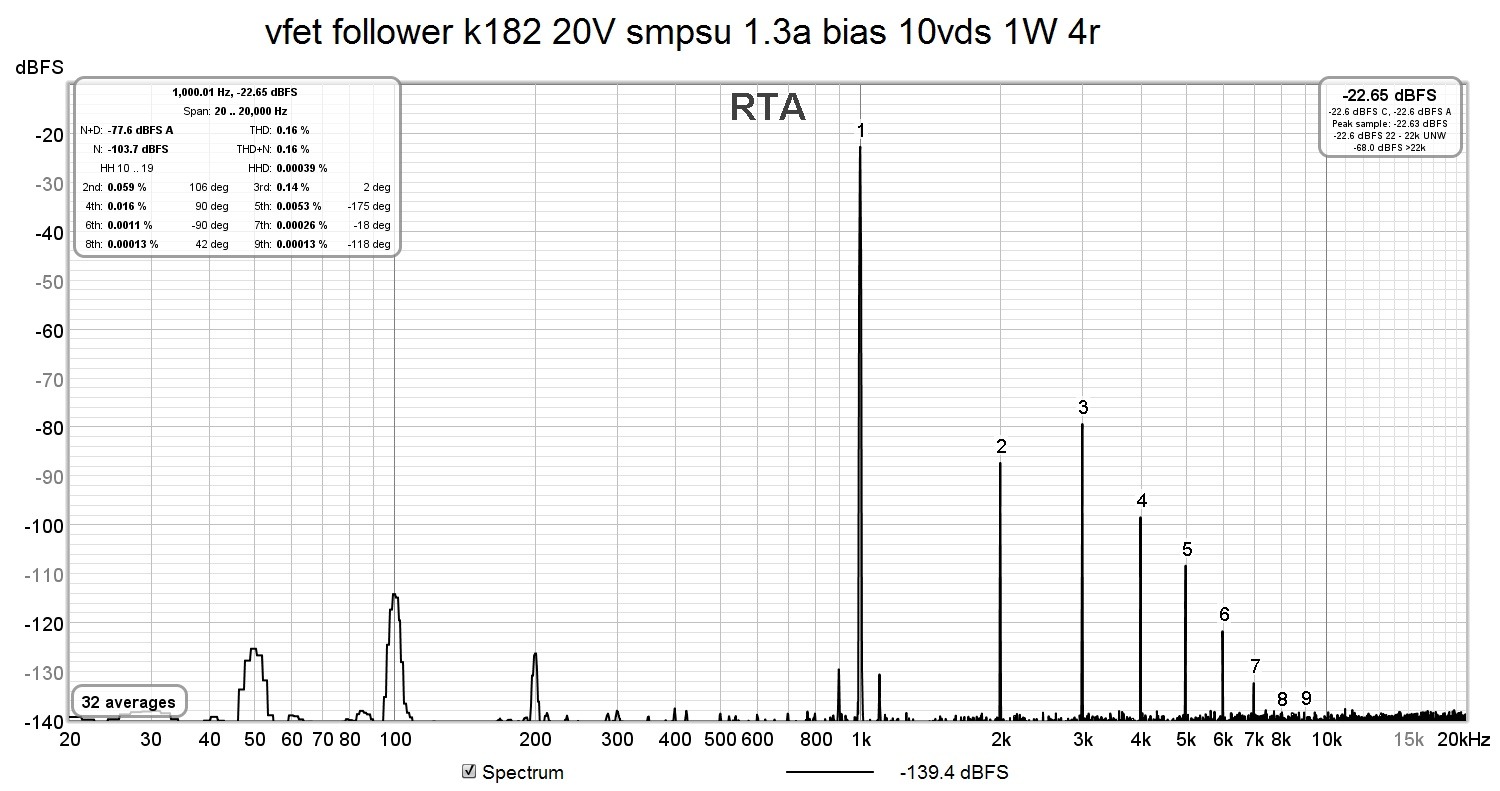

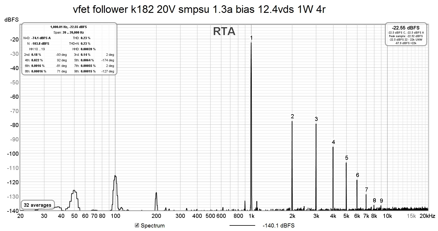

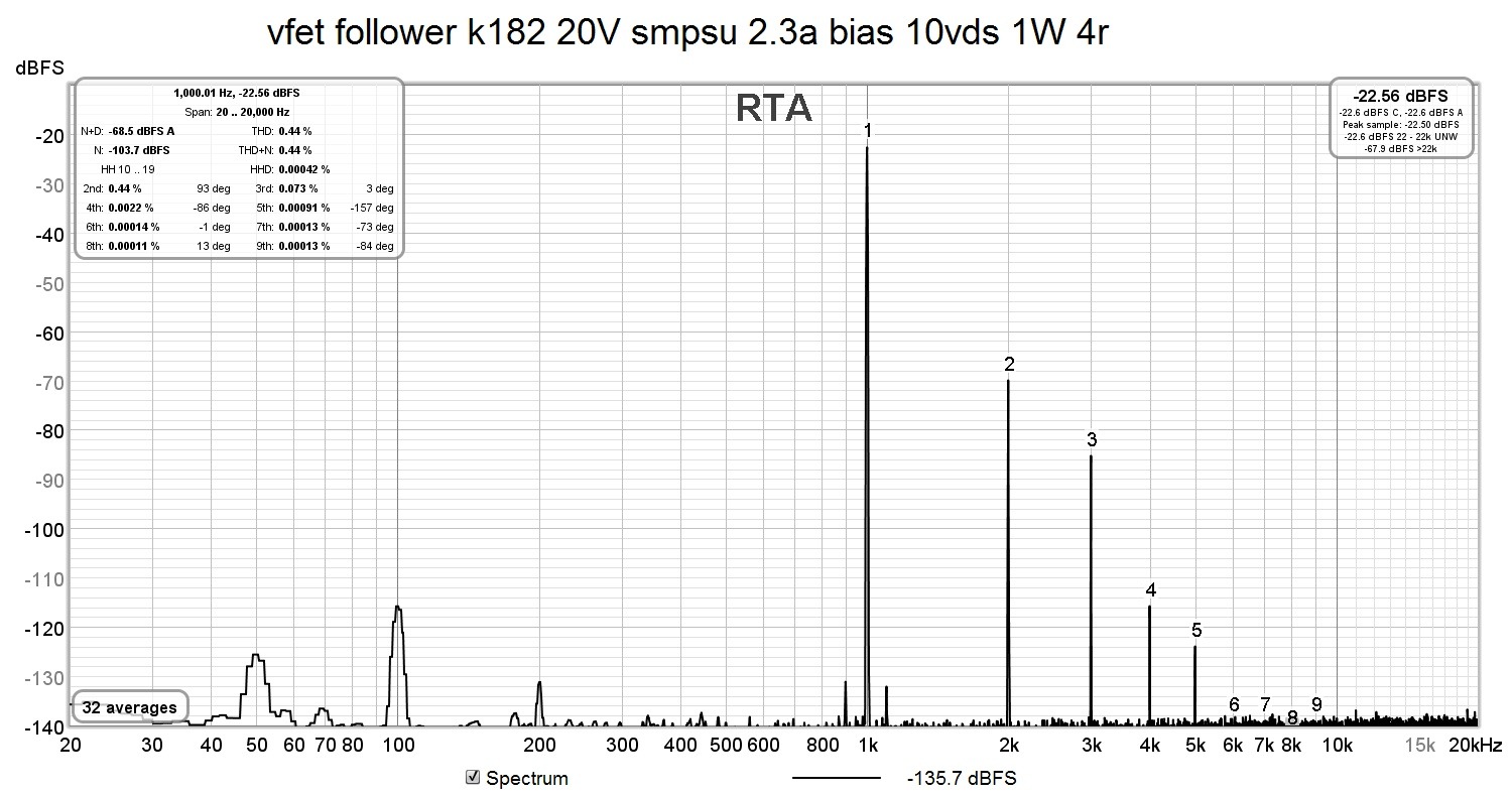

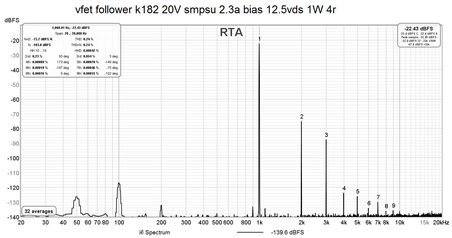

Playing with sits I noticed quite the contrary, you increase the 2nd hd by increasing the bias. If you want to lower it increase the vds of your sitI tend to think the amp with 2.6 A would have less second order distortion.

Schultzsch, I thought that Mr. Pass said that less 2nd harmonic was what happened when you increase the bias on the SIT 1 amplifiers. Of course, it would not be unusual for me to get it backwards! Thanks for the correction.

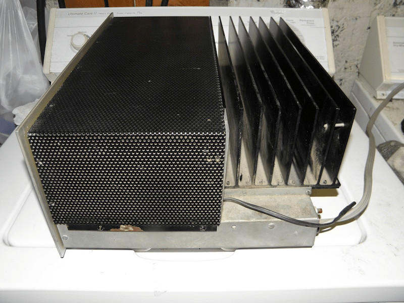

I have plenty of heatsink - the old DYNACO Stereo 400 heatsink placed upside down so the fan blows through a tunnel of fins.
The 3.2 A side got warmer than it ever has but nowhere near as warm as the SIT 1s did. Of course, there is no easy way to put a fan on those - whether it was important to keep the resistor heatsink cool is something I do not know.
These are not my amplifiers nor my washer and dryer!
Only the heatsink is used and it is upside down with a fan on one end. What little circuit there is is nestled within the rails for mounting the transistors.

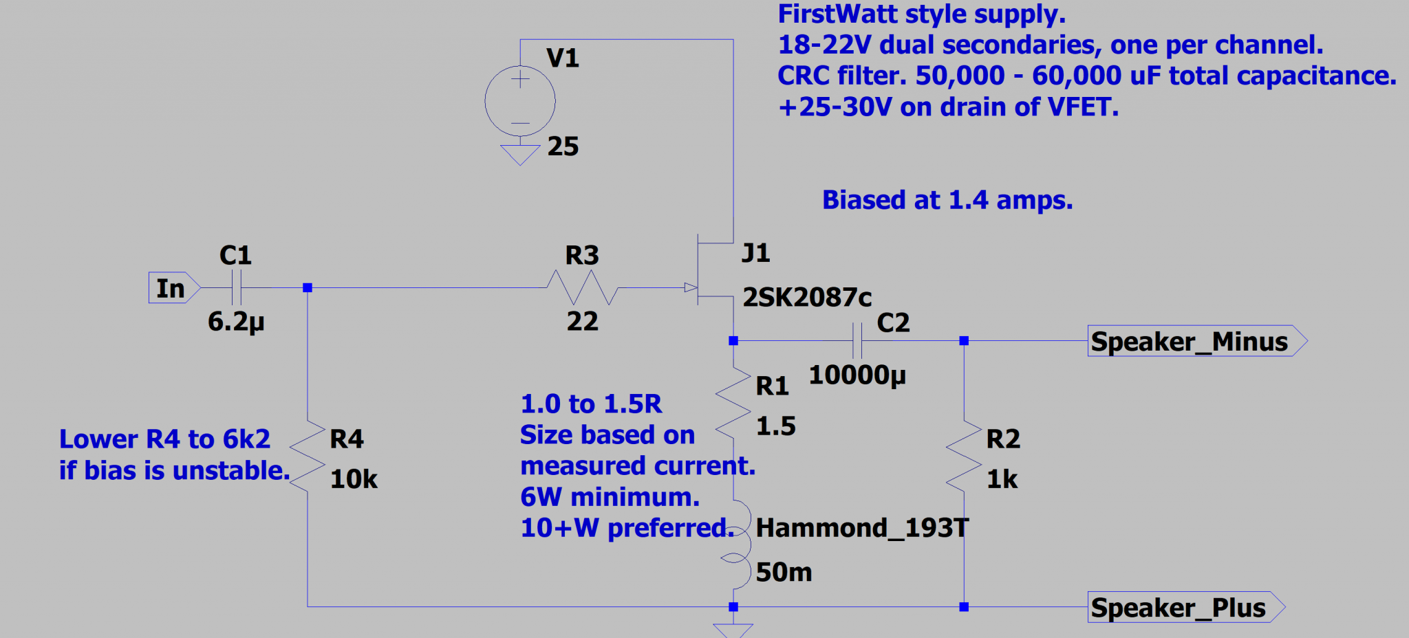

Rick, I don't understand where you moved the resistor then. Is this the schematic of your amp (I know you are using a higher voltage power supply and your source bias resistor may be different)?
Which resistor did you move and where?
If you prefer to not have resistor R1 and find that the current is too high, you can add a negative bias voltage to the SIT gate. You would need an adjustable negative voltage power supply, connect the ground to ground, remove R4's ground connection from ground and connect it to the negative voltage. In tube circuit terms this would be fixed bias. My SIT amps have a bias supply at the SIT gate rather than a source bias resistor.

Your earlier approach of using a CCS to measure should work. A DN2540 et al. based CCS can be set using 47R, say, and then you can insert an additional resistor of small but unknown value and you can measure the voltage across the unknown resistor and find out its value by knowing the current set by the CCS.
Also, I tend not to focus too much on the actual value of the resistor. It is somewhere in the 0.5-2 ohm range because I need a Vgs of -1.0–3.0V and given a current of 2-3A that’s where it needs to be.

I cannot remember where the schematic is where you showed an alternate place to connect R4 to get more bias. I thought it was between the choke and resistor instead of ground or in my case B-.
My ears are telling me there is much to be gained by not using the resistor at all.

Back to R4 - can the value of R4 affect the bias current? Mine are around 7K. I am thinking the amp with the 3.2 A bias current which is much higher than the other three - I do not want to add a resistor between the choke and the THF51 - can this resistor be changed to a higher value for a little less bias current?
