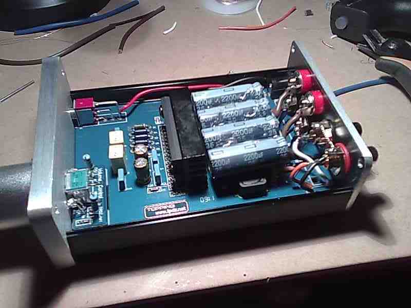

morfic said:
Try adding large caps to the12V input like described further up, i only could grab some 4700uF Nichicon caps locally, but they brought back the lack of low end (god knows the t-amps have detail up the whazoo)
I may pick up larger input caps if i ever go back inside the TP10 MkIII to do other stuff to replace the ones i have now.
Try that with larger caps as Arjen pointed out and it will make a huge difference on the cheap.

I was considering getting a socket and a plug of the right size and trying it externally, i ended up soldering inside, but maybe you could try it externally and once convinced go to do it inside? 🙂

Go for it Marcus, it's a really simple mod with a noticeable improvement to the sound, you will be glad that you did it! 😉

Yeah 6300uF or a bit more 25v or > electrolytic across the supply.

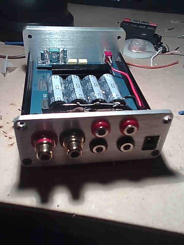

morfic said:
Just solder it to the 12V jack. on the center riveted piece and the left flat piece, loocking from front to back.
http://www.diyaudio.com/forums/attachment.php?s=&postid=1806854&stamp=1240193192
Arjen posted this picture of his mod on page 1 of this thread.
Okay i will go get some e-caps6300uf/ above25v
Couple of shots of mine

I meant to clarify my bass statement a little, it changes enough to make low cello notes sound "right" (to me), low cello notes is my measuring stick.
W/o the mod they sound thin.
