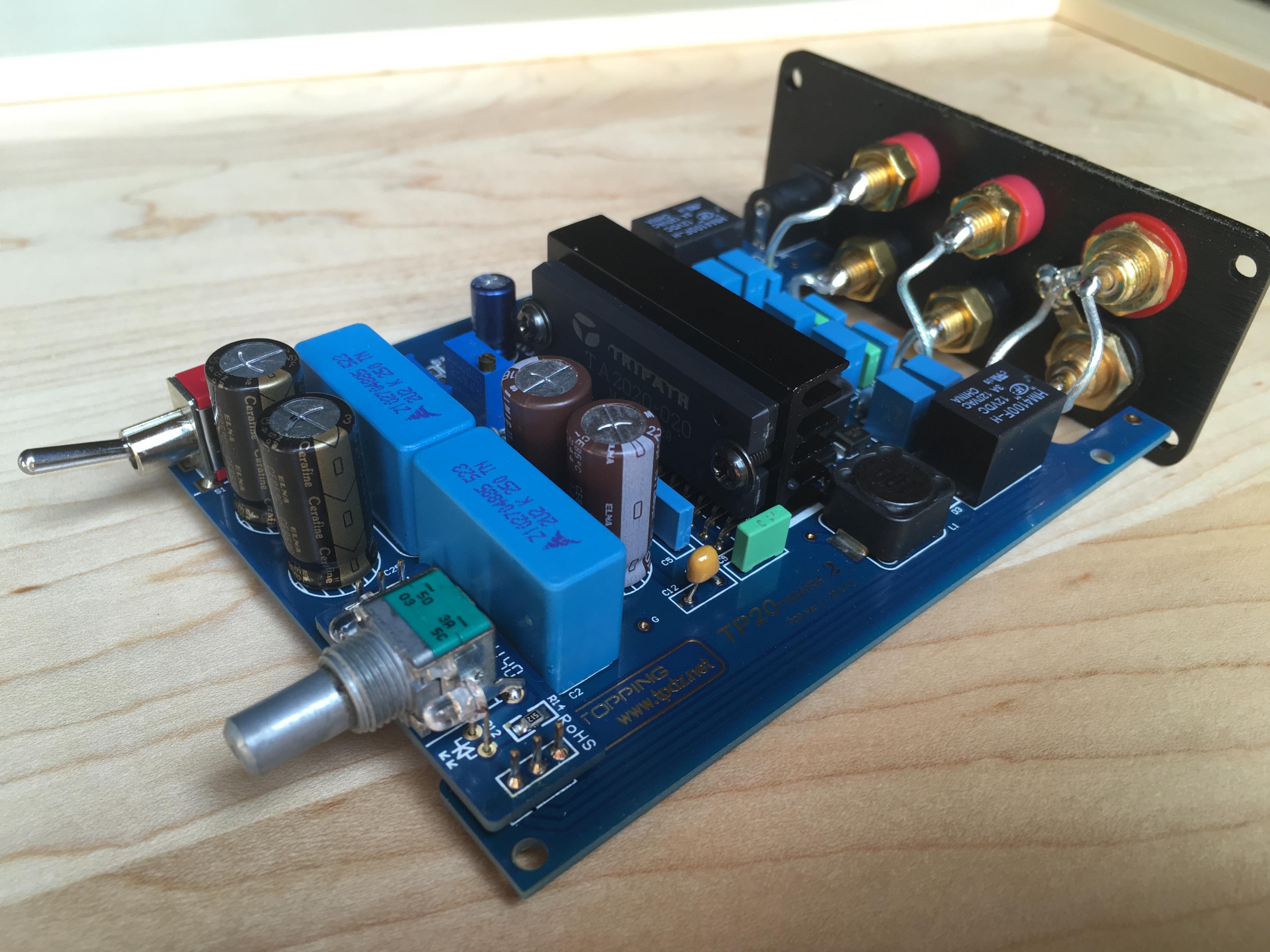

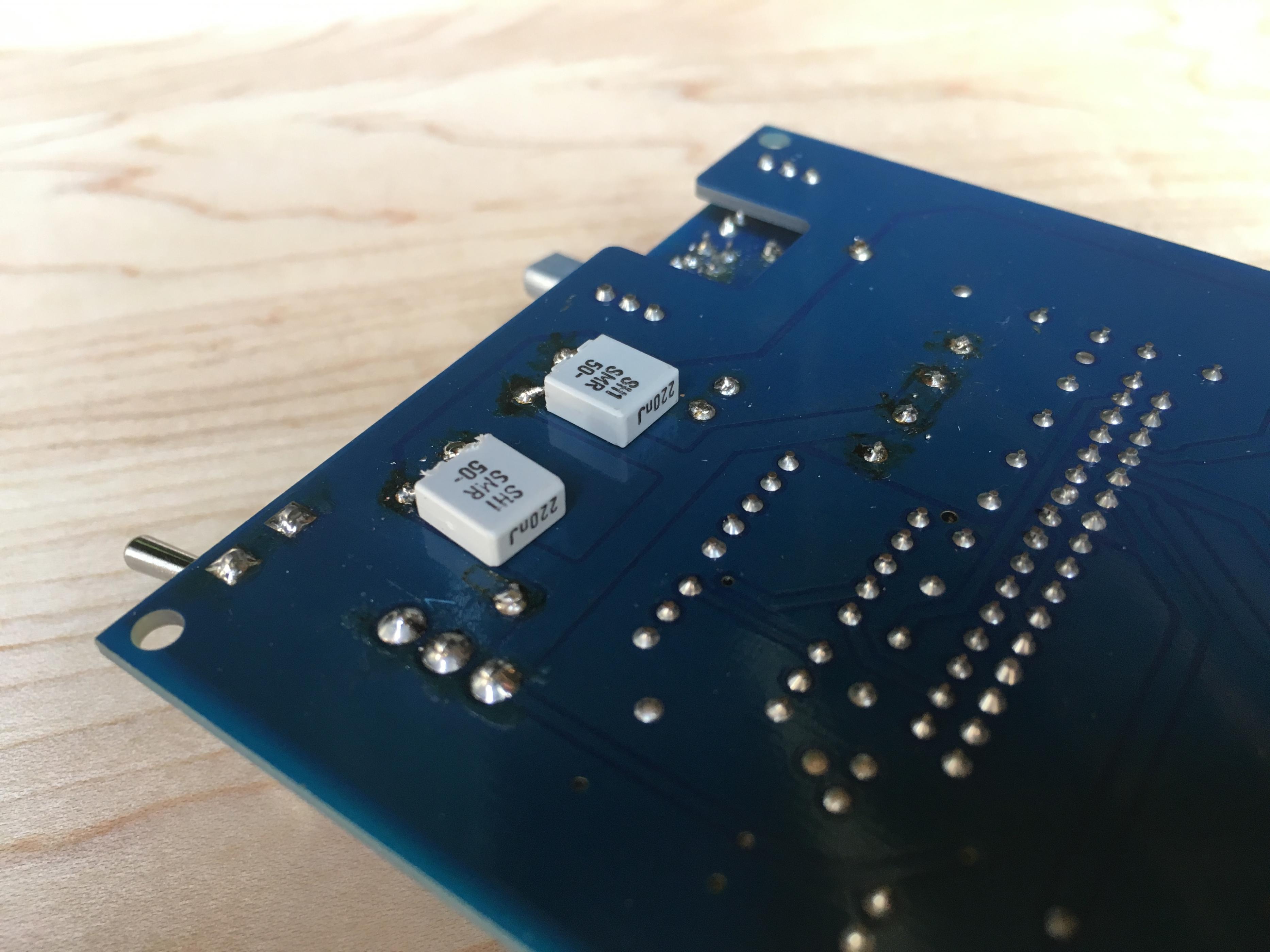

Thread resurrection!
My TP20 mk2 was starting to bore me with its cool, analytical sound. So I recapped it for fun, to see how far I could take it. I tried a range of Panasonic, Nichicon, and Elna electrolytics, and ended up combining Cerafine and Silmic II for a sound that is more detailed and--more importantly for me--a step closer to the full-bodiedness of a Class A/AB amp.
To my ears, Silmic has the treble shimmer and phat bass, and Cerafine has the forward midrange. On their own, I felt the colorations were wrong for this amp. BUT... Together, there is a balancing act with some serious mojo going on.
I ended up with 16v 220uF Silmic by the IC and 16V 330uF Cerafine for the main power smoothing caps (biggest that'll fit from this series, I think). I also added a very compact .22uF Kemet SMR (PPS) film bypass on each of the Cerafine power caps. I think this yields a smidgen more HF air and extra textural realism. Enjoying my amp again 🙂
