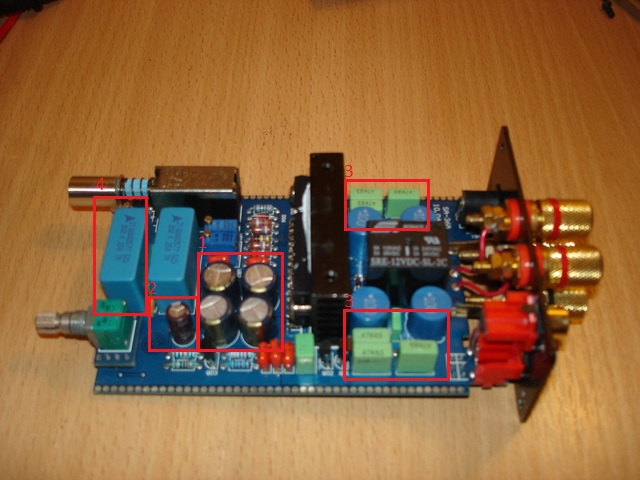

I recently bought a ta2020 amplifier and i thought modding it would be a nice first touch with audio.
After reading this article, i concluded that
1. adding caps to the 12V line
2. replacing possibly fake components with genuine
3. replacing components with better quality equivalents
4. adding a bigger than 220μF buffer cap
would do a noticeable change ( for the better ) to the sound.
So, i opened the case to see what is what and who is who. And i got confused. Big time.
No matter how much i look at it and try to follow the lines, i cant get it right.
Firstly, i saw those six green capacitors numbered 3 in the attached picture, right next to the b plugs. They bring ERO markings and are numbered MKT 1818 .47k63 ( fake? they don't seem to exist ). By the .47k63 i assume that they are 0.47 μF @ 63 Volts. Given the value (0.47), according to the ta2020 datasheet, four of them should be the output capacitors. Right? So what are the remaining two? The datasheet doesn't give any other caps at this value.
Then there are four caps, numbered 1, which are 470 μF at 16 volts and connected in parallel. Are these the 12V caps?
Right next to these four caps, there is another one, numbered 2, which is 220 μF at 16volts. Is that the buffer cap? And if that is indeed the buffer cap where are the input caps?
What are these two blue components (?) numbered 4?
I also saw that the ta2020 datasheet states that for 8 ohm speakers ( like the ones i have ), the output caps should be 0.22 μF. Once output caps recognized, should i change them or is it no good?

Hi CaliCanjaros,
I'm not familiar with the board shown, but from the photo, the two marked 4 look like the input caps, probably ~ 2.2uf film caps, item 3 are part of the output filters, the others: if you say items marked 1 are in parallel they look like the 12v tank caps, you can trace the tracks to the switch / 12v power and IC pins 22, 25 and 27 to confirm. Item 2 – not sure.

Hi Steve. Thanks for the fast reply.
Actually your message helped a lot. You were right. These four caps numbered 1 are the 12V line capacitors. I located them to the pins suggested. One thing that troubled me is that sometimes i get a sound from my multimeter when connecting to the +pole of the caps and ta2020's pin 32!!
The ero marked green film caps are indeed the output capacitors. Four of them are the output capacitors and two of them are the zobel caps. Apparently the four output caps are set in 0.47 μF for 4Ohm RL, but why would the zobel caps be set in the same value?
As for the two big blue caps numbered 4, i see that they are connected with the pot. The pot is connected with the rca input plugs, so i guess you are right once again. These are the input caps.
Now that i have a dim idea, i m thinking of
- changing the four 12V line caps from 470 μF @ 16V to 4*2200 @ 35V caps ( i was thinking nichicon FW. any suggestions? ) .
- Changing the six film caps to 0.22 μF caps ( four output caps set for 8ohm RL [i was thinking electrolytic instead of film ], and the two zobel to the value indicated in the datasheet )
Only thing left is to figure out what that 220 μF cap is for.
Any suggestions about which brand's caps i should choose? Any other modification? Should i go for the things i said above or have i got something wrong?

Hello again,
Item 1. the 4 x 2200 / 35v FW's - good choice, its been done before and works well.
Item 2. network caps, give it a go! but I would recommend NON-polarized caps. Please report your findings.
Item 3. the 220uf cap, again trace the tracks ans see where it leads (IC pin #)
hope this helps!
cheers.. Steve

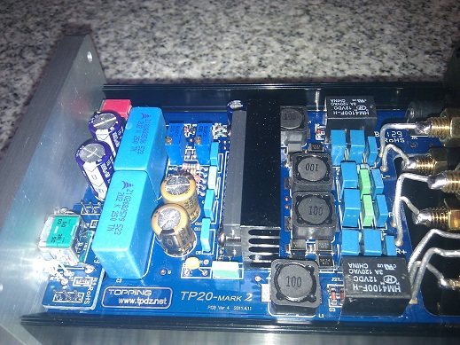

I also got my Topping TP20 Mark 2 amp today. Hooked up my sony 6 ohm 3 way speakers, I did not find the bass tight and when I increased volume to full.. there is lot of distortion. I will try to modify the AMP with the capacitors and see again, if it makes any difference.
I opened the TP 20 AMP, see two 220uF 50 V capacitors (C10, C11) near to IC, and another two 1000uf 16 V capacitor ( c23, c24). Can some one please let me know which Caps to change with what specs of capacitors.
Thank you Advance
Regards
Chandra Velaga

I am updating the photos, This PCB looks different than the ones posted in the forum. where should I connect the capacitors ?
You should add caps to the switch (rear connection I believe) and -ve side of the dc socket (the connection on the side of it).
