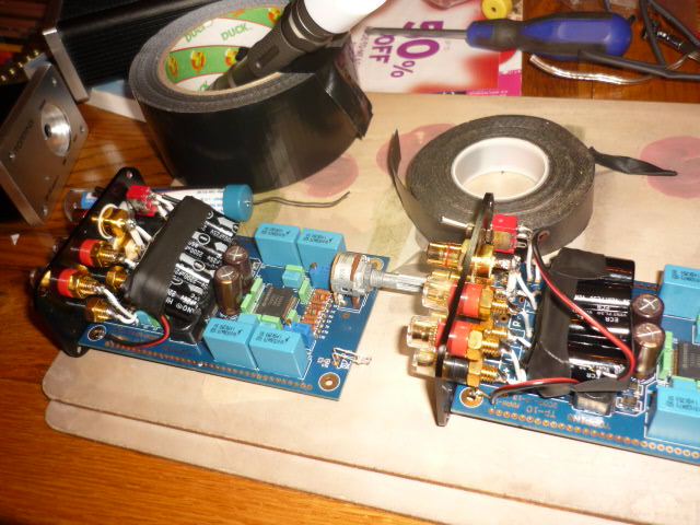

@the others for what better type can i change the caps marked in the picture???
pls help me im so
Hi Ra77, those do appear to be the input caps so yes you could be able to change them for non-polar film caps or whatever. The polar caps are said by some to sound better in reverse polarity.... but that is a matter of opinion.
To be sure, we would need a good quality picture of both sides of the board so that we can see the tracks and where they go from the potentiometer.

Looking to buy a Topping amp, and have decided on the lastest 2 models. The TP20 mark2, Or the TP21 with head phone output included. I don't see that they have been discussed in this thread yet. Any input? I'd also like to hear Arjen's comments.
Heres the tp20 MK2 board
And the TP21 board
And the TP21 board
And the TP21 board

Did you end up buying one of these, if so any comments? If not, anyone else know anything about the TP20 in particular? Those yellow thingy's could they be caps on the 12V as was discussed earlier?
From the photo of the two amp boards, it looks like the TP21's headphone output is driven by a basic op amp--no big deal in terms of great sound quality. Other than that, it looks to be a nicer amp over the TP20 Mk II with 2 x 3,000uF Elna electrolytic caps (purple) on the DC power. I don't see any comparably-sized electrolytic caps on the TP 20 PCB. It also appears to have the same pair of 2.2uF film caps (yellow) for the input.
The TP21 has more thru-hole components like the Dale RN55 metal film resistors, which are nice. If someone wants to experiment with Carbon composition resistors like Kiwames or Rikens or other metal film resistors like PRPs, it's a lot easier to swap them in than trying to replace tiny surface mount resistors. These might be the feedback or gain level resistors. If anyone has a schematic of the TP21, that would be helpful for understanding the role of these thru-hole resistors. Anyhow, it looks like the TP21 has the space and layout for easier modding than the TP20.

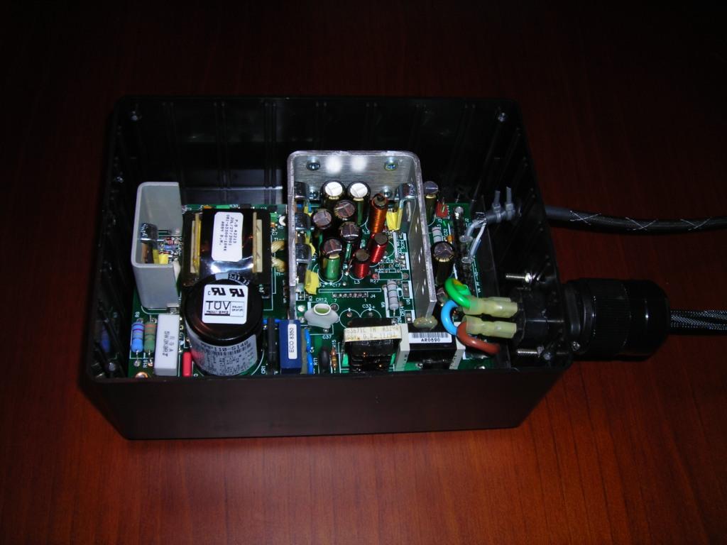

In my experience with Class T amps, the power supply has a significant role in sound quality. I have modified a Power-One MAP110-S140 switching power supply by installing higher capacitance 2,200uF/50V Panasonic FM electrolytic caps in the secondary filter cap bank. I made my own DC umbilical cord by twisting a pair of 18 AWG Teflon-insulated Silver-plated Copper stranded MIL-SPEC wire with Switchcraft 2.1mm/5.5mm DC connectors. Like most switching power supplies, the output can be adjusted with a pot to boost the output voltage. The result was a warmer, richer sound and significantly better defined bass.

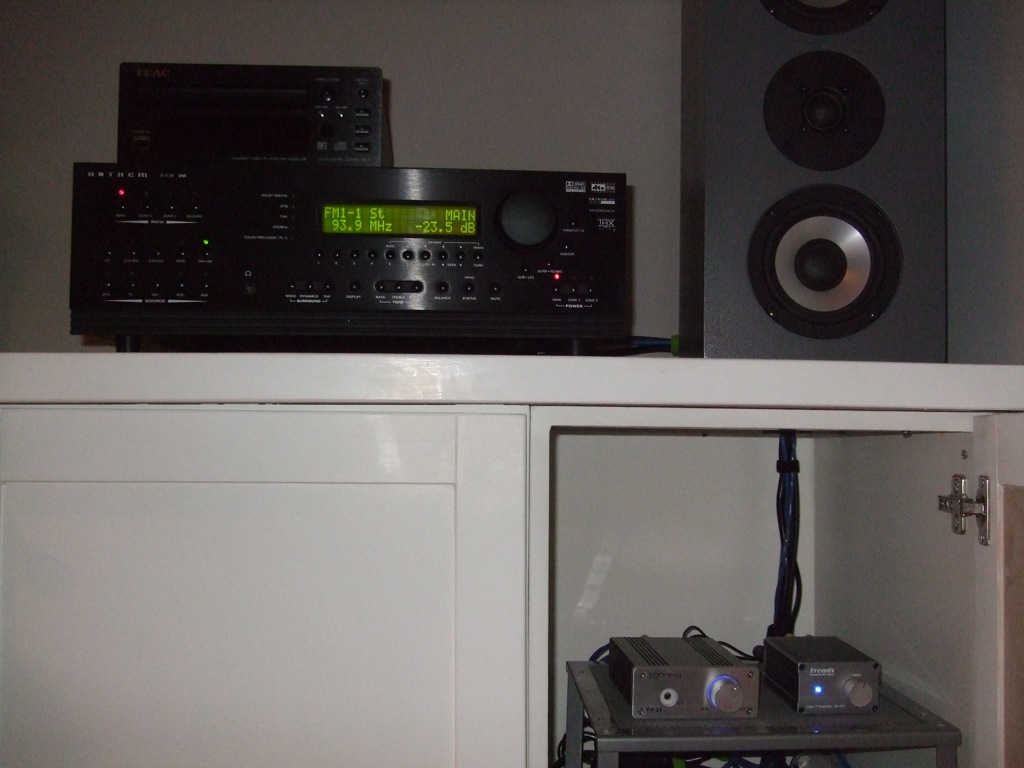

I received my Topping TP21 from Arjen yesterday and got it all hooked up. I have it driving some fairly inefficient speakers (87db?) right now and it sounds good. I was using a Trends 10.1 before and I can't tell them apart. It's very quiet with no noticeable buzz or hum until the volume is all the way up and even then I have to have my ear 10cm from the speaker. I'm using a Lian Li 4.5A SMPS.
The amp is larger than I imagined and it's really nicely put together. The binding posts are not the standard width apart so I had to use use some different banana plugs. The blue ring around the volume is nice and dim. I'll pull the cover off in the next couple days and post some nudes.
