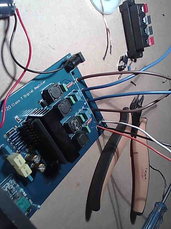

I was thinking of getting a regulated 13.8v supply for my TP20 but have just noticed the two D0 diodes required for operation of the tripath chip above 13.5v are missing, would it recommended to install these before doing this?
minusthetom said:I was thinking of getting a regulated 13.8v supply for my TP20 but have just noticed the two D0 diodes required for operation of the tripath chip above 13.5v are missing, would it recommended to install these before doing this?
Hi, minusthetom,
I have a modded TP20 that I run off of a homebrew SLA supply, when the battery is fully charged it it delivers about 13.5 volts and have had no trouble with this.
I am not familiar with the 'two diodes' that you mention, this to me sounds more like half wave rectification rather than an over voltage protection? Could be wrong though
I guess an option would be to change the regulator in the supply to a lower voltage....
cheers.. Steve
Sorry I wasn't all too clear with my post!
The output stage for the tp20 is identical to that found on the ta2020 data sheet with the exception of a couple of capacitor values and the omission of 4 Schottky Barrier diodes (2 per channel) which connect to Vd. Tripath state that the diodes are required where VDD exceeds 13.5 volts to "minimize overshoots of the outputs with respect to VDD during switching transitions".

I downloaded a copy of the Tripath TA2020 datasheet, the question you ask about the Schottky diodes might be better answered by Arjen.
I note the data sheet shows that the typical input voltage required is 13.5 with a maximum of 14.6, which again goes to prove that you have nothing to worry about with your proposed regulated power supply.

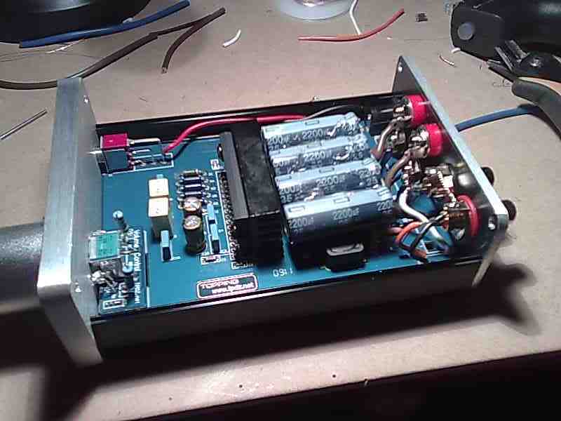

I've a TP 10 Mk3. The bass is pretty weak. I want to mod but i don't know which is the input capacitor and the buffer cap. Anyone can help me identify them?
I've got a TP 10 MK3. the bass is weak. I want to mod but I do know know where to solder the caps for the 12v line and which is the input cap. Can anyone help me identify them?
Hi Kakaxi, add the capacitor(s) across the 12v input, mine is + to the switch and - to the DC input socket (TP20) I'm sure that you could easily identify the + & - supply onto the board, choose somewhere where you can easily solder a wires for the capacitors.
I'm sure that you will be happy with the result
cheers.. Steve
I have four 4400uF 25V cap´s that i wanna put in my Topping tp-10 Mk3.
why the voltage in cap´s have to be 25V? even the input voltage is only 12V?
Do I have to loverdown the cap´s Voltage somehow?
Is it ok if I only put 3 Cap´s if i´dont have enough space for four cap?

The voltage rating of the capacitor should be above that of what it is being used at, the written rating on the capacitor is what it's dielectric is rated at.
So a 25V rated cap is perfect for 12V.
I would think that two of your 4400uF cap's would be more than adequate for your TP10. 8800uF tank cap is good 😉

Thanks! 🙂 two it´s gonna be. easy to fit.
I also going to change the two 220uF caps that are original inside, for 1000uF caps. Is that also Ok or is´t a waste of time?
The capacitors that I think you are referring to are the two 220uF input caps, I would strongly advise you not to increase the size of these as you will probably damage the 2020 chip 😱
You might consider installing better quality film caps in their place of the same value (220uF) Mundorf's, Auricaps or something similar.
