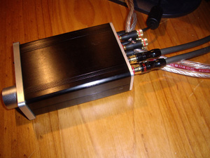

Hi Arjen,
firstly I would like to thank you for service given by yourself and Stacy and the easy ebay transaction, I would highly recommend anybody to purchase from you.
I have done some modifications to the back panel, removed the 3.5mm jack and the very ordinary speaker connectors. I would have liked to install binding posts, but with the very small available area, I resorted to using banana sockets along with two RCA sockets.
I am very happy with the amplifier and happy with the results of my modification.
If anybody is interested, I can supply a CAD drawing of the back panel, I will also post all of the modification photos on 'DIY Audio' on Facebook

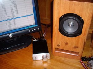

BTW the speaker in the photo is a home built Swift design by Emil Attlid (just a little plug for a good designer!) The driver is a Tang Band

Hi swkbkk,
sorry I'm new to this site and thought that I had attached photos to the post? I haven't had a chance to post the photos on the Facebook page yet, I just finished working on the amp about an hour ago.
I'm not sure that changing the 3.5mm jack to RCA's makes a vast difference to the sound? My original plan was just to swap over those horrible little plastic snap in speaker cable connectors with binding posts so that I could attach a 'decent size' speaker cable, however I had enough space for a couple of RCA's, and I prefer them!!

A single full range driver bookshelf for TP20
Hi Audi0,
Thanks for the pictures. Your homemade speaker looks very beautiful! What model of Tang Band does it use? Do you have more information and building instruction available? How does it sound with the modified TP20?
I am in the process of finding a small bookshelf speaker for my TP20. I want a high efficiency single full range driver speaker without any crossover (even without a notch filter if possible) that is simple and cheap (hopefully below $100US) to build. Well, I have never built a speaker myself so I want it to be as simple and cheap as possible but of course, I want it to sound good too.
I have been searching and gathering information and have found a few interesting projects including Pekar's DelSol speaker, which seemed almost perfect solution for me until I found out that the Aura driver used in the project is no longer available. :(
Maybe, I can try building something like yours if it's not too complicated and not too difficult to get the parts.

Hi swkbbk,
the speakers are Emil Attlid design 'Swift' all details are on his web site http://attlid.eu/index.html
The parts are easy to come by.

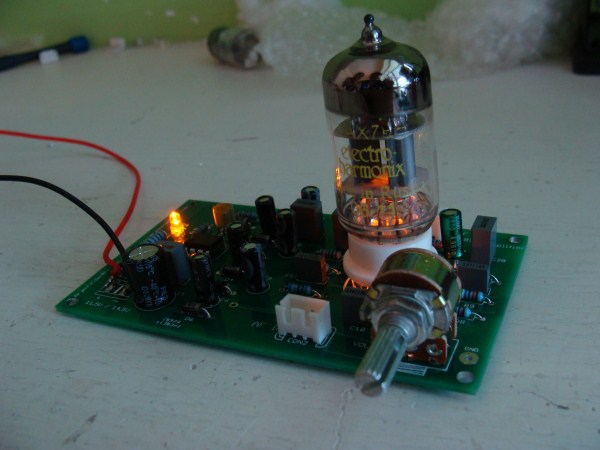

Hi there,
Ive been working on exactly that, changing the sound to a different flavor using a pre- amp, or to be technically correct a valve buffer.
I have designed together with a good friend from Germany a buffer specially for the Tripath IC series, it uses a 12AU7 valve, and feeds on only 12 volts, because it has a DC-DC converter inside, making about 42 volts max as plate voltage.
This set up i have been testing over the weekend here, and wowee! that sure sounds nice! it adds the warmth of a valve amp without harming the detail of a T-amp, its fantastic!
Also, ive got new PCB's out! for the TA2020 and TA2024 MKIII
amoungst the improvements,
- bigger buffer cap 6800uF 25 V
- Micro metals high frequency toroidal output coils
- 3mm thick PCB board
- AC and DC input supported
- Ultra wide voltage input, 9-15 volts !
ETC!!
Greetings,
Arjen
