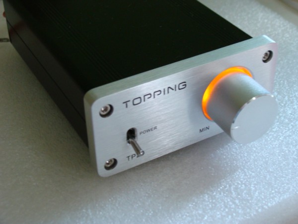

First of all, i would like to explain why i think its usefull to add some capacitors, later today i want to post the scope readings aswell. to show the efffect it has.
Since the powersupply has a cable of say 1,5 meter, plus a connector plug, plus a switch all in the powerline, plus the PCB tracks, it has quite some resistance, especially at power peaks.
If you measure at the IC's 12 volt lines you can see that the voltage is not as stable. with every beat it can drop as much as 1 volt. this means that when the IC needs the power most, it has less power available.
I have measured this by connecting my probe to the 2 power input leads of the IC while the amp is playing at medium volume at 13.5 volts.
adding extra capacitors to the power line after the switch and the connector means that the ESR is dropped significantly, and therefore the drop in voltage over the power pins is also dropped allot, to about 100-200 mV max.
This results in to a tighter bass response, somthing witch is not just measurable with my THD meter at 120 HZ but also clearly hearable to most. ( unlike allot of those input capacitor mods, witch are spendy but without measurable results. )

PS:
Added is the photo of the Modded amp. ive also changed Blue for a yellow- golden color of light.

After my first impression at night at low levels with the 2x 4700uF added to the 12V line i finally got around to normal listening levels yesterday and i am impressed.
Both by how much the amp changed with such an easy mod (now i get why people love lead batteries) and how low my speakers really go.

Yes its amazing how much difference you get changing just the input caps, the rezon is that the buffer capacity needs to be really close to the IC itself, a battery powered amp will also perform better with big buffer caps, because the resistance inside the battery itself rises exponantionally with the current demanded.
I put 8800uF 25 volts caps in the modded amps, and i standart replace the Blue LED for orange/Amber colored ones.
The input caps i replace with 2.2 uF 63 volts poly caps from singapore, they measure very well with very low dissipation factor. the advantage of poly caps is that they are not so very large, like the ones used on my PCB's i sell, but later there will be a version that carries the latest PCB version with much improved output coils.
