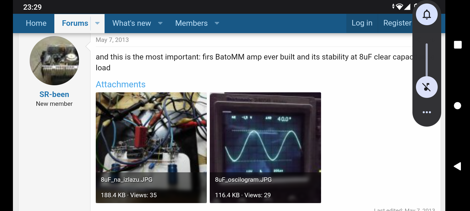

You really need to look at this with a 3-4V pk~pk square wave at 2-3 kHz with ~1us rise/fall times. Driving 8uF at LF with a sine wave is doable, but will be problematic at HF. That is one of the reasons for testing with a square wave - you can see how the amp deals with a very low impedance load (the capacitor) at HF. One of the issues is you get is HF OPS pole migration downwards in frequency and if the gain ends up being >0dB before the unity loop gain frequency the result is instability. You should use fast rise/fall times because it will also give you some idea as to how aggressive the amplifier front and bandwidth limiting filter is, or even if the amp has one (it should both for RF ingress filtering and to ensure the front end diff amp remains in the linear part of its operating region - whether it's a VFA or CFA). A small value output inductor of 0.5-2uH is extremely effective in isolating the amplifier output from capacitive loads.

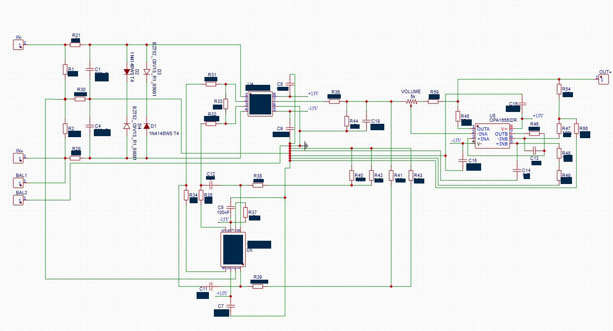

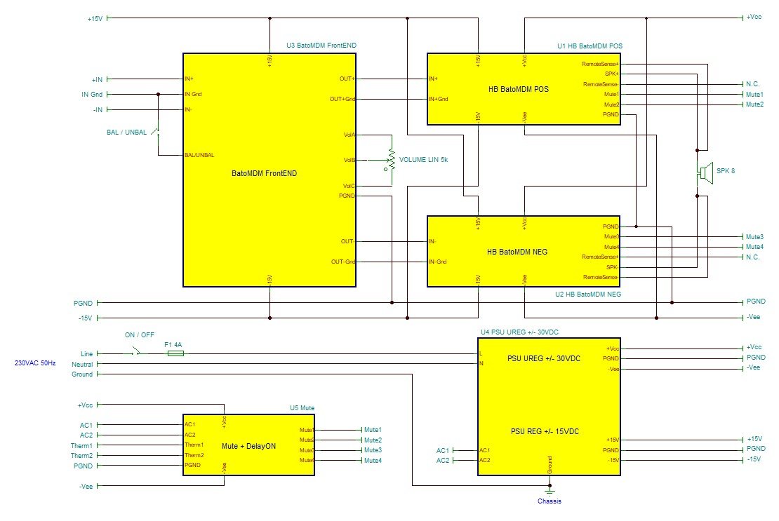

There is a lot of information about BatoMM on the internet, so try to find it! it is an ultra low distortion amplifier, with remote sensing directly from the speaker terminals, it was a very popular amplifier in the countries of the former Yugoslavia and over 1000+ builds. The designer is Dragoljub Aleksijević - Macola. The most recent pcb is V1.5 from post 304 page 3, its designed carefuly by instructions from the peoples from yu3ma forum where the amplifier was created, I helped them and drew the PCB V1.5 voluntarily following their instructions, no one has tried the amplifier v1.5 yet, but if you want a proven good version, you can find it here ->https://github.com/yu3ma/BatoMM V1.5 is very similar to it, a bit more modern than that one from git. Peoples started simulating BTL version, it will be probably born very soon too. Frontend is brutaly good too, similar to this one but do not have i/v and tone control. https://www.diyaudio.com/community/threads/topping-b100.417717/post-7860188 That's all I can reveal to you. It's not interesting to me, I prefer class D, but I can recommend that you try making such amplifier, you will definitely not be disappointed, similar to b100 "laboratory like amp". : )
V2.0 is in plan, contain frontend from picture, and when done I will post in thread from post 304.

this basic #1 rule of balanced interface technology
Link to this global 'rule book'? Topping made an engineering decision. In the bench test context it obviously works brilliantly. The inarguable oversight was not making explicate in the manual that their balanced input can't be driven single ended. Small sacrifice for a niche application.
Topping definitely has room for growth. Elsewhere here I describe how my DX3 Pro Plus DAC apparently spews RF junk. With one amp the front panel display status was clearly audible at the speakers. Recently it also became apparent its headphone output isn't RF protected. Driving the Hidsz MP145's 4-wire cable - and only with the Hidsz - the DAC goes randomly 'unstable', humming loudly at non-AC related frequencies. Placing a hand on the chassis temporarily ameliorates it, as does balling up the headphone cable. These concerns are the main reasons for my holding off on a B100 purchase pending more market reports.
Sorry, this is absolutely self-evident.
Why on earth would one want to propagate the common-mode signal/noise through the the whole amplifier, even amplifying it? CMRR will degrade from any component/gain mismatches between paths, but the bigger problem is that you want to drive your bridged output stage symmetrically, with the common-mode signal removed to avoid early clipping and other ill-effects.
The whole idea of balanced interconnect technology is that the receiver must not make any assumptions about the signal on the input pins other than that the difference signal is the payload. To extract the payload and remove any common-mode stuff (be it signal or noise) you must perform a subtraction as soon as possible right at the input, period. The subtraction circuitry can either yield an unbalanced or balanced output signal. You will not be able to find any well-designed balanced input that works diffently.
