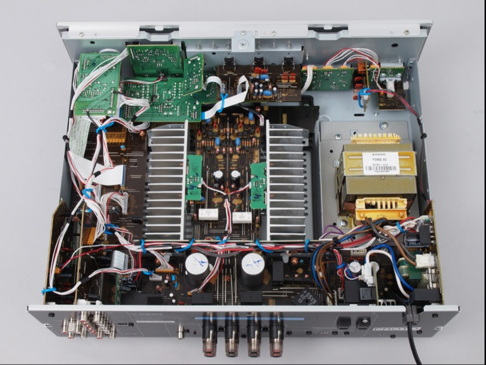

Just one look at the internals of that so-called amp should be more than enough to know that heat dissipation alone isn't ever going to cut it. Not possible... even if it was a class D amp with optimised idle losses.

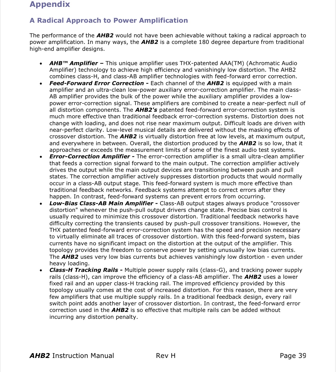

Still going good with the B200? listening impressions?IMD -20dB lower on the Topping B200, crosstalk zero if using monoblocs than using a single AHB2.

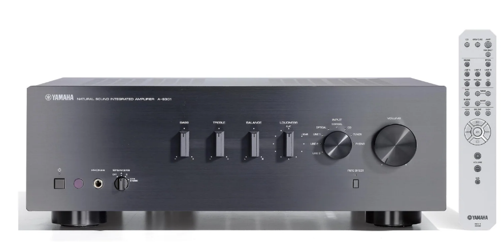

Yamaha AS2000.>Hypex NC400>Neurochrome Mod 86 bridged>Benchmark AHB2>Topping B200.
All through Topping Pre90 into fully tricked Quad 989 ESL's.

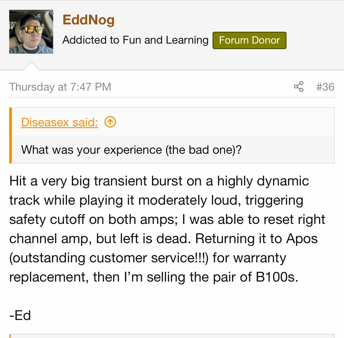

I was considering the B100 for a part in multiway active setup, but having an amp that dies during normal operation is a simple nogo.

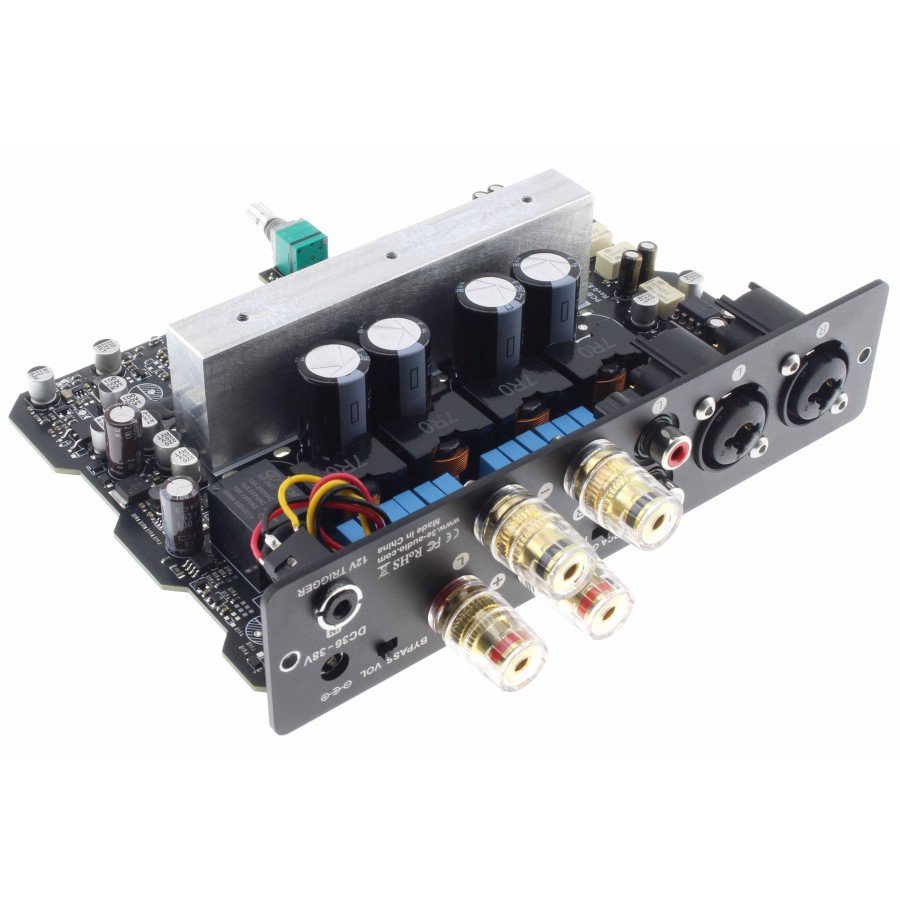

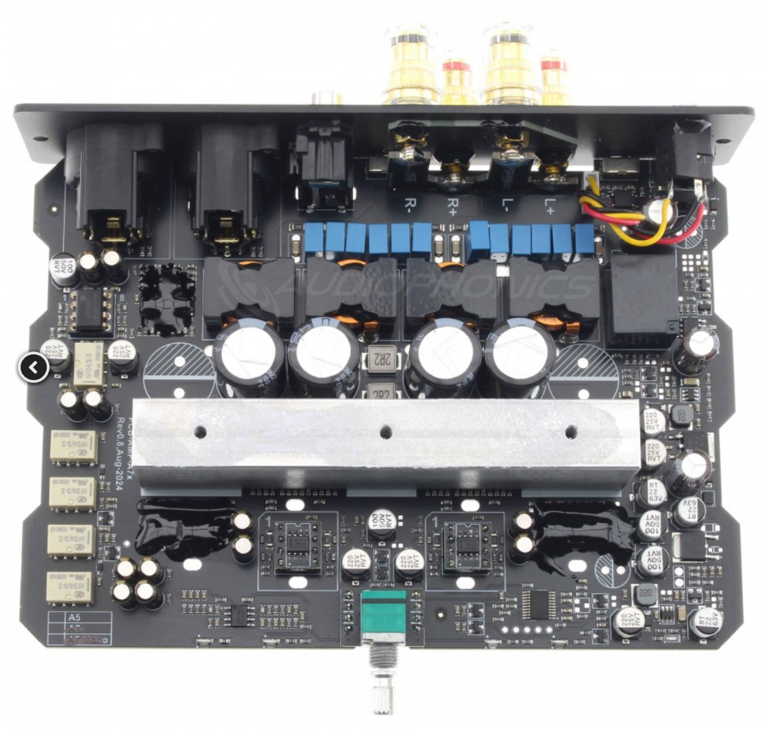

These PFFB-equipped TPA3255 designs are of highest price/performance value I think.
The question is how they sound ? Seeing their measurements I assume they're just as transparent as the Hypex NCORE amps (I've heard quite some now). Natural, beautifully precise, well controlled bass, etc.
With growing reports of B100 failures those 3e board are an attractive and inexpensive play around option. I may do a desktop unit. My comment though was more related to the ill advised social phenomena of holding the B100 to standards that amps the same people deem superior don't meet, like 'big fins'. Not a credible look.
I bought the Fosi V3's soon after this thread started. They are great for the $. My DIY class AB monsters are parked. Perhaps permanently. In this system they are powered up for days on end so class D much better. Also balanced connection out of the DAC. No pre-amp. More than adequate for my application.
Cool. Now do today's golfing panther amp.
That is the first time I have seen nicely implemented TPA3251. 3e Audio has had enough time spent with that particular IC product family to produce a very nice integrated amp. I personally appreciate the fact that it has 2 inputs and a volume control. But, what I really like is the layout, construction, parts used, and specifications are also very good - the crosstalk figure on its own shows a carefully laid-out PCB with proper segregation. So, yeah... if I ever decide to get a cheap amp for the kids' bedrooms, this (A5 balanced version) might be an amp. I do have only 3 concerns: No1 is that black stuff they used to cover what I assume is the PFFB global feedback passive and active components - will it cause electrical shorting/loading issues? ; No2 is the fact that heavy stuff like chokes will be hanging upside down for a long time. Probably okay, but it is a concern, nevertheless, if the amp gets bumped/exposed to vibrations like... bass shaker 🙂; No3 - the cost (ouch!).
