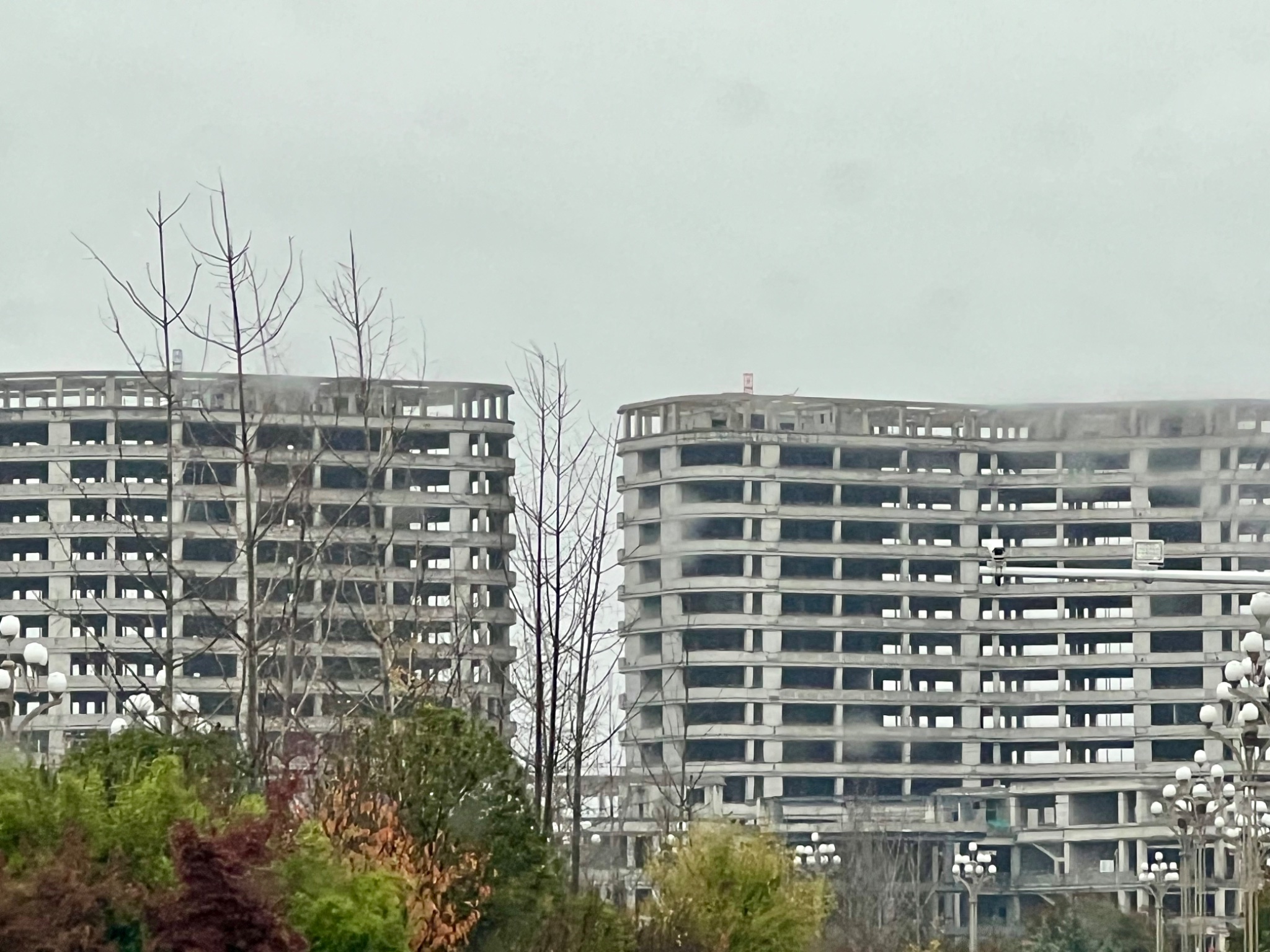

Between Hanzhong (population 3M) and Xi’an (population 12M) I saw literally 100 buildings like this. 1/3 finished, probably will never be completed. Devastating real estate crash. Epic levels of corruption and fraud. This problem extends all over the country with many “ghost cities.” With population levels in free fall.

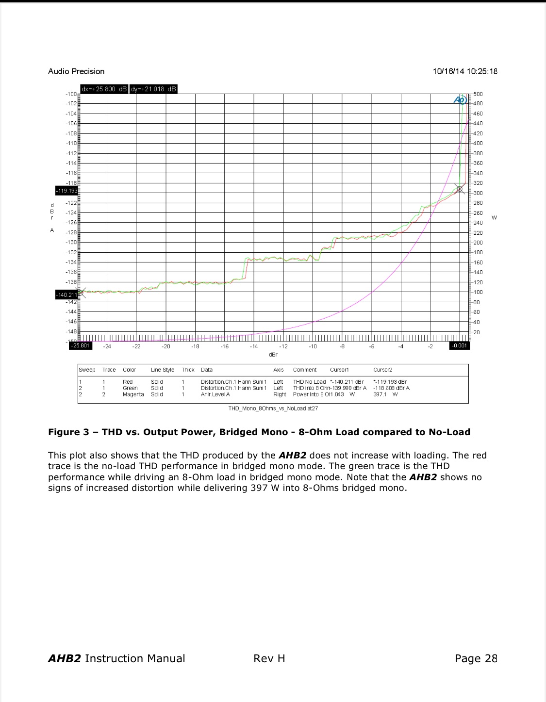

e.g. For the AHB2 amp, can be bridged also. Apart from increased power, the distortion figures are even better - most likely because of the balanced action at the load itself:

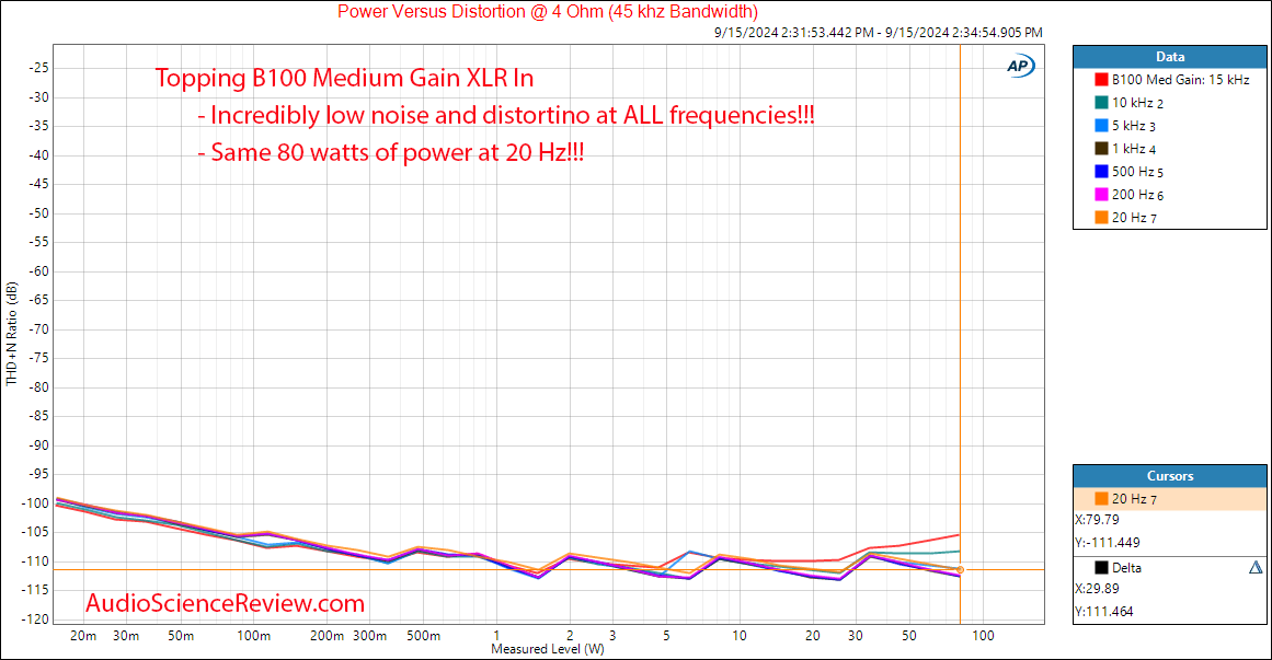

IMD -20dB lower on the Topping B200, crosstalk zero if using monoblocs than using a single AHB2.
https://www.audiosciencereview.com/...er-low-gain-multitone-measurement-png.337826/
https://cdn.prod.website-files.com/...6_668b904180ec750137b5eb11_B200%20-en-13.jpeg
https://www.audiosciencereview.com/...er-low-gain-crosstalk-measurement-png.337828/
I have both, B200 for 5 days.

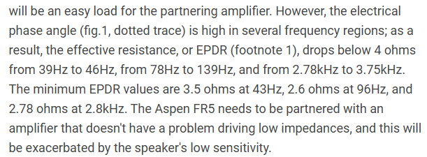

Here is a snip from the Stereophile PS audio Aspen review (the first speaker on your list) - EPDR is the important spec because you have to consider phase angle as well as load impedance:-
Some of the bookshelf speakers you mentioned have horrendous sensitivity specs - the PS Audio Aspen was measured at 82.3 dB - for a 100W amp at 2 metres that's 102 dB SPL.
