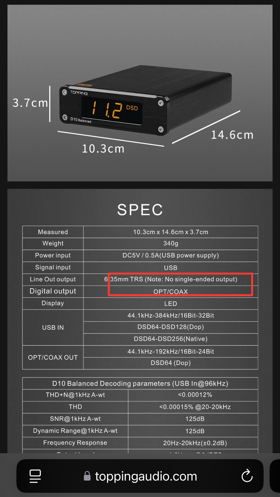

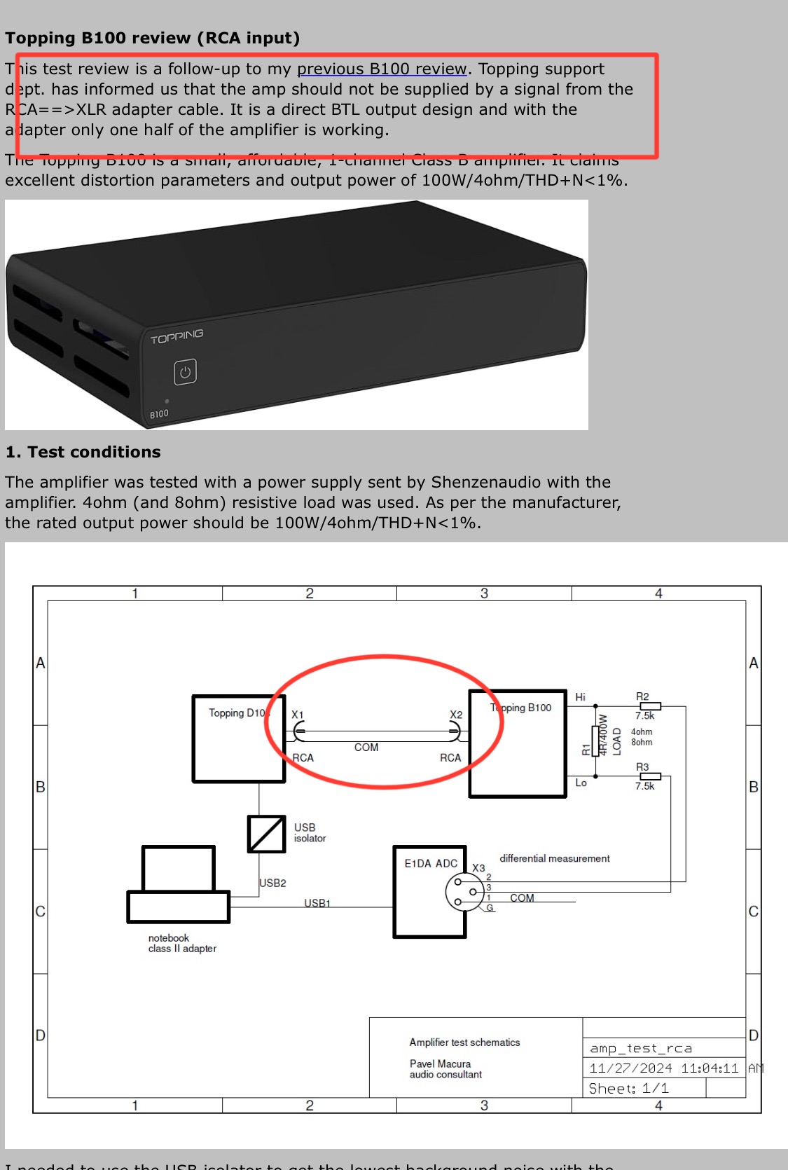

One thing I don’t understand is why the tester, Pavel configured unbalanced drive from the TRS (balanced ) output of D10 DAC that clearly states no true SE capabilities. And he is driving into the RCA input of the D100. Topping has clearly advised against this type of setup.
So the measurements of the/noise etc is a bit suspect. The correct way should have been balanced TRS from D10 to XLR balanced into D100
The use of USB isolator to possible overcome the loss of signal quality?
and if I were from Topping support I would dismiss this test arrangement and the report

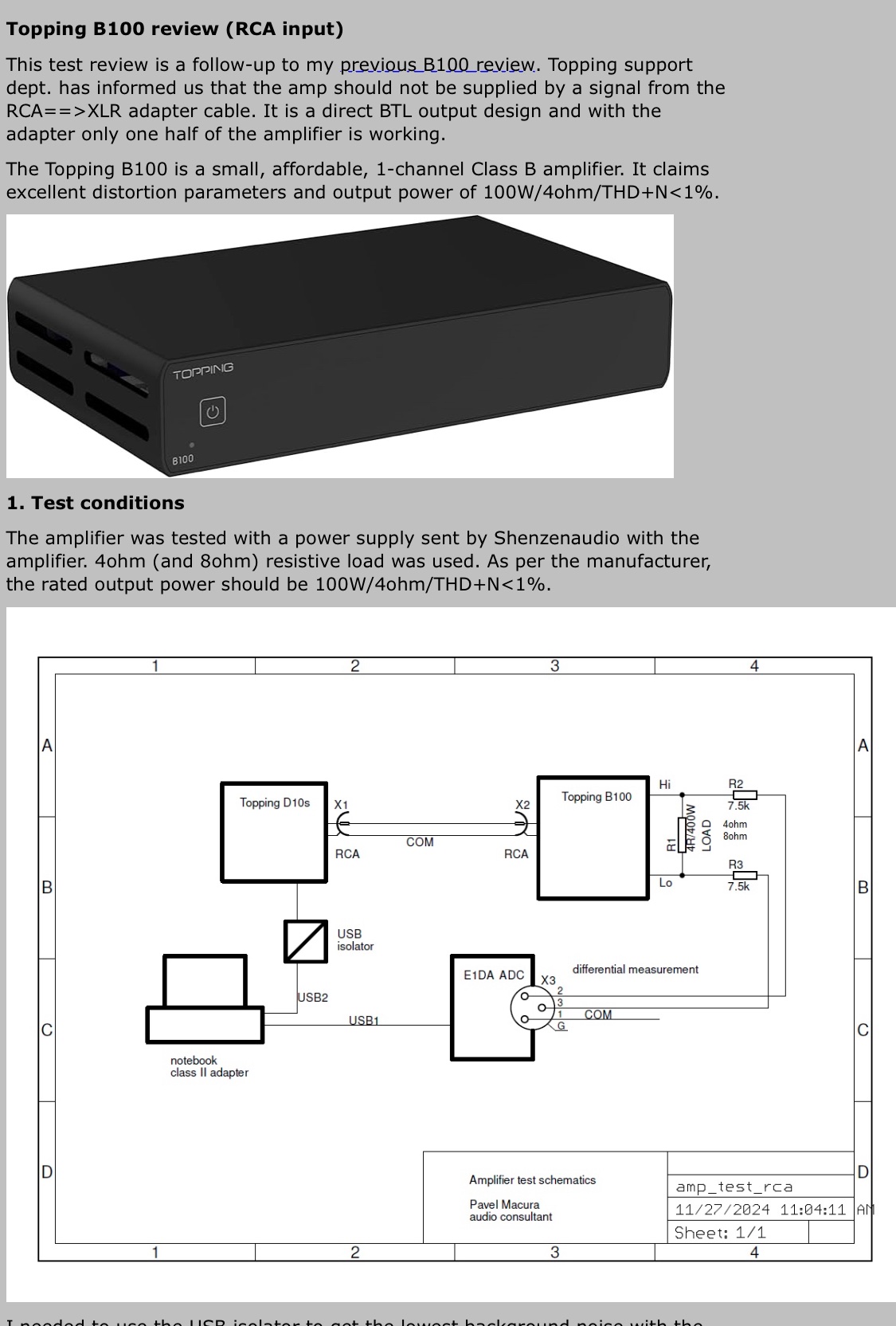

Thanks Miero, very interesting but I am not quite on the same page:

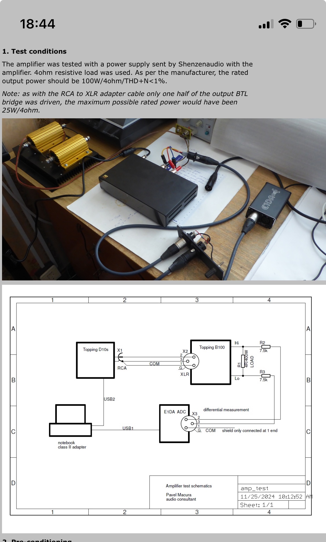

As I see it the the first setup looks not optimal as balanced output from D10 DAC (correct) configured on RCA wiring goes into the XLR input of the B100 with one end of the amplifier circuit grounded to match the SE drive (incorrect). So the THD+N figures not that good as one of the B100 amplifier circuit is not engaged.
So perhaps Topping advised Pavel to use the RCA input of B100 instead since RCA cabling and connectors were used. This is correct on the B100 side but Pavel had also configured the balanced out of the D10 as SE arrangement. This is not really optimal as the D10 is balanced out only and if signal taken from one line then the cmmr suffers so not optimal again.
Why not get Pavel to use TRS connections on both D10 and B100 and see how the measurements look like
Are you aware that there are two Topping D10 models, the D10s with RCA outputs which Pavel used and the D10b with TRS outputs?One thing I don’t understand is why the tester, Pavel configured unbalanced drive from the TRS (balanced ) output of D10 DAC that clearly states no true SE capabilities. And he is driving into the RCA input of the D100. Topping has clearly advised against this type of setup.

My bad, forgot to see the fine print on the different models of D10🙈
So all good with Pavel’s tests so just back to power delivery issues

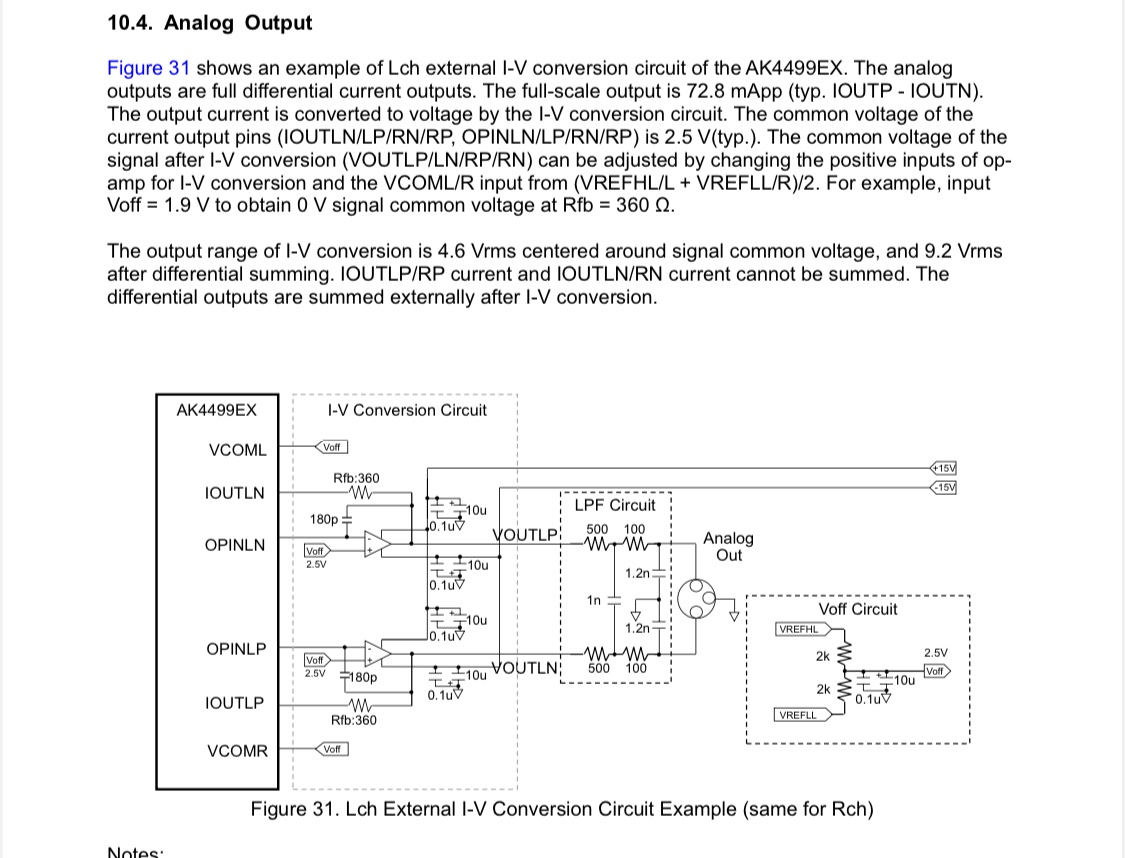

I don’t see why Topping’s implementation is bad on their DAC or Amp. See how AKM implements balanced outputs. The subtraction effect is at the output, very simplified with just one amp per line. Yes, you can sum and then rebalance but this means more active stagesAre you aware that there are two Topping D10 models, the D10s with RCA outputs which Pavel used and the D10b with TRS outputs?

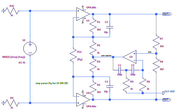

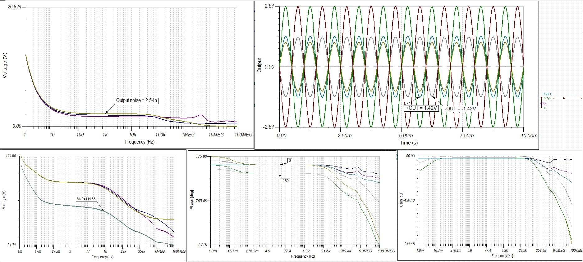

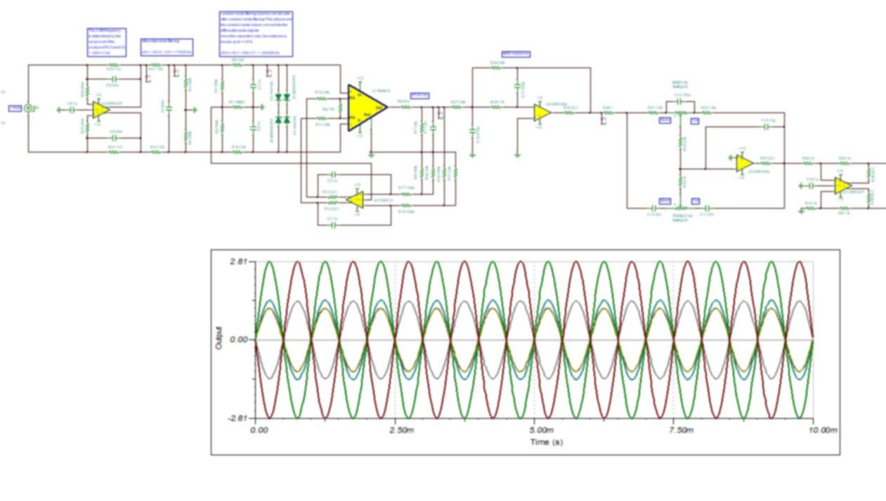

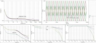

Not neccessarily. See following design example, a rebalancer/driver with high-Z inputs can be made with 3 opamps, even with switchable gains:Yes, you can sum and then rebalance but this means more active stages
The only restriction is that minimum gain cannot be unity.
A DC servo can be added with just one extra opamp. So you get away with 4 opamps for a full-featured amp input front-end.
Excellent! Yes, I have seen this elegant solution in new ESS 9039 DAC app (and also in Marcel’s RTZ DAC) but surprisingly Topping, smsl others seem to eschew this. I have implemented this 3 opamp arrangement on my new AKD39 DACs just to keep it close to ESS recommendations 🙂

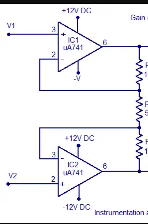

Note that this is the high-Z instrumentation amplifier version, whereas in an I/V-stage one would use the FDA approach with current input, either as a fully integrated FDA or the 2-opamp or 3-opamp versions.Excellent! Yes, I have seen this elegant solution in new ESS 9039 DAC app (and also in Marcel’s RTZ DAC) but surprisingly Topping, smsl others seem to eschew this. I have implemented this 3 opamp arrangement on my new AKD39 DACs just to keep it close to ESS recommendations 🙂
While the INA with CM servo loop is nothing new it flew under the RADAR all the time and it is hard to find references. I remember to have seen an implementation in the late 1990's
Yes, it is more like the IA first stage. For the FDA/CM servo I don’t remember seeing anything like that during school days so was pretty stumped with Marcel’s and ESS ones.
