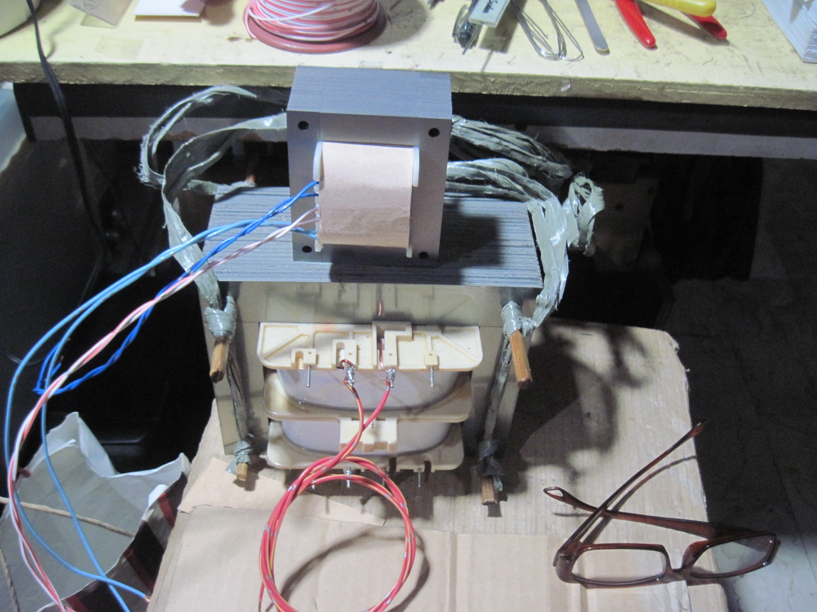

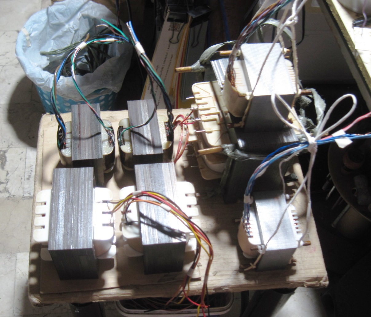

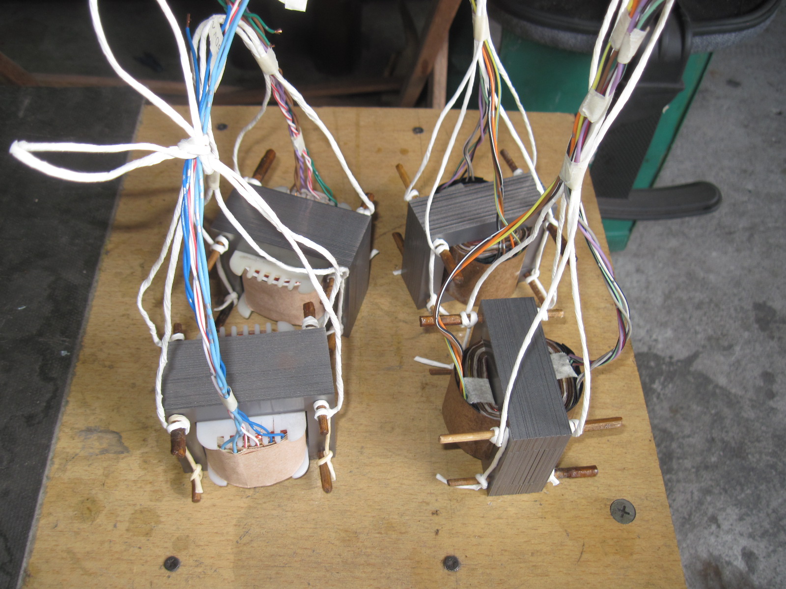

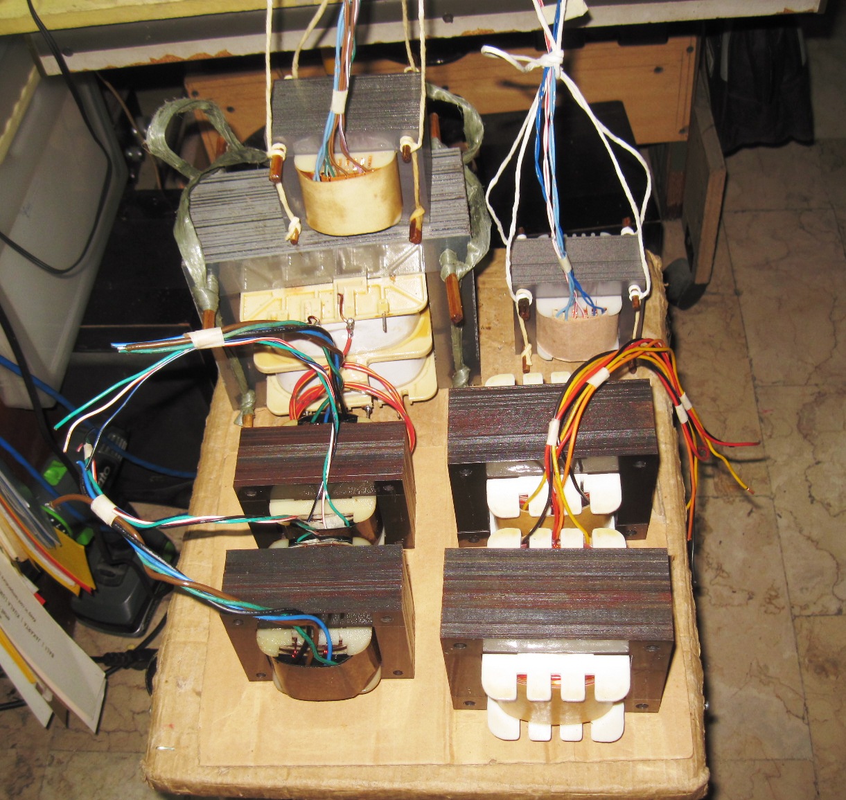

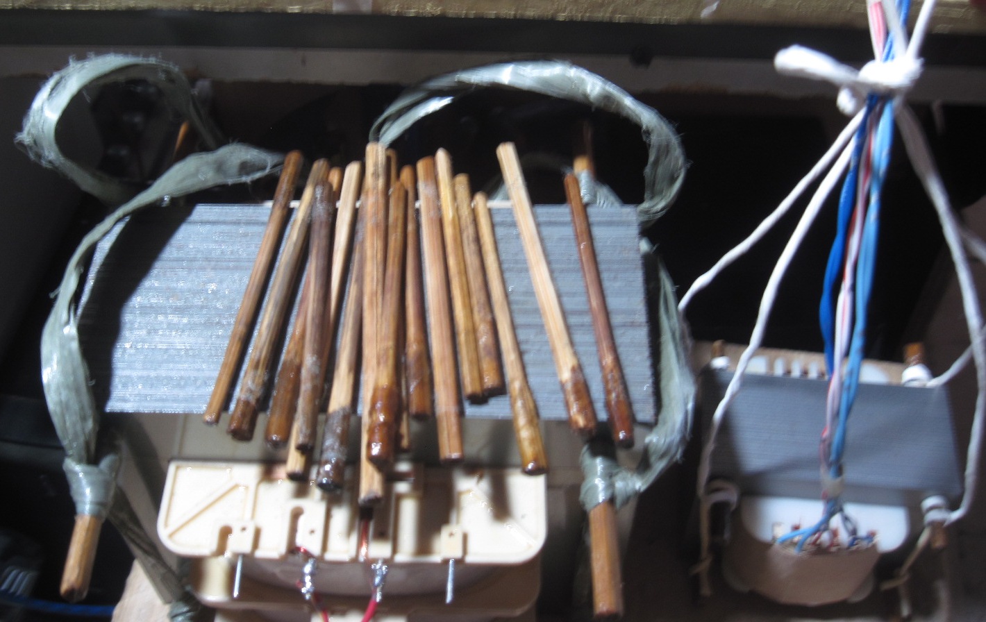

yes it does, and under the "HOT" Manila sun dries in about a day or two...
i soak my finished traffos under the sun for almost a week...
so those traffos are good to go in about a month or so....
i know that drying takes time, i am in no particular rush to use them...
but i also test them a bit even before dunking them in varnish....
btw, you know when the varnish has dried up when the strong smell of the solvent is gone....

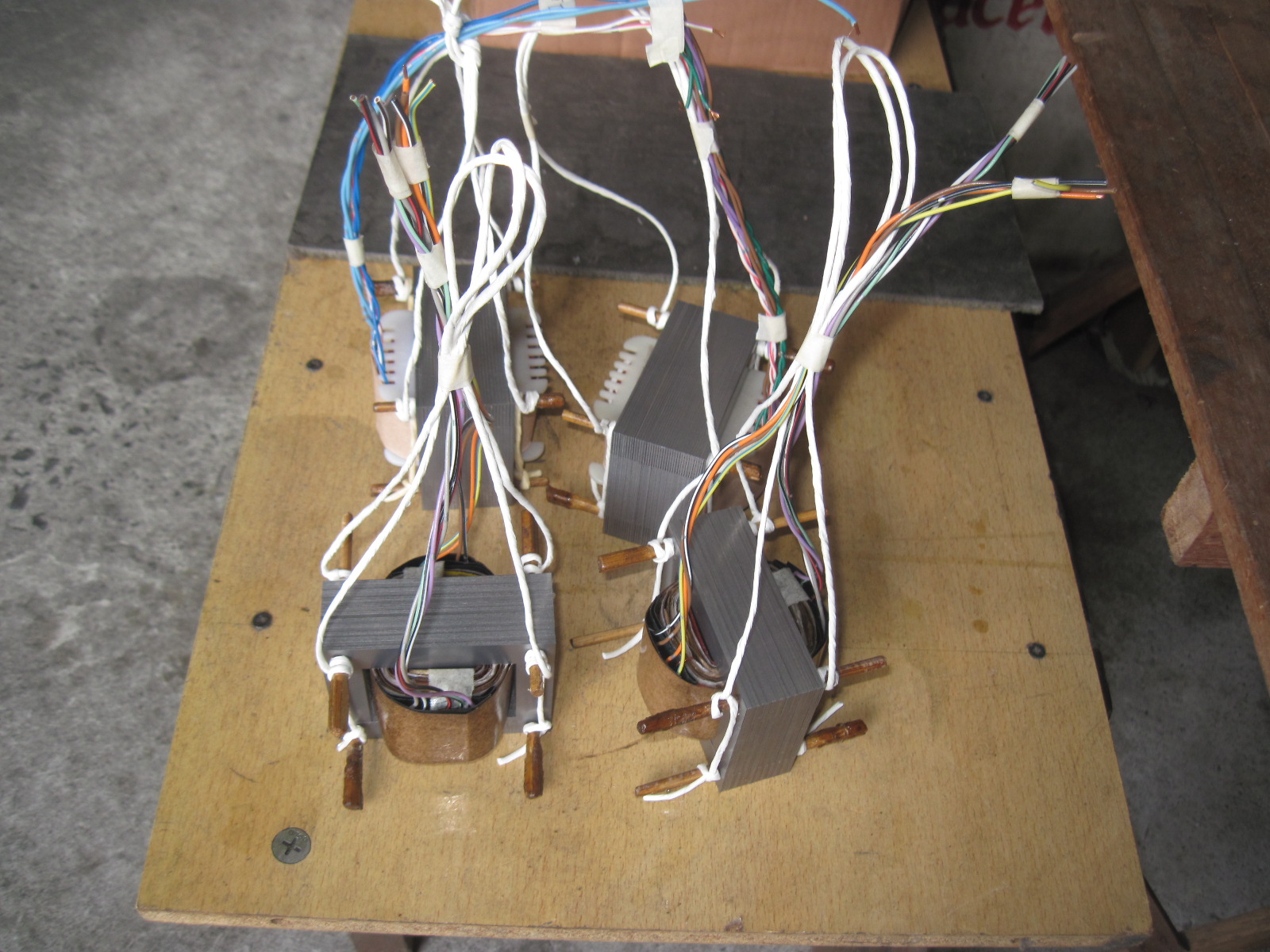

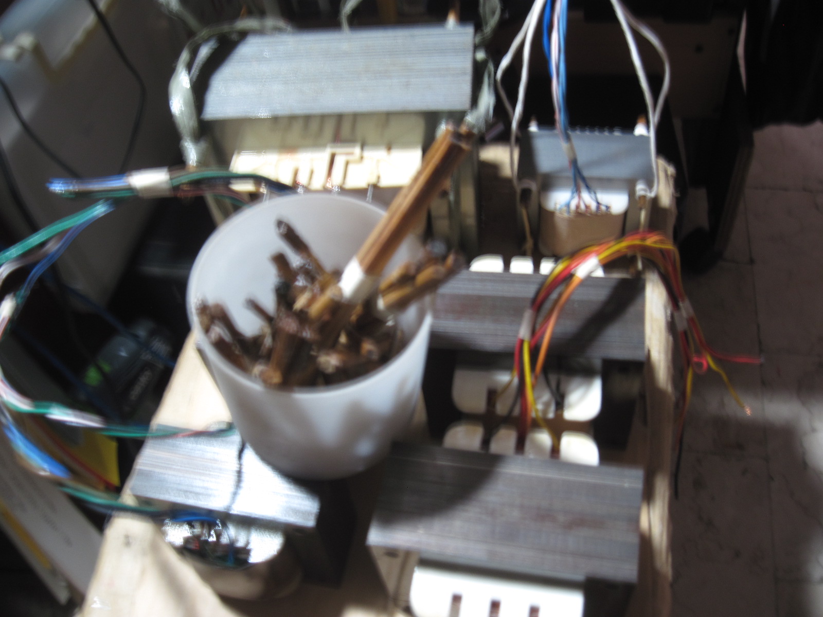

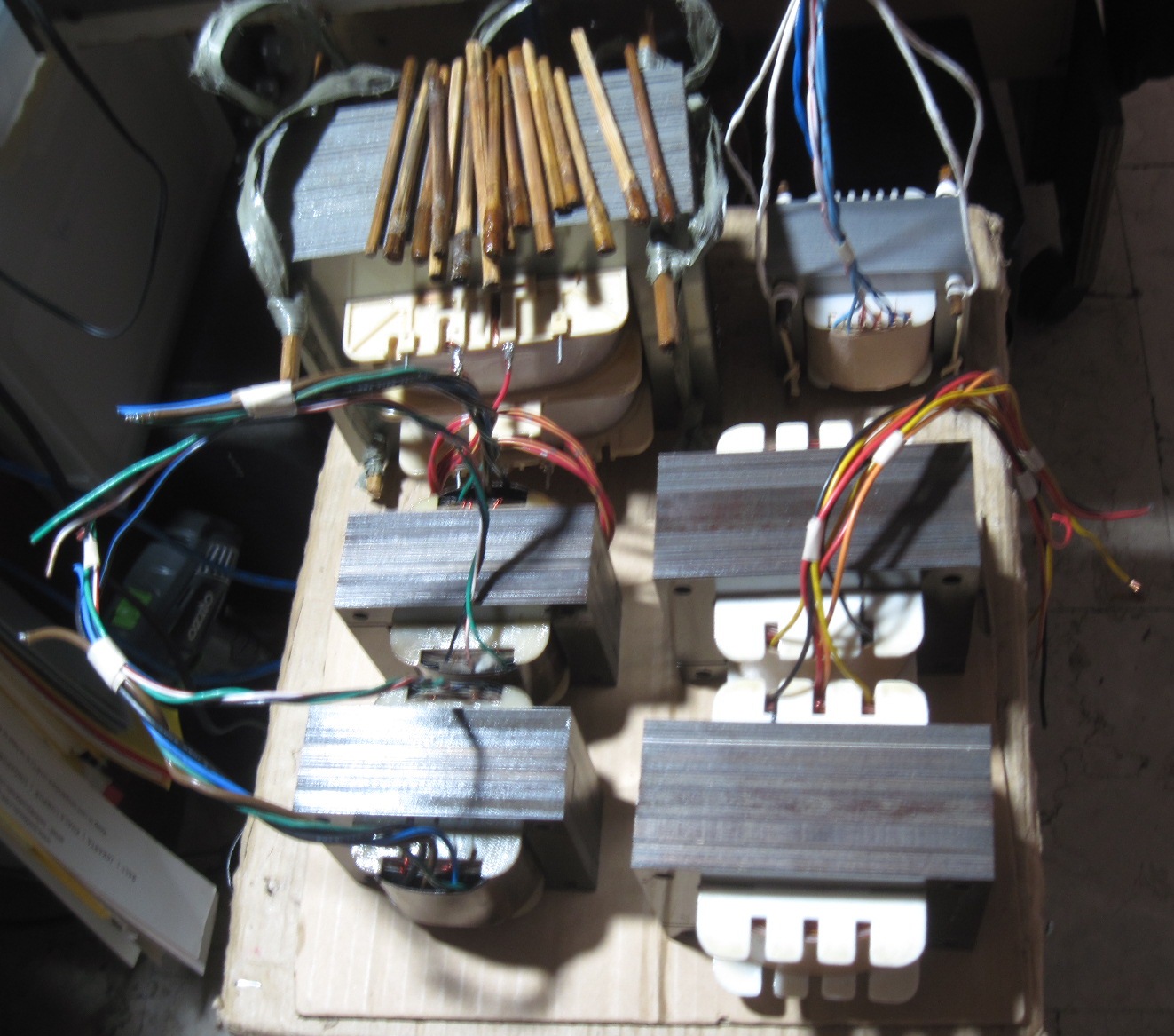

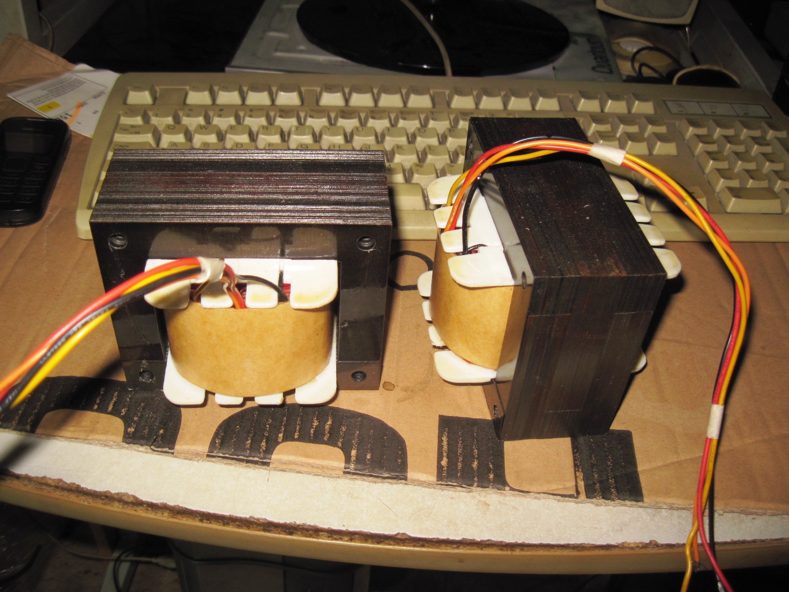

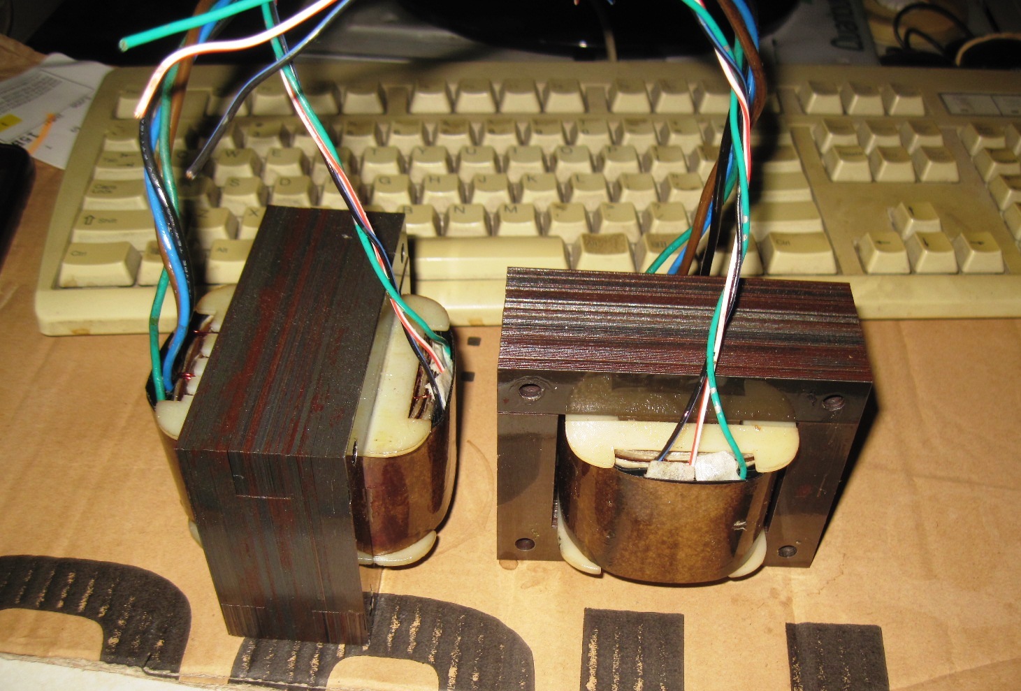

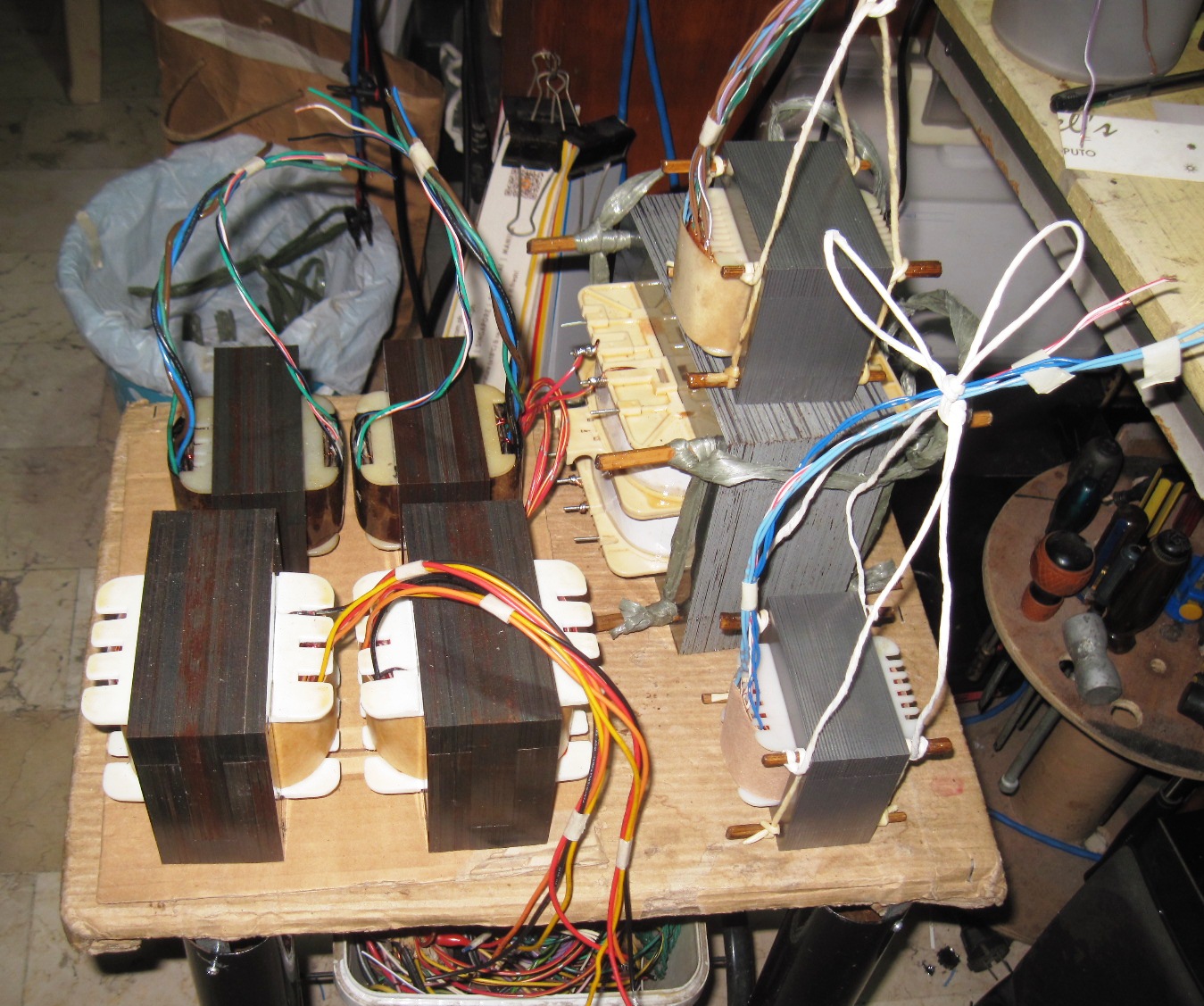

productive weekend......

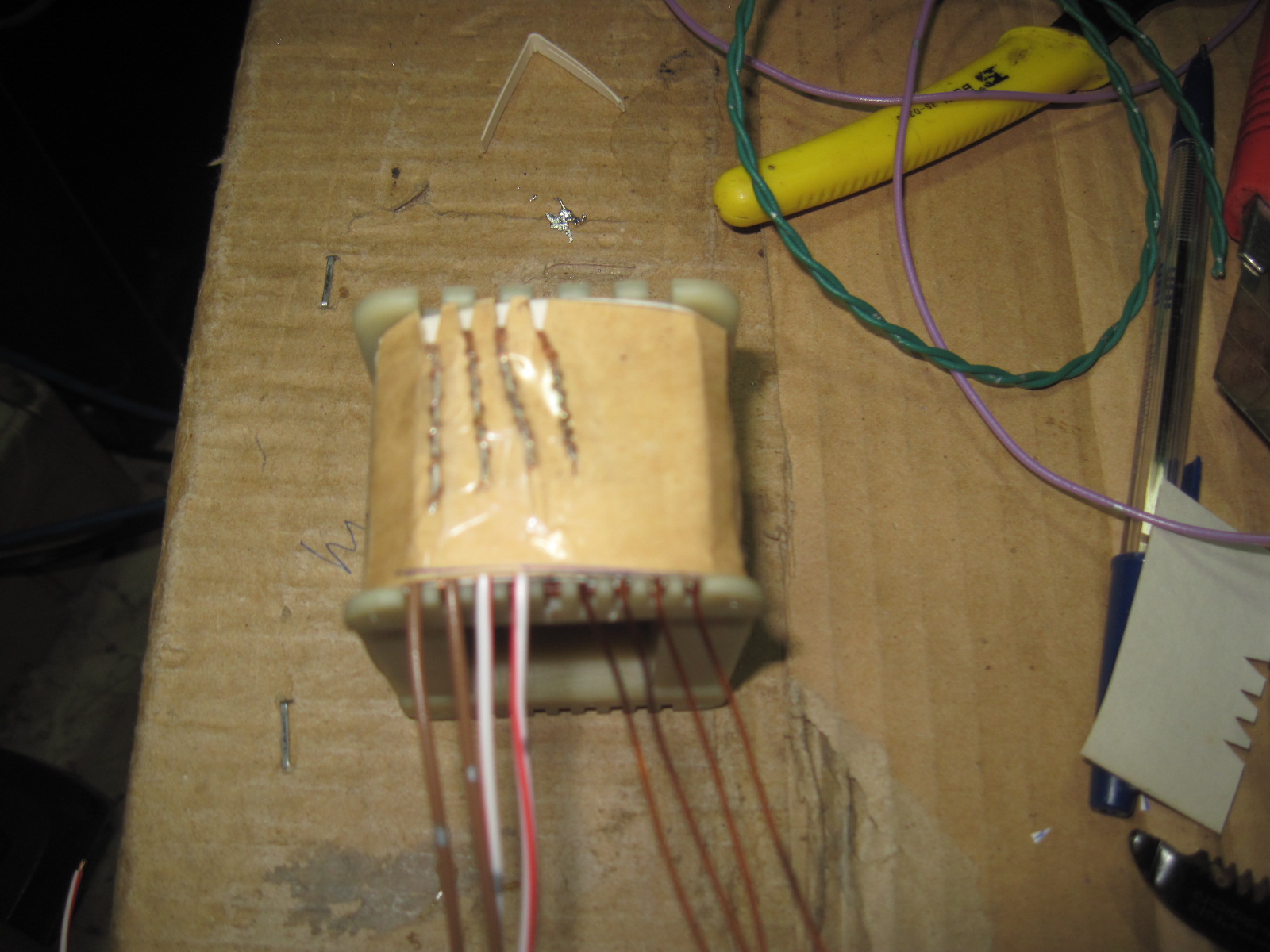

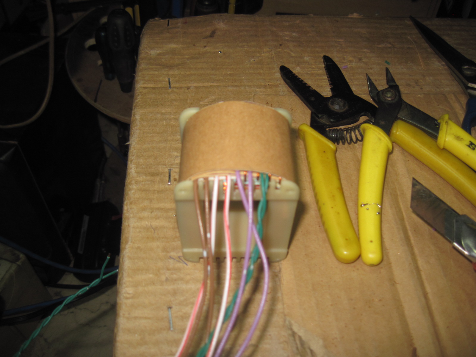

terminations of pigtails i learned from the japanese....
now i learned it from you...
is it ok to use mylar as covers
thnks
sam

yes...i use those too...
thank you sir...

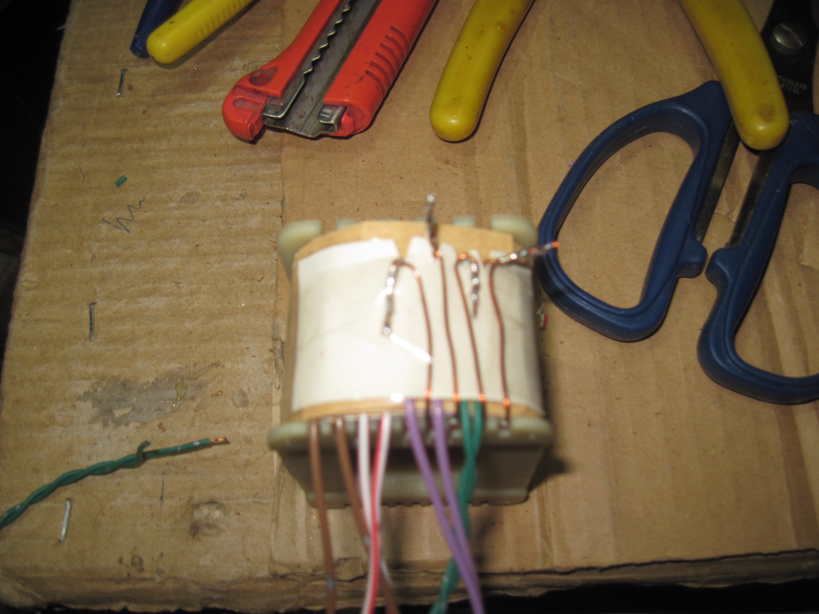

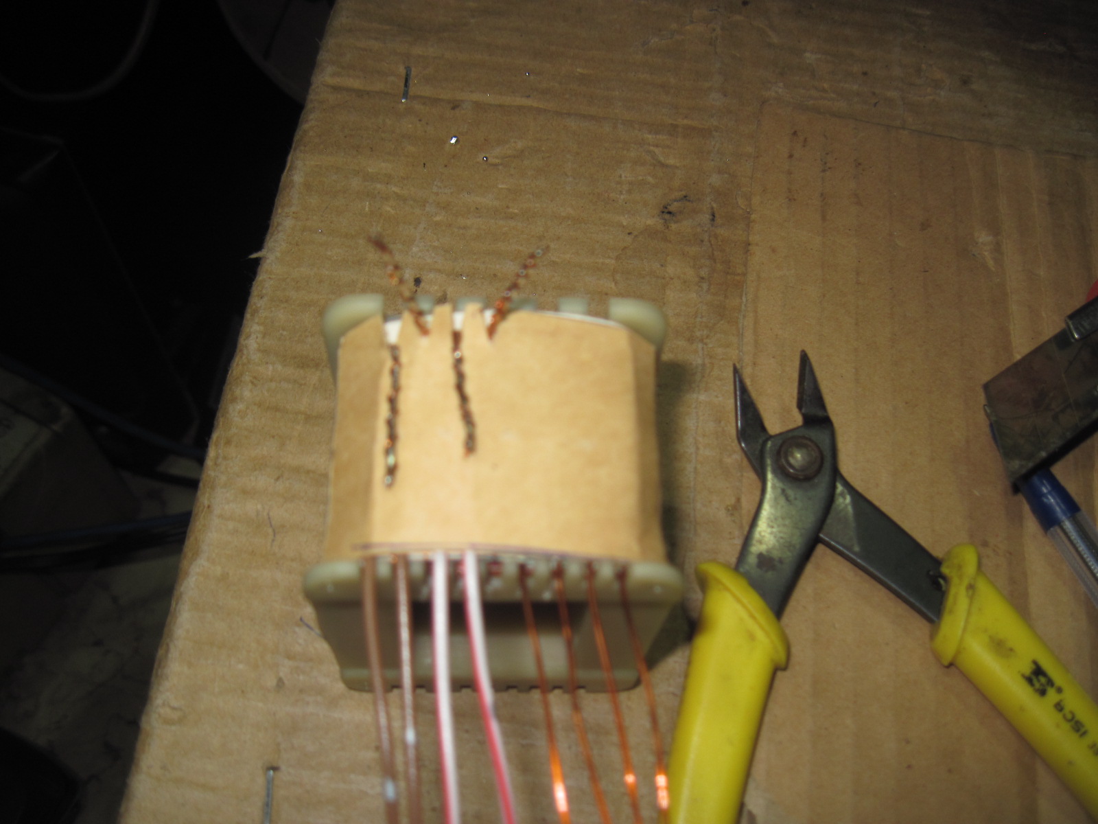

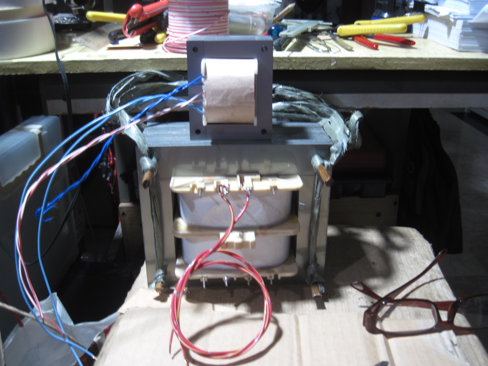

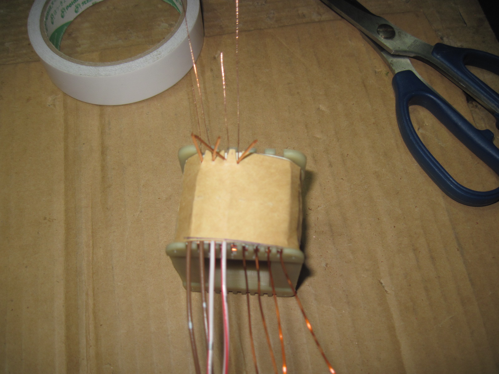

here is my primary treated with poly urethane 3 days ago, i'll wound the secondary when its partially cured. in my opinion i prefer this so varnish can penetrate the primary. i'll finish it when i get home in the wekend.
sorry not in a good angle this was when i took pic on my diy of APEX AX14 with that traffo beneath CL 1 1/4"
regards
sam
regards
sam
