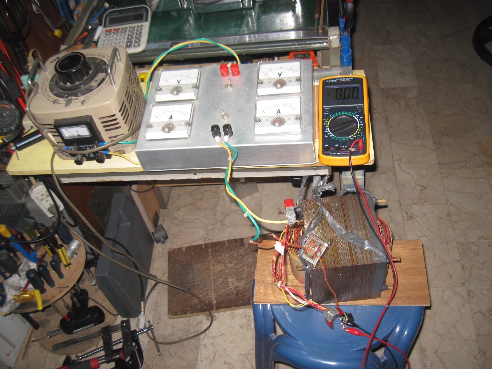

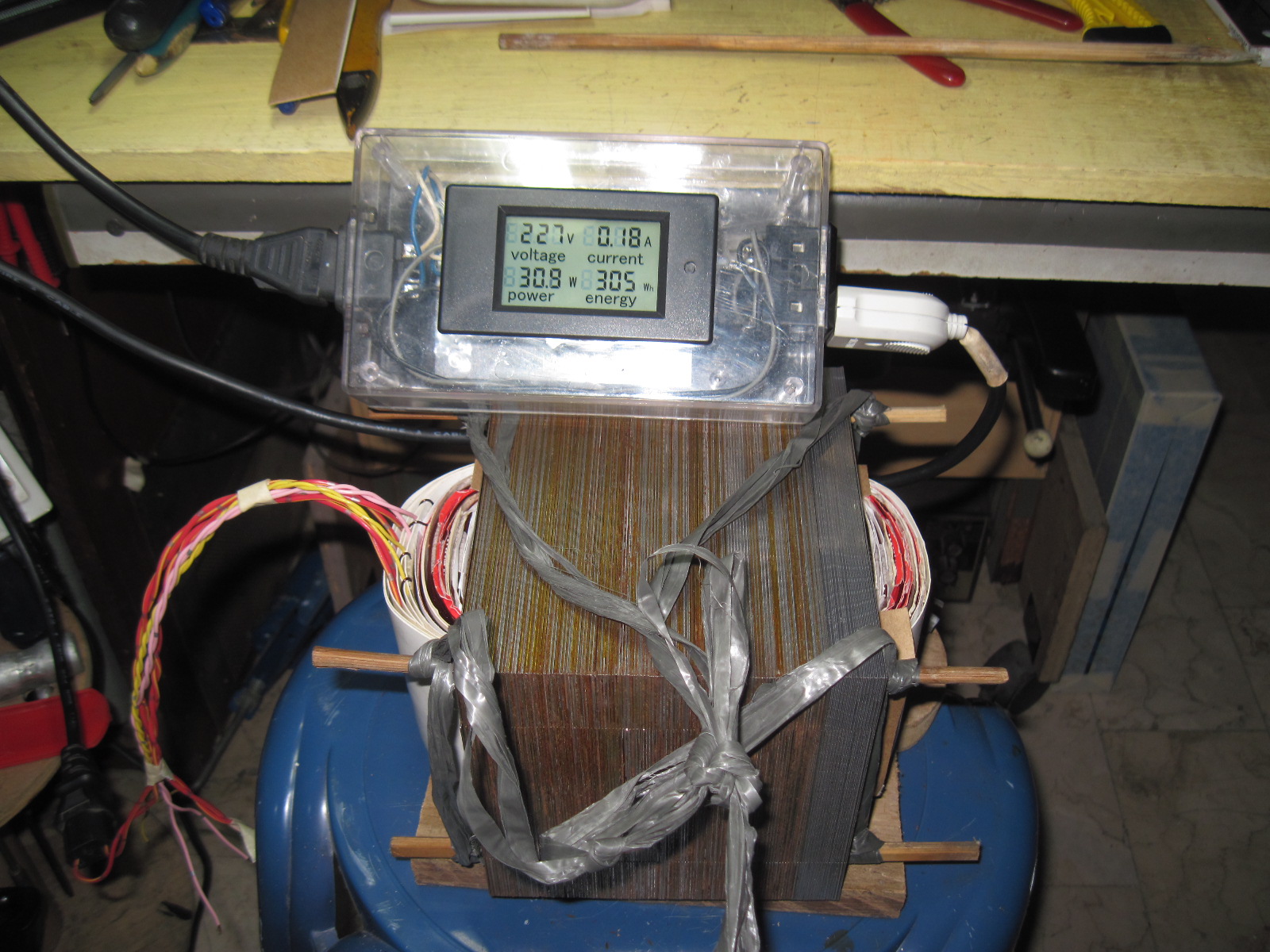

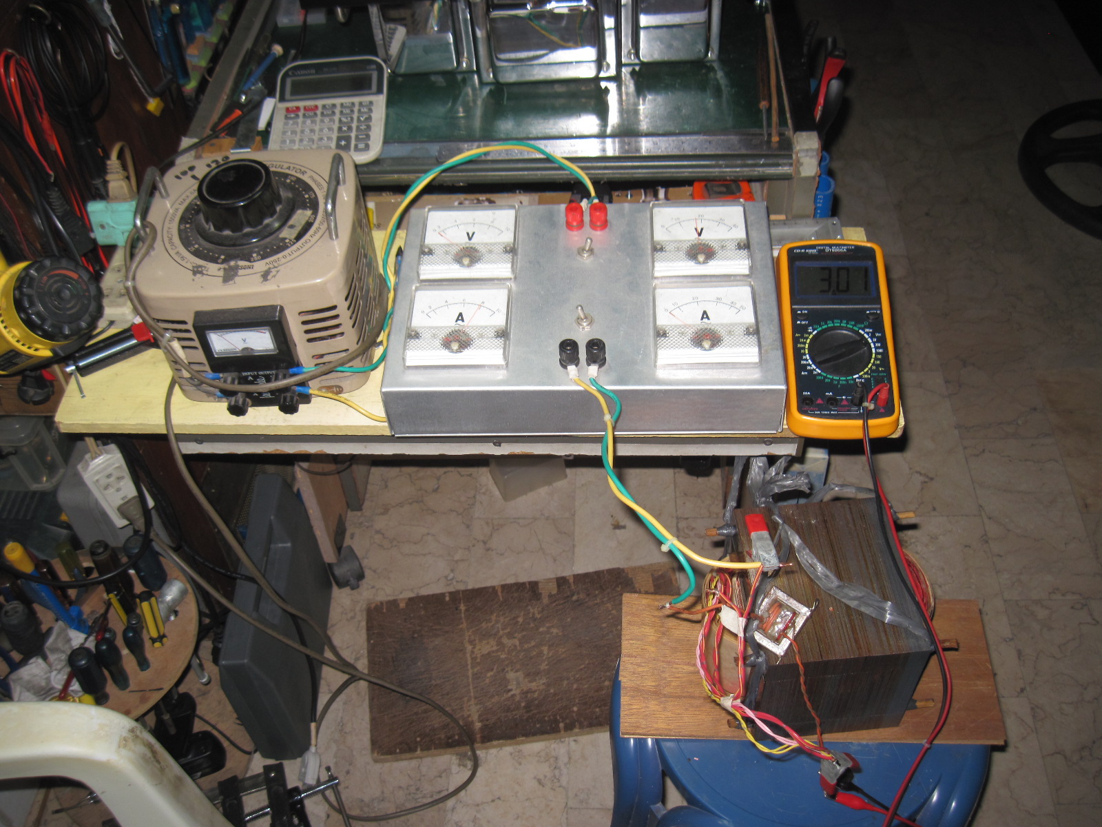

testing my isolation traffo...
open circuit shows 31watts core loss and idle current of 180mA...

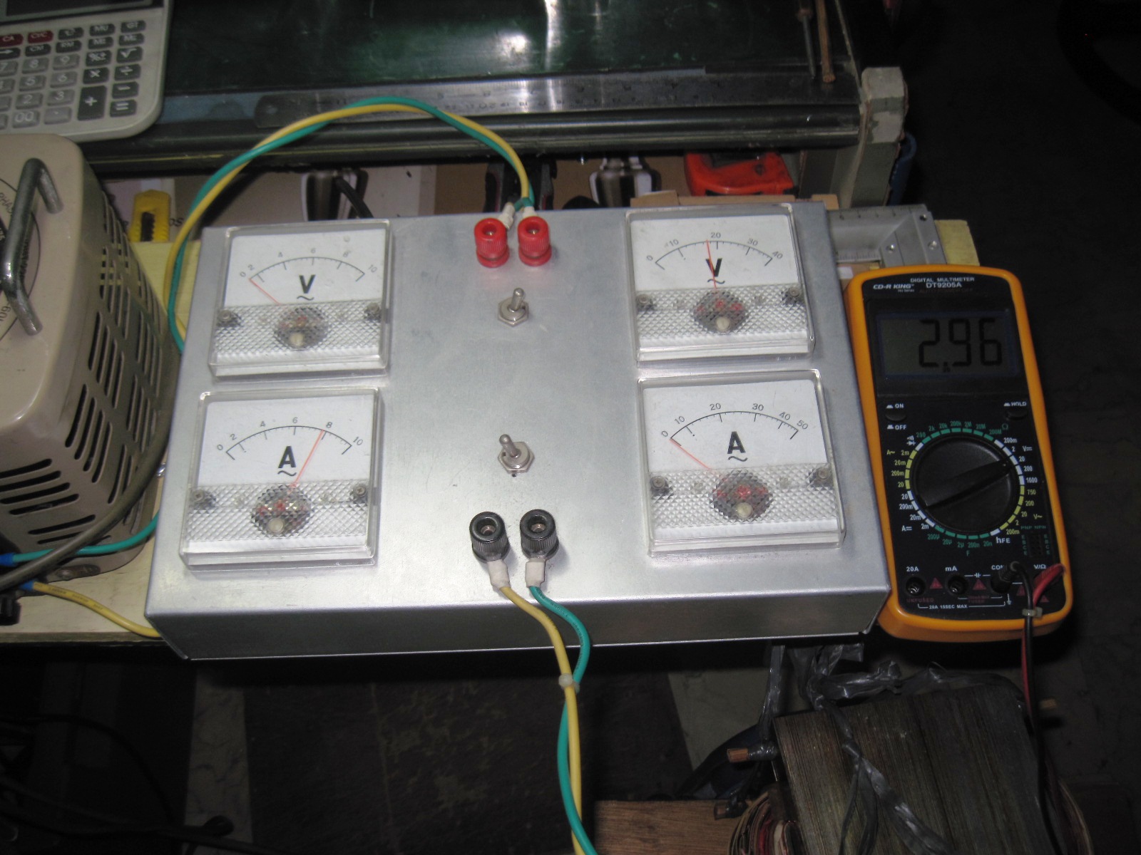

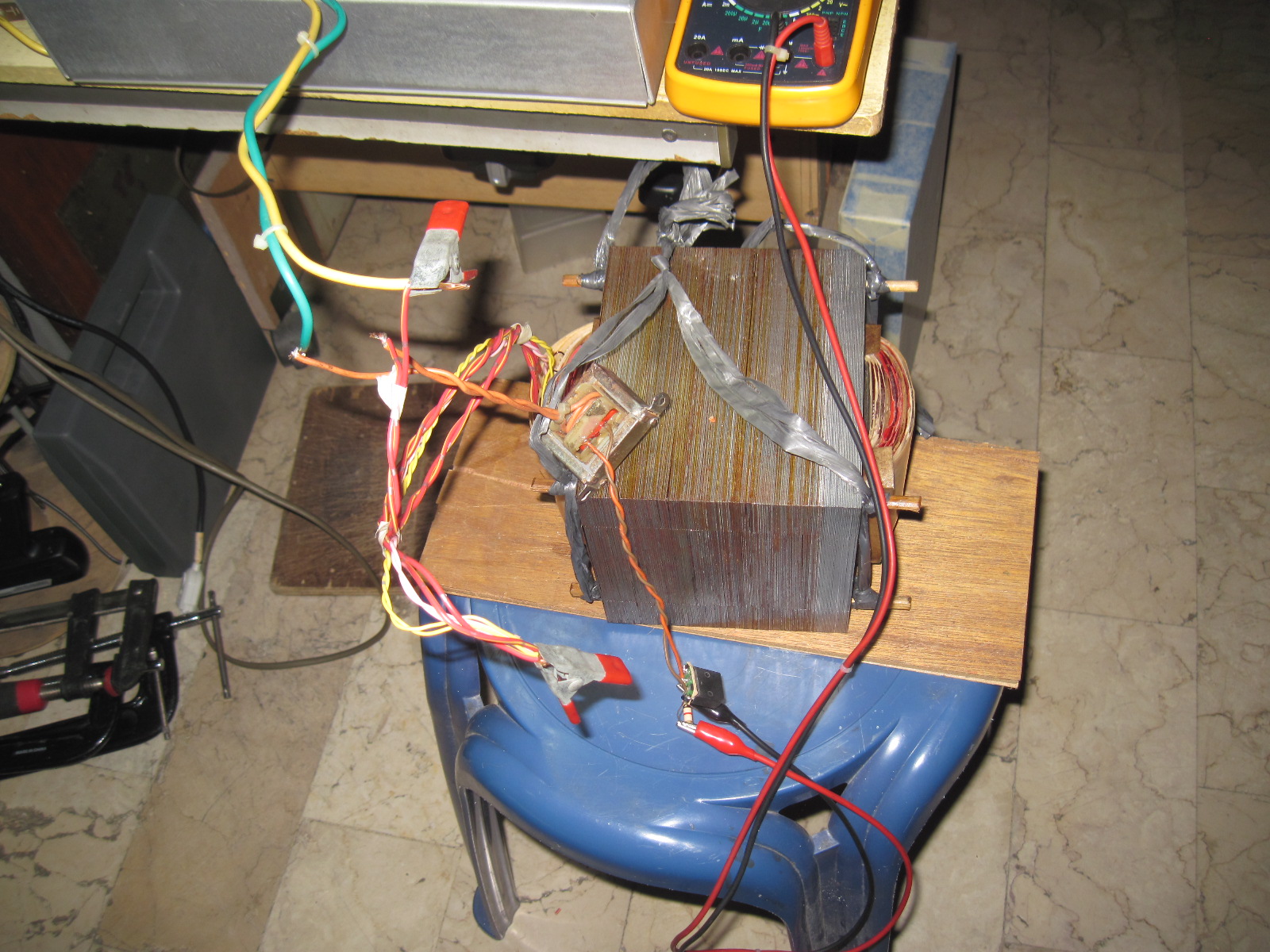

short circuit testing shows copper loss at 8A primary current cause a voltage drop of 18 volts...
a current traffo was put in series with traffo primary winding and at 8A
primary current cause a 3 volt dc drop across a 1k resistor....
this CT will be used as overload protection, disconnecting
the traffo primary if 8 amp or more is detected...
