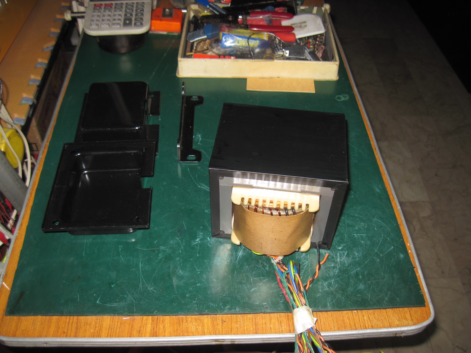

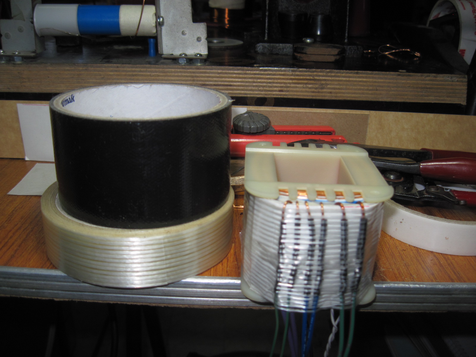

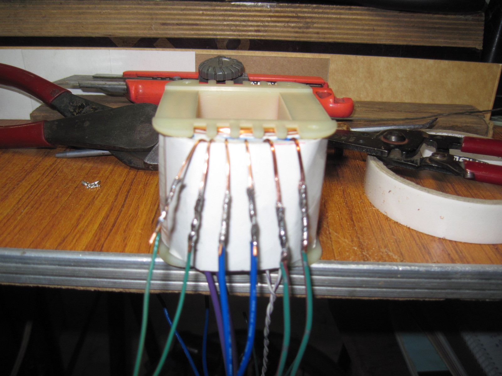

terminating pigtails on a power traffo...

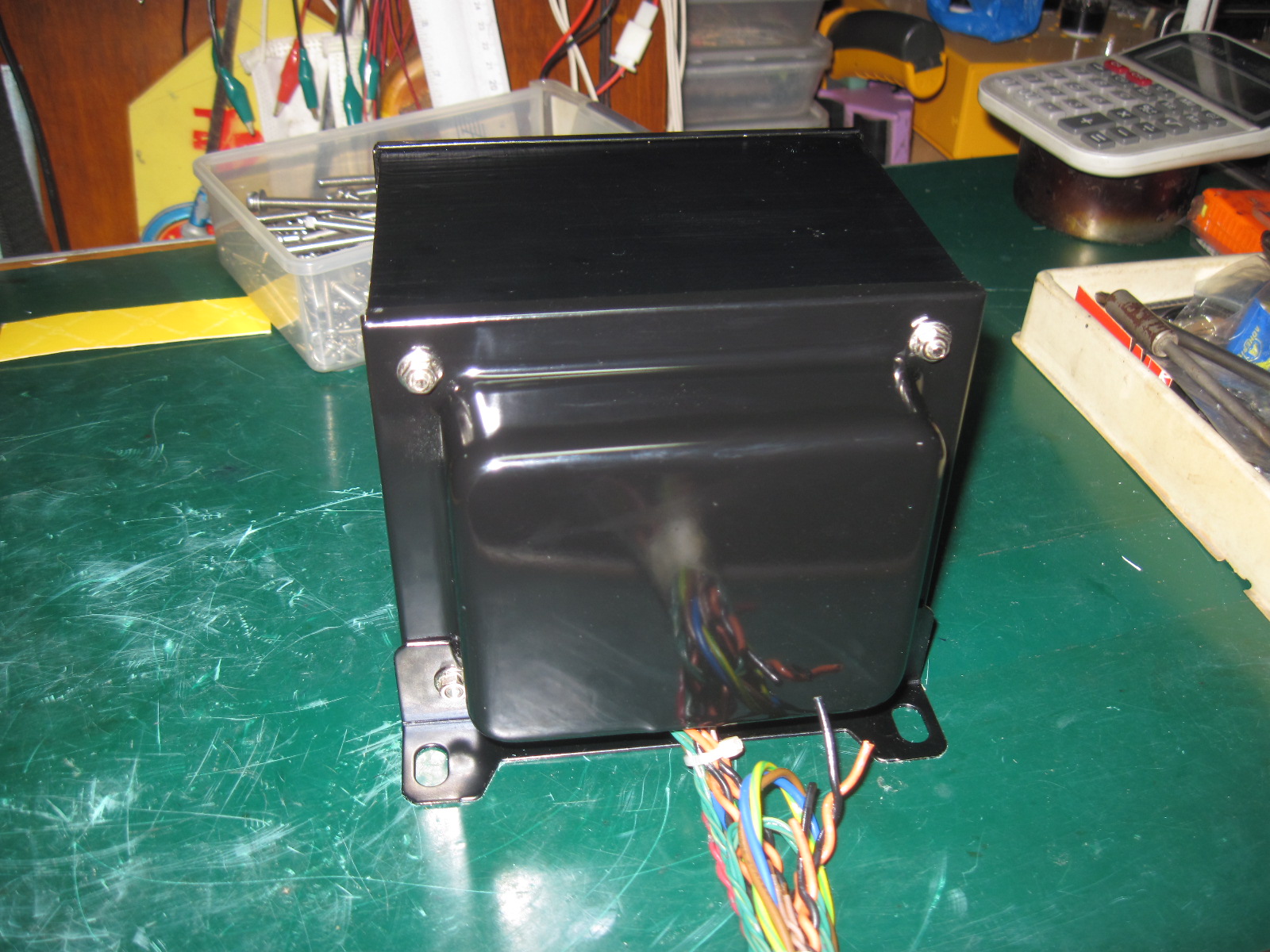

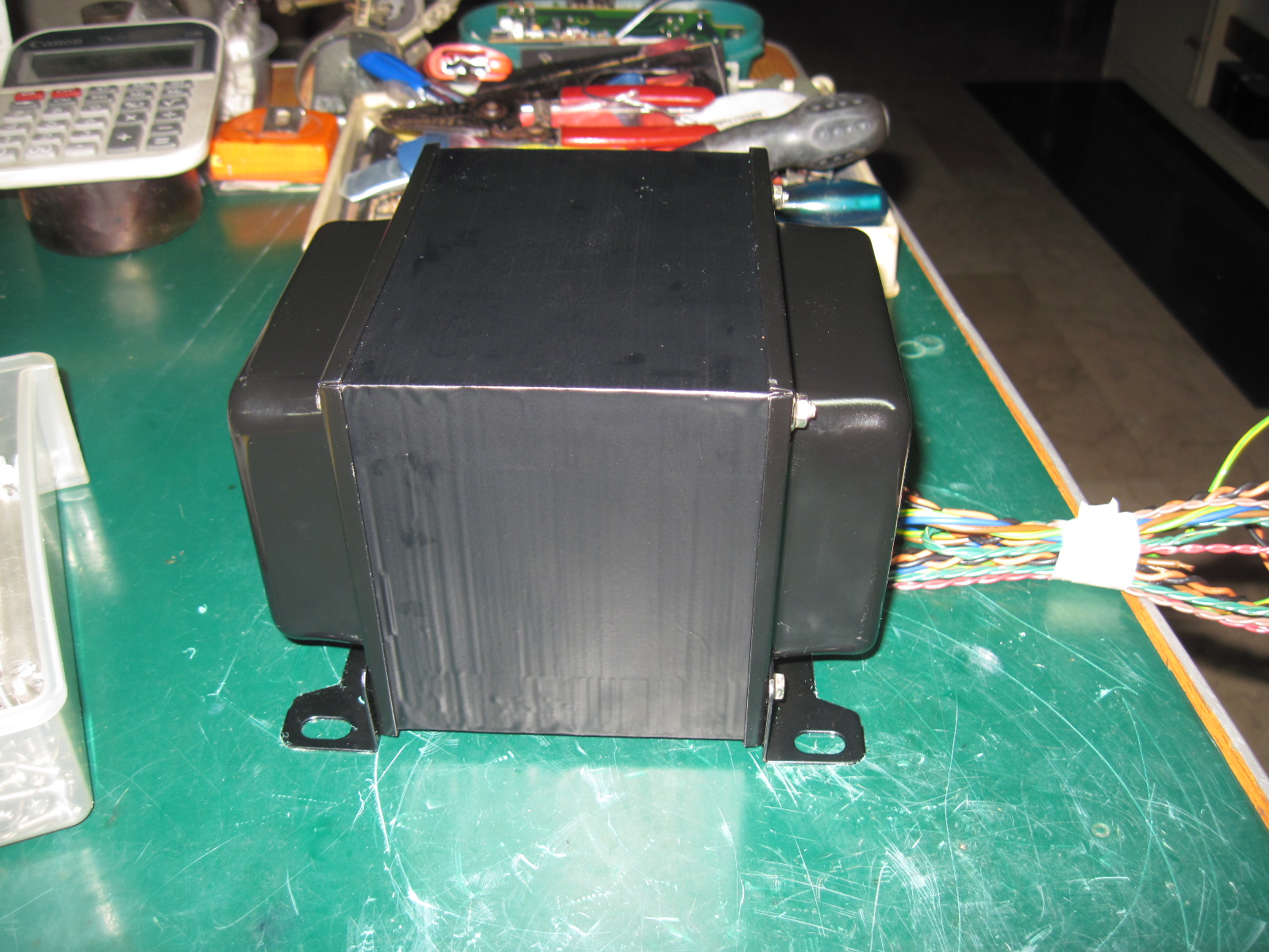

power traffo for 2016....1 3/4 x 4 inches, weight is about 12kg....
will be used in my upcoming 120Wpc 4D32 pp AB2 push-pull amp...

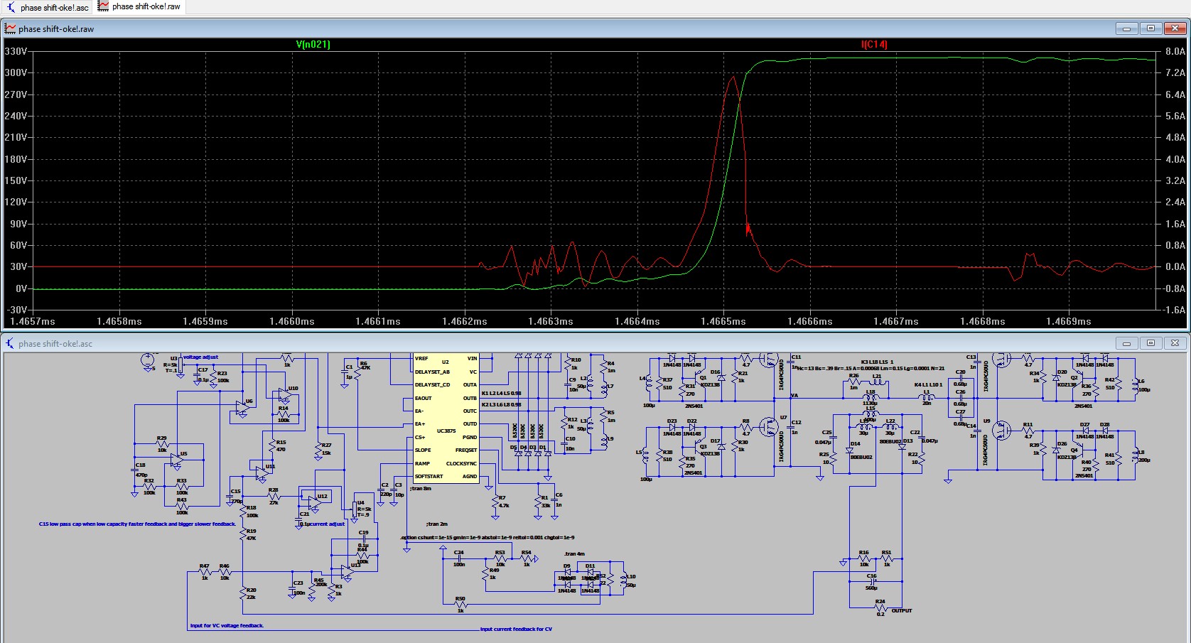

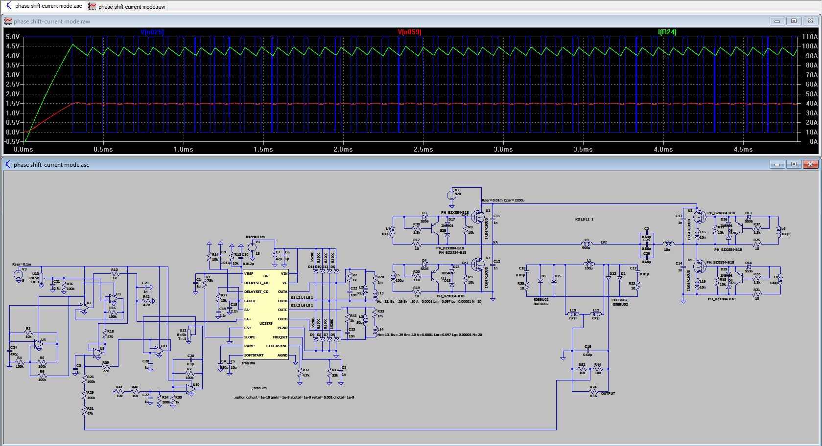

I go smps, busy now with a welder and later for my amps also, resonant bridges have sinusoidal resanonce with soft switching ans so no noise and such.
Picture two you see soft switch, red is cap on igbt and green is when it switch on while cap is charged by unload trafo, giving ZVS.
this examples are fase shift version.
And only as example that technologie of smps is really grown up.
