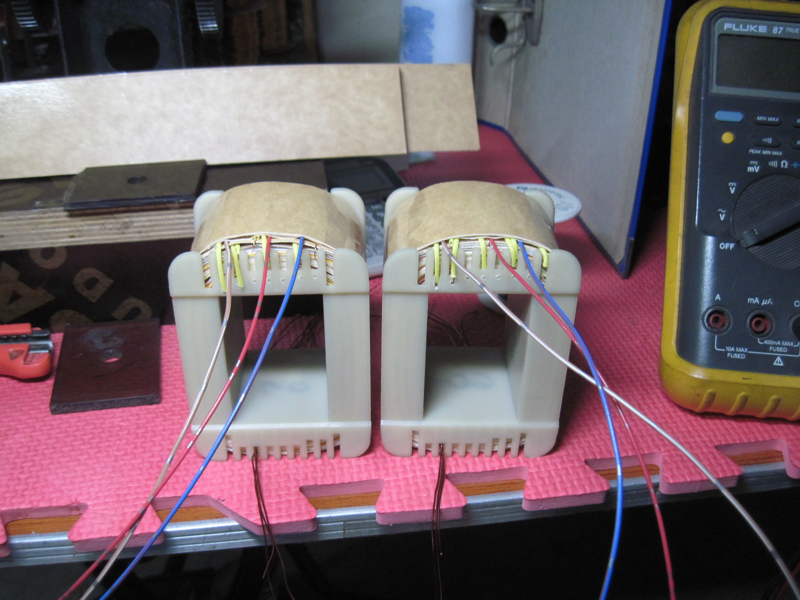

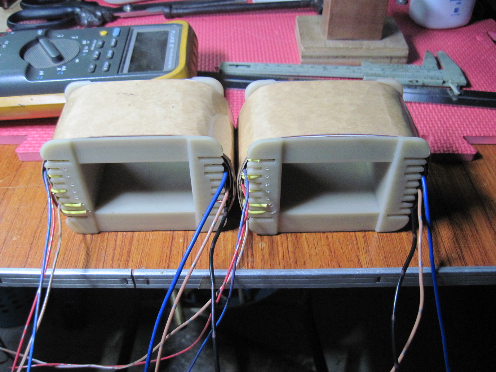

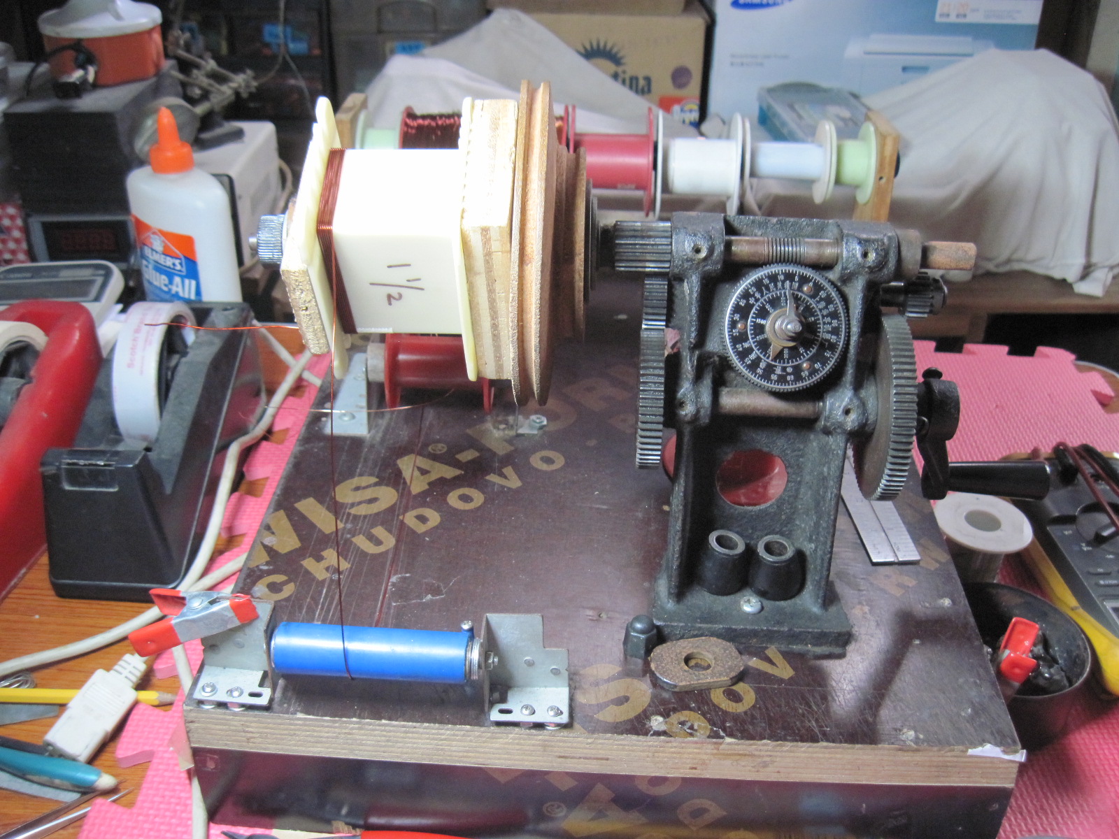

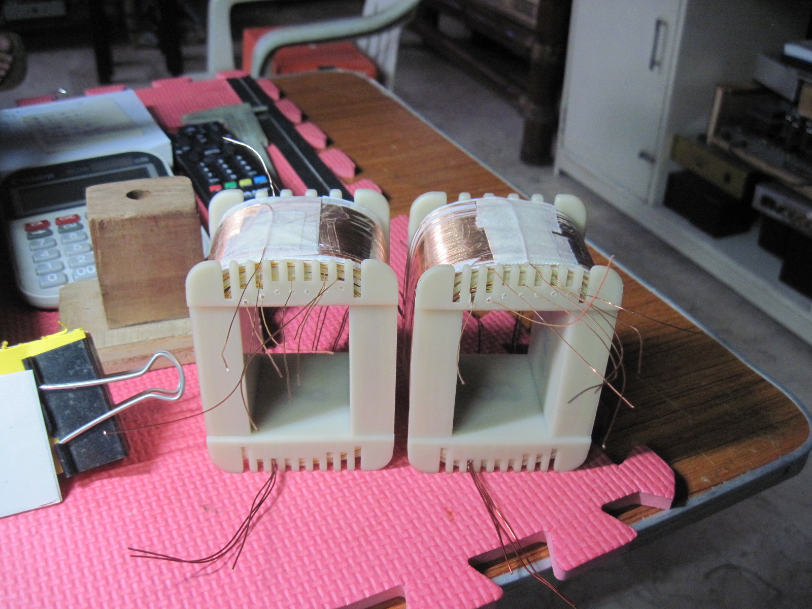

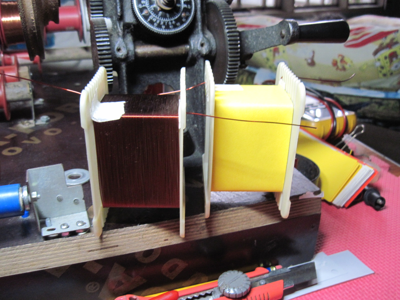

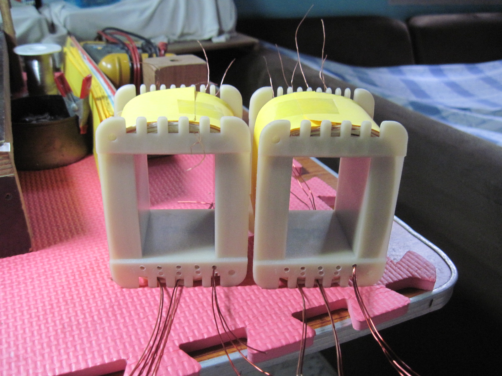

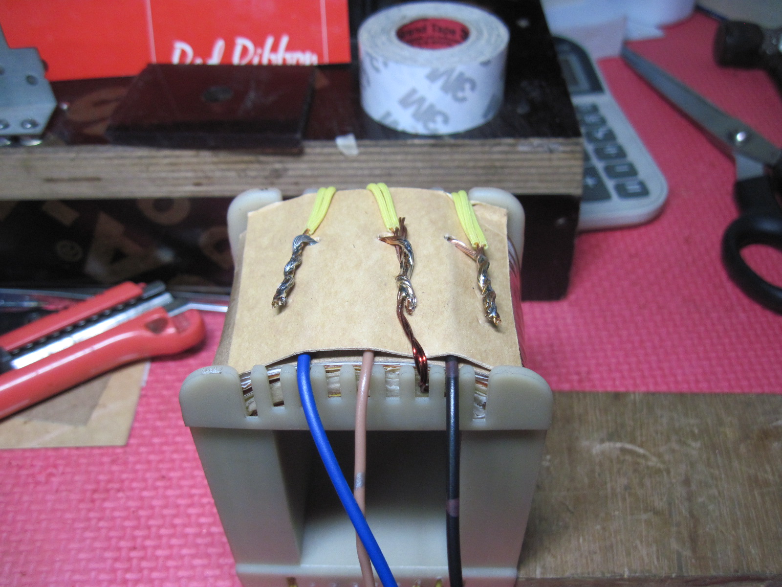

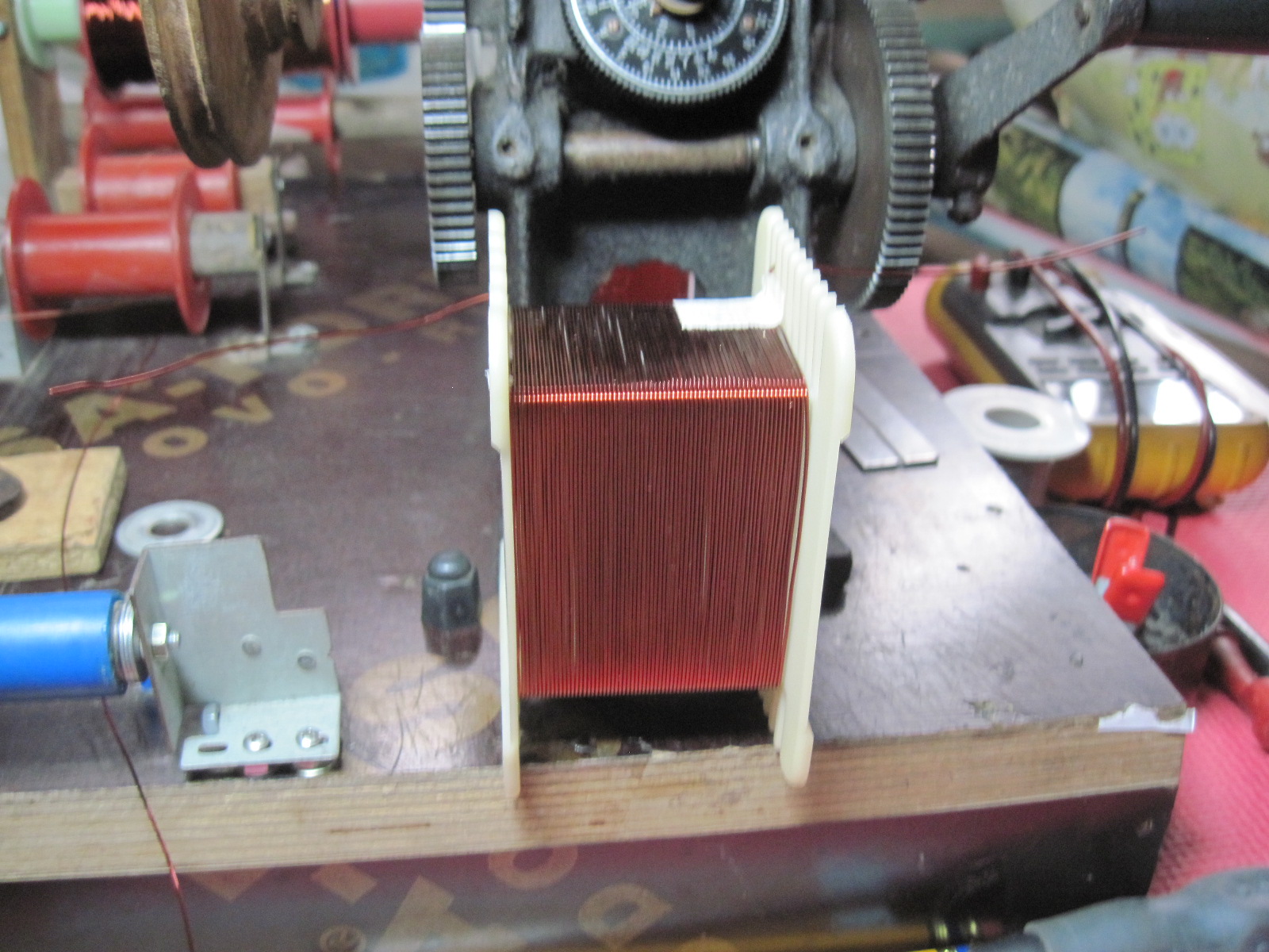

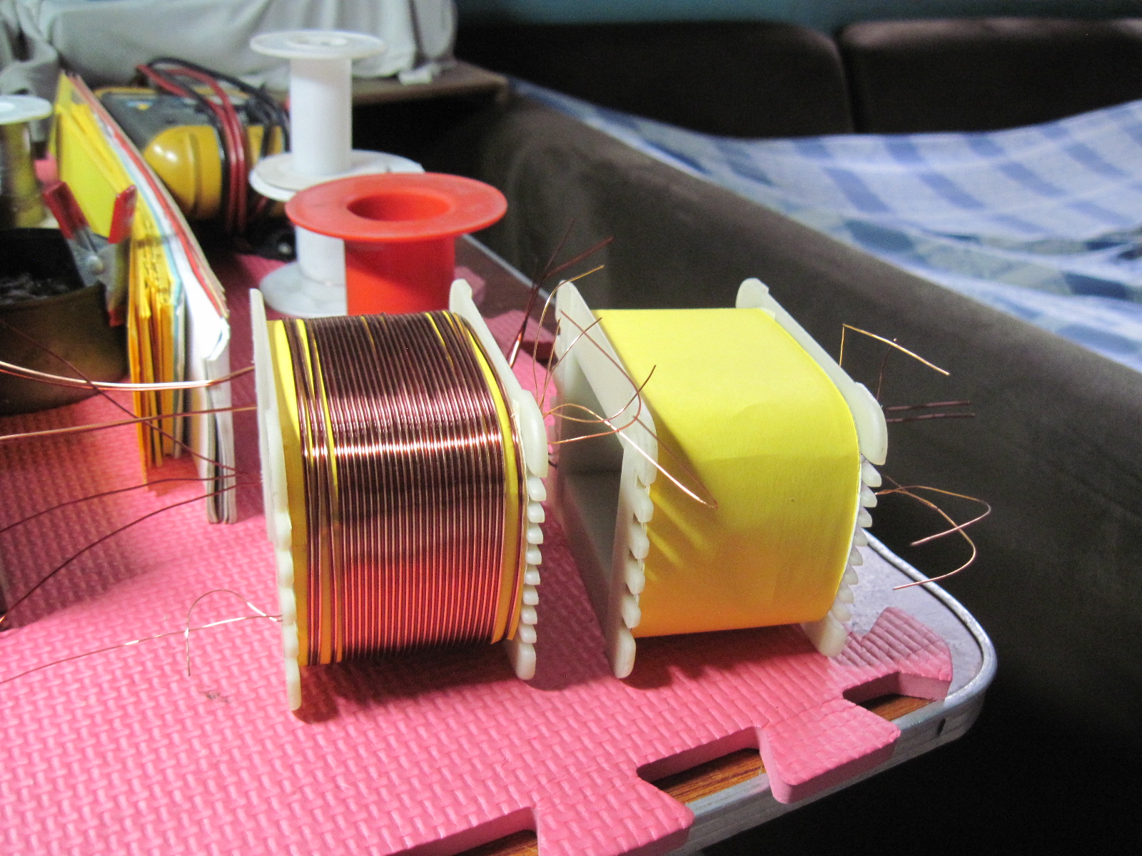

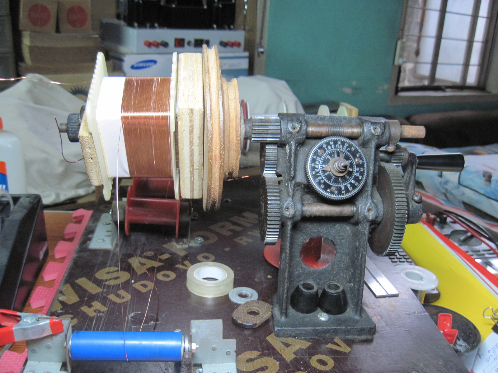

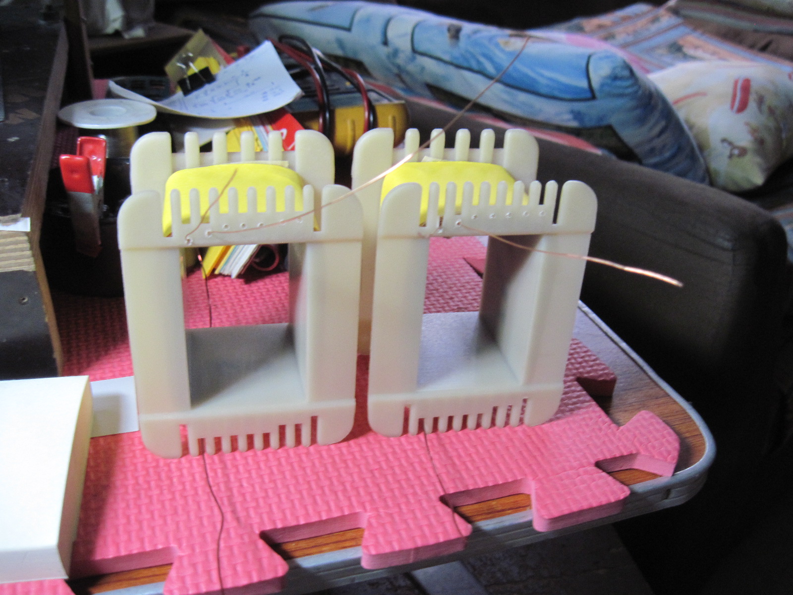

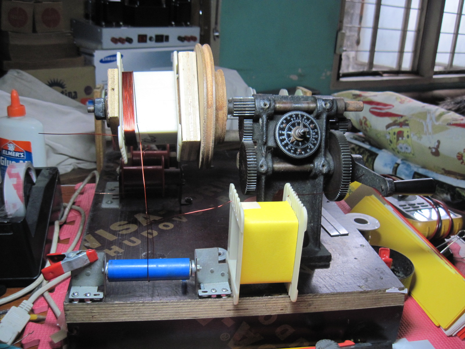

OPT's for a PP 4D32 Class AB2 power amp...
1 1/2 inch center leg stacked to 2.36 inches....

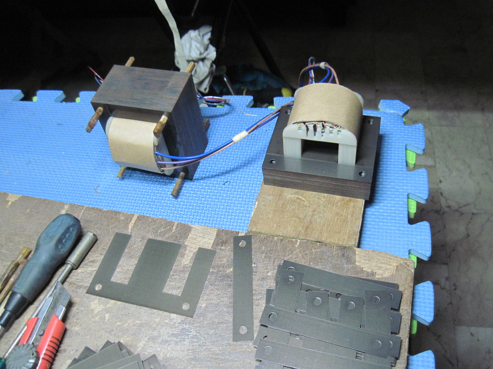

hi, i bought 5 old transformers and i dismantled one, its 3.8 cm center leg 5 cm stack with primary winding around 260 turns and secondary around 44 turns. i wanted to make a power supply for my new project. how much ampere can i get from stacking them together? i also wanted to know the no. of turns in primary and secondary and gauge wire to use.
here are my details:
220 volt primary and secondary 50 volt center tap
looked like those are 1.5 in center leg, stacked to 2 inches, good for about 280VA each.....
if running at 220 volts, idle current is on the high side, can you confirm idle current?
and at 220 volt input output is about 37 volts, not far off your intended voltage...
if you can tell me what amplifier you are trying to build, i can give you further advise....

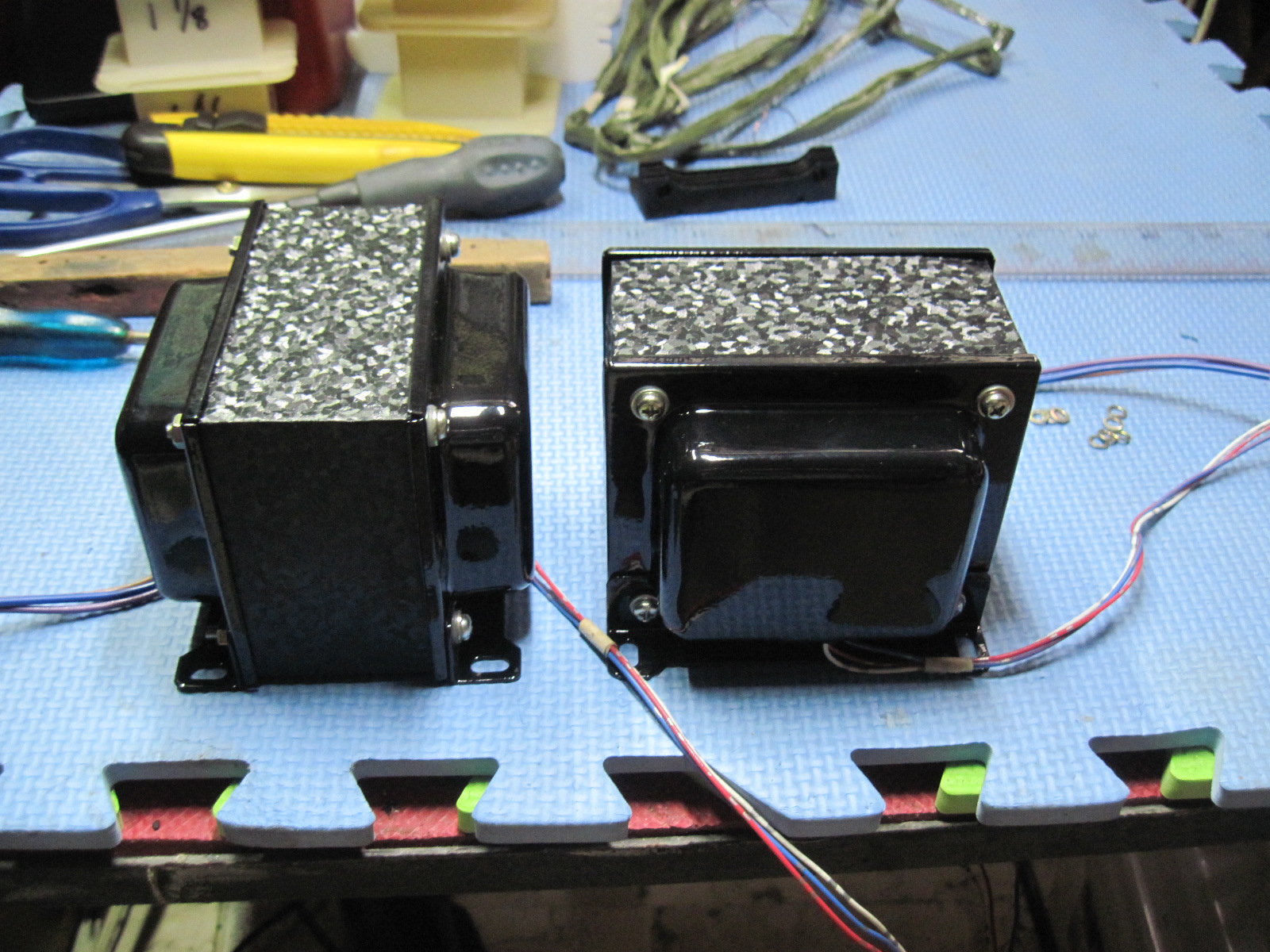

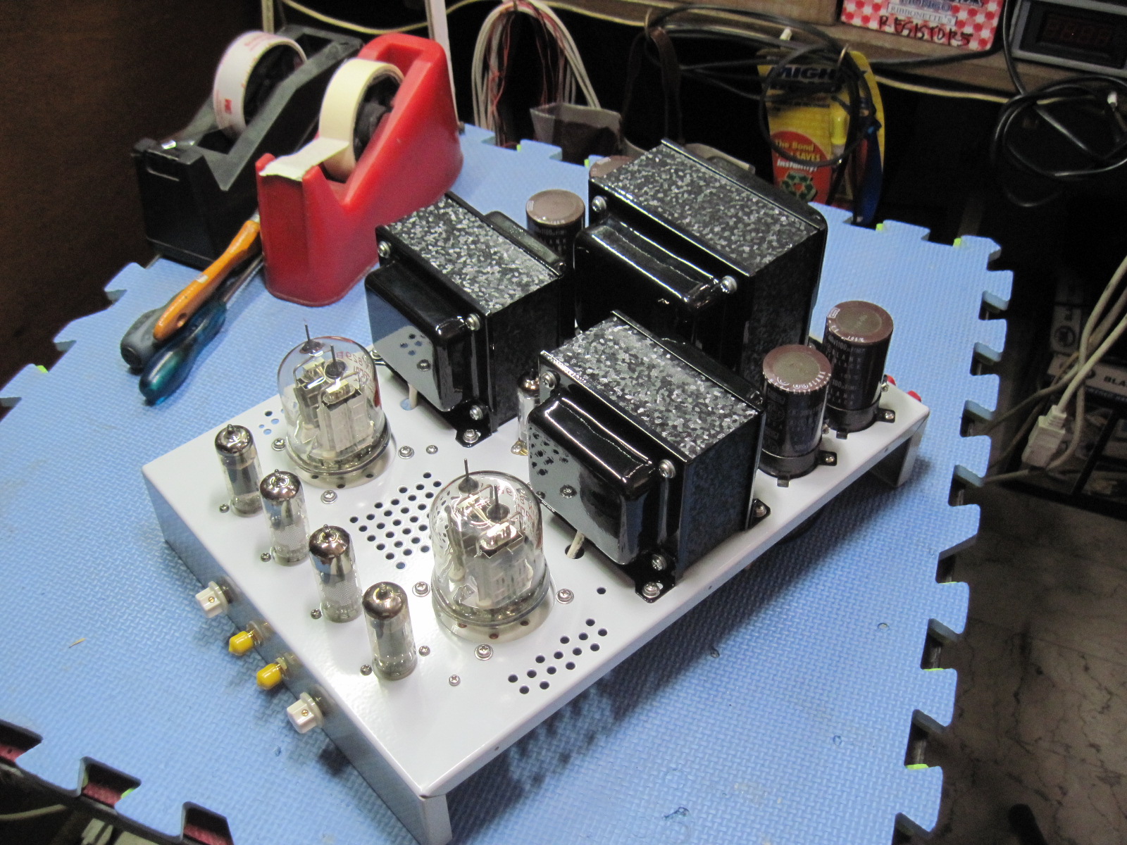

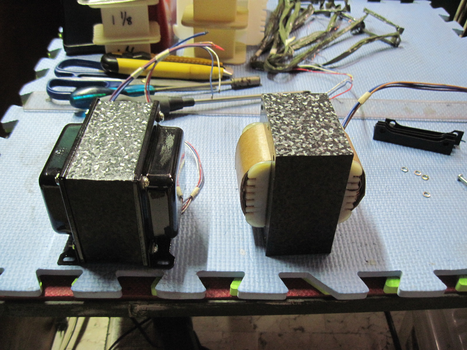

the shape of things to come....two rows on the left are OPT's, the rest are power traffos and chokes for upcoming projects...
a pair for a 4D32 single ended amp, the rest are for push-pull amps..
