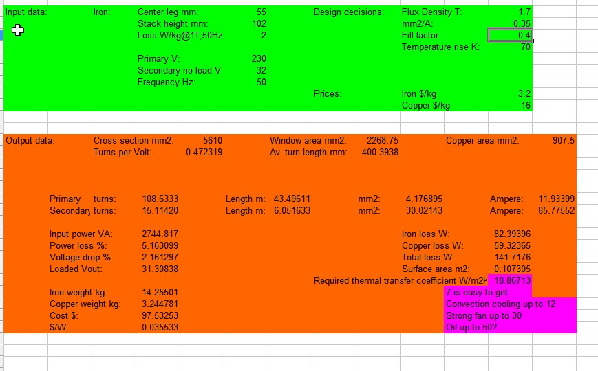

I have seen that the sheet for exel I did download do calculate a lot of possibilities of what is possible. Also it is said that flux density is important for how much I can get out, the laminels of my trafo are 0.5 mm thick and for welding I have read it is possible to use higher flux.
See picture of the calculations.
regards
kees

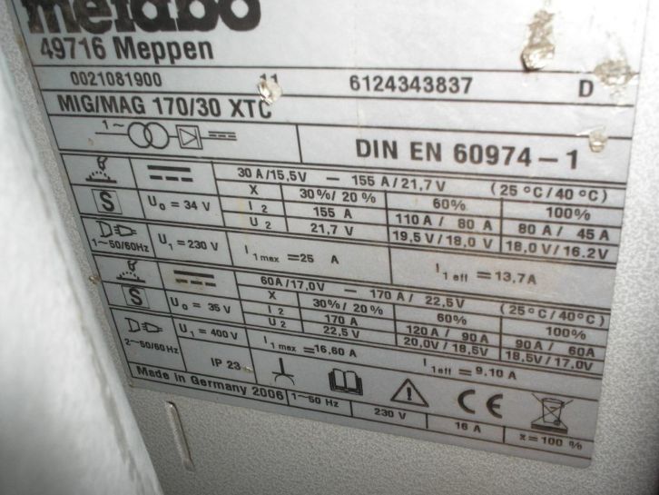

If I did now I tell, I Have it from a scrapyard of how it is called in english.
I think I go for a inverter, I have the core,s, only I need a constant voltage source for Co2 welding with wire, I presume a smps with voltage feeback and current protection (above 130 amp it get in) is the way to go. electronics and pcb is no problem, however what chinese supplyer is to be trusted when order on ebay the IGBT,s and diodes.
I did see with current source inverter that only current is regulated and no voltage feedback make it open.

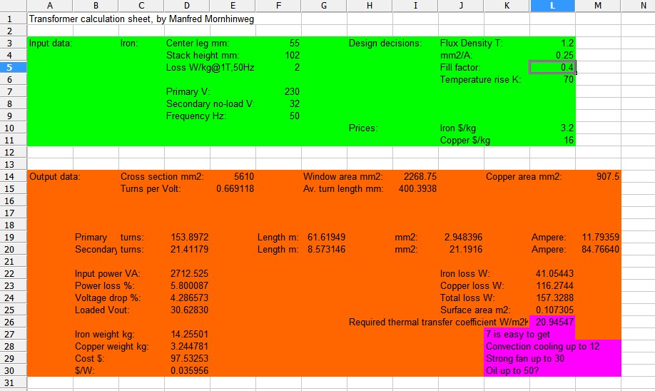

I have calculate the trafo such that I have 140 amps on 21.2 volts like the welder has on manual, now it looks it fit and wire thickness etc is more normal.
I have use a flux of 1.35 T what is used for weld transformers.
program calculates load on output, so I think if i build the thing I get 32 volts open loop.
regards
kees

try a flux density of 1.7T and you'll have much more reasonable results.
most stick welders have 80 volts open circuit.
With either adjustable magnetic shunts for current control or an inductor with multiple taps.
the problem as i see it is you do not know the actual quality of the irons you have in hand, you start winding a primary, then test for magnetising current and find out at what voltage your iron start to saturate, you will need a variac.....

I did calculate it with flux 1.7T and a 0.35 mm2/A (was 0.5 normally but because of welding this is no problem, never continu duty).
This come in the naburehood, I get with this 85 amps and is x 1.8 153 amps, if I am right about it.
I do like the complete formula for the duty cylce because I am dutch it is more easely to read.
Oke with this I also need less copper.😀

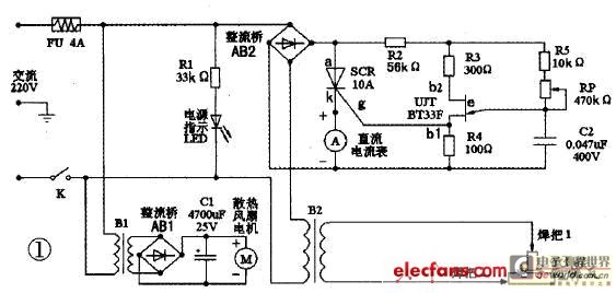

I have a 3 phase rectifier who has T7922-4 diodes on them, I can not find any stuff on google, Can I wind a single fase transformer such that I can do use this rectifier? otherwise I have remove two diodes. I can never reach 90 degree on a slinge fase transformer.
thanks.

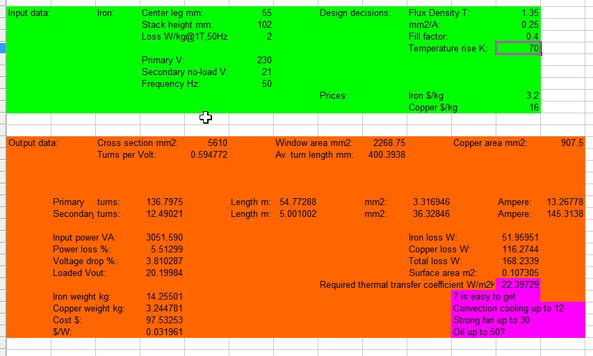

At last I have found a weld trafo company.
These says what to do.
just use T 1.35 for it, that is what she do and calculate power that way is pretty safe, but I think because it is a welder a T of 1.7 do also, but for a SCR on input I go lower and use the T 1.35 and then waiting what it does with unknown core EI core.
I did this before and now again, I go that way I think it is safe and make my bobine also more efficently used.
In the winter when I have more time I go make the inverter in stead and use this transformer for build spot welder.
regards
sure you can....
can you show pics of your rectifier? you can use a 3 phase rectifier assembly using just the two ac inputs, no need to remove the other two, i have used 3 phase rectifiers like those before in ss audio amps like the one below...
but for your needs, you want something much bigger...
i see you want to vary the primary voltage, this is a neat circuit to use...
and the dc ammeter lets you monitor current...
For work on a car with thin metal this is nice to use. Chinese have somtimes good idea, I need a big rectifier there I gess, trafo is in serie with it.
the SCR of 10 amps, well, that is chinese, it blows.
The 3 fase rectifier is the same as you let see in the picture, only I have some cooling ribs on it, big ones.
I have seen that two diodes are not used, just uses it as a single fase rectifier,
