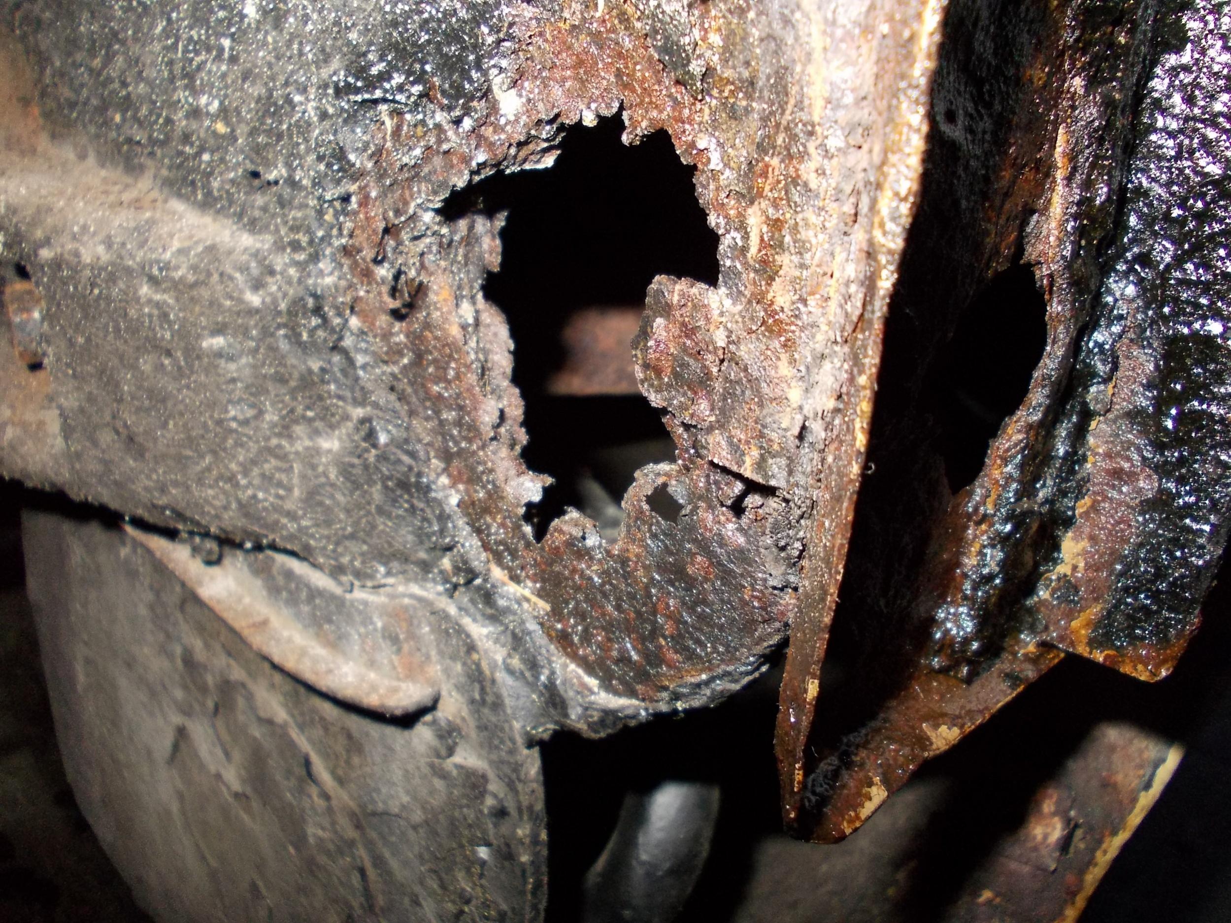

The P6 is mostly aluminium, if I remember correctly.
Stick welding will not be easy.
Ehhh no.
lot of iron, only boot door and bonnet is aluminium wich are fine..
the rest rust best..

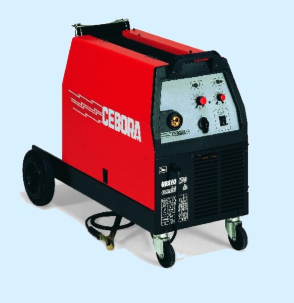

I do not stick welding, do not work, I have a cebora co2 welder with gas, that is where the trafo is for, I did buy the thing without trafo for cheap, so the rest was present and works, I am starter the dismanteling of trafo, heavy to do with al the hars, it is impregmented with that stuff, I keep the lowest 100% weld amperage as start, I think that is best, that is 85 amps.
Still I do not now about the square root 1/30% is 1.85 machine is 35 procent with 145 amps, max is 195 amps 20 procents.
The formula for the duty cycle is how you get 1.85 out of that, I am dutch so technical english is now as well.

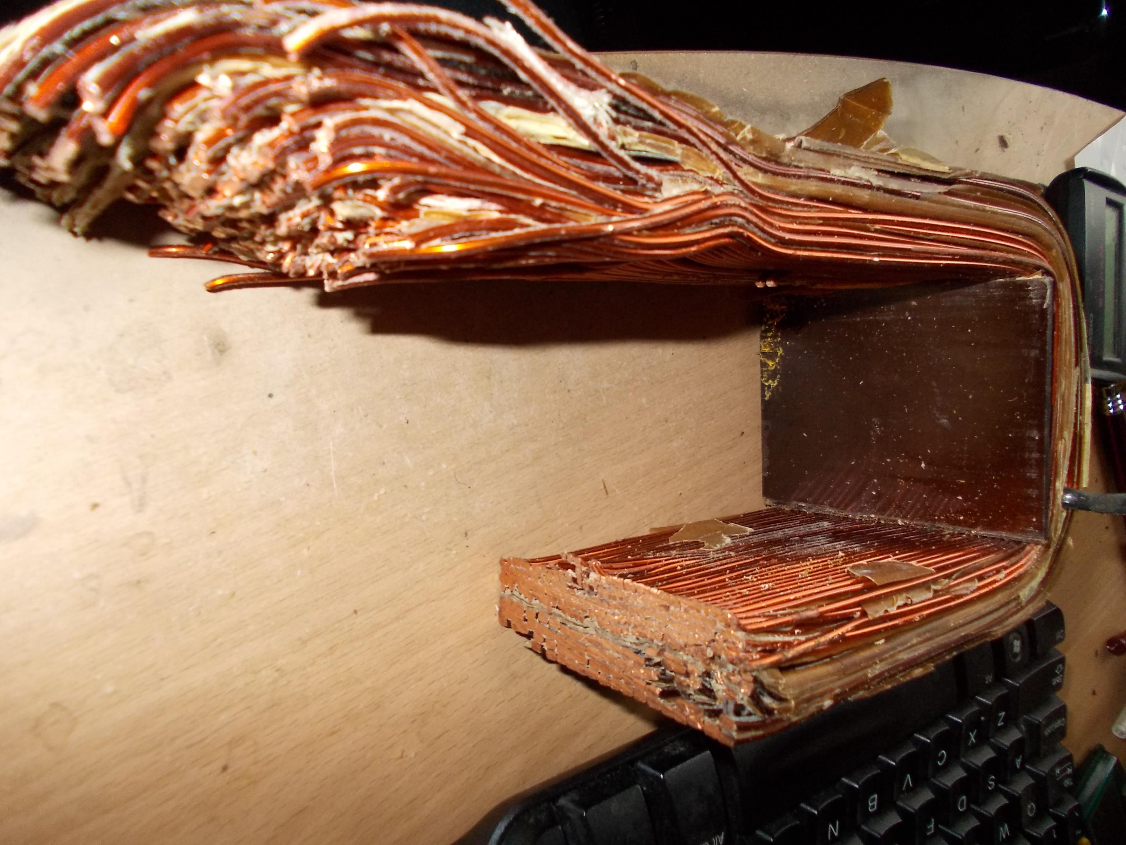

I have try to remove laminels but the epoxy is real tight, damaging laminels, I have to cut open the coils and now i heat the metal for removing, also windings are impregnated.
and heat will maybe help our not afcourse,
thin nife help also.

Wel everything is done, the coil is damaged because the resin was very strong
windings are sticked to each other damaging the insolation layer when remove.
But need a new bobine and wire.

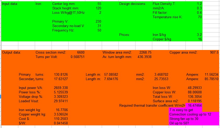

Here I am again
I have calc a transformer as test, I get it at 85 ampere 31 volts open connections.
But what happens if I go weld with it so without a regulator, go it then go to max ampere because of the short circuit what happens, and so have a suitable transformer.
Or.
Have I calc a transformer who is 140 ampere 31 volts open, but I think when go welding with this i get extreem high amps and trip the breaker.
Therefor I have calc 85 amps, what makes 140 or more 20 % weld current.
I see with trafos who has a switch and tapped primairy windings like in Co2 welders
that when on lowest setting somtimes as low as 10 ampere it has less dutycycle when set higher amps, this is only from primairy where the flux that way get very high when set on highest amp setting and so less primiry windings.
I have not this I use a regulator so current get lower from 85 amps open connections 31 to 15 volts.
Please let me now If I right, finding weld transformer calculators is not easy.
Have included a sheet calculation 85 ampere.
regards

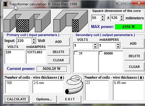

square root 1/30% is 1.85, this you tell me, and is 76 amps, I see on machine 100% is here 85 amps 18.2 volts, maybe it is a idea to use this seen the short cicuit action of the welder.
I have calc with this software also, see picture.

watts follow current squared.
square root of 1/30%? is 1.82.
If you want a welder for 30% duty cycle at 140 amps, it needs to be large enough to supply 76.6 amps continuously.
but under what temperature rise? most stick welding is only 100% duty cycle, if you count 1 hour of continuous welding.. i mean you're not trying assemble a bulldozer in 1 week are you?

I have now the idea that I have find out how, it is the surace of the wire used, it do match with yours when 120 amps continu, for lower duty cycles the wire is just thinner and core sometimes smaller.
I have now seen that when I use the machine 100 % amperage and use this with the open max voltage I am where I need to be.
because my machine was a three fase with 170 amps (is close to 30% duty cycle when 85 amps) I can not use the 100% current for the new trafo and so I use your 76 amps for 30% on max voltage (32 volts), and I need a stabilization coil for after the diodes and big elco,s.
Bigger wire for 100 procent duty do also not fit, yours is a bit bigger with 22 kilos so that big enough.
What I get from program is for 76 amps 32 volts.
primairy 168 windings 2.5 mm wire.
secondary 24 windings 6.1 mm wire for 32 volts, (I need some more for diode rectifier 1.2 volts but because of elco,s proberly not needed).
stabilization coil is 30 windindings 6.1 to 8 mm wire on core with airgap. (without you can not weld with it).
