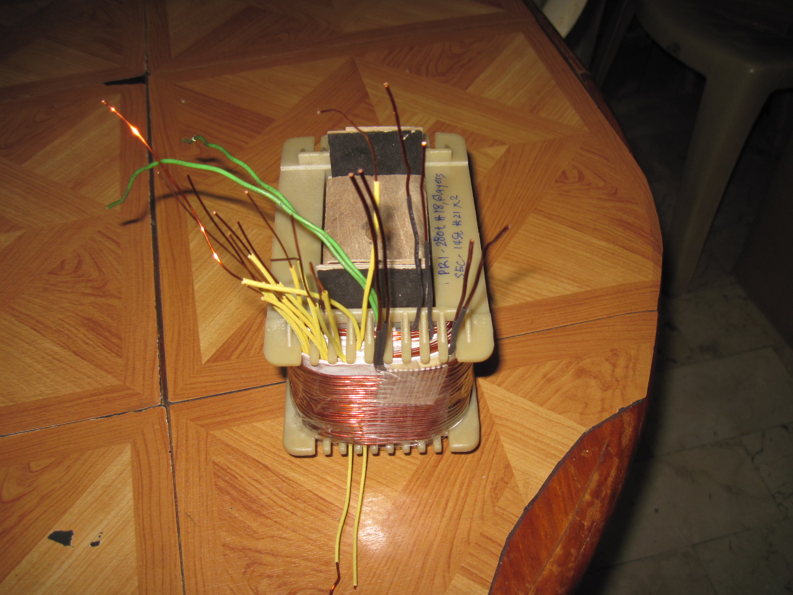

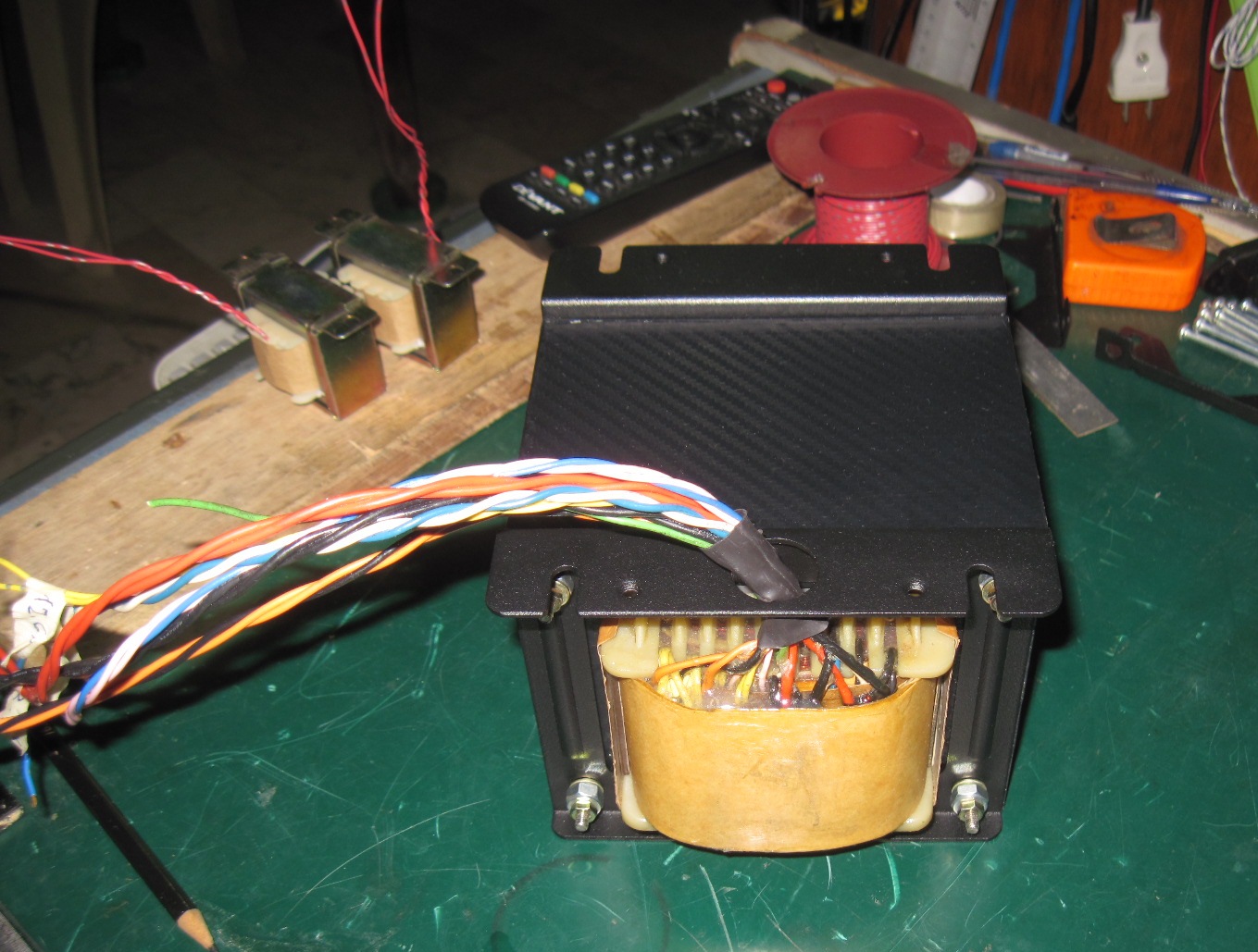

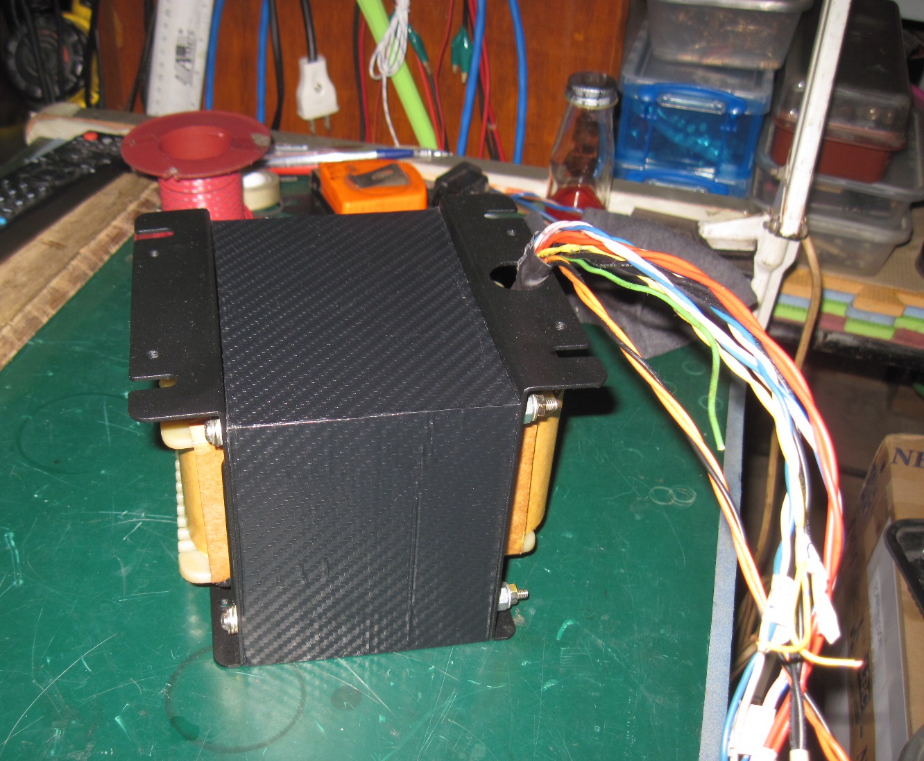

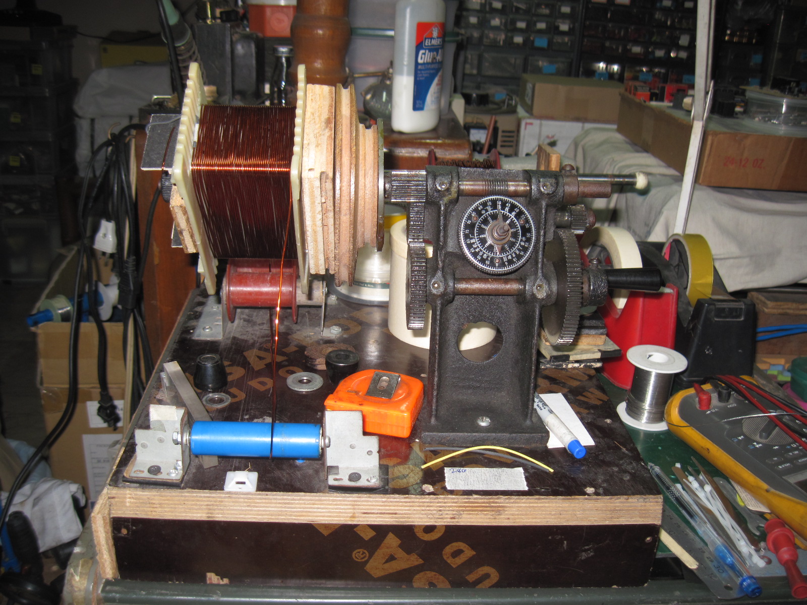

new traffo builds...heat index here can reach in the 40's..

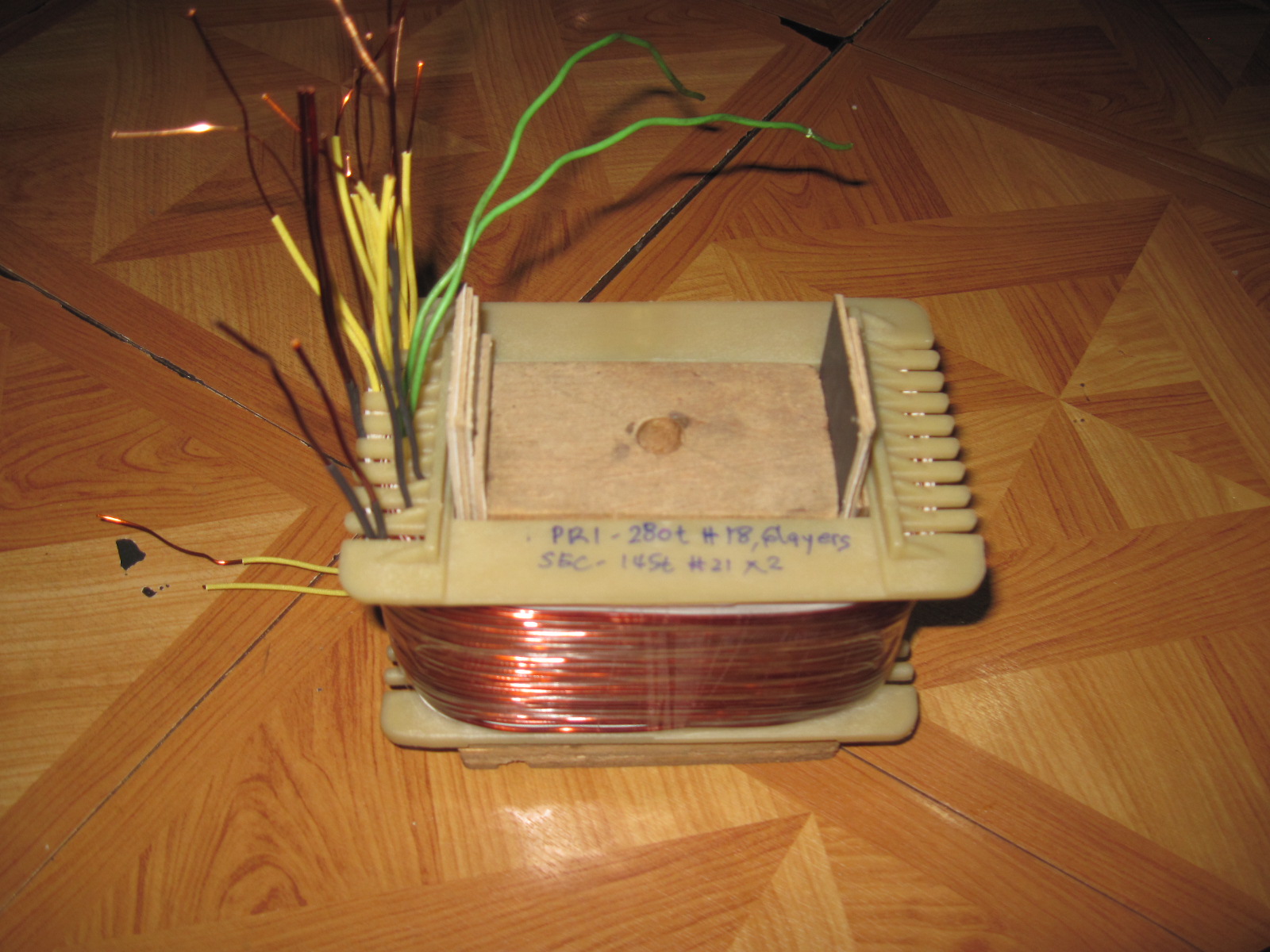

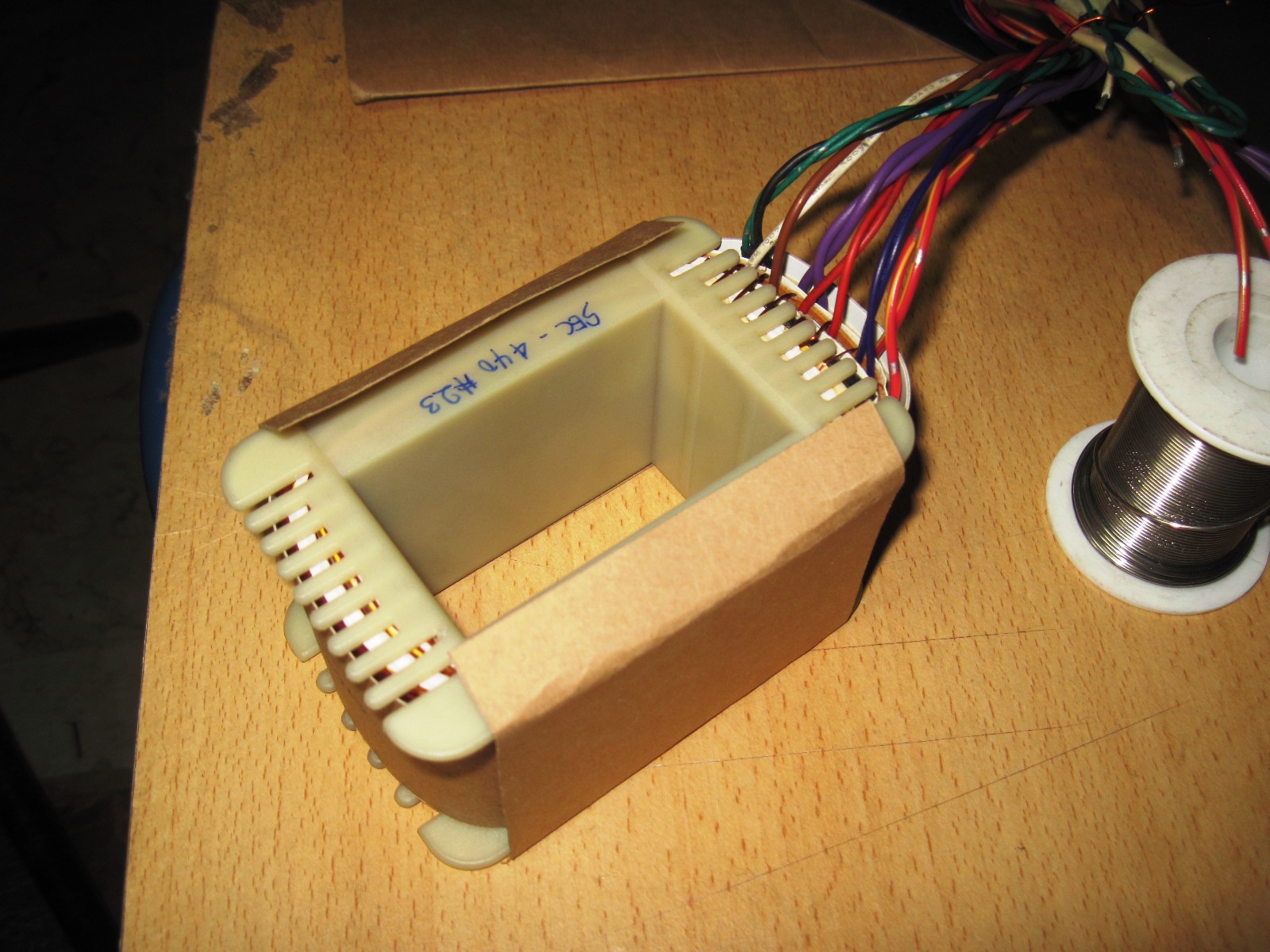

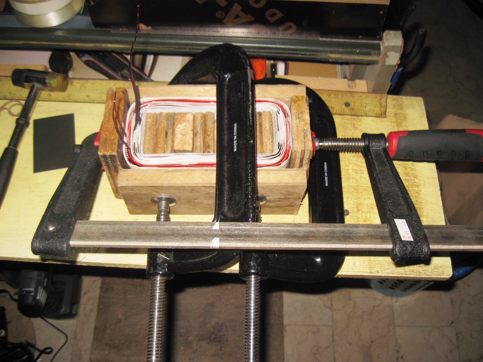

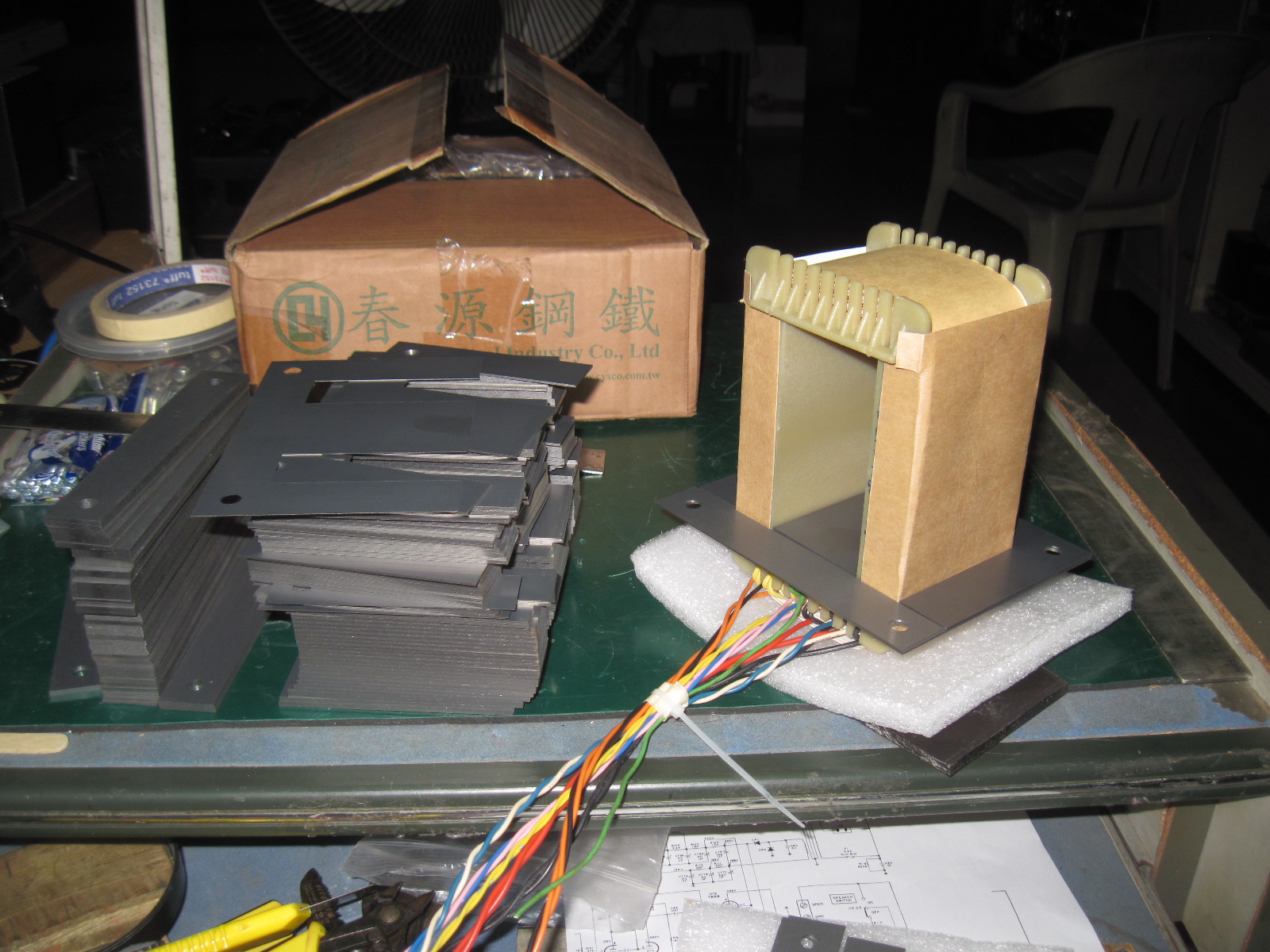

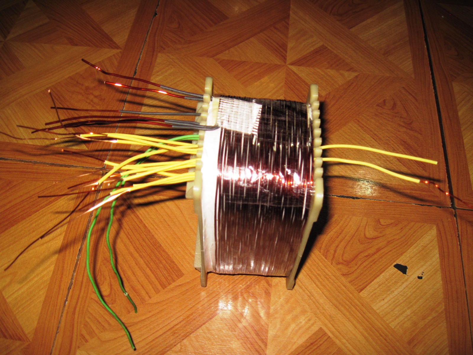

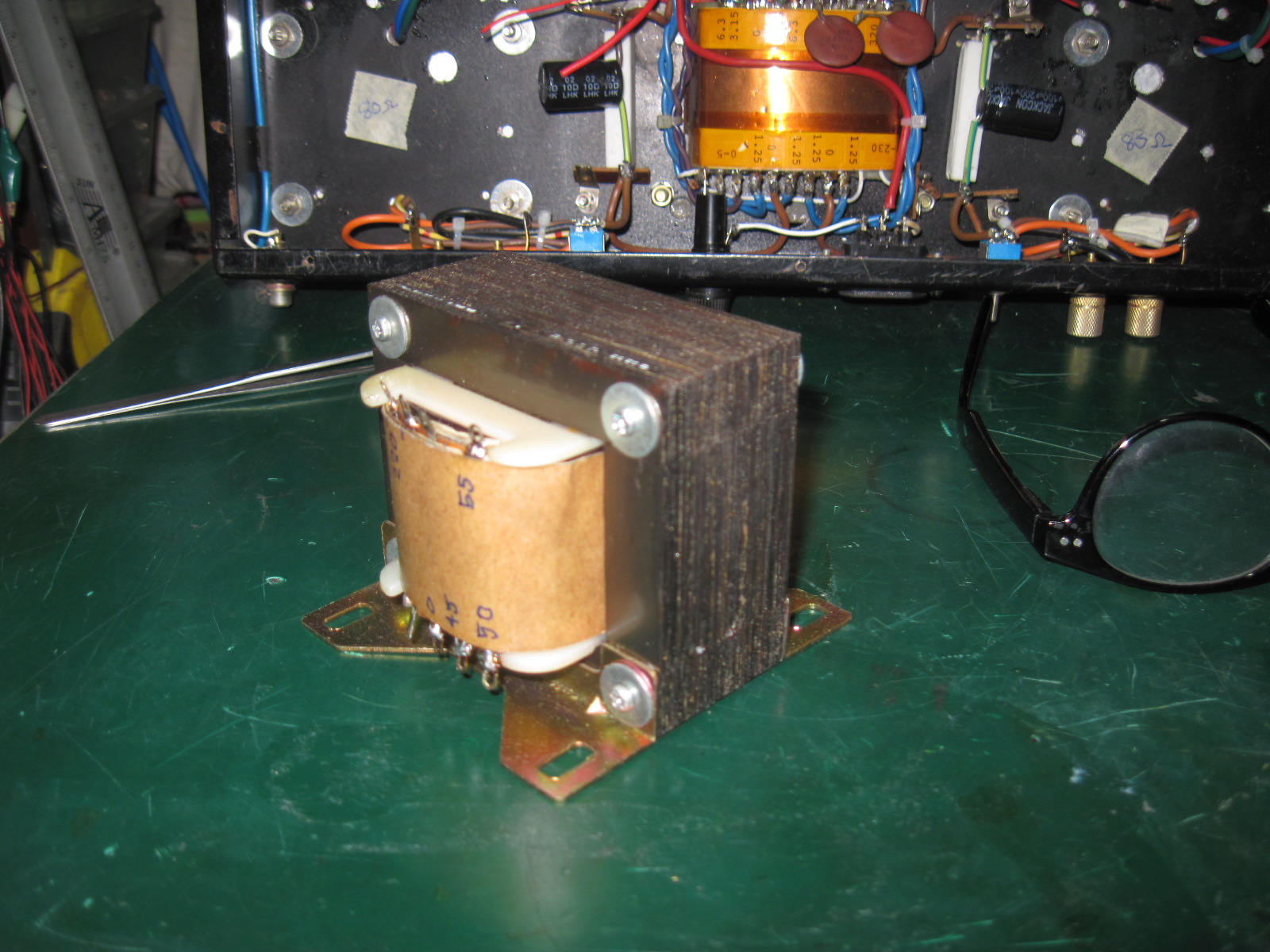

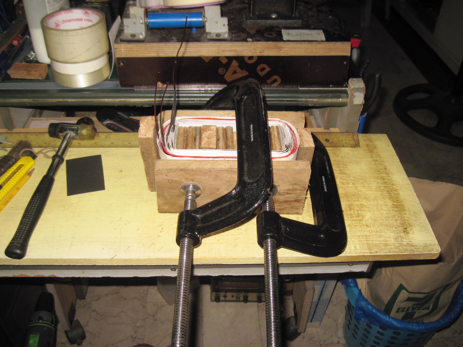

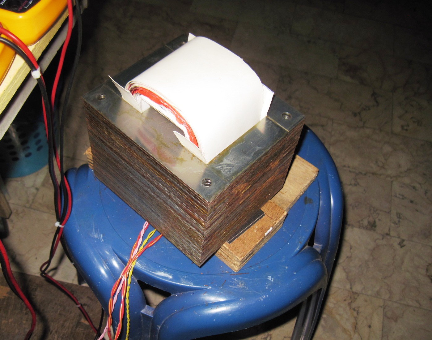

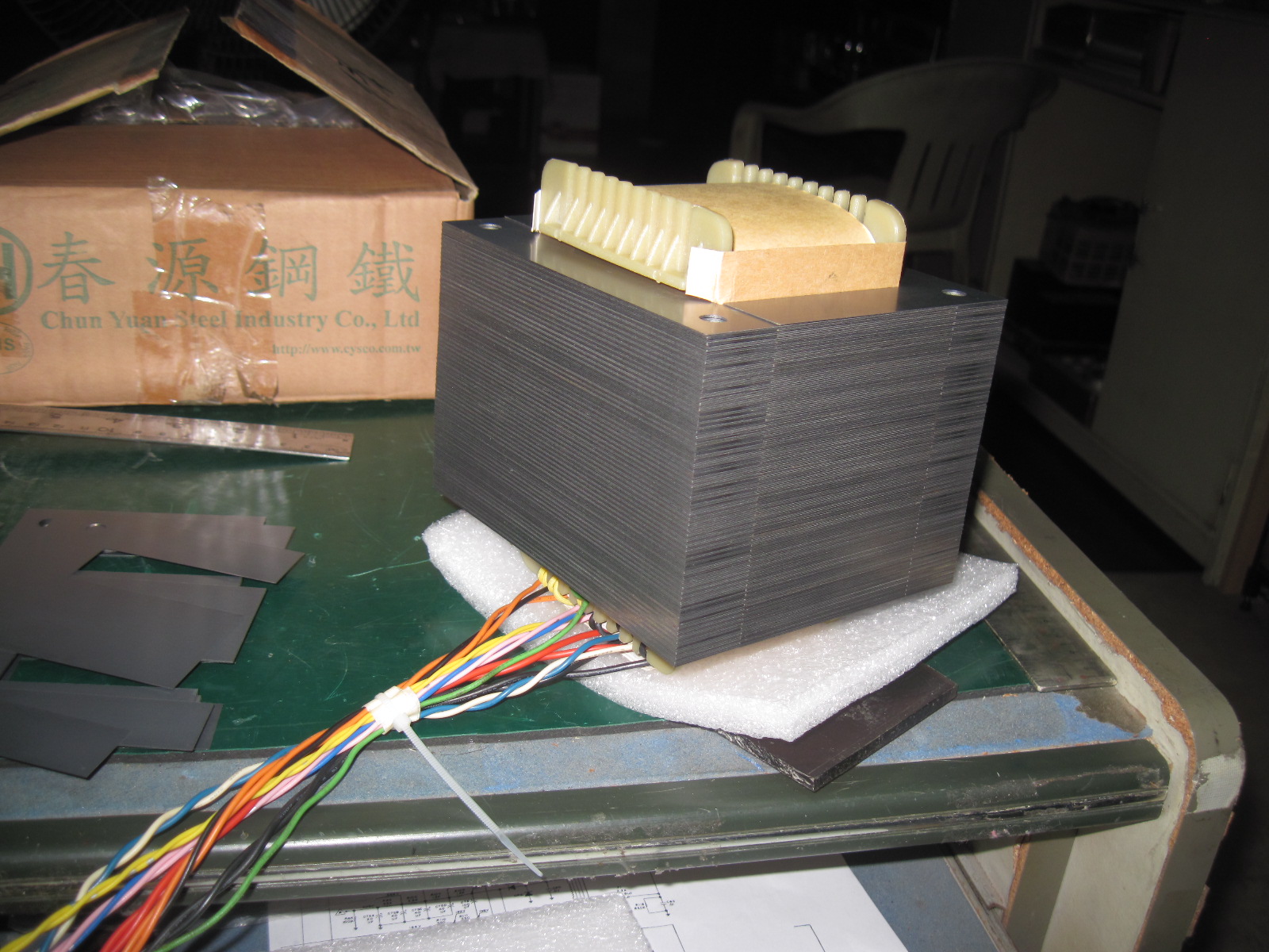

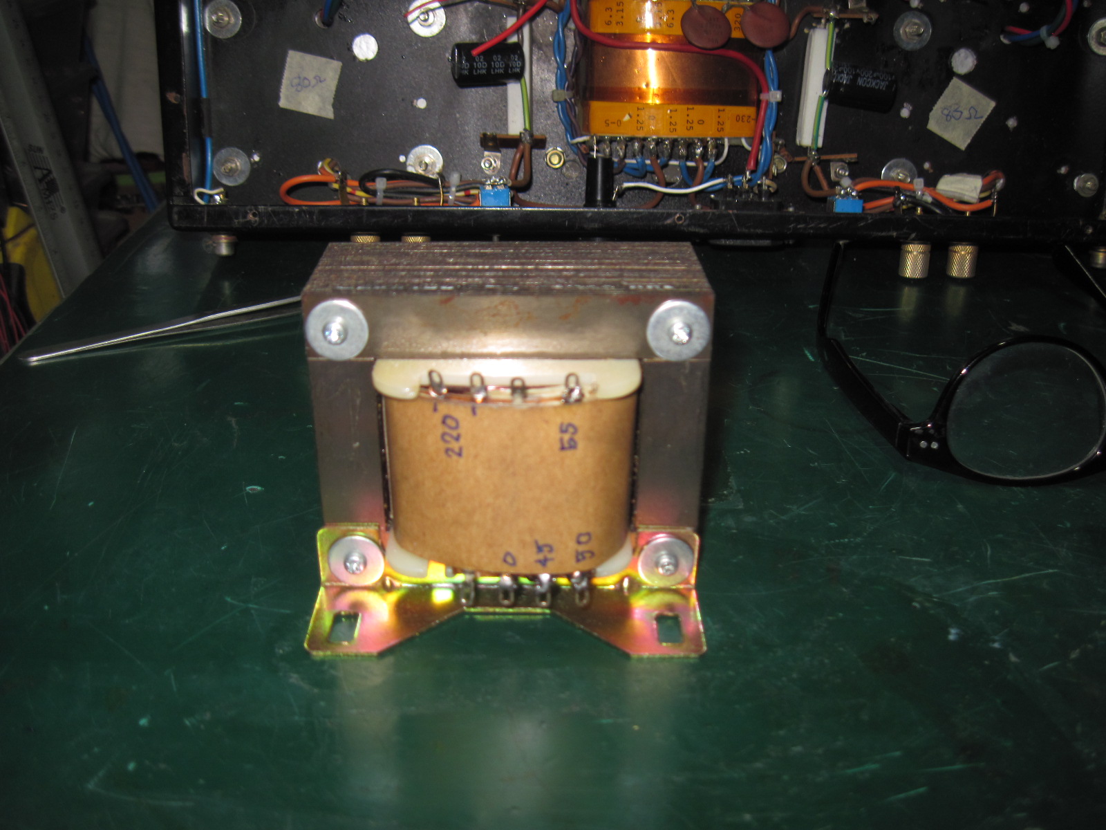

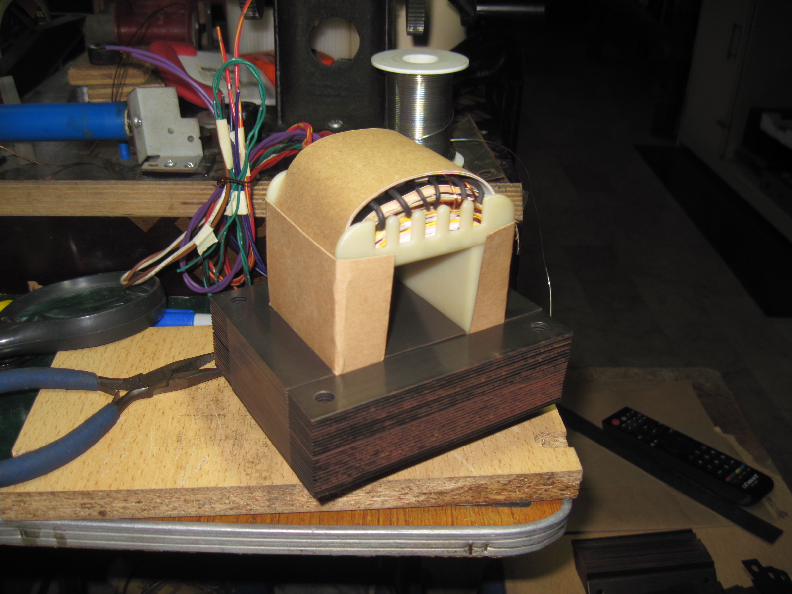

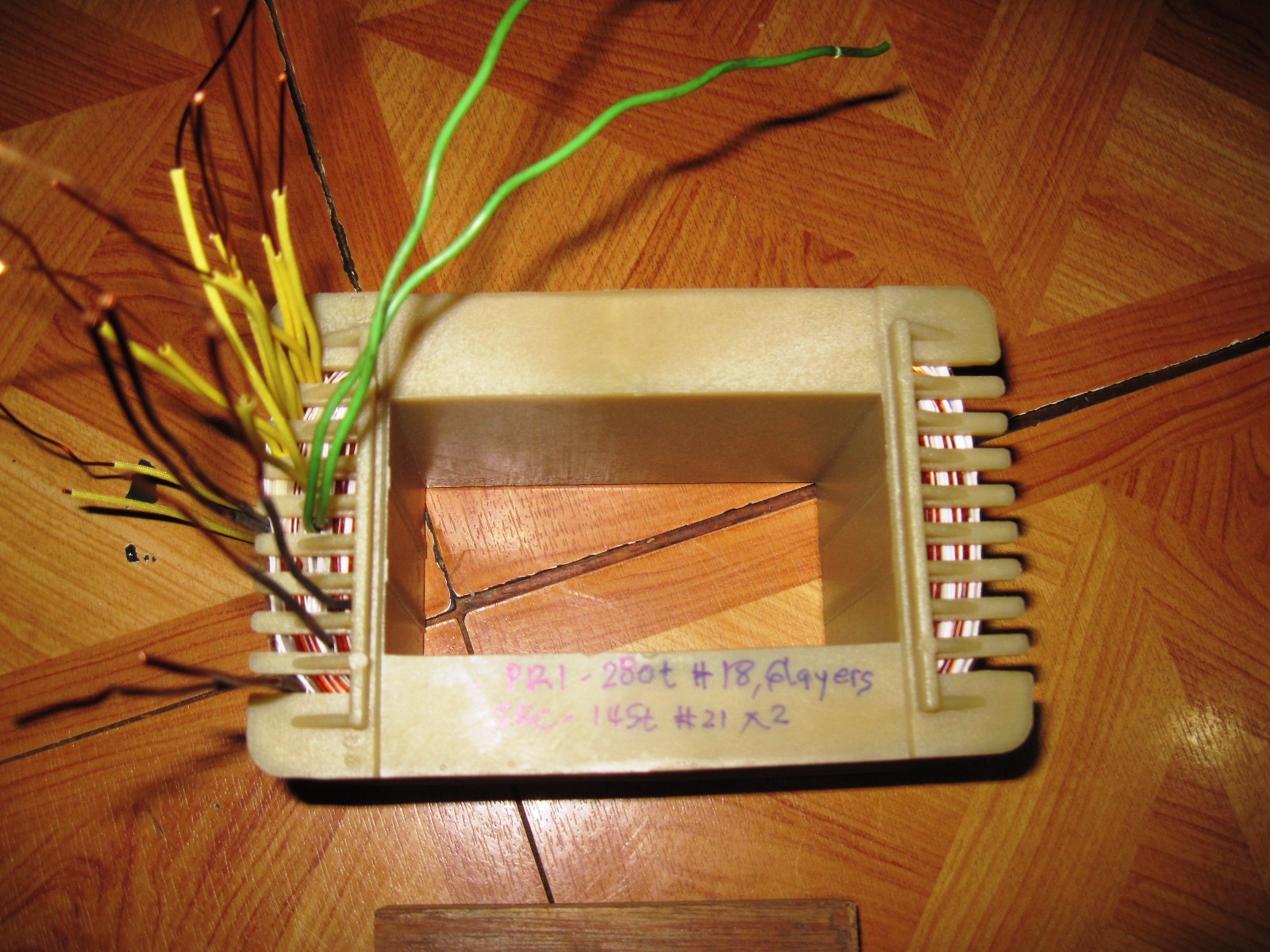

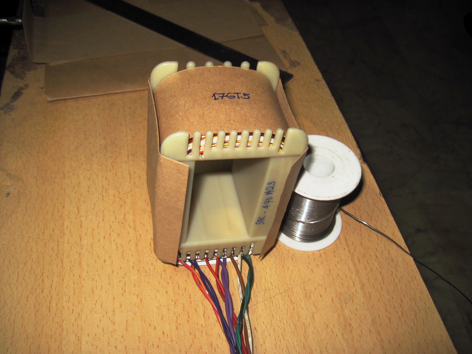

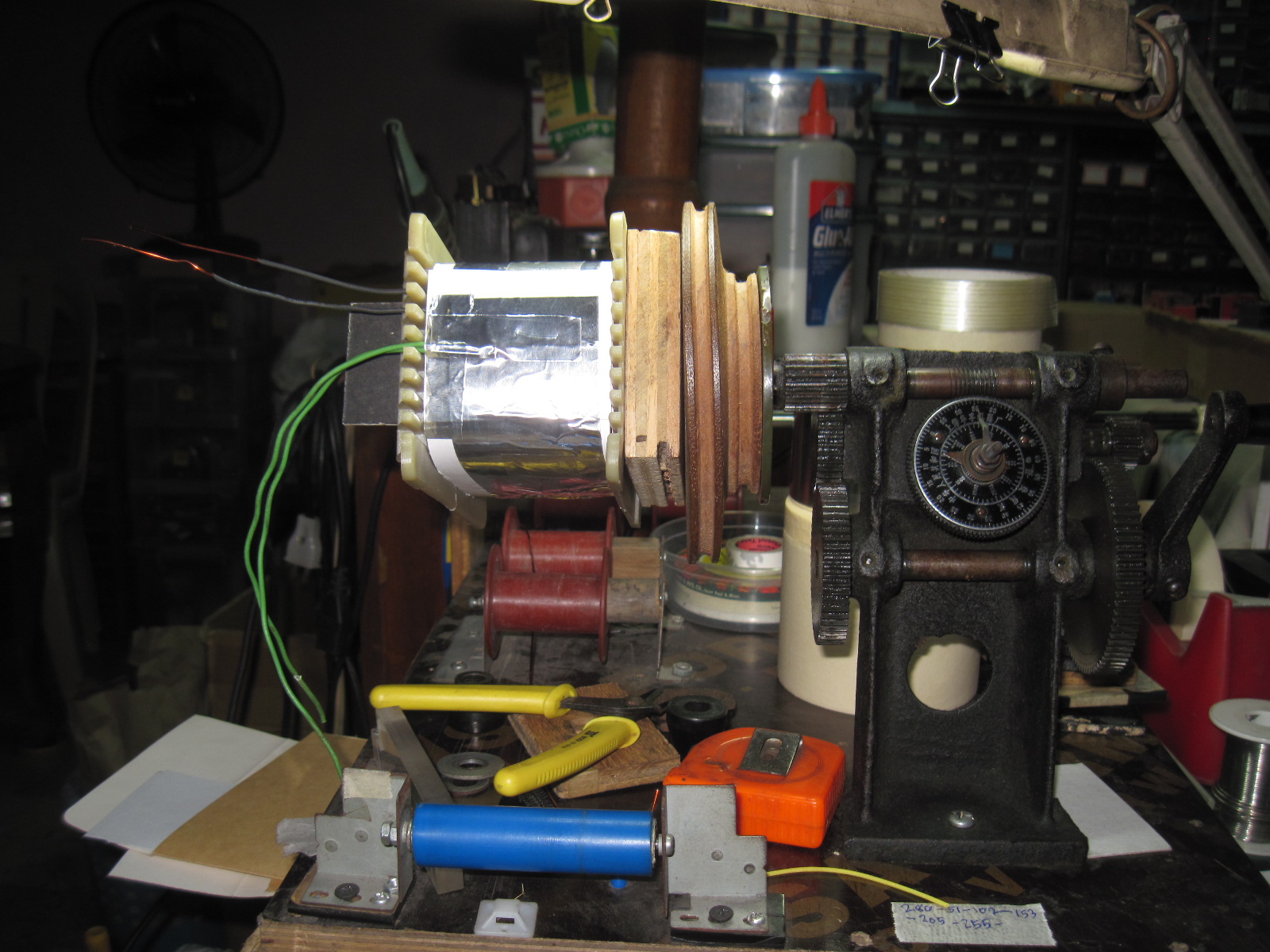

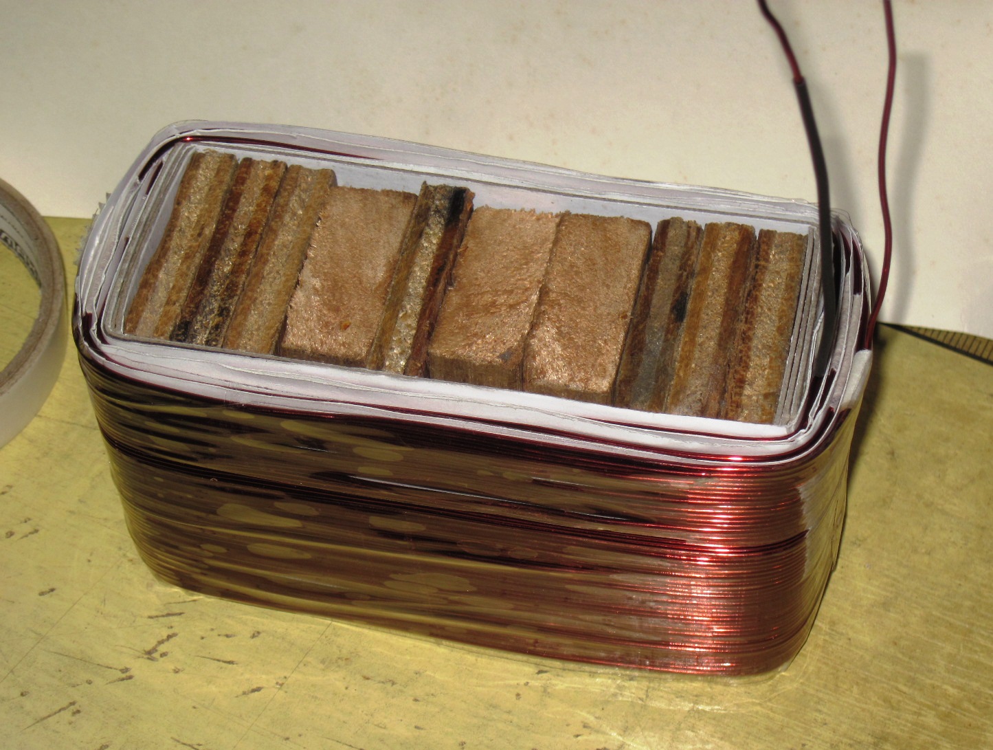

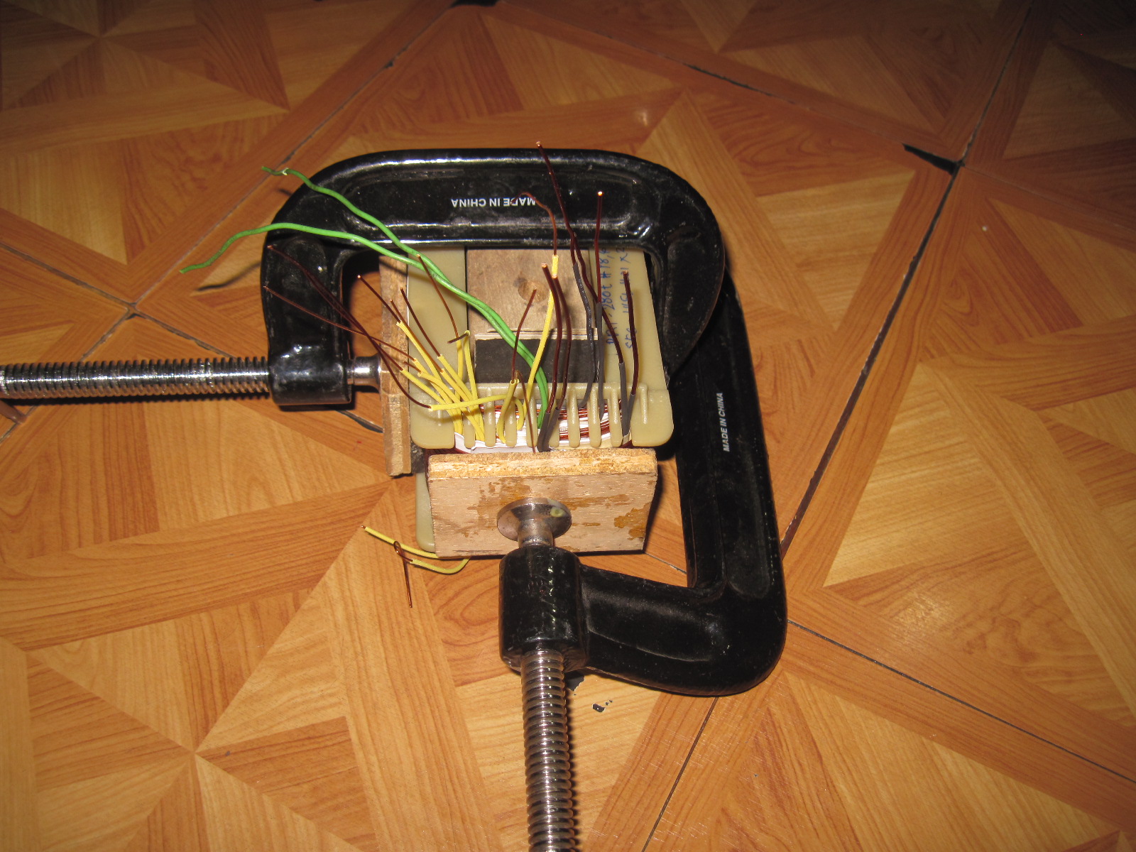

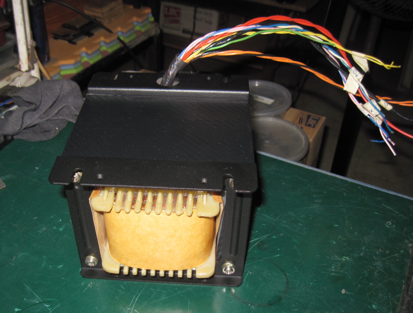

another traffo build for an OTL amp....1 3/4 in cl x 3.5 inch stack using H18/M24 core, weighs in at 9.5 kgs....

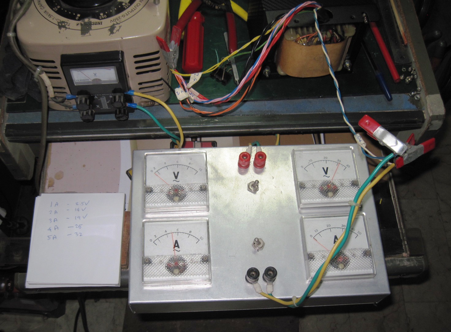

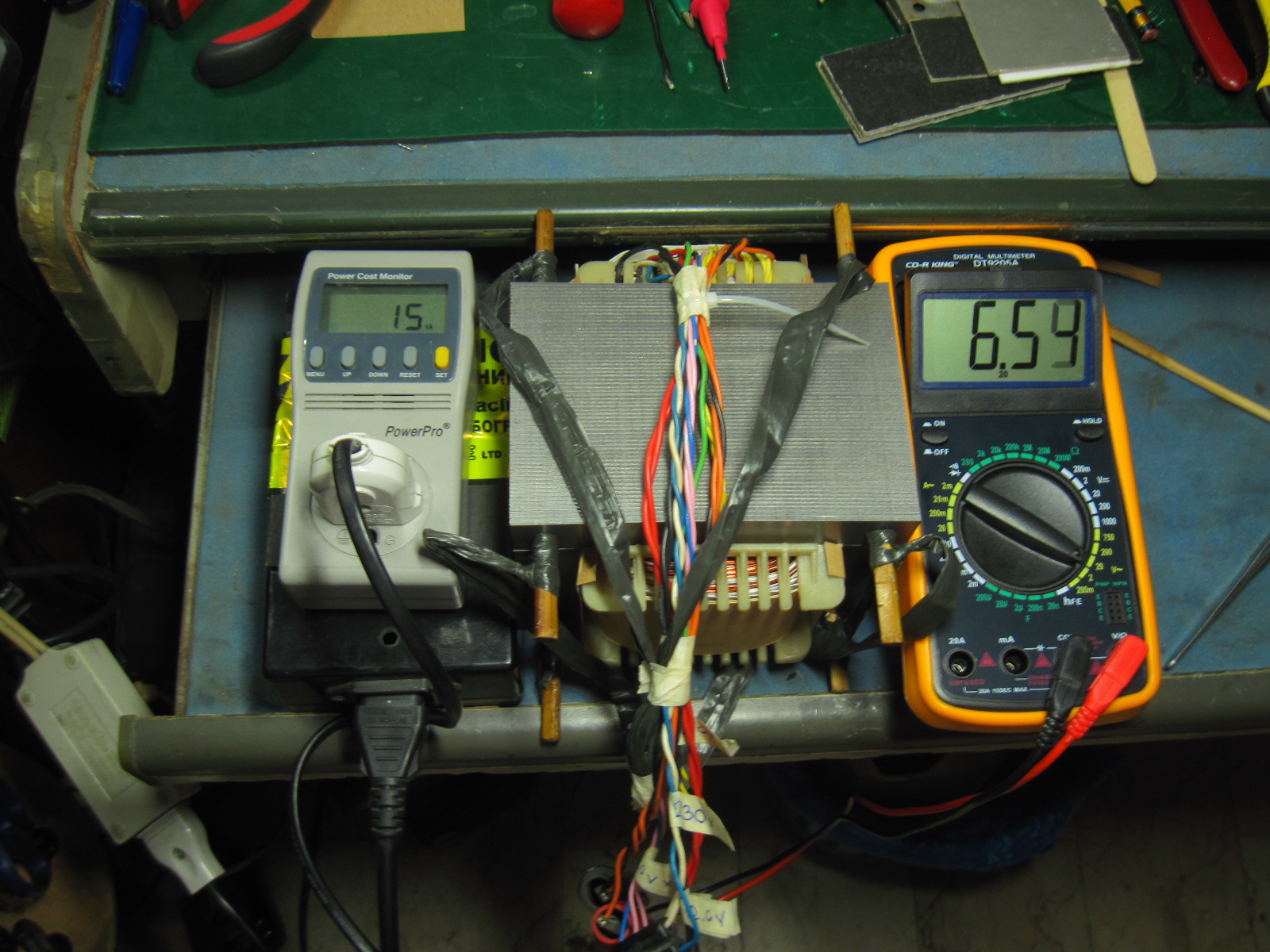

testing of power traffo........
short circuit testing to determine copper losses at various input currents...
this traffo has a core rating of over 1000va, will supply a continuous power of 250 watts,
and about 300 watts at full tilt, so i made it big to keep the heat down hopefully...

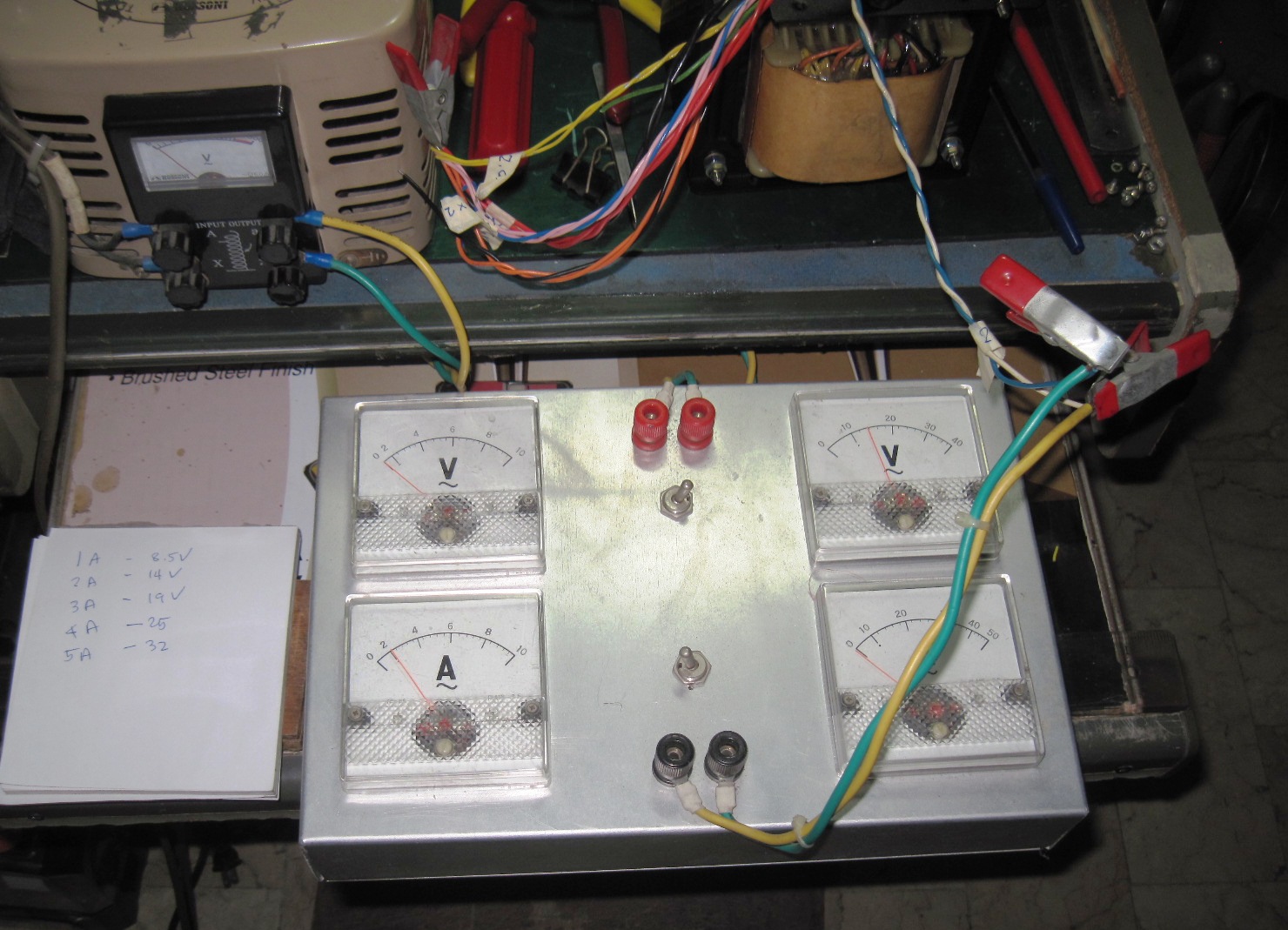

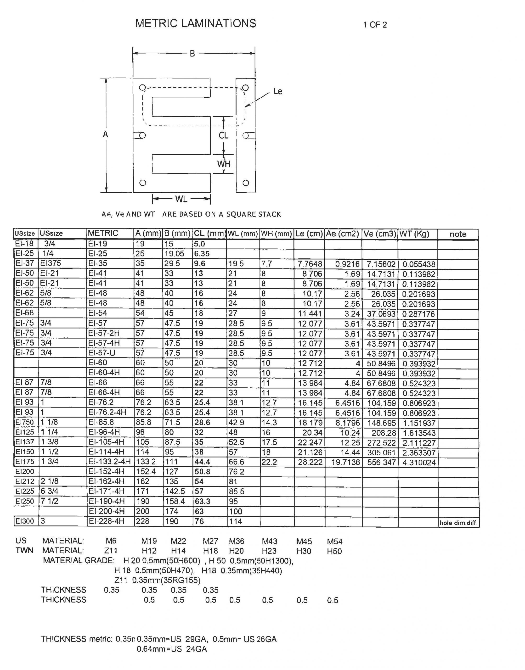

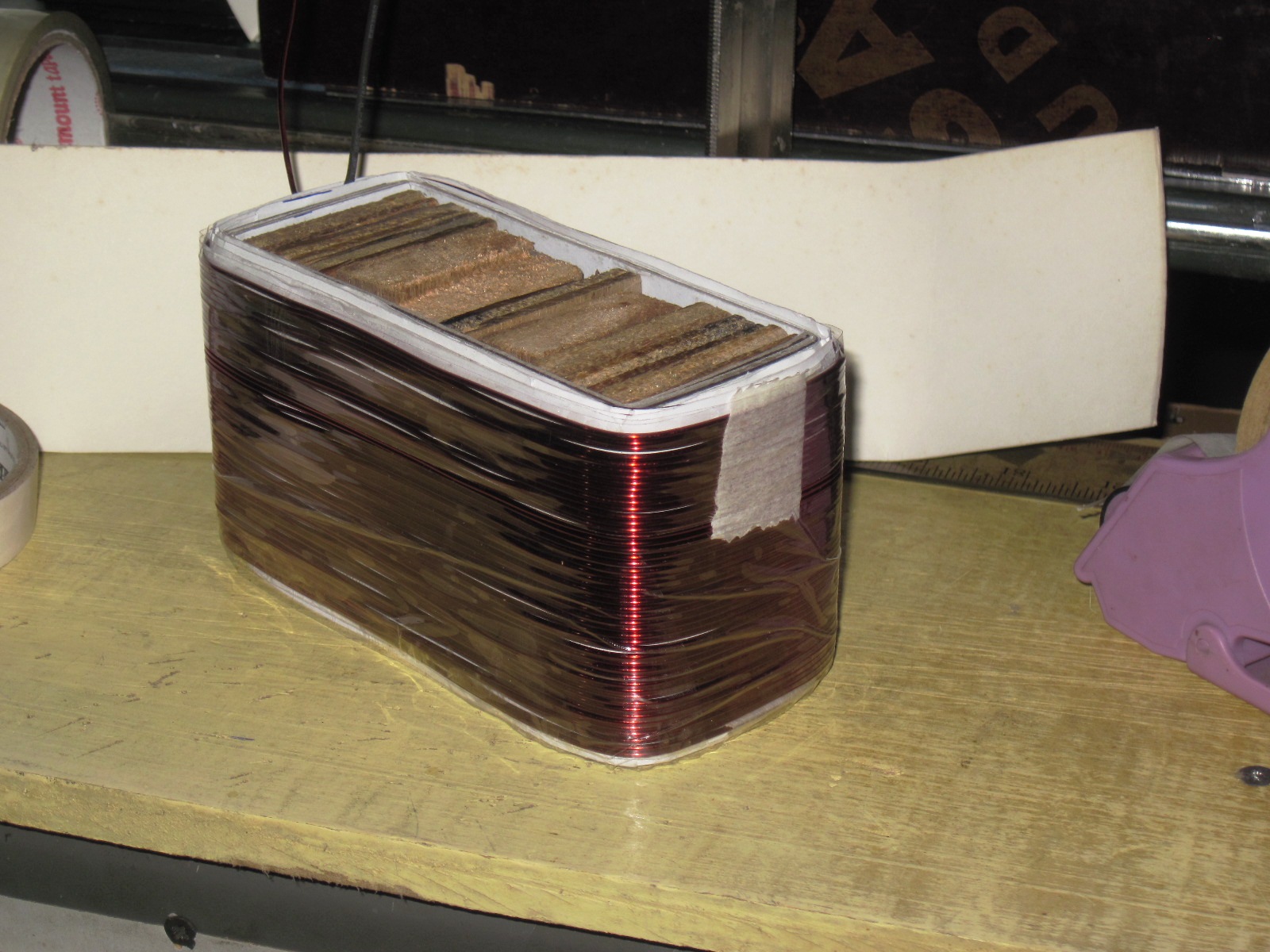

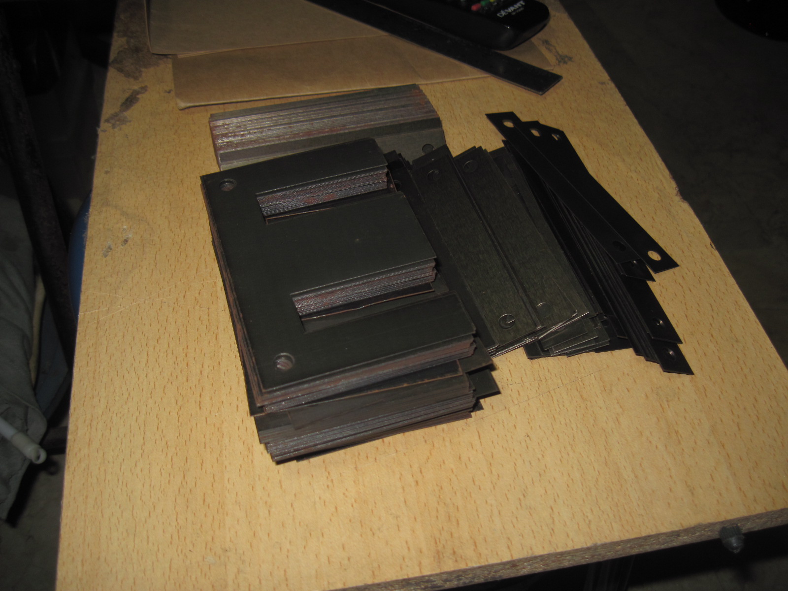

I think I know some of what you are describing, but could you explain all of it for me/us?1 3/4 in cl x 3.5 inch stack using H18/M24 core
and this please?short circuit testing to determine copper losses
H18/M24 is core grade, M3/M6 being of the higher grade, in manila,
the lowest grade H50 is most commonly used in cheap power traffos,
good for solid state amps, but for tubes, you need to make them really big...
and this please?
short circuit testing is an engineering process to determine copper losses
of a given traffo when rated current is flowing in the primary winding...
for this you need a variac to adjust input voltage so that rated current
flows in the primary winding...i tested this amp for 1 to 5 amps of
primary current with 230 volts this is 230watts, 460 watts, 690 watts,
920 watts and 1150 watts...

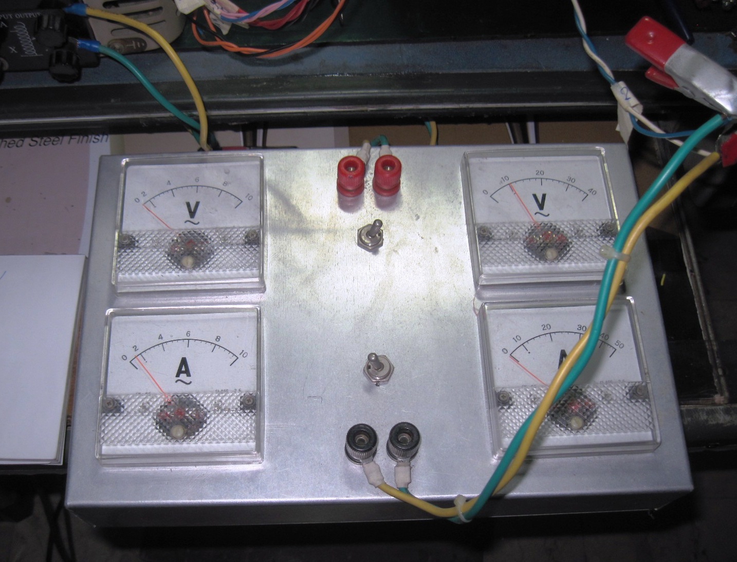

voltage readings were taken off the homemade tester i constructed for
taking voltage and current readings, as shown has two ranges that
can be selected by toggle switch...
for the 1 to 5 amperes of test currents, voltage readings were: 8.5v,
14v, 19v, 25v, 32v....
so then copper losses were 8.5W, 28Wm 57W, 100W and 162W...
btw, prior to testing, all secondaries(except the center taps) were stripped and connected to form a short...
this completes the short circuit test...

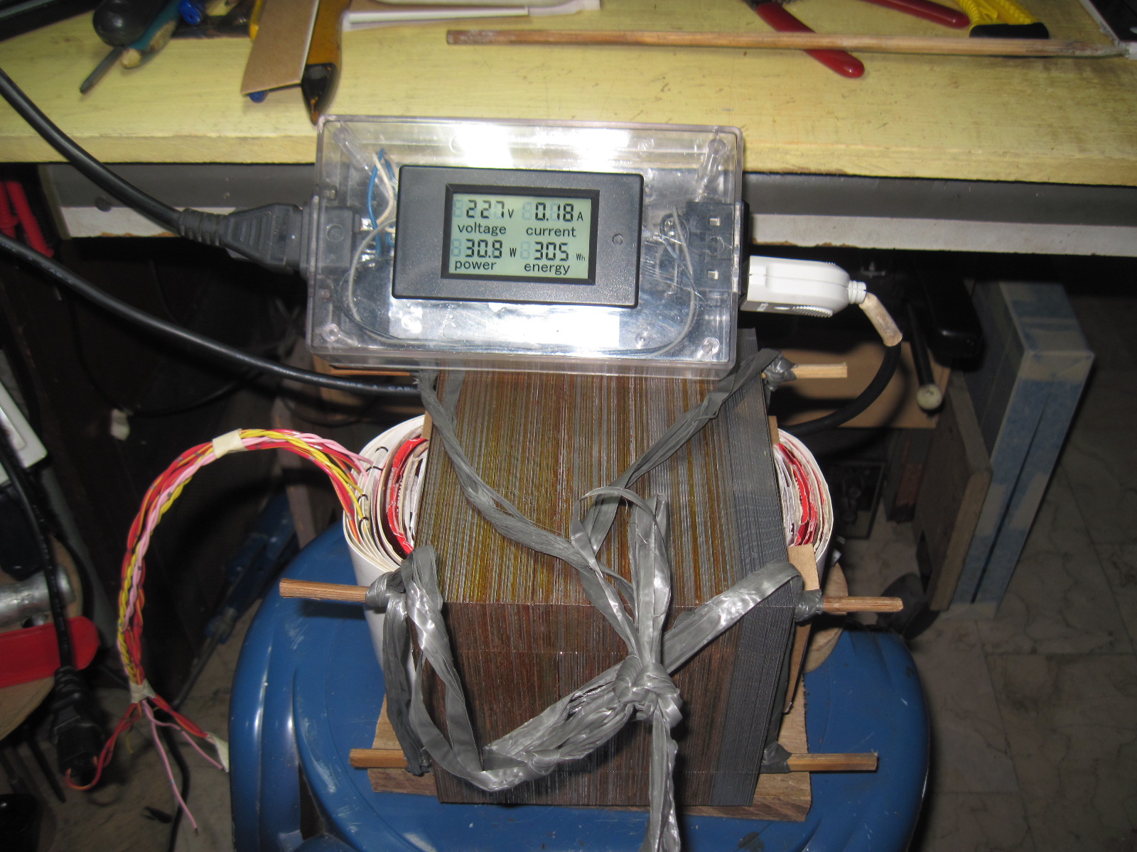

before this i also did a core loss test, or other calls as an unloaded test...
here, using a kill-a-watt tester, i found that 15volt amperes are drawn
and that 10 watts core loss was measured....
so armed with the knowledge of losses, this traffo efficiency can be calculated..this traffo will supply about 250 watts of continuous power
idling and at full tilt around 350+ watts will be supplied by this traffo...
efficiency, E= 350/(350 +10+28) =90%
i can make a traffo with much greater efficiency than this, but for now
i think this will be just okey...
H18 is the equivalent of M24....taiwan vs, american
cl is center leg
stack is how much laminates are put in...
Edit: instead of M24, it should read M27, my mistake...
cl is center leg

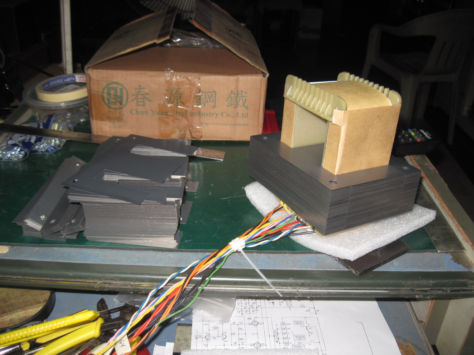

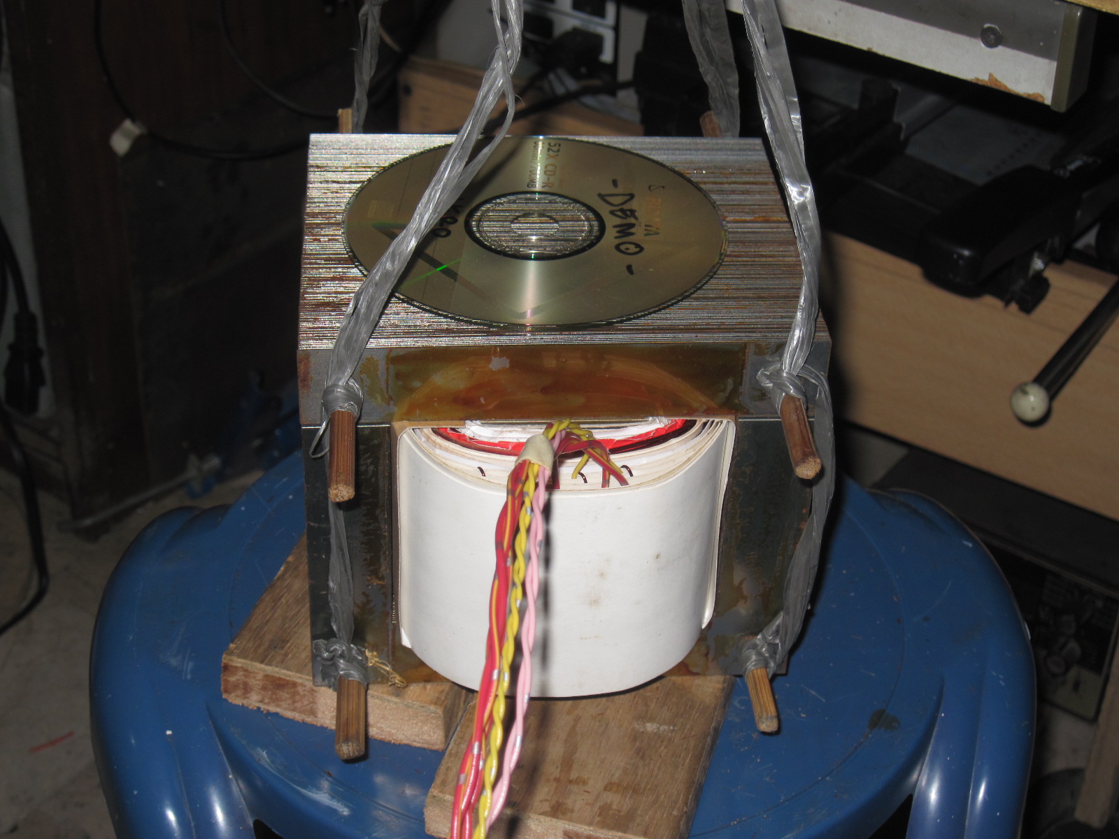

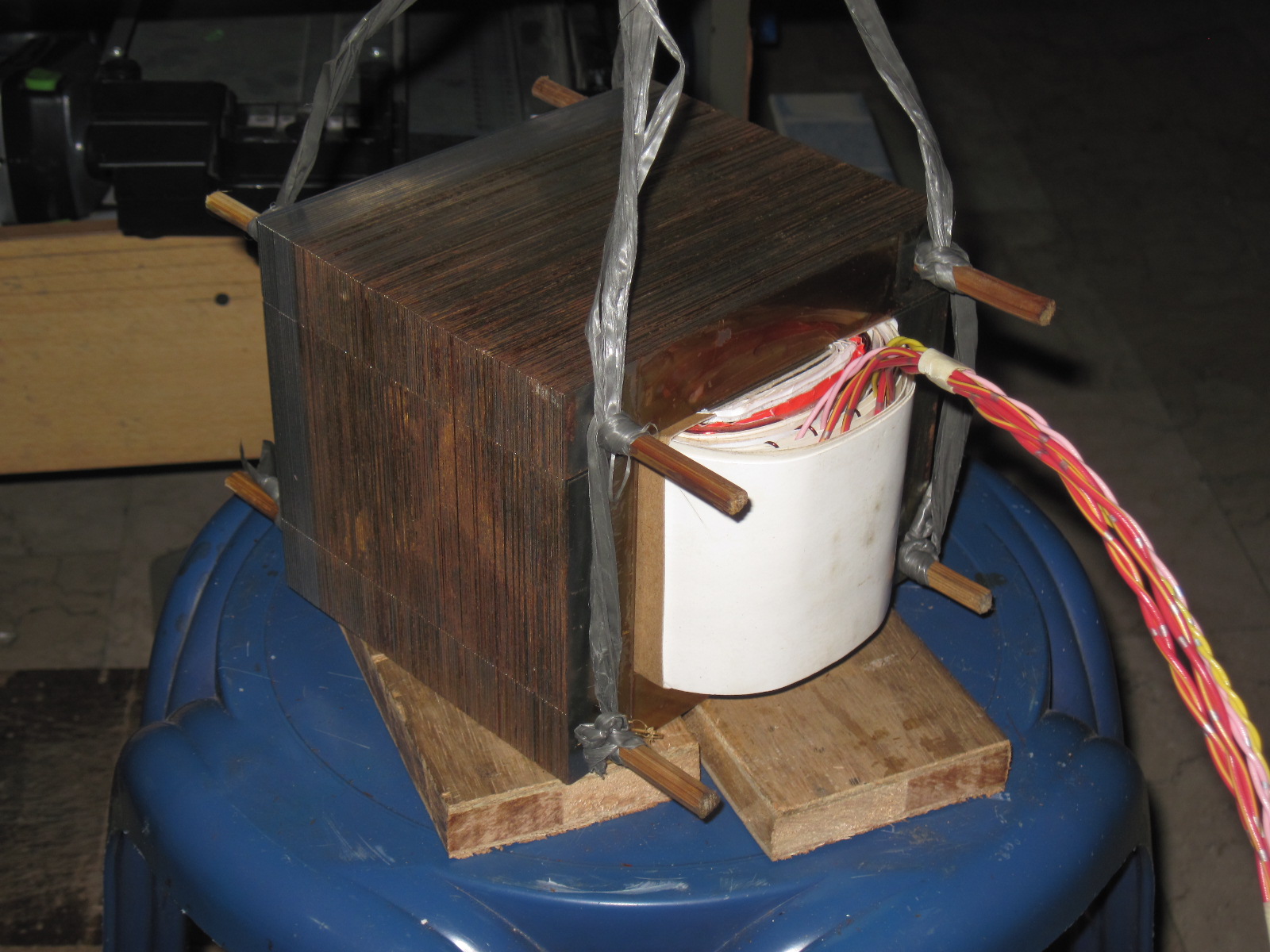

i need an isolation trafo for my hobby, i decided on one, two secondaries,
one is good for over a hundred watts(for testing equipment)
and the other for over 1kw of load power...
core is H50, 2 inch CL by 5 inch stack and weighs in a hefty 38 pounds...
when fully assembled will be on caster wheels....
testing for core loss prior to varnish application....

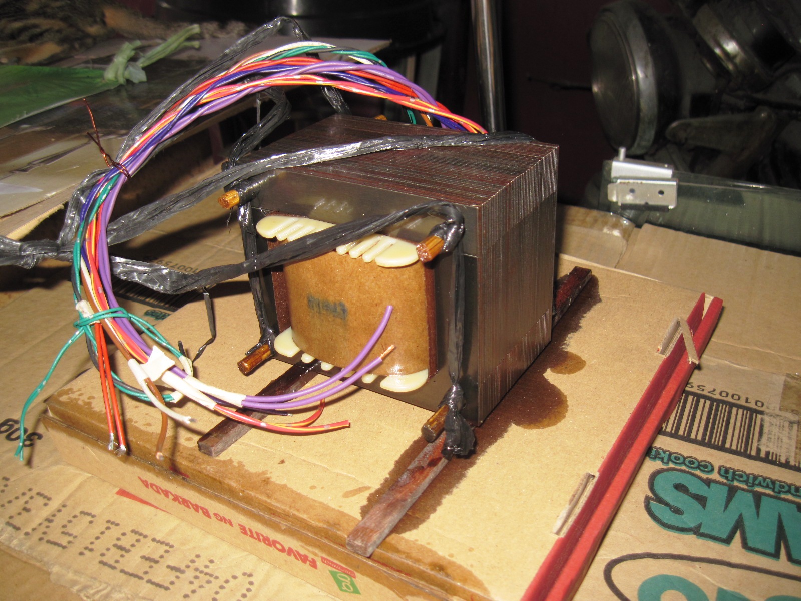

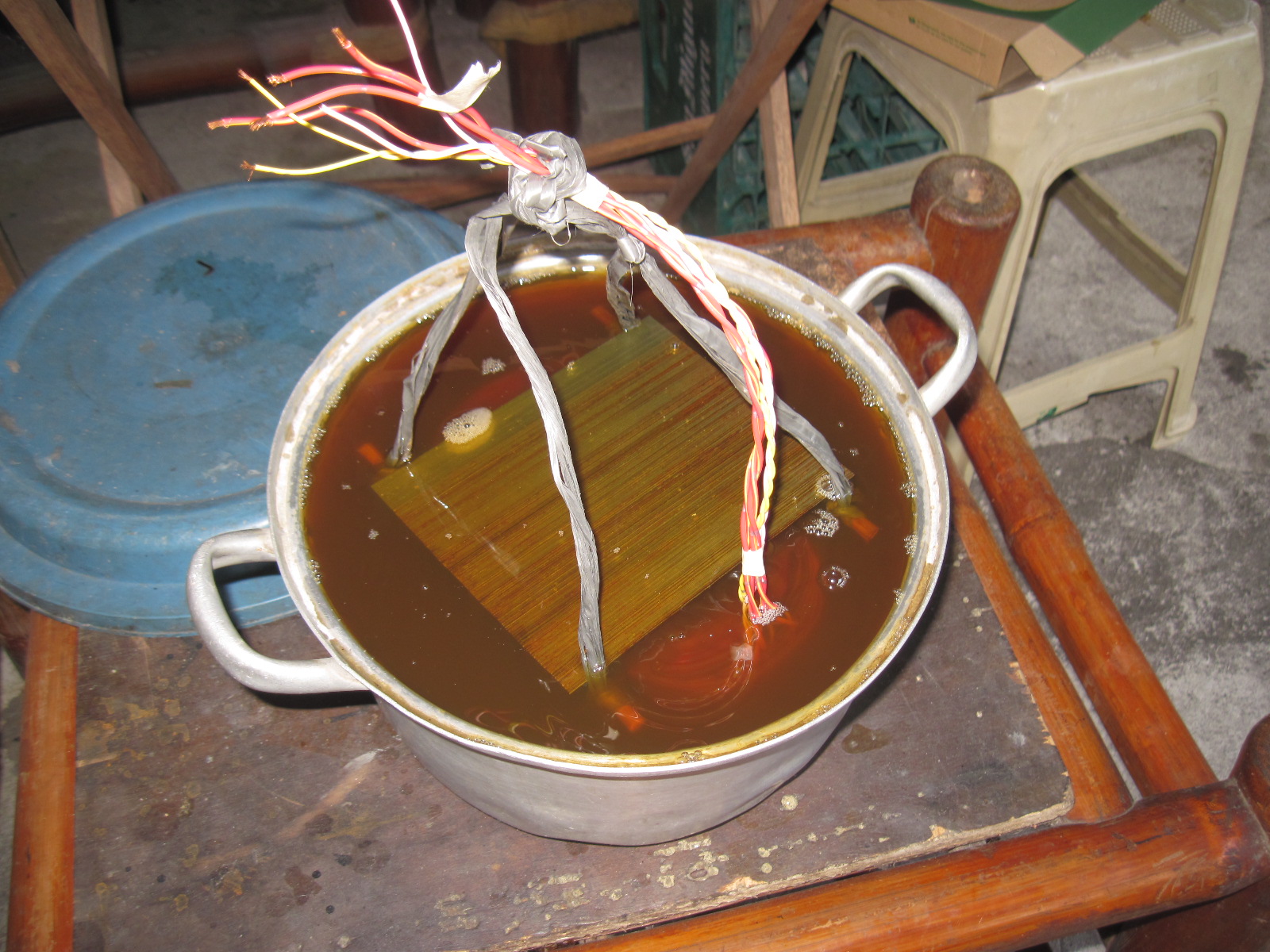

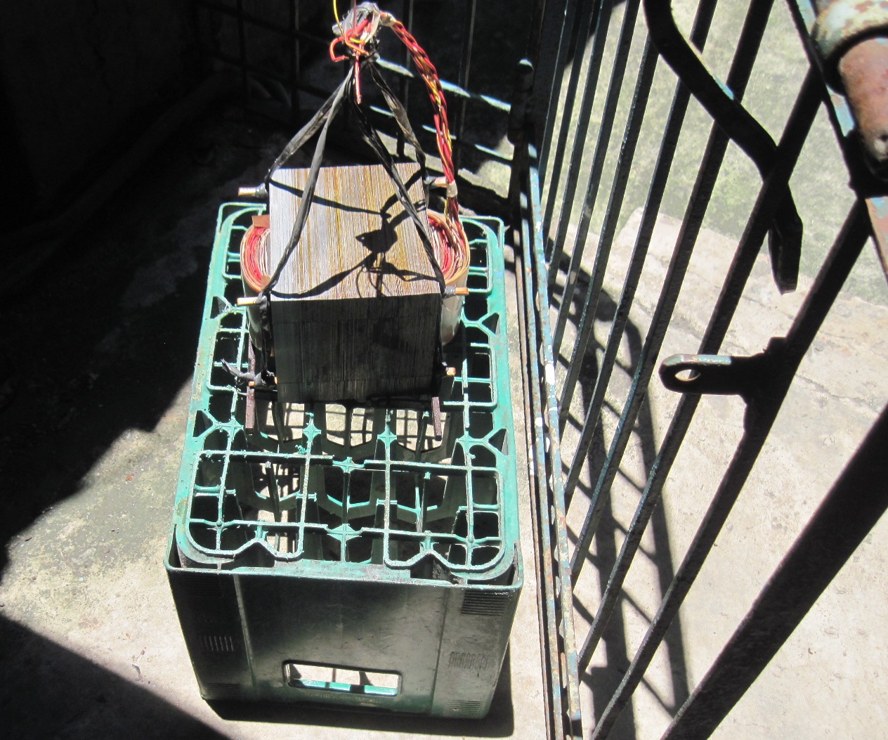

completely submerged in insulating varnish,
soak for over an hour, lifting and then dunking several times,
letting it drip off excess varnish, and then sun drying for over a week....

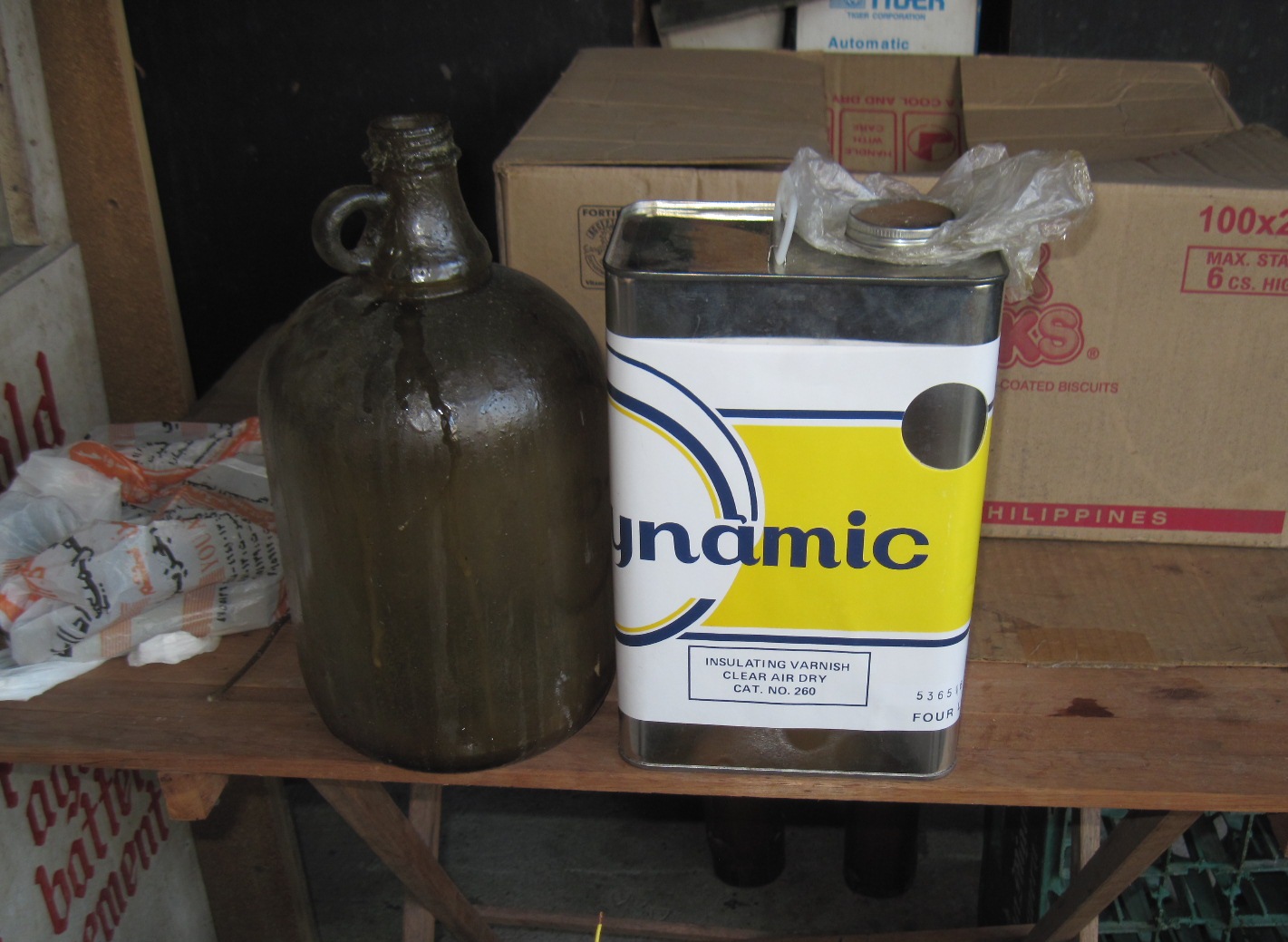

that is a good thing about the Phils, I would never in a million years be able to source a
2-litre [?] can of insulating varnish where I live and if I could it would be very expensive.
you have so much iron lying around you must feel like you are living in a scrapyard !.

the air drying varnish cost 460 pesos (U$10) per gallon,
i keep a couple of gallons on hand at any given time.....

tony can you supply the manufacturer's details and part number of that air drying varnish so I can look it up online ?
also what is the mimimum ambient temperature needed to dry the varnish.
