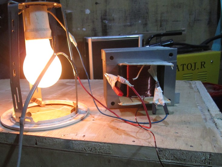

..................may i ask you in using series bulb test to a newly made traffo, what would be the necessary wattage of the bulb?
is it ok to apply series bulb test after winding the primary coil only?................
the primary only test is OK.you use the series lamp tester on a completed traffo for EI...
wattage of lamp is not so much a big deal, i use 100 watts in mine...
you can use the bulb resistance to limit the current so that a too few turns primary does not get damaged.
You can measure the voltage across the primary and measure the voltage drop across an in series 10r resistor to determine the current. From that you know the Henries and what to expect for that particular Vprimary.
I use a low value bulb wattage for transformer alone. Typically 25W or 40W. Often this value does not even flicker. The transformer just turns ON.
Once that is complete you can progress to using a Variac to check Iprimary for the full range of Vprimary and then plot Vprimary vs Iprimary and see the "S" shaped curve and decide if the highest Vac is getting too close to saturation.
This can all be completed before you wind on the secondaries.

with a lamp tester, the bulb is dim and the degree of dimming is directly proportional to the magnetizing current,
more current and the bulb glows more, and vice versa....
a fully lit bulb indicates shorts in the secondary or primary...

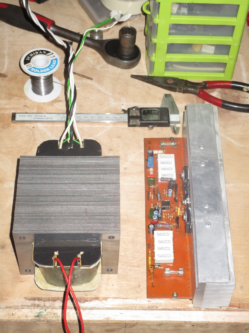

sir tony here is my latest traffo i think this is H50 since it 0.50mm thick, i used illustration board and mylar for bobbins,
2x50Vac 8A and 2x19Vac 1A
50Watt bulb does not lit up after traffo was finished.
tested pluged in directly no load for 5 hours, Cores 33 Degrees Celcius
thnks

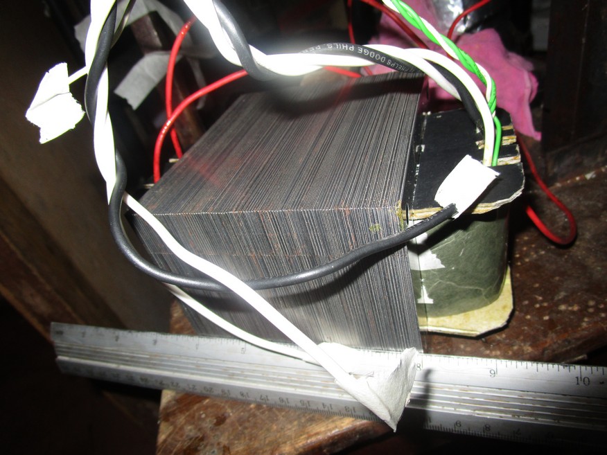

I think, in general stacking laminations to extended heights like these may not be too desirable, due to increased winding lenghts.
Best regards!
Best regards!
Best regards!
agreed, and the next bigger core is selected, the ideal is a square, but rectangles with a ratio of 1:3 is usually my limit....
but when you come from a country where resources are limited, then this will do....
i tell local guys that for as long as you know the consequences of one's choices, then you can do it in any geometry you like....
A ratio of 1:3 seems quite a lot to me. Here in Germany, maybe in continental Europe also, standardized cores, i.e. those with pre-fabricated bobbins, are/were stacked to not more than 1:1.5.
Best regards!
Best regards!
i have premade nylon bobbins 1.75 x 3 to 4 inches that i used....
the lates big traffo i did used bobbins for 2.25inch cl x 3 inches, that is 1.33...
for good use of the iron the core should be roughly square.A ratio of 1:3 seems quite a lot to me. Here in Germany, maybe in continental Europe also, standardized cores, i.e. those with pre-fabricated bobbins, are/were stacked to not more than 1:1.5.
Best regards!
1:0.7 to 1:1.5 would be a good range that gives acceptable use of the iron core.
1:1, or very close, gives best use and also allows the optimum window for copper.
As the ratio is stacked longer, the copper window remains the same but the iron limited VA is going up and the copper length is going up. These two effects increase the transformer regulation and lead to a big sag in voltage as the load current is increased.
It would be better to select a wider/bigger EI for improved transformer performance and probably end up lighter and cheaper and lower regulation due to less iron and less copper length for the new bigger VA.

^yes, that is why when i design a traffo for my amps,
the secondary voltage at rated amplifier power is the prime consideration,
naturally you always end up with higher unloaded voltage...
i never even bothered computing for regulation....
