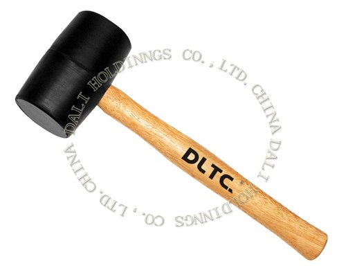

what i do in cases where thick wires is used is i lay them out straight on the ground and remove the kinks if any before winding them onto the bobbin....
nice bobbins and mandrel you have there btw....
now after winding the coils you can use rubber or wooden mallets to compress the coils.....do not pund on the coils directly but use a small wooden planck about 1/2 inch thick.....do not remove the coils from the mandrel while you are doing this.....

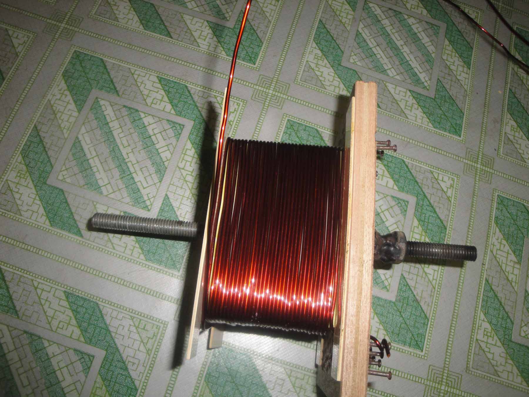

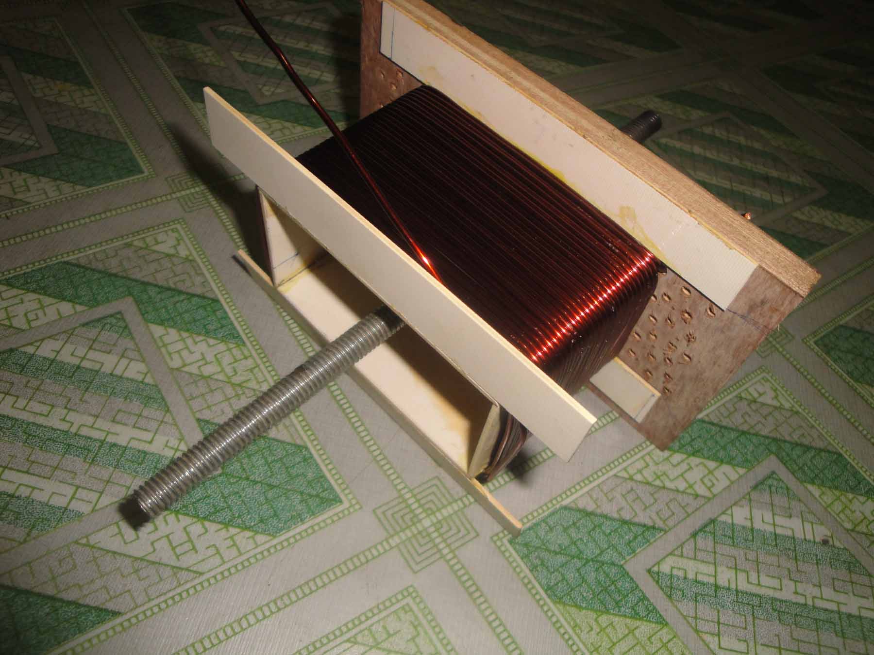

i tried with this jig.
the bobbin size is 1.75 inch centerleg, core stack 4.5 inch. i made with pcb board.
a couple of suggestion please.....the mandrel should sit in the full traverse width of the bobbins.....you can drill holes on the side of cover plate to thread in the wires...

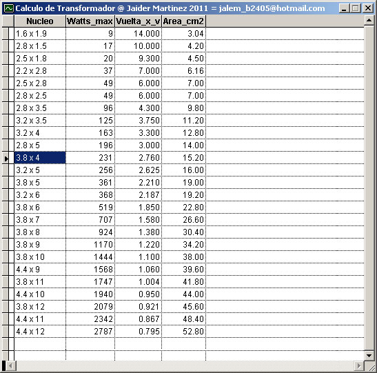

hi tony,
from this image if i select 4.4cm by 9cm for 1568watts transformer, what are the calculation? 60-30-0-30-60v ac for seconddary, if i choose 16awg for secondary and 18awg for primary. is this gages are ok, pls reply.
just about right for the core size...in India, you are using British standards for magnet wires so make sure you get correctly wires that you need...
1 3/4 inches center leg x 3 1/2 inches stack will require about 320 turns #18, so at 230 volt primary, that will be 1.39 turns per volt.....
secondary, you will need 4 coils of 42 turns per coils #15 magnet wire...
if you can not do a quadfillar, you can do 2 x bifillar instead.....

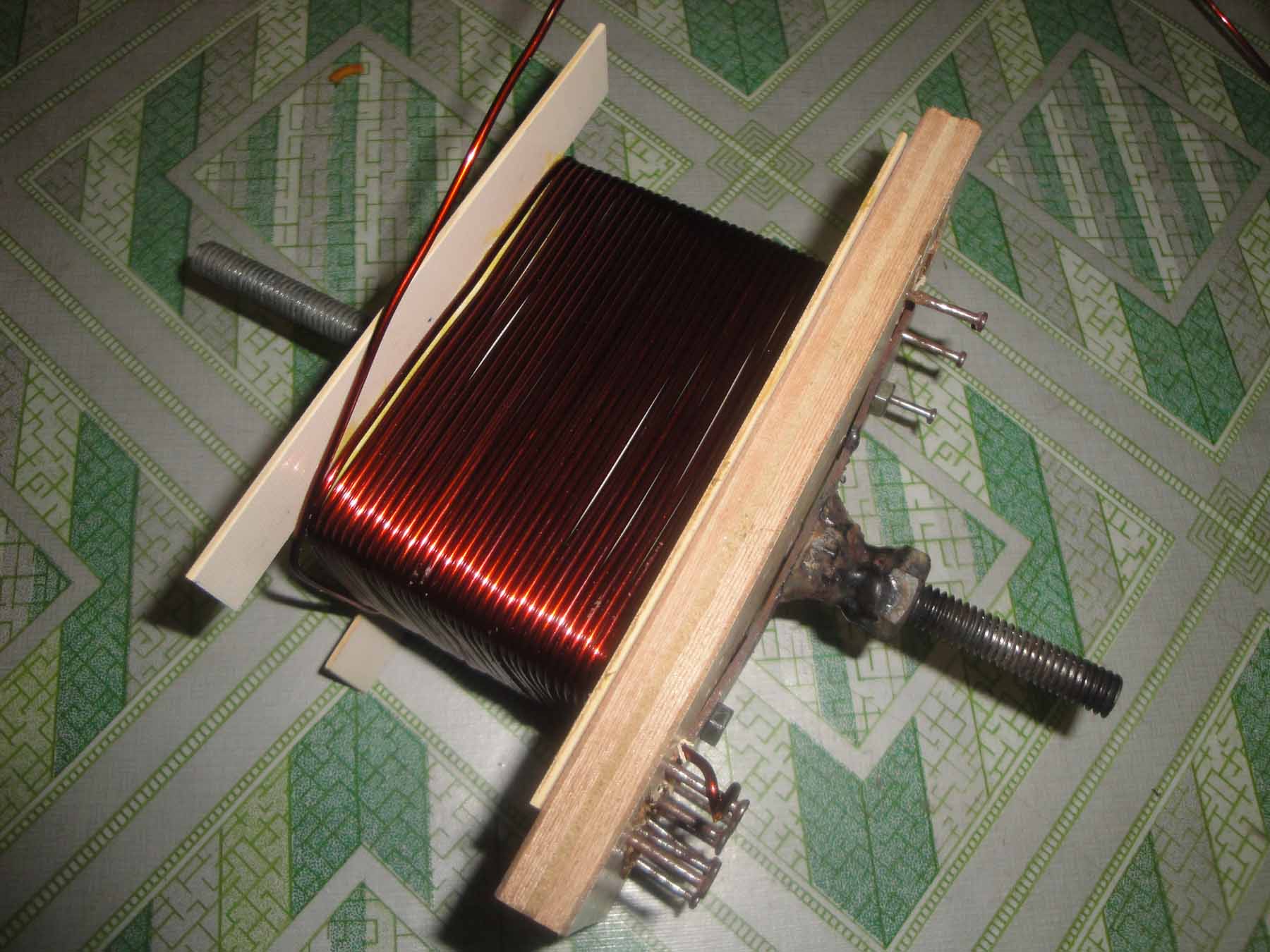

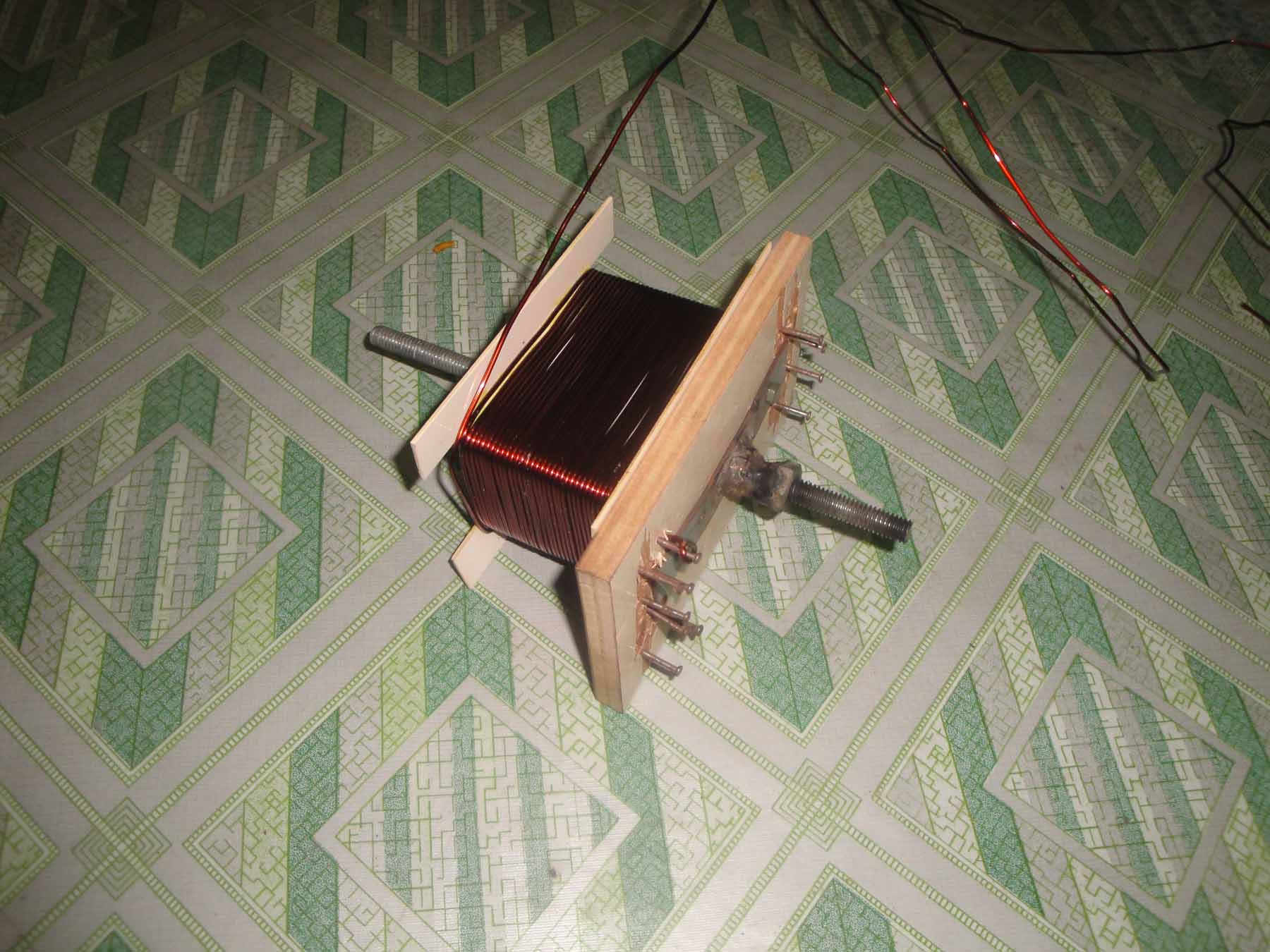

hi tony,
is this correct or not?
i make the bobbin with epoxy pcb board.
i start wind secondary first.
if first layer complete what insulation material should i use?
In one wire there is a little scratch on top of the wire,(.3mm by .4mm)(the enamel is removed), my screw driver scratched. is it ok or i have to replace the hole wire with new one?
can i add transformer varnish to the scratch area?

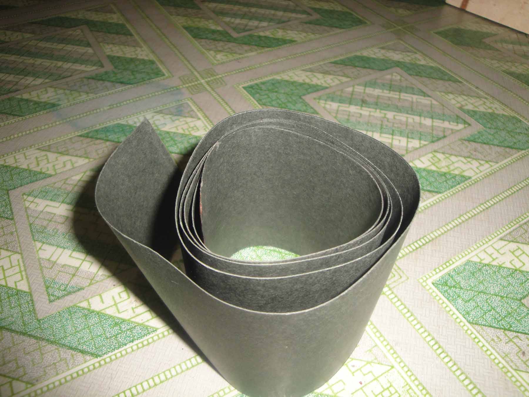

is this insulation paper is good for layer separating?
what material used to separate between primary and secondary?
