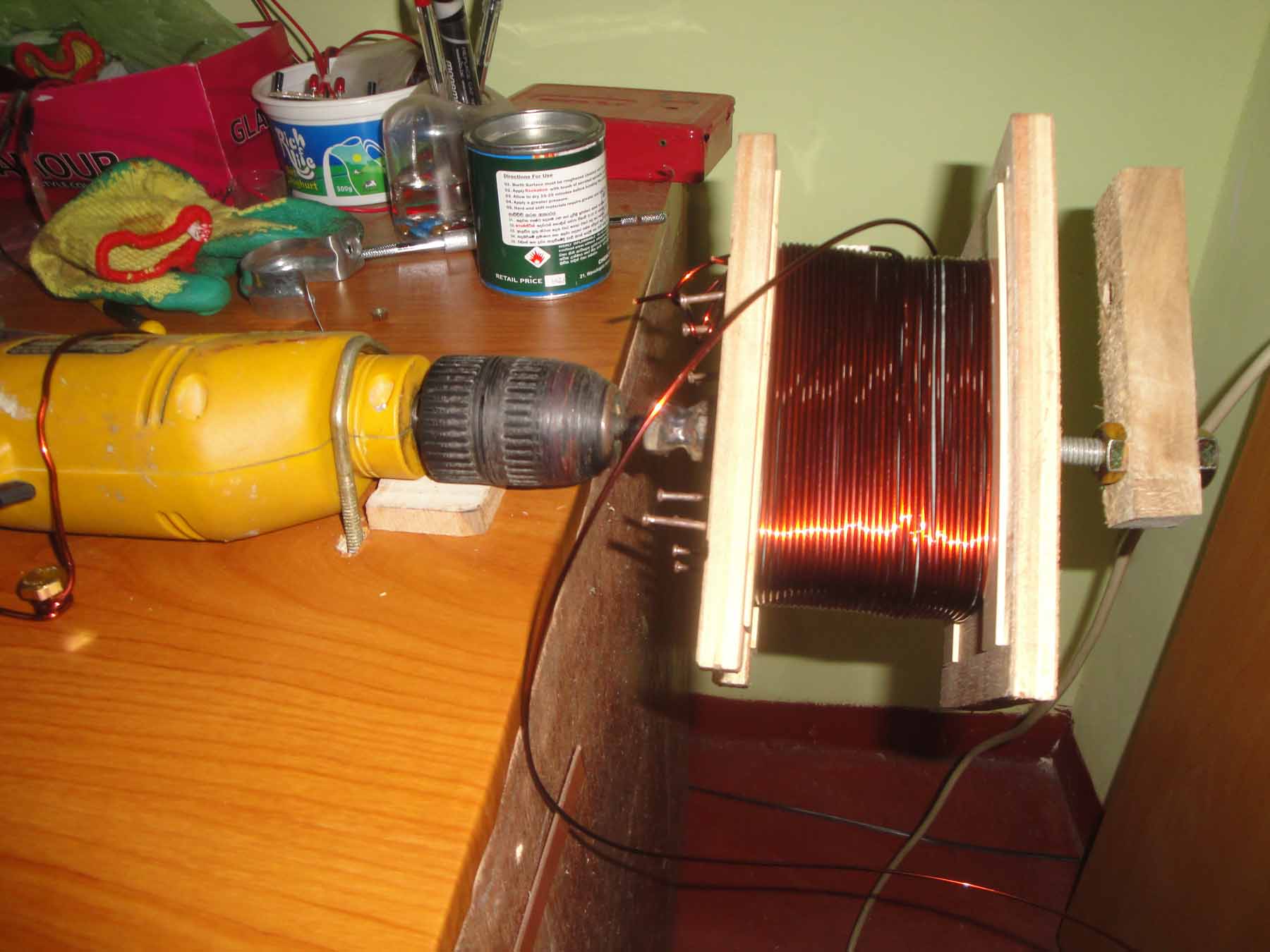

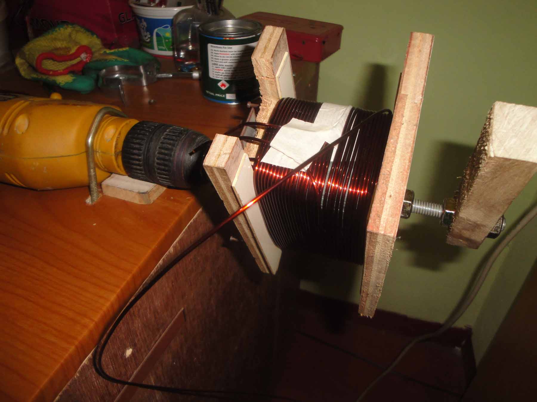

hi tony,
is this correct or not?
i make the bobbin with epoxy pcb board.
i start wind secondary first.
if first layer complete what insulation material should i use?
In one wire there is a little scratch on top of the wire,(.3mm by .4mm)(the enamel is removed), my screw driver scratched. is it ok or i have to replace the hole wire with new one?
can i add transformer varnish to the scratch area?
is this insulation paper is good for layer separating?
what material used to separate between primary and secondary?
you can use masking tape or cellophane tape on scratched part of the wire....
fish paper like what you have there is good for interlayer separators...

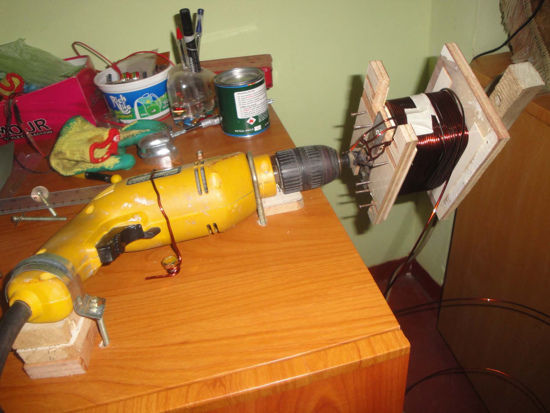

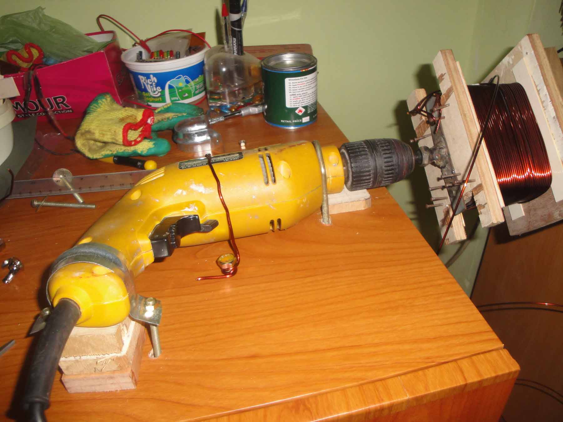

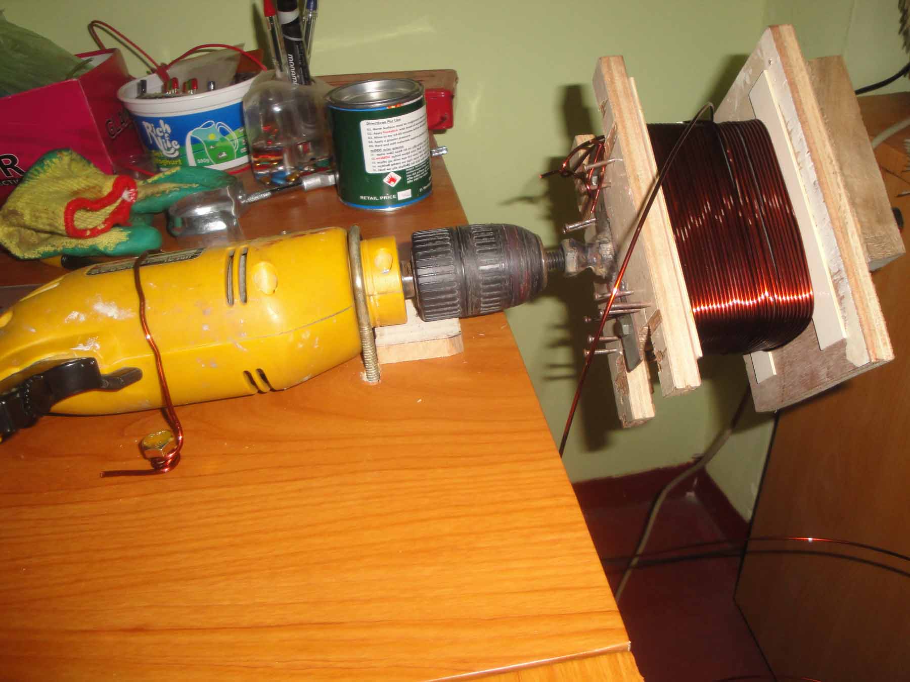

thanks for the comment,
i use drill machine to wind.
in the image i remove the drill machine from my table.

hi istpyro and tony,
this is how i wind with the drill machine.
looks nice , do u have turn counter too ?
