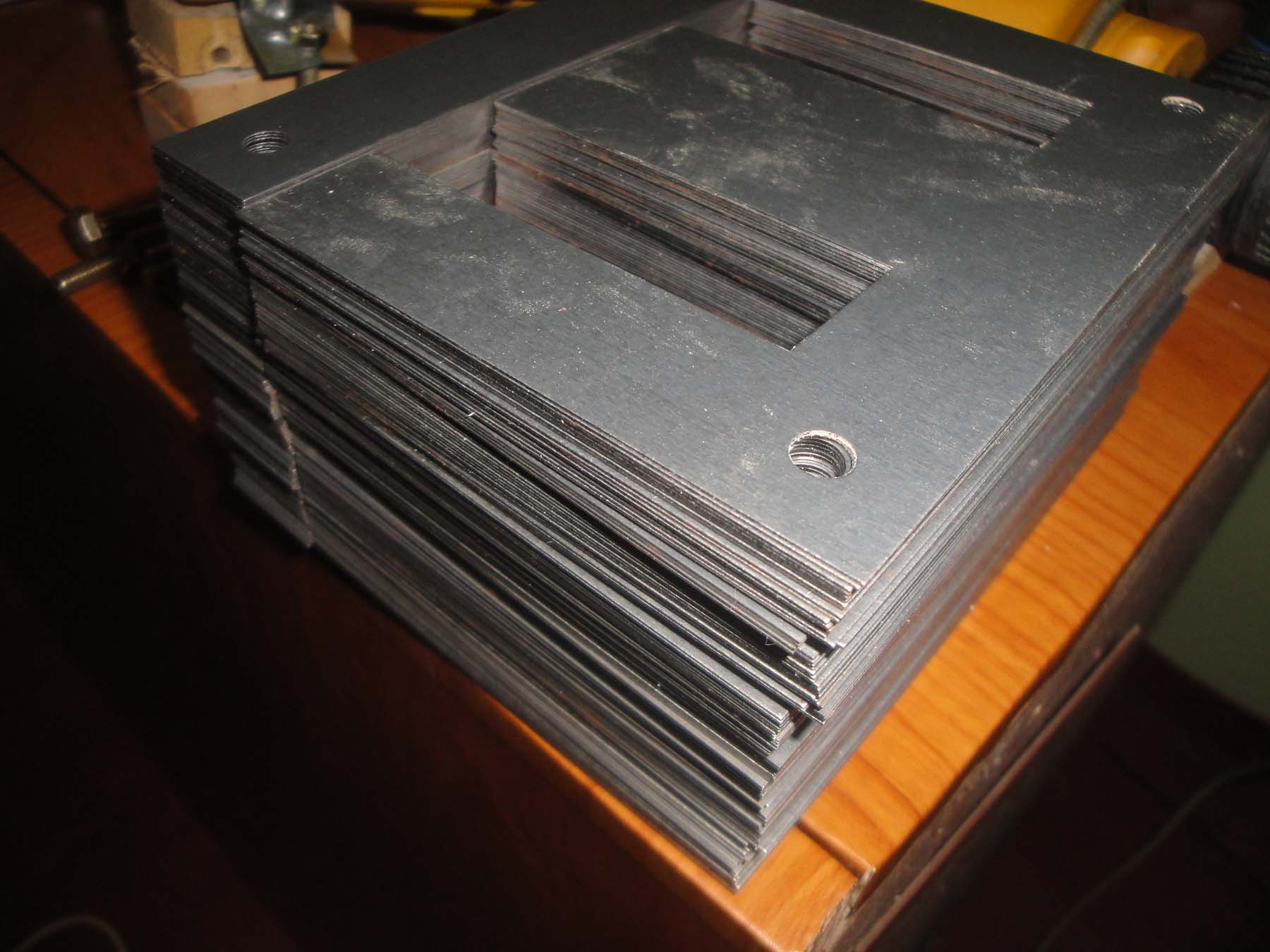

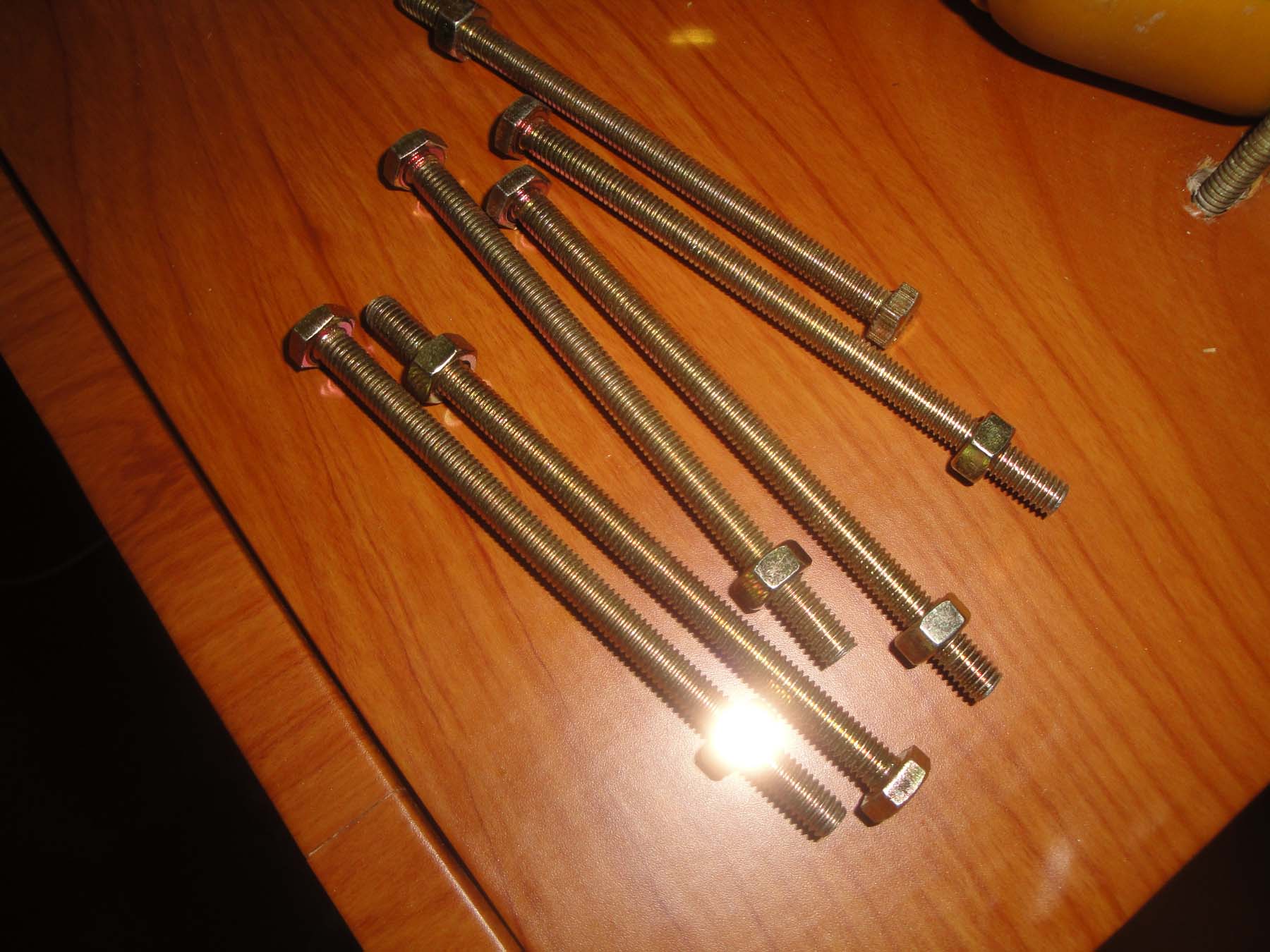

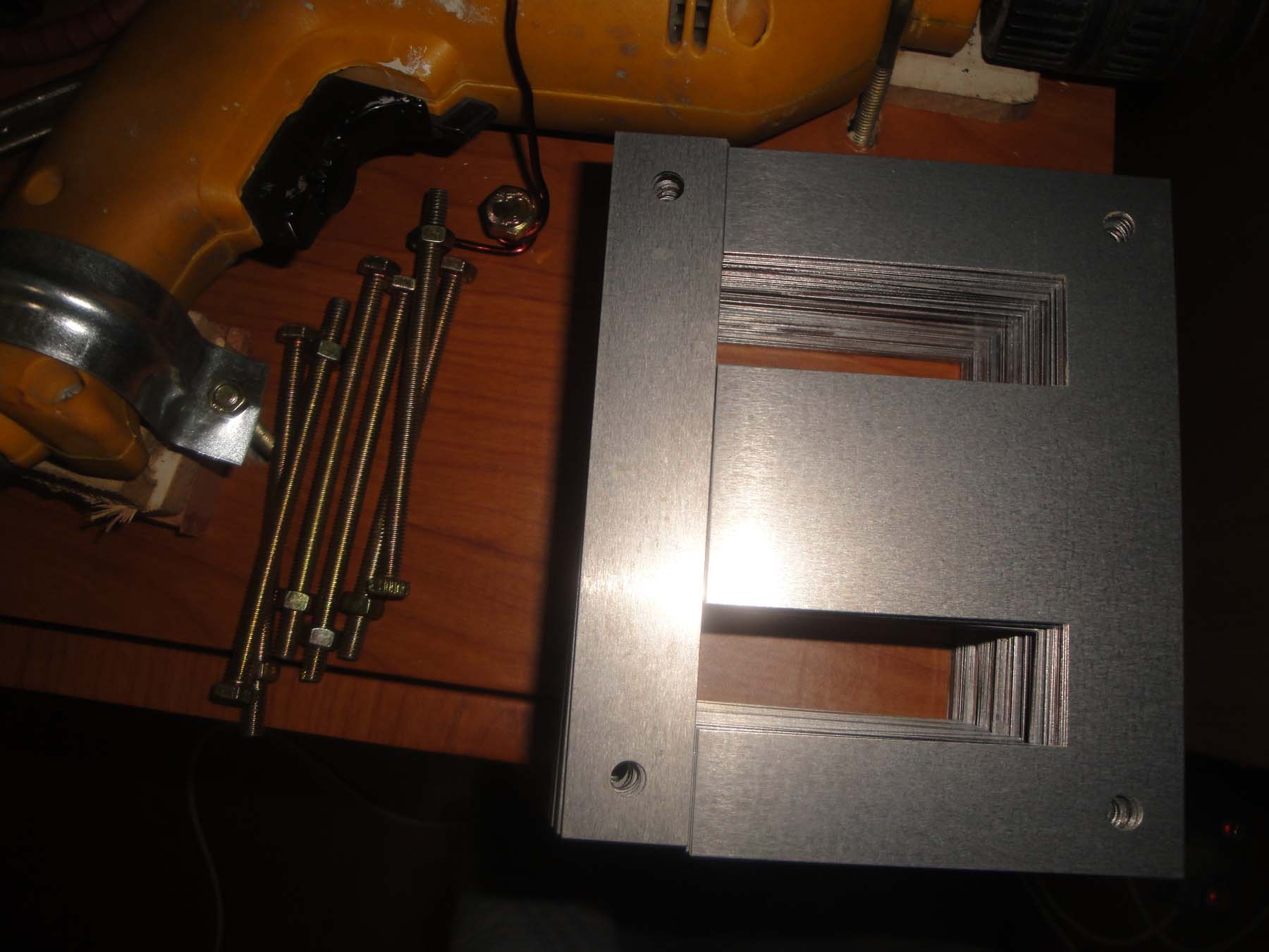

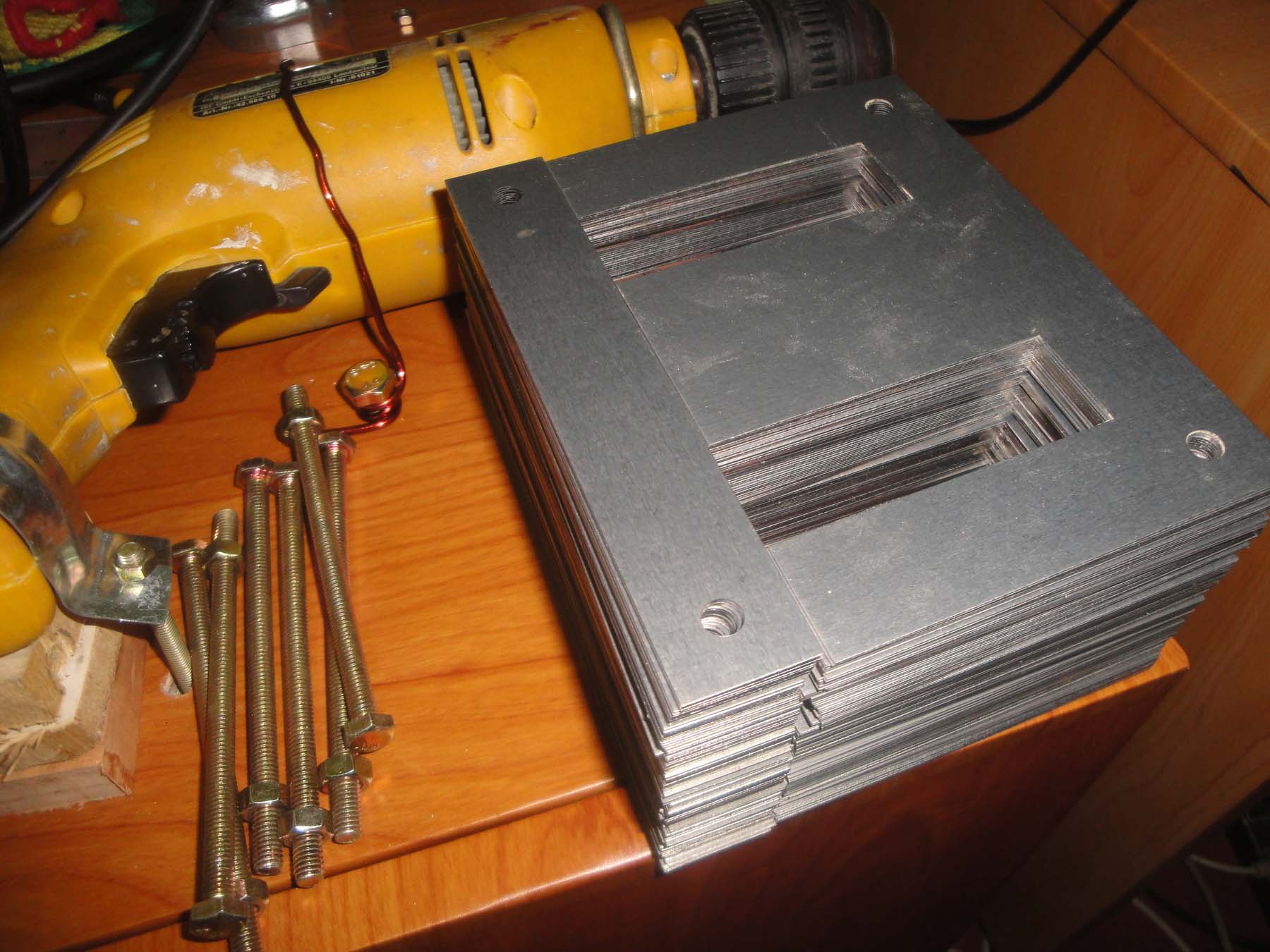

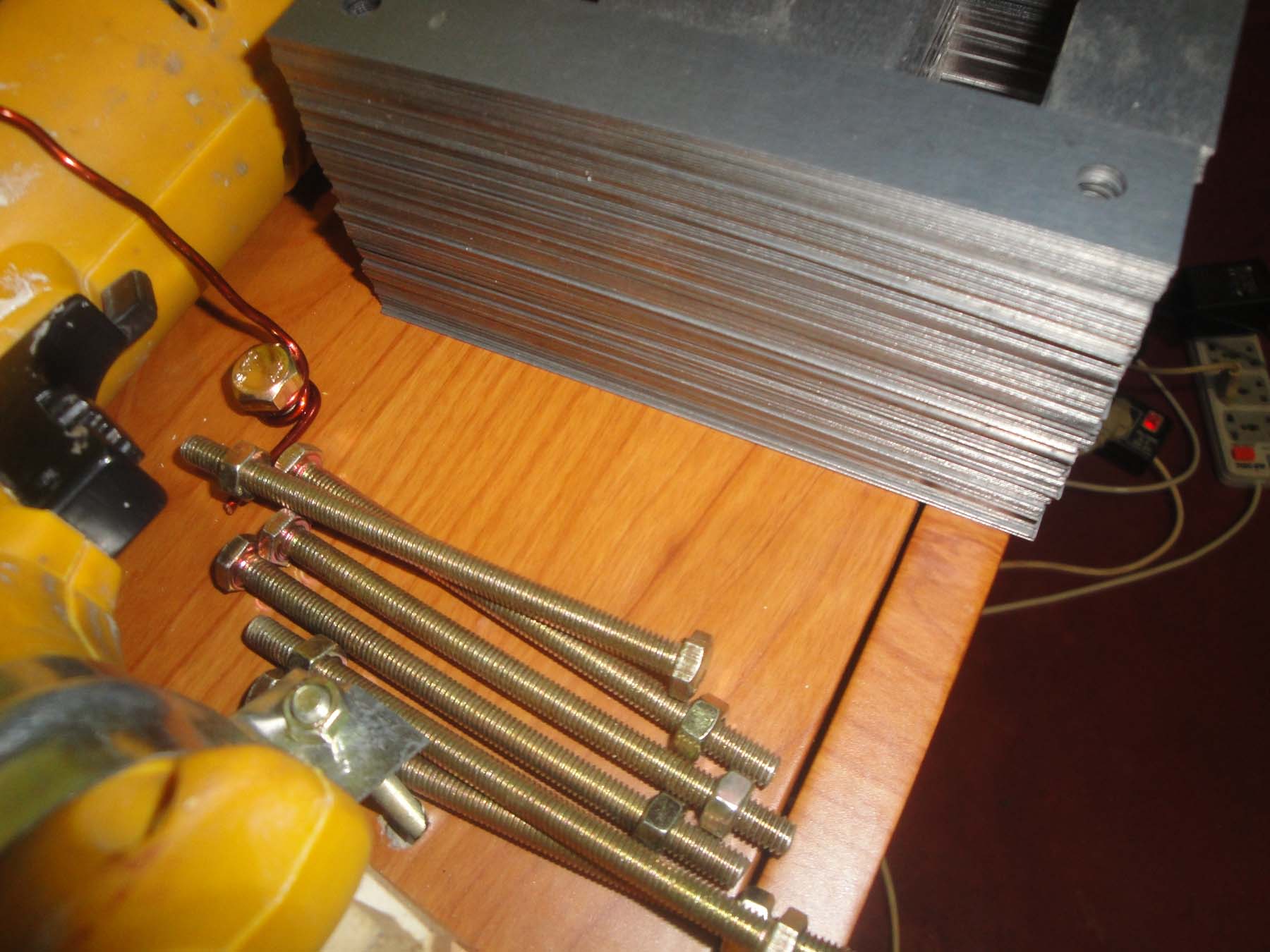

is this bolt and nuts perfect for lamination tightening?
it is galvanized bolt and nuts. 4 inch long.
hi tony,
yes, that will do.....look for shoulder washers to use with your bolts and nuts, better to use them for cooler running traffo...

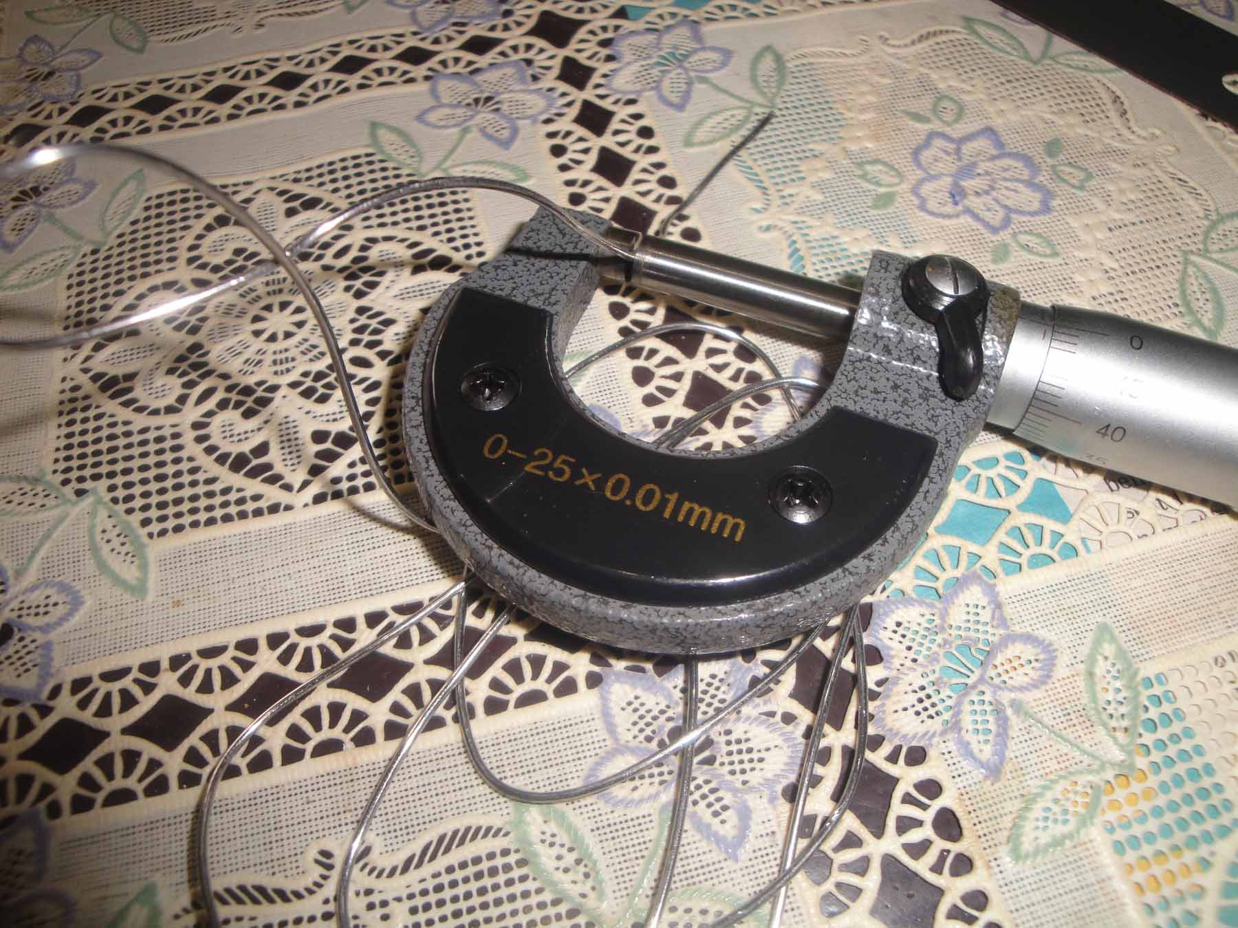

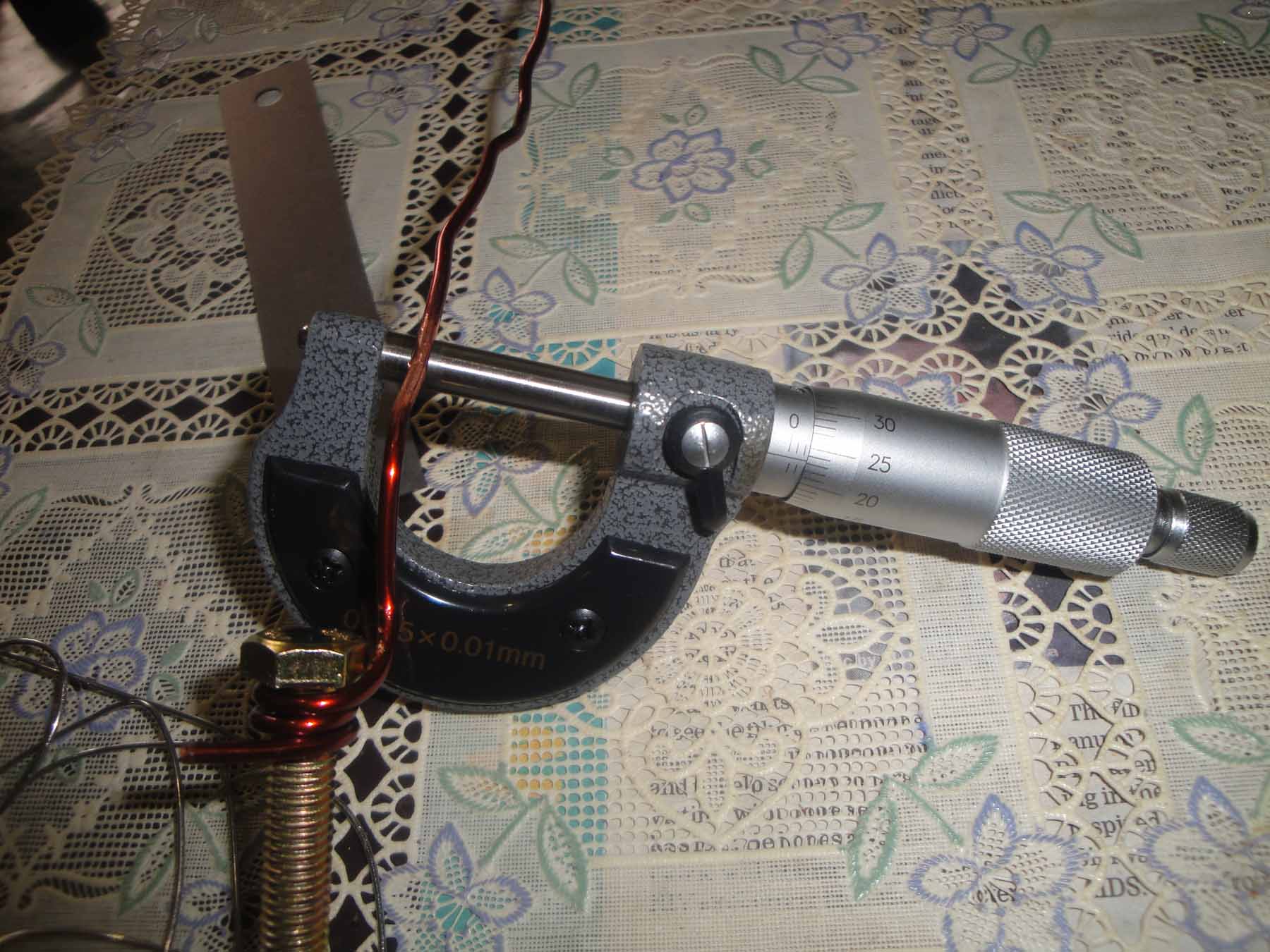

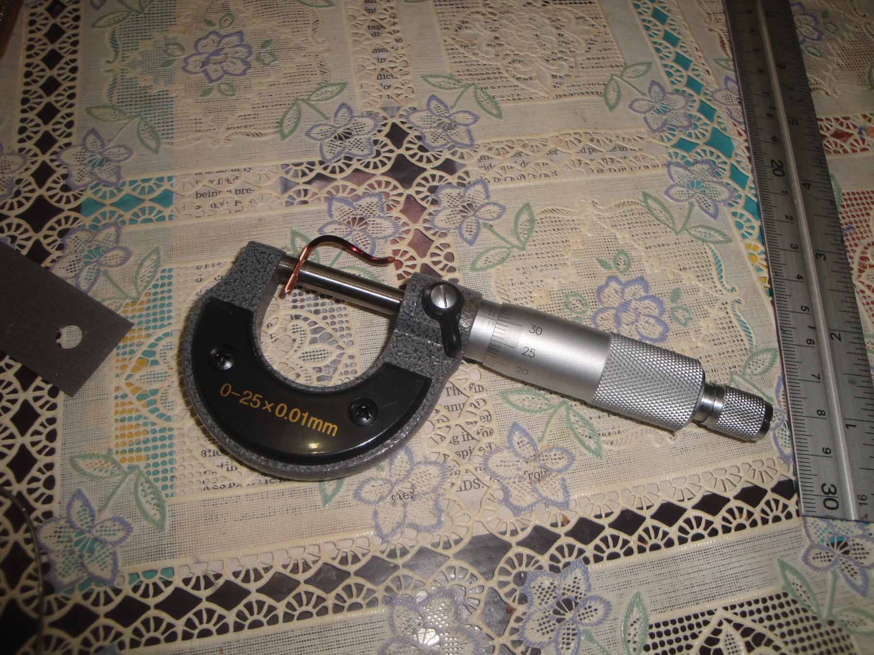

i am facing a big problem with wire gauges, i didn't ask wire size in mm, when i buy magnet wires, i asked in gauges, today i bought a micro mm measurement tool and measured the gauge no-15 it shows 1.80mm, i checked the supplier chart and it shows 1.80mm, in ur chart, shows 1.45mm,
i already told u gauge no-13 hard to wind, i checked that one also, micro mm measurement tool shows 2.25mm , in ur chart showing 1.90mm.
i already wind secondary 42turns into 4 with 1.80mm gauge wire, i didnt wind primary yet,
so can u help me to solve this problem.
i am busy these days, because last days i am in my wife place,

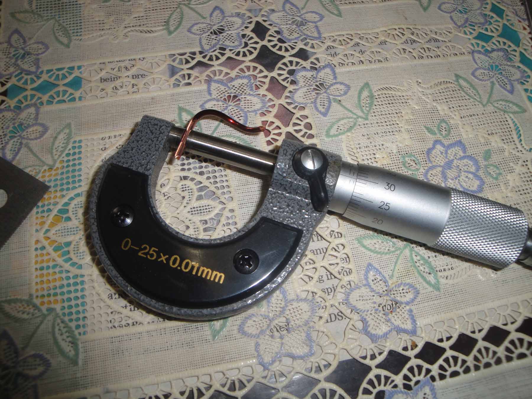

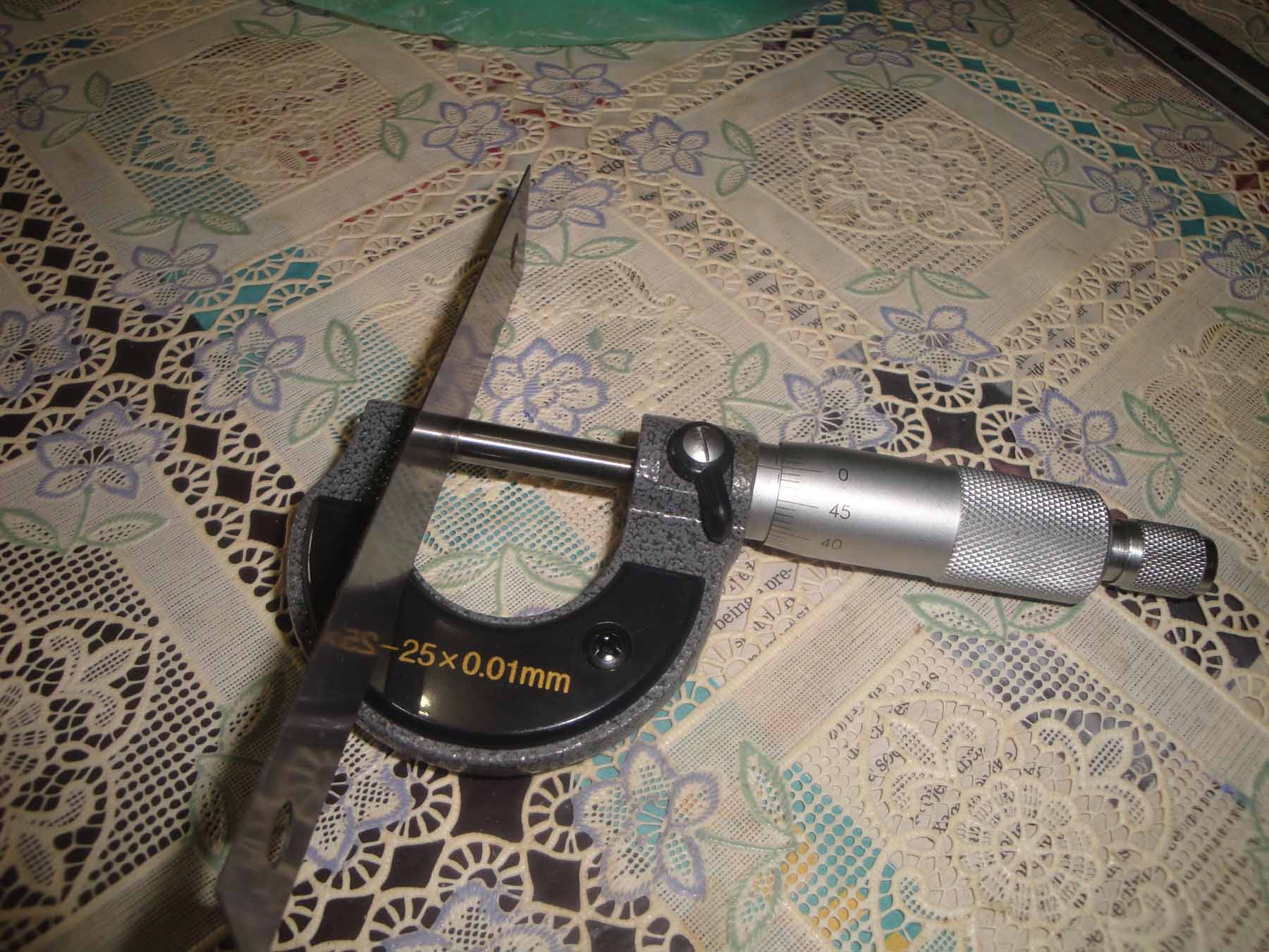

lamination thick is .5mm.
i remove the enamel and measure the wires.
i already wind secondary 42turns into 4 with 1.80mm gauge wire, i didnt wind primary yet, so can u help me to solve this problem.
that is because in India the British standard applies, while in Manila we use the American standard.....
so better get wires based on my table on diameter in mm....

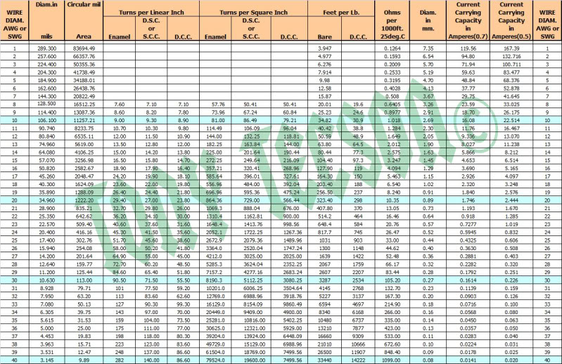

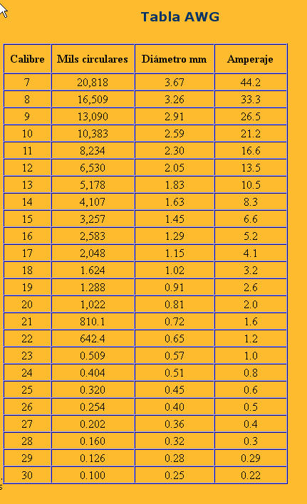

why this no-13 gauge different from both images. only no-13 is different.
in post no-199 u mention no-13gauge for secondary , is it 1.83mm or 1.90mm?
because in the images two charts showing two values,
so no-1.83mm is ok, can i use 1.80mm gauge, because in here 1.83mm is not available.

but u didn't tell the gauge (no-13) 1.83mm or 1.90mm.
i searched the datasheets for awg on the web the no13 showing 1.83mm.
you are better off with diams in mm as a guide.....as i have kept on repeating, we are not using the same standards wrt copper wire sizes...diameters vary because of insulation thickness there are copper wires that are single, double insulated, still others come with 5x insulations so naturally diameters vary......you don't worry about those things so much.... your goal is to stick those windings in....
you need a bobbin sized for 1 3/4 centre leg stacked to 4 1/2.....
you can get around 1740 volt amperes out of this...
primary turns = 233 turns #16 AWG magnet wire
secondary turns @30volts = 30 turns #13 AWG magnet wire, 4 coils, two bifillar windings....
in my country, the standard is AWG, please take note of this as you may have a different one in yours...
