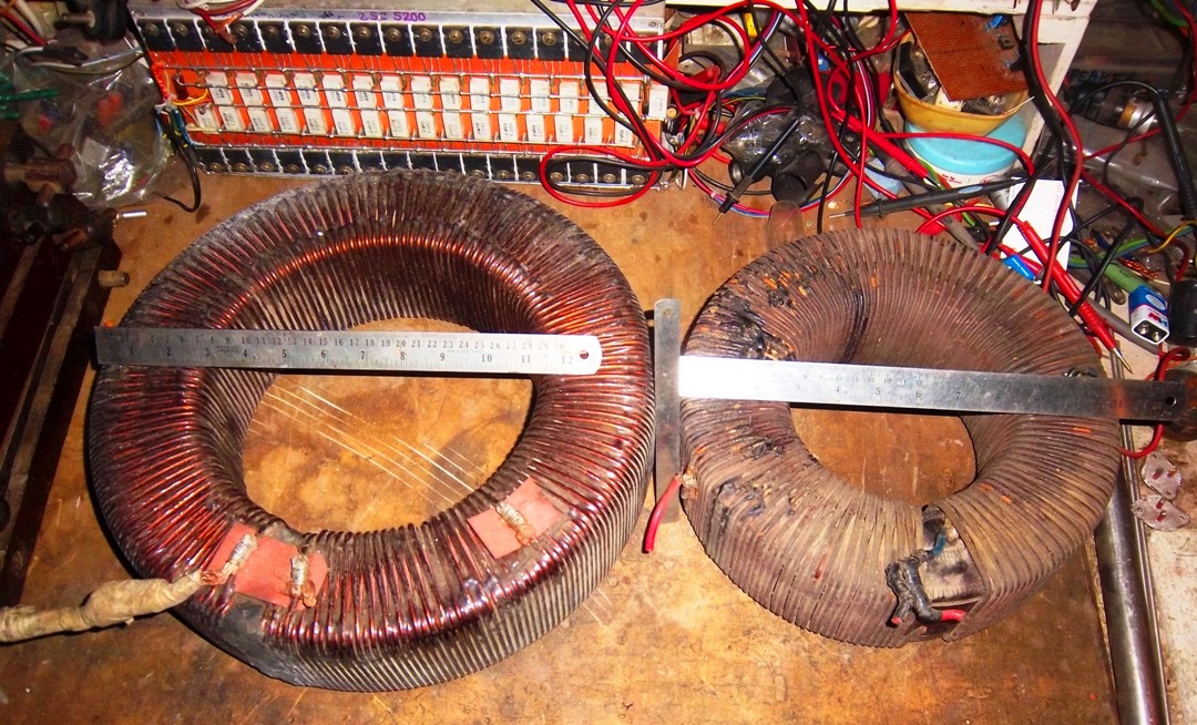

2 small torrids I bought
Attached with are photos of 2 torrids primary already there , 240 volts 40 ampere and other 240 volts 60 ampere,will varnish them tape with glass fiber cloth and than secondaries, already bought 10 s.w.g. 15 k.g. for secondaries.

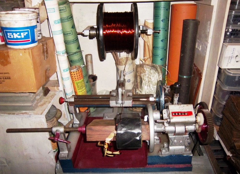

my modified traffo winding machine
This Machine I bought as scrap, cleaned it,increased the height of posts fitted it tuned it painted it, and fitted with D.C. Motor worm gear box,pulley and v belt now it is powered to wind traffos core section of 4" X 8" , 2 nos. 12 s.w.g. wires tightly it can pull with ease
