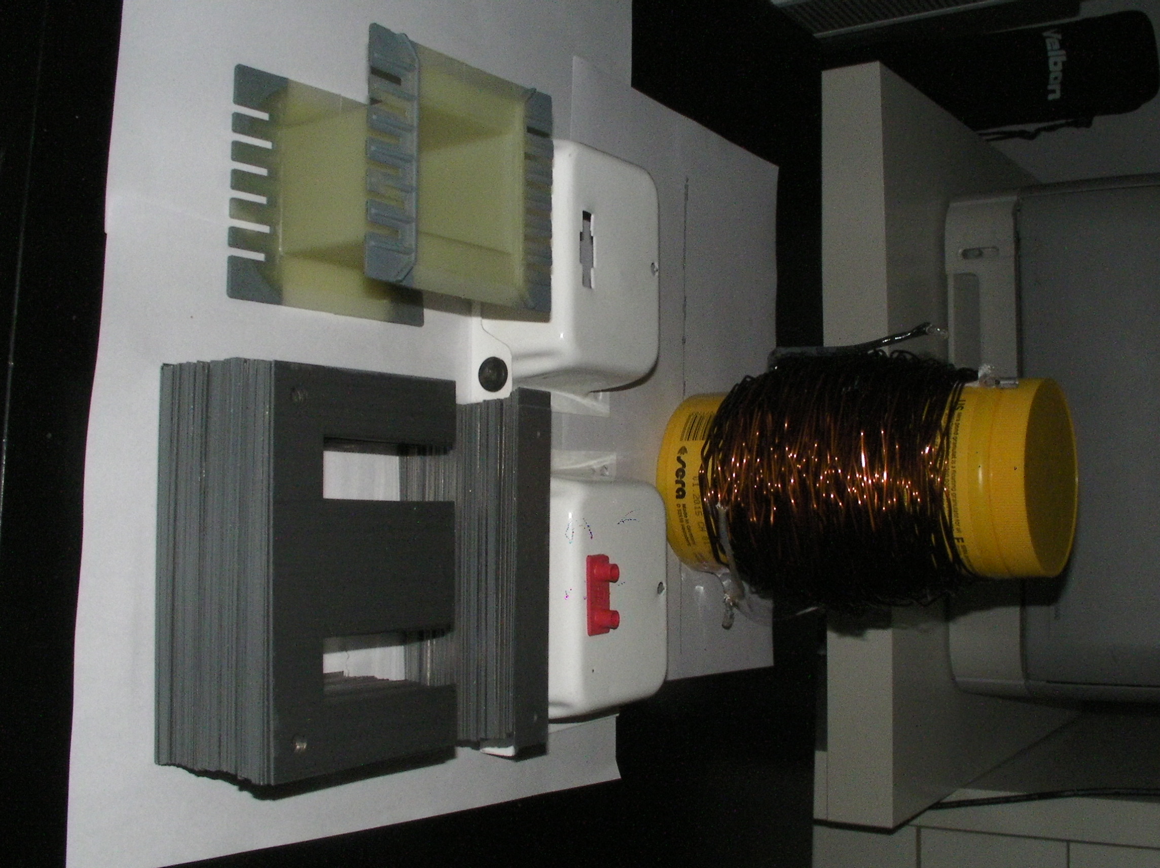

I'm referrring to 10 Output Power transistors which is 5 pair to you, anyways thanks for your explanation.
AndrewT if it will yeild me to higher VA I will combine the two trafo as it has the same Size EI core.
You might have a problem with that because the thick core uses so much wire. Also the window or hole on the core only allows so much wire. so the window size places a limit on the total number (primary plus all secondaries) or turns. You may not be able to fit all those turns unless you use smaller diameter wire. Then you have problems with DC resistance and current handling.

Sir Tony it's 0.5mm, I'm planning to use the trafo for Leach amp with 10 O/P tranny. Thanks.

I already dismantle one of the trafo i have, the bobbin size is 51mm x 42mm. I sent you PM for my requirements. I found this site interesting Practical Transformer Winding, what do you think of it?

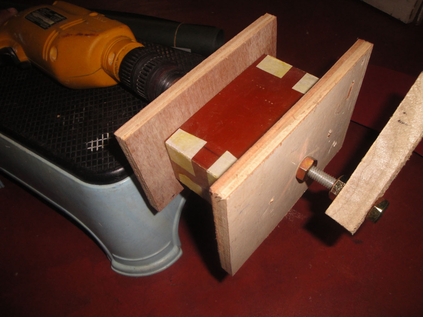

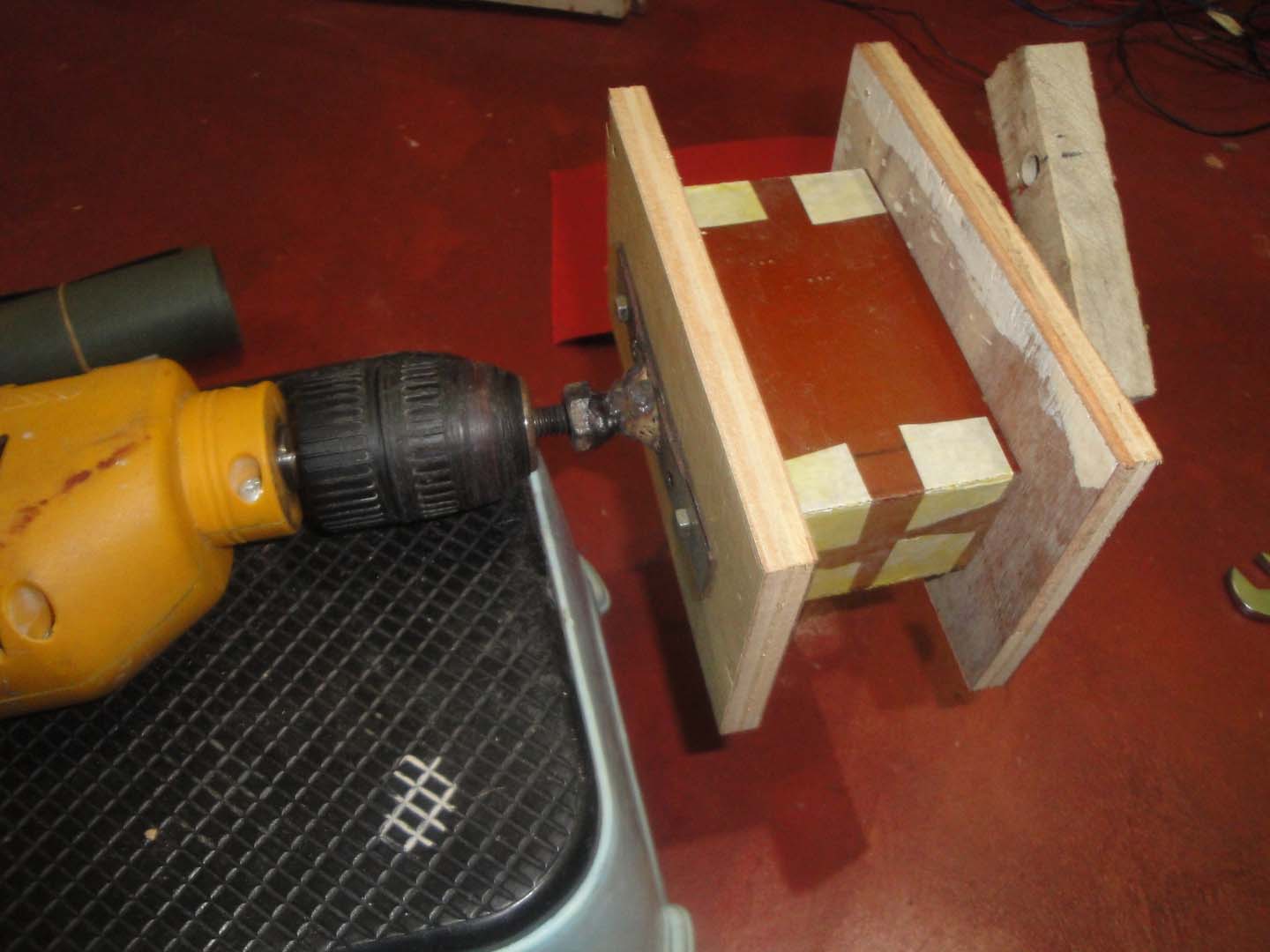

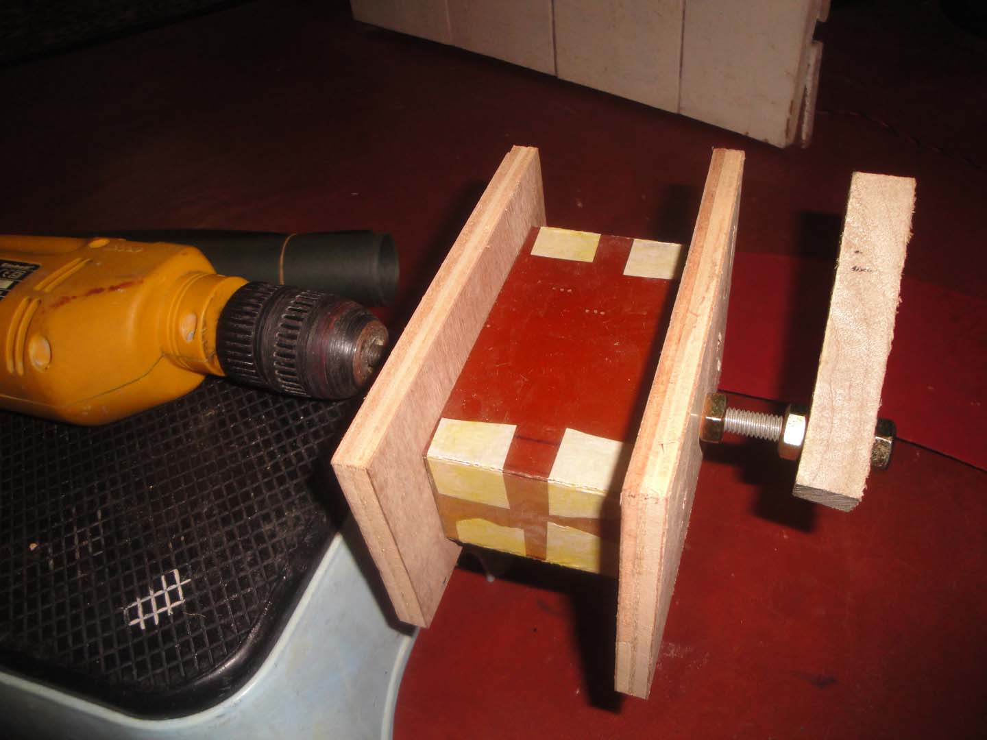

when winding traffos with wire sizes as big as these, i do it manually with the help of another....
hi tony,

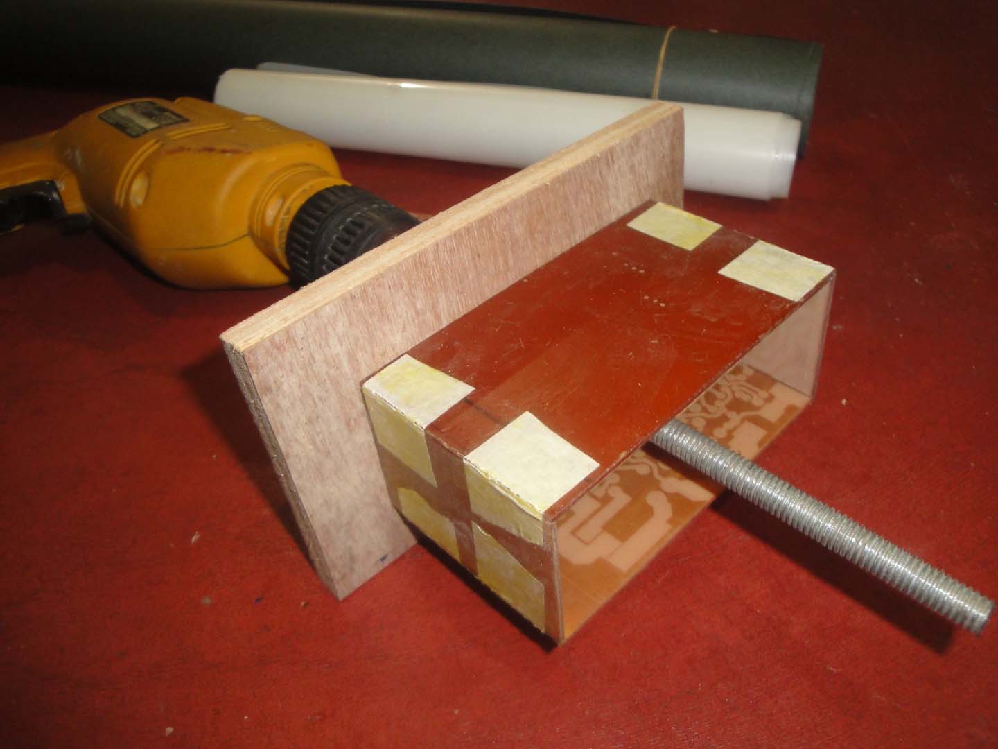

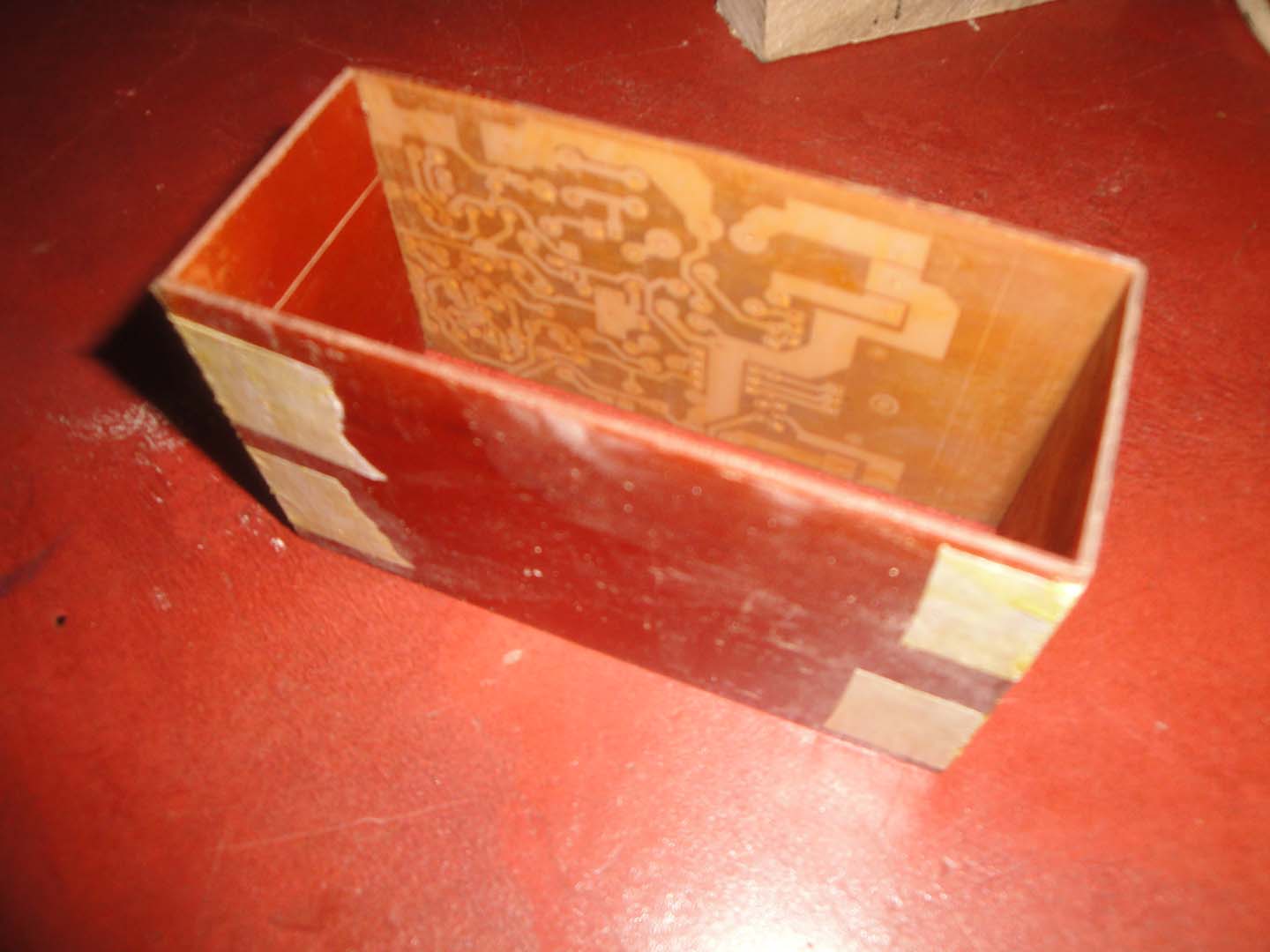

i made the bobbin with pcb board.
the problem is i cant wind the wire with straight.
the wire is very thick and i burn the wire with lighter, the enamel is not removing. i think this is good quality wire.
any method for winding this wires?
i will post images when my camera return from my friend.
the problem is i cant wind the wire with straight. the wire is very thick....

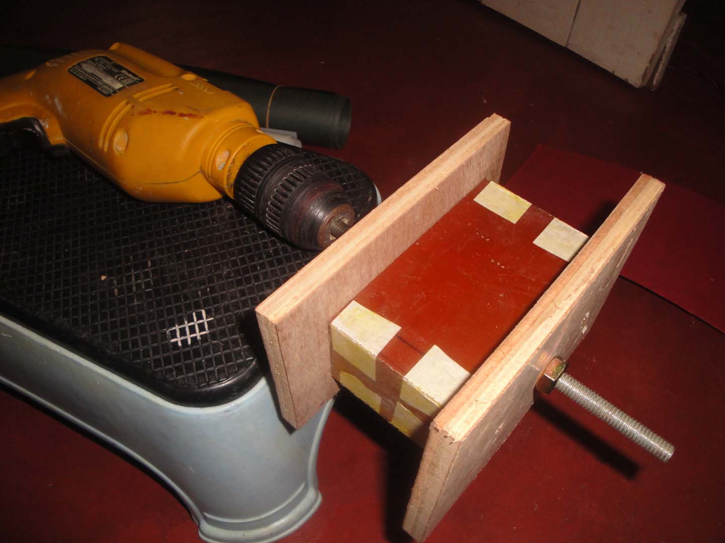

I think with thick wire some people use wood blocks and clamps to compress the winding so that it will be straight and fit in the core. You only have to compress one side, let the other get larger.

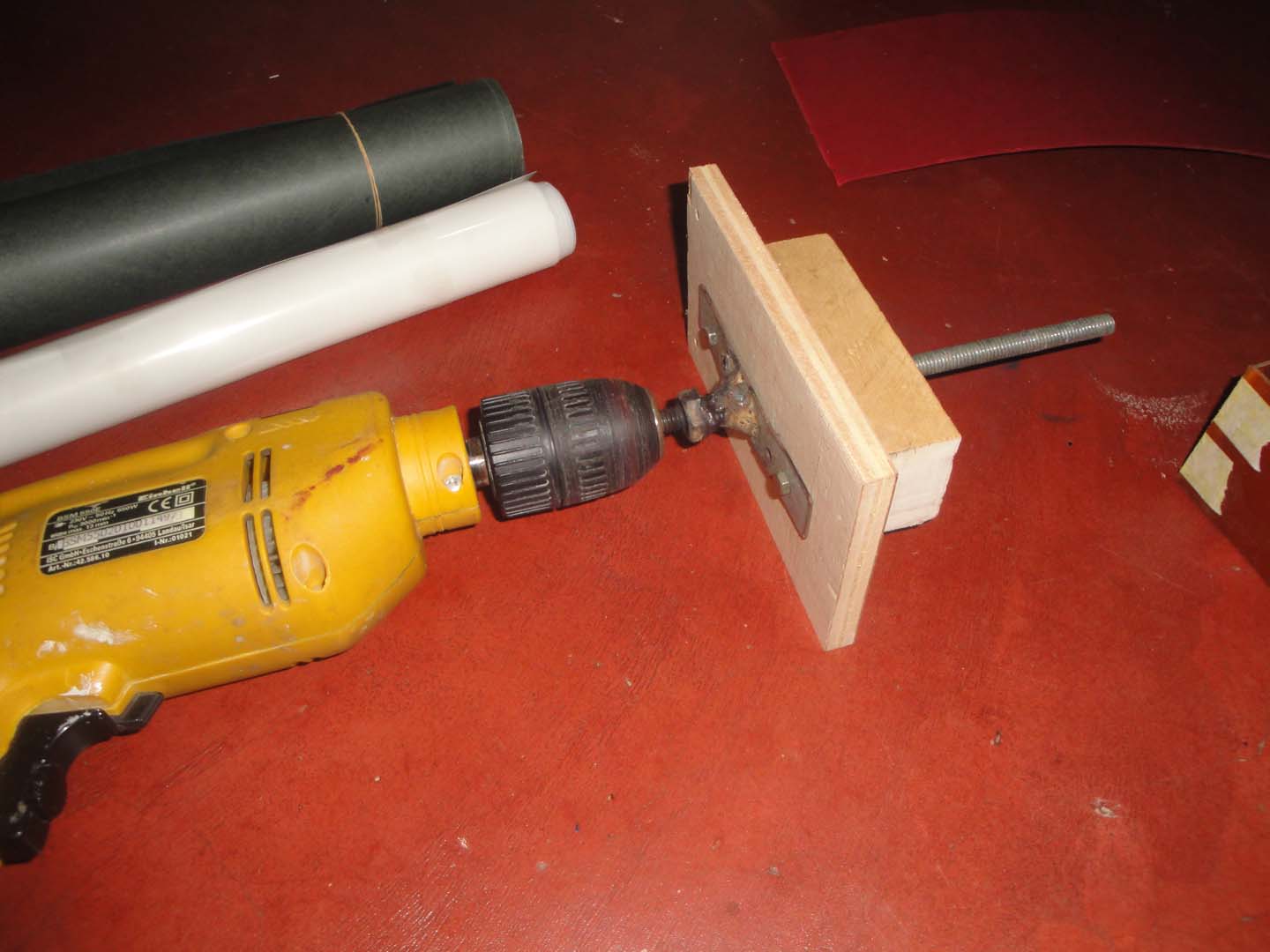

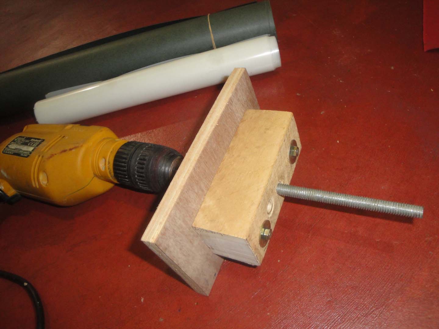

i tried with this jig.
the bobbin size is 1.75 inch centerleg, core stack 4.5 inch. i made with pcb board.
How did you get the drill to turn the bobbin slow enough, to tension the wire flat against faces.
I'd expect a slow drill to be 10times too fast !
i am not giving power to the electric drill. just hold the thread bar, and i turn the plywood box with my right hand, with left hand i slowly giving the magnet wire.
