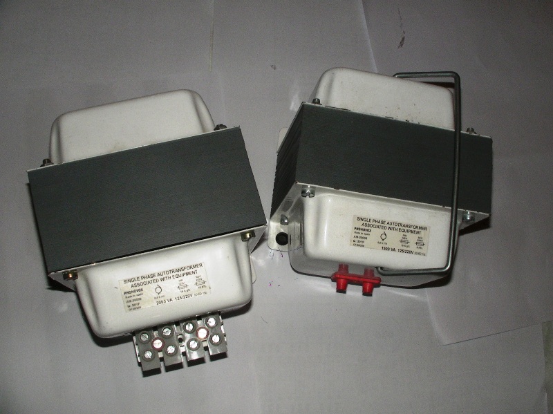

Winding my own trafo
Hi to all.
Buying a new trafo is expensive, since i have two stepdown(220->110) I'm planning to build my own with the below spec:
Input: 220V/50Hz
Output: 45VAC centertap
18VAC centertap
VA: as per the label it's 1000VA

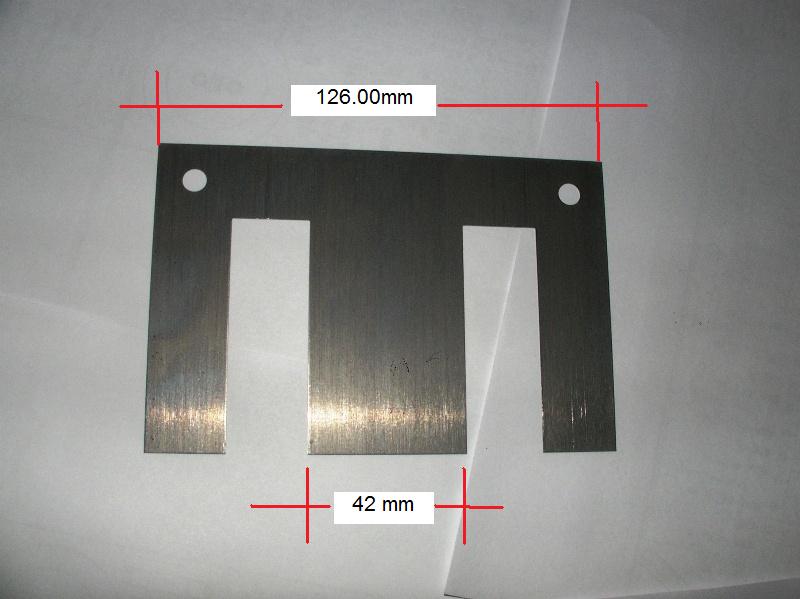

42 * 51mm = 2142mm² = 3.32sq in of core area.
VA ~ 31 * Core area² ~ 31 *3.32*3.32 ~ 340VA for the smaller stack and ~ [60/51]² higher for the bigger stack i.e. ~ 470VA.
Certainly not 1000VA.
If you added the two stacks together (not ideal because the stack shape is 42*111= very non square) you could get ~~ 1.6kVA. But there would be relatively small window area for sufficient copper to keep the resistances low.
87mm stack gives ~1kVA
