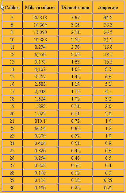

if i select 1444w, size lamination (3.8cm-10cm) in the below table.
turns per volt 1.1.
for 10ampere table shows 13awg so 120*1.1=132 turns for secondary.
for primary 1200w / 235=5.106ampere. so 235*1.1=258.5turns.
16awg 5.106ampere

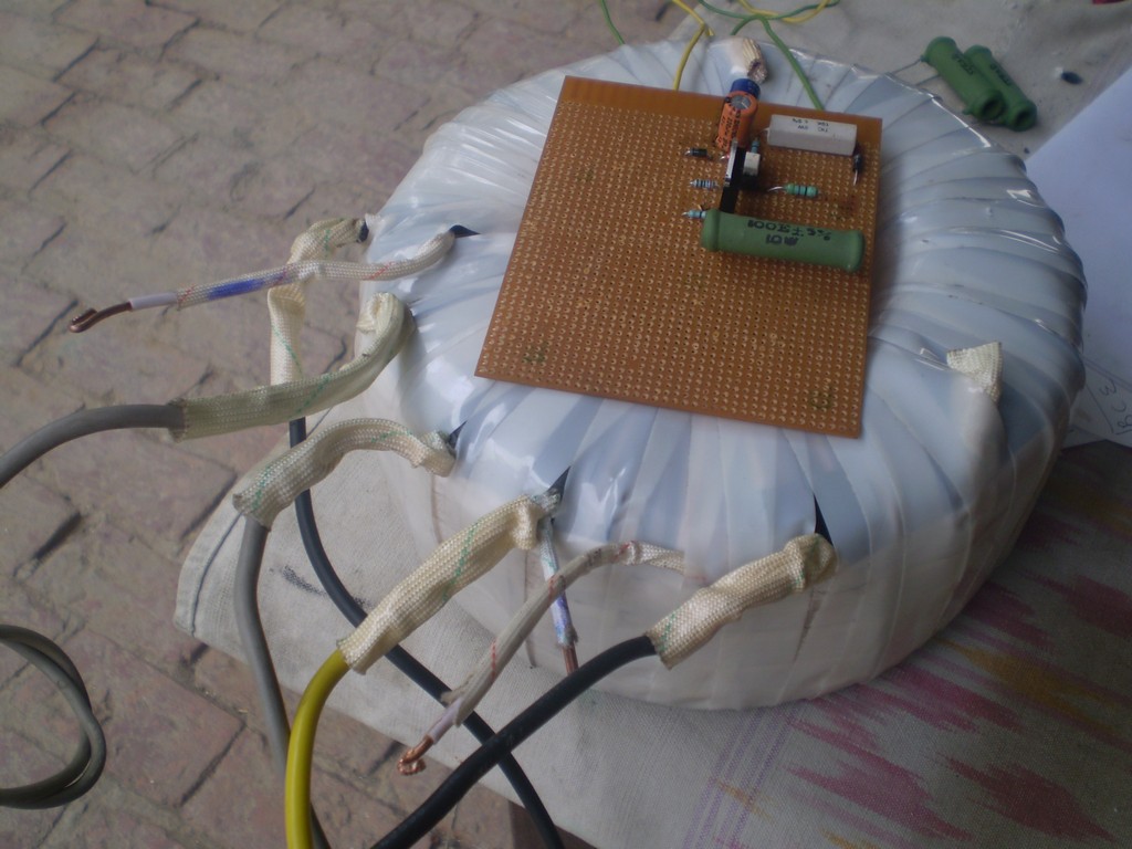

greetings thank you for guiding me to make my torriod
OD 21cm ID 10.5 cm height 10cm
primary 13 swg
secondary 11 swg
ac 50 0 50 and 60 0 60

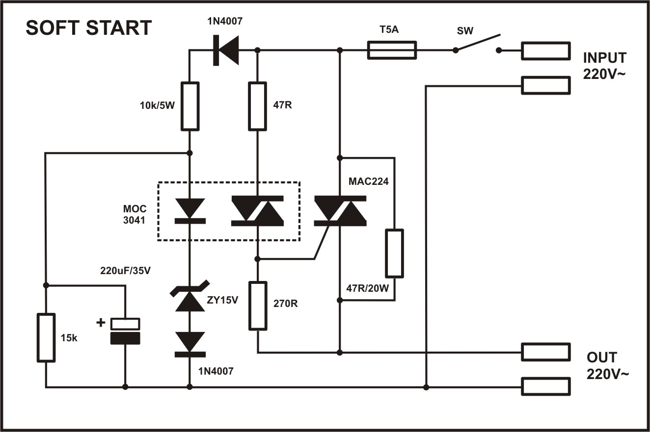

apex audio your softstart is good have to change 47 ohms to 50 watts
nice softstart
warm regards

Hi Tony
primary 13 swg
secondary 11 swg

nice job andrewlebon,
which softstart are u using? can u share it?
how many ampere of the torroid.
