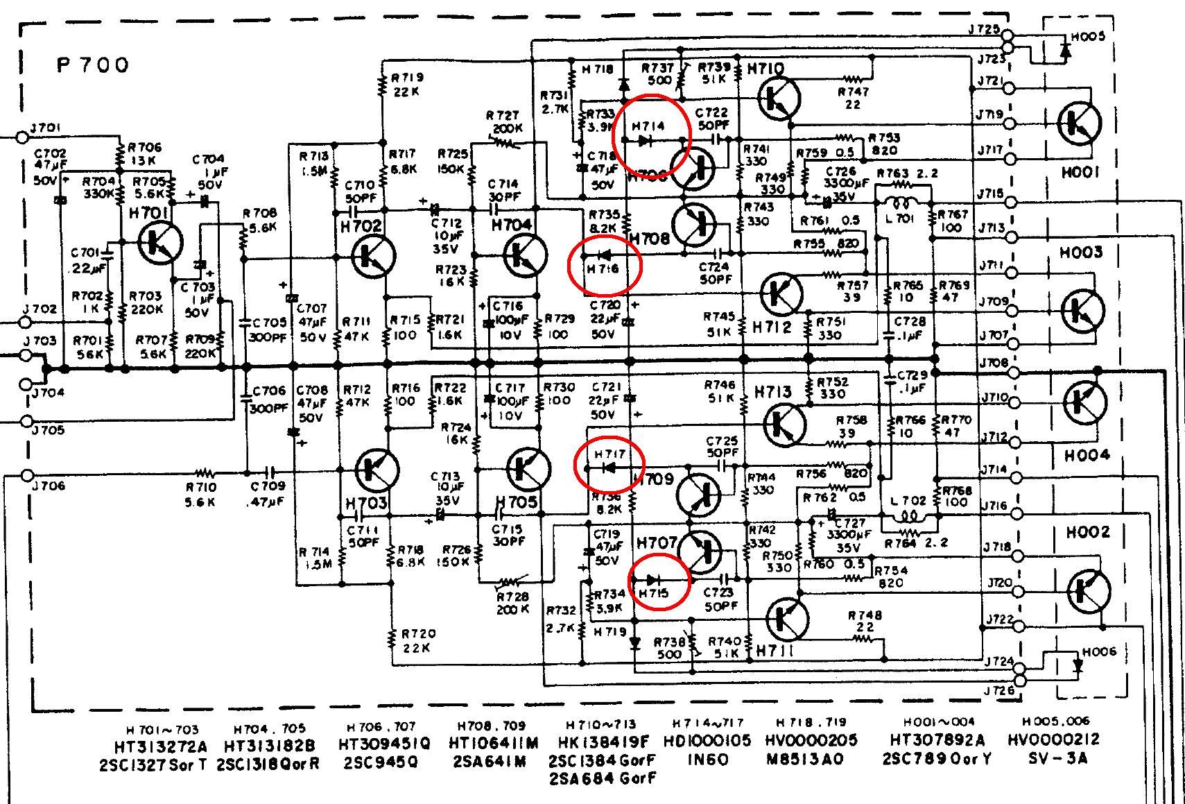

I tested the germanium diodes (1N60) from the power amp board. They have a voltage drop of about 0.38V - 0.4V and they all have a leakage current of about 3uA.
I have some BAT41 (0.38V - 0.39V drop), shall I replace them? I think they are for protection only.
Germanium do have high leakage and a low forward volt drop. That voltage sounds high for germanium tbh. Would have expected nearer 180 to 250 millivolt.
http://phys.thu.edu.tw/~mengwen/exp-electronics/datasheet/1N60.pdf
Seems ok, typical is 0.32V.
I read that BAT41 is a good replacement for 1N60 but depends on application.
I guess here for protection would do, but I would like to be sure.
http://www.vishay.com/docs/85659/bat41.pdf datasheet for BAT41 diode

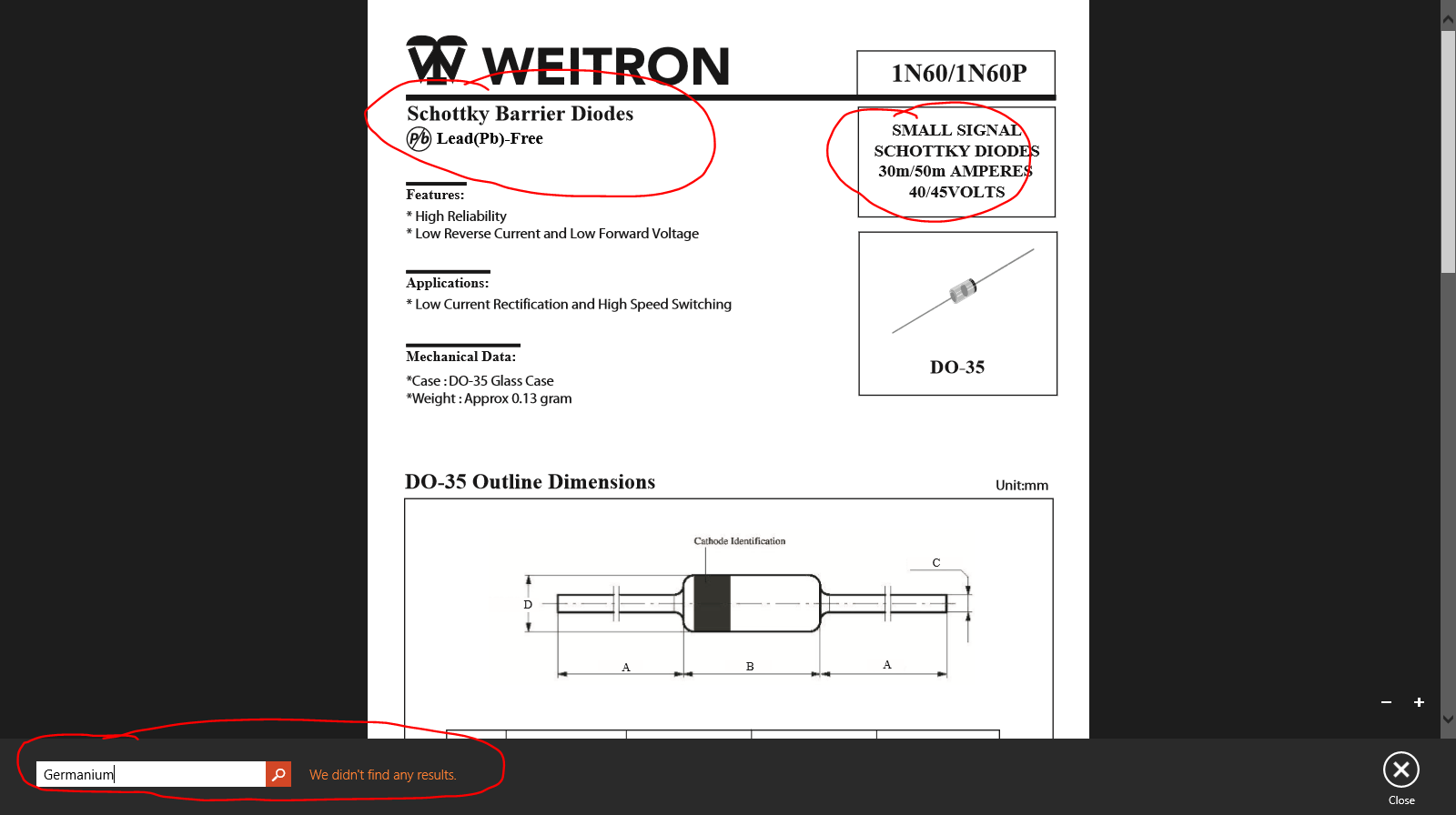

Oh now I see 🙂 the pdf that I posted is not saying it's a germanium. I found the original datasheet:
http://pdf1.alldatasheet.com/datasheet-pdf/view/78466/ETC/1N60/+W747JUCRC/1JOY9+/datasheet.pdf
It is a germanium. And seems to have a larger V drop of 1V at 5mA
Sorry I'm on my phone and the link must be bad:
http://www.alldatasheet.com/datasheet-pdf/pdf/78466/ETC/1N60.html
Link doesn't work for me.

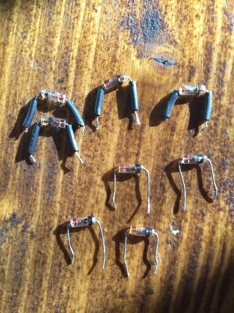

Your picture looks like a point contact germanium such as an OA47 type of device.
Yes I posted a link that is for mobile use. But I posted the good one. They must have kept the name for new production Shottky to suggest it is a direct replacement.
They look like germanium. Try connecting a 10k series resistor to one and put it across a 9 volt battery. Then measure the volt drop across the diode.
