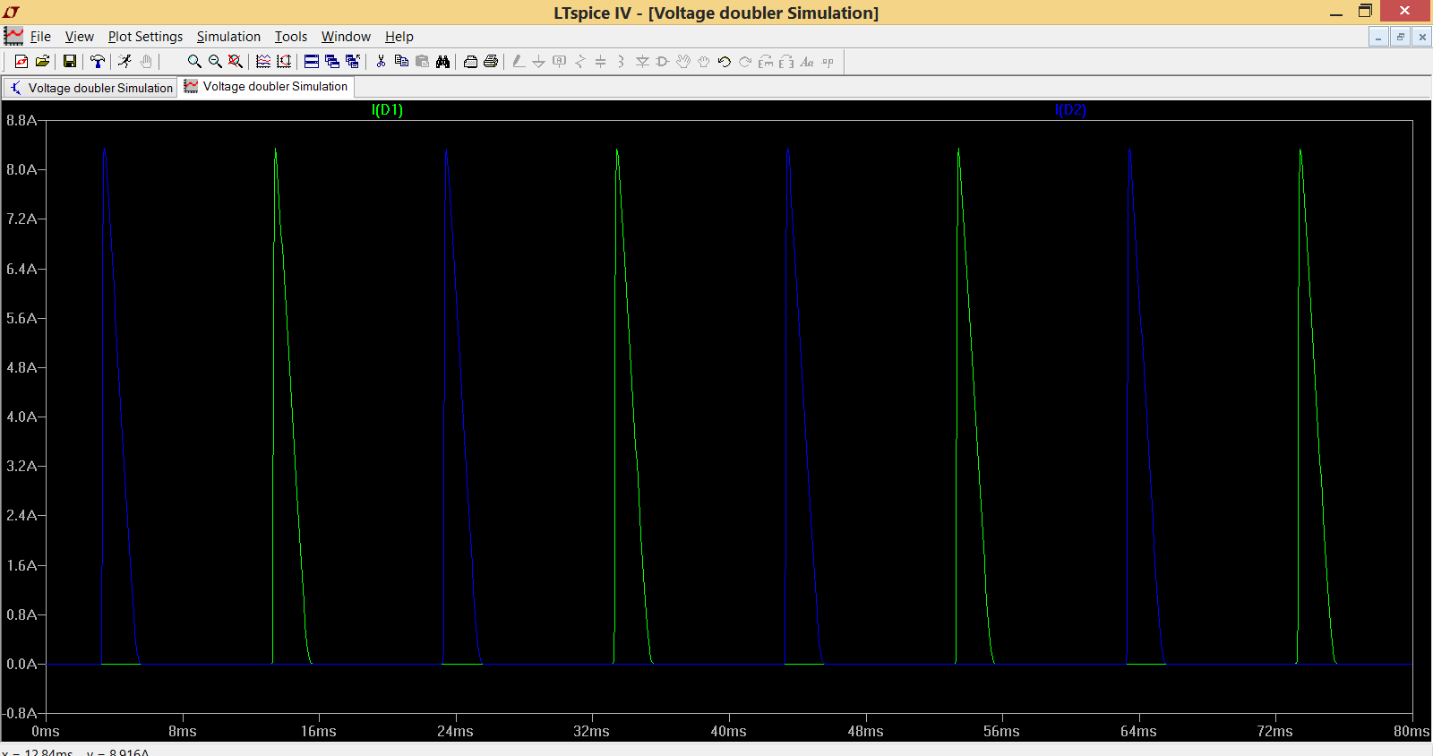

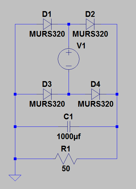

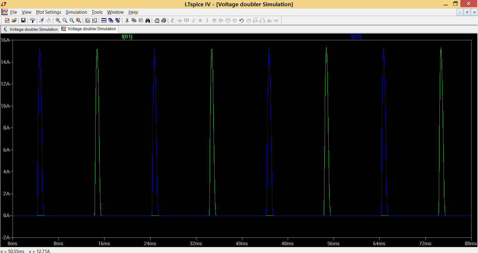

Here is a 50 volt DC supply feeding a 50 ohm resistor. So 1 amp is drawn.
The waveforms show the result of changing the cap from a 1000 to 10,000uf. Look at the scale at the left and also the shape of the current. These are for two of the four diodes in the bridge.
