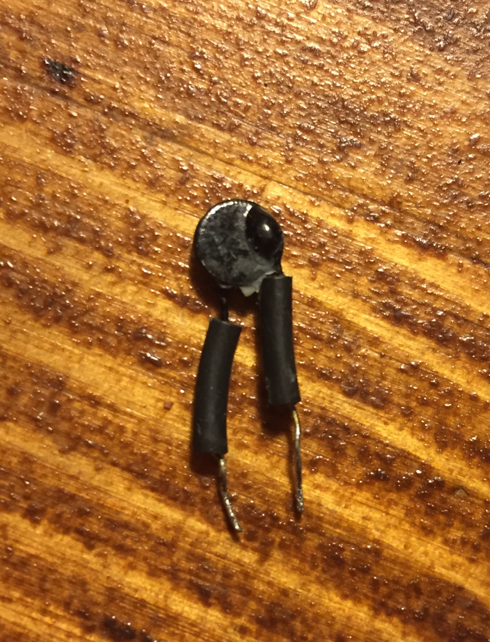

I started working on the power amp board and noticed something I haven't seen before.
There's this diode, M8523 A-O noted in the service manual, it's thermal coupled to 2SC1384 transistor, and when I tested it, it conducts both ways. But it's not shorted, there's a voltage drop of about 0.250V each way and varies if I hold it between my fingers. There are actually two of these diodes on one board, both behave the same and conduct both ways. Is this normal?

If both are alike I would leave it. thermal sensing of the output transistor stage is a good design feature; semiconductors usually have a negative temperature coefficient. But .25 v drop sounds like a germanium part, very obsolete. Don't lose or damage; these there won't be any more I'm sure.
More common is negative temperature coeficient resistance material, but again, getting a replacement with the exact resistance and temperature coefficient your board had originally is very unlikely.
Usually NTC parts are electrically in the stack between the upper driver and the lower driver transistor.
Its a thermistor not a diode. Refit them exactly as they were with regard to any thermal coupling. There purpose is to track and compensate the bias current as the amp warms. Without those you would get destructive thermal runaway.
Yes, some thermal coupler paste is good. General caution, the berylium kind of paste is poisonous, wash your hands afterwards.
I've been looking for some thermal conductive glue since my wires tend to pull the thermistor away from the transistor in my homebuilt packages, but until I do I've been using duco cement.
Cool, arctic silver aata-5g says it is a thermal bonding adhesive. Newark (farnell) stocks it but I had never heard of it before. I had a blown temp sense "stabistor" (dual silicon diodes in a tiny package) in my 1.3 kw amp, and it was glued in somehow, I just didn't know how to buy the stuff. Thanks for the name. It's a non-stock supplier direct ship though, that makes an $8 tube a $16 purchase if they use UPS and $22 if they use Fed-Ex ground.
Newark says they also have a thermal joint compound from them, which I suppose is non-adhesive.
I've been using WEP brand thermal grease from 30 years ago, a company probably bankrupt or merged out of existance by now.

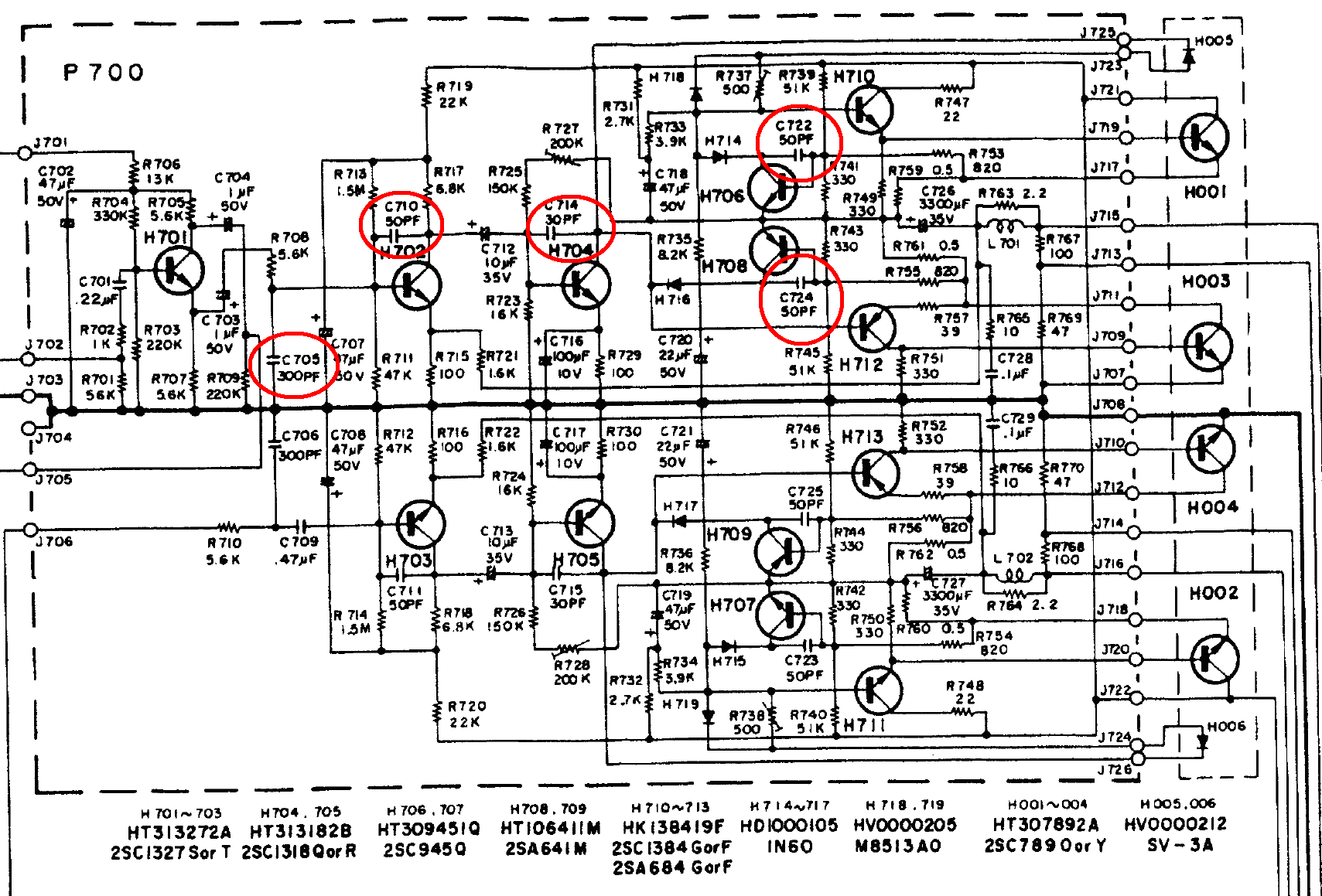

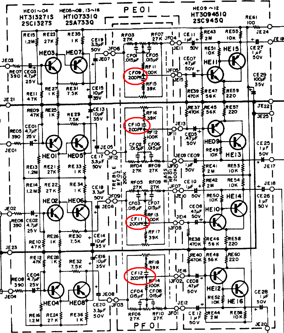

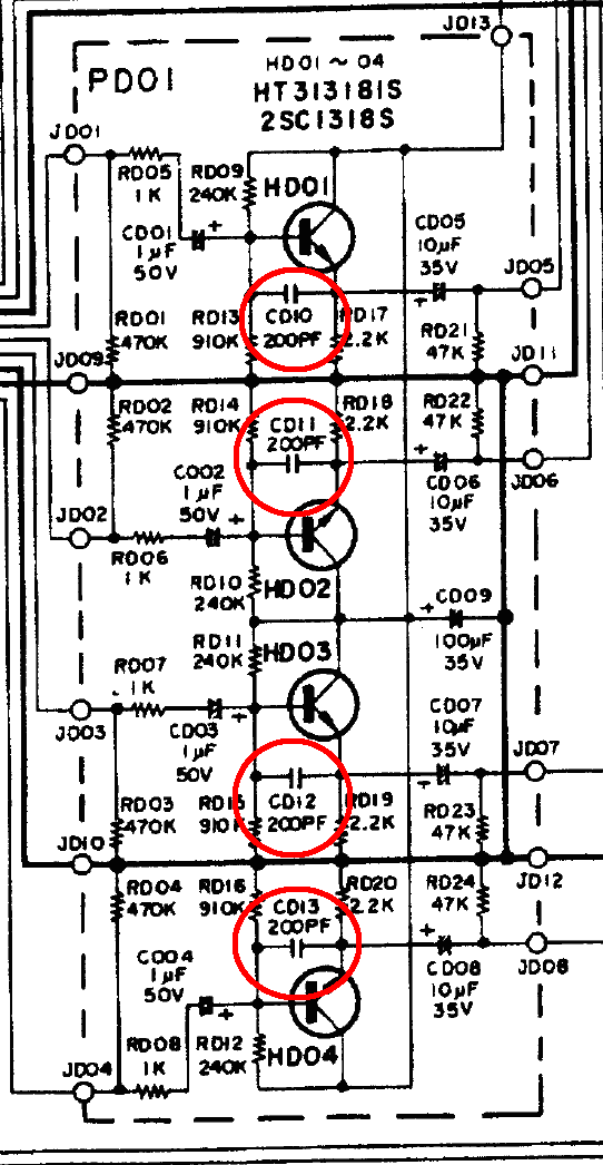

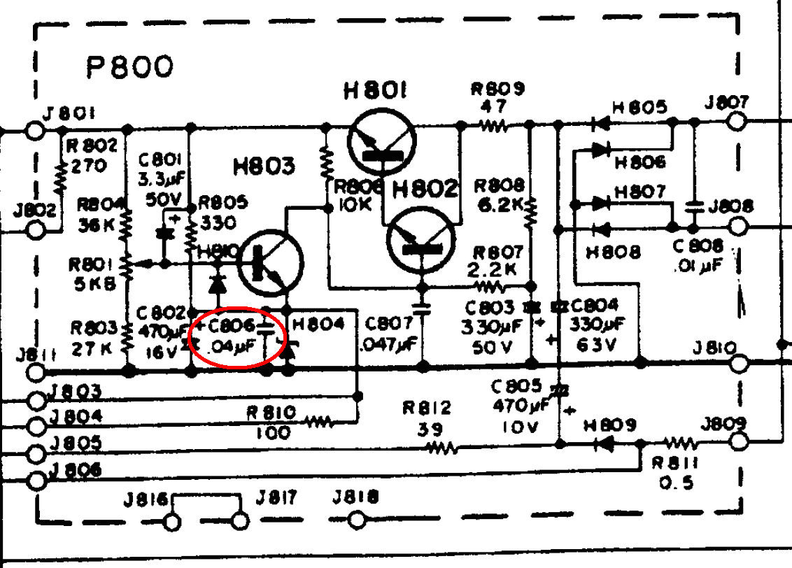

If I would decide to replace the small ceramics, can I use similar values? Like 27/33pF instead of 30pF, 47pF instead of 50, and 220pF instead of 200pF, or 330 instead of 300pF? I'd put some new C0G types.
I noted them on the schematic. If someone who understands their role/implication can tell me if it would be ok or not I'd appreciate that. It's pretty hard to find the exact values.

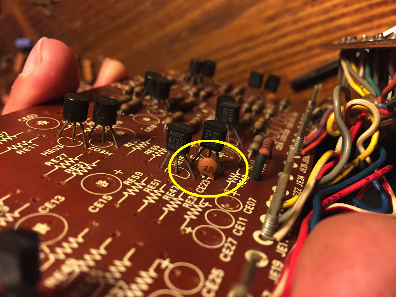

On the Tone board (PE01 not PF01) there's 4 small ceramics that are near some transistors, those don't appear in the schematic at all. Nor in the parts list. They are 20pF, I could find 18/22pF I think.
