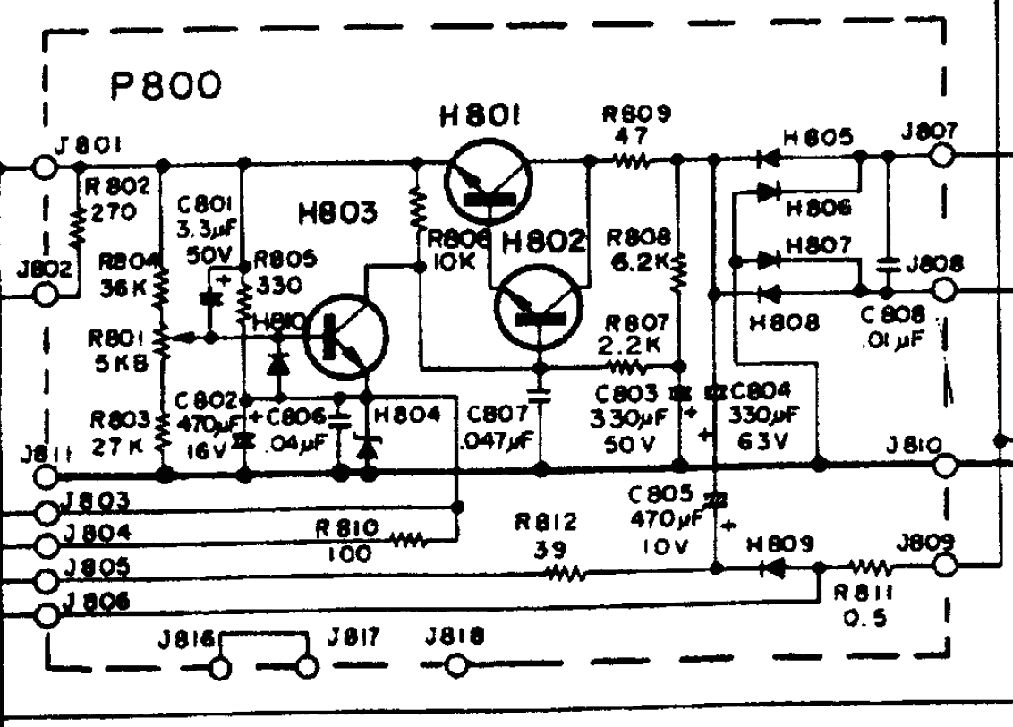

Many will say yes you can. You can go up a little yes but I wouldn't go over the top. Increasing the value means the rectifiers conduct for a shorter time (because the cap holds more energy as it discharges between cycles), however they conduct 'harder' drawing more current over that shorter time. That can in extreme cases cause transformer saturation (a little unlikely here) causing the transformer to run hotter and maybe be noisier. It can also increase any volt drops caused by the cap charging currents. With perfect layout and a perfect grounding scheme on the PCB's that is no problem. If its less than perfect then you could actually hear an increase in residual 'hum' on the speaker feed.
C802 is a brute force large value cap across the zener reference for the error amplifier of the regulator.
I'm with gmphadte on this. Leave the original values. Why do you think they are unbalanced with a 470uf and a 330uf ? (C804 and 805)
