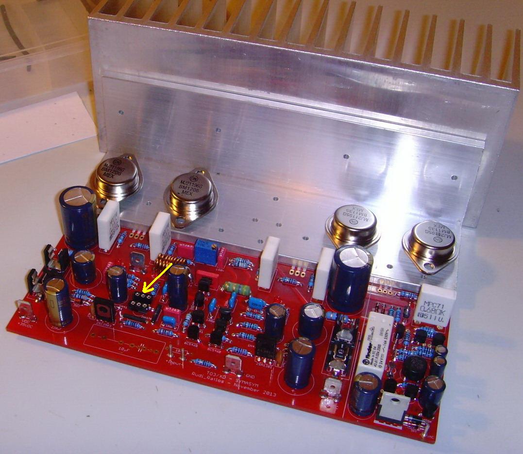

I have built a TO3-SYMASYM for a friend of mine a month ago using very expensive PRP-resistors (see image attached).
A PRP-resistor costs about 40cents (as compared to a 4cent-resistor, being offered by REICHELT, produced by YAGEO (formerly: VITROOHM), rated at 1% precision).
I did not hear the least audible difference, compared to my own REICHELT-resistor TO3-SYMASYM.

Rudi do you think the 2Sk170 transistors are mich Moore Bettler than the BC550C transistors? I ask because I want to buy man oft them to match them and a 2Sk170 costs about 0,7€ per piece a BC550C only 0,04€ per piece.

This is the way I do it (see attached image).
I do not solder the input-differential pair of transistors directly into the PCB but use a 6-pin IC socket (you have to cut it, of course!) and insert the transistors into this socket (be aware of the orientation of the transistors!).
Then I will use whatever transistor sweets my ears at its best.

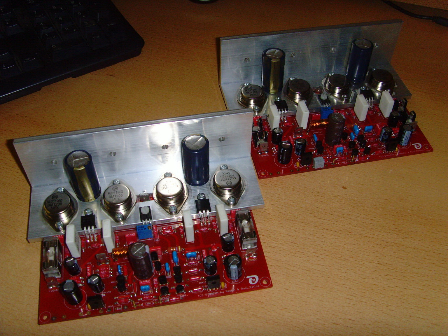

For resistors: yeah I know Rudi. I built my first Symasym Monos in 3 different Versions, all with the same standard Panasonic / Wima Caps. First block was Reichelt Resistors, Second one was Takman, Third one was Vishay CMF. From my subjective listening: No1 /2 no difference, subjectively a little more lively sound on the Vishay CMF SAS. Most impact was exchanging the WIMA FKS with MKP1839 MKPs Vishay Roedersteins and the electrolytics. Though, its not perfect... there has to be more deepness in sound, thats why I have "big plans" with this Symasym ;-)
My plan for this new Black Beauty:
- Vishay CN60 where possible, rather good to source them, only 0,25 € per piece
- 100nf Caps totally Vishay Roederstein MKP1839 (will be a tight fit in some locations), not yet sure about the other foil resistors but they will for sure be PP, nothing else
- The 4 0,22 / 5W Resistors will be replaced by Isabellenhütte PHB Managanin Resistors. Those are real cuties, 3W standard / 10W with cooling fins.
- Silver Micas for Mica Caps
Open questions are still: Electrolytic Capacitors... I am really bad in making decisions here... For sure its not going to be some boutique stuff like Black Gate / Mundorf / Daelund stuff. I was thinking about Nichicons / Elna (Silmic II / Cerafine) / Panasonic (FM / FC) ... definatelly need help here ;-)
Besides that: Wich Transistors should be matched? Besides the 2SK170BL's (and which Idss should be chosen here)

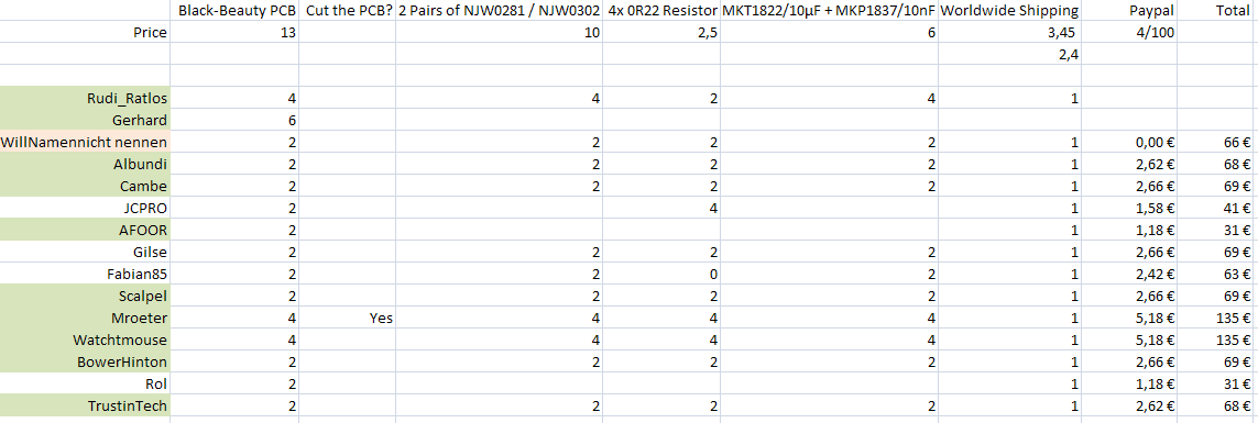

Hi Rudy,
Payment is send, for the Symasym, Black Beauty PCB (NJW0281/NJW0302) thanks for the time invested in this version.

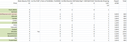

Put me down for two sets
Please put me down for two sets
4 x Black Beauty PCB
4 x two Pairs of NJW0281/NJW0302
4 x four x 0R22 Resistor
4 x MKT1822/10µ + MKT1837 10nF
1 x Shipping to USA
Break the PCB's: Yes
