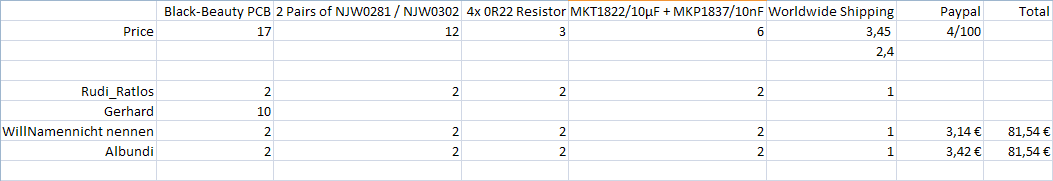

Gentlemen, find attached an update of your orders.
I have changed the SYMASYM's / SpeakerProtect's BoM to include insulating material and spaceholders.
The updated BoM can now be found at: https://secure.reichelt.de/index.html?&ACTION=20&AWKID=940016&PROVID=2084
I have included Silicon pads as insulation material.
Allthough some experts in this forum (like AndrewT. or FranzM) prefer to use MICA washers, I prefer the textile Silicon pads, since they are very easy to handle and the SYMASYM is not an "ultra-high power-consuming" amplifer.
(Please refer to Rod Elliott's article: ESP - Heatsink design and transistor mounting Chapter 7).
ATUPI: I am using two paralleled 2.200µF capacitors directly behind the rectifier to obtain "a low ESR capacitor". The big capacitor is used in the 0R1 / 10.000µF highpass filter.
I do not offer matched input-differential 2Sk170 transistors this time.
There are several ebay-sellers (for example) that offer them.
Best regards - Rudi_Ratlos

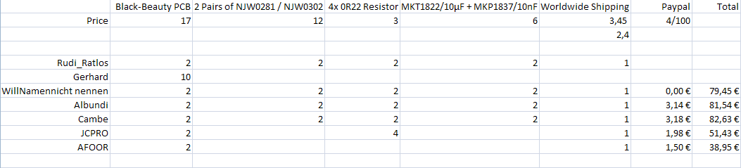

@Scalpel: I have attached the BoM as a .pdf - file.
I have already been told that I have included some resistor-values that are not used on the PCB.
I will discard them and give you the updated URL of the BoM on coming Monday.

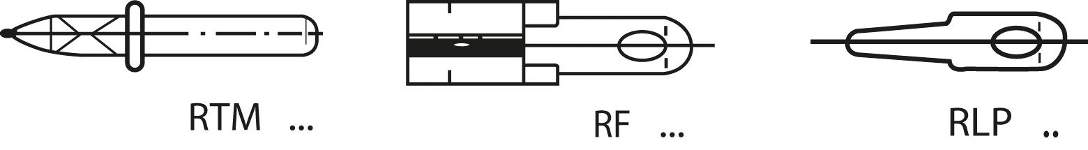

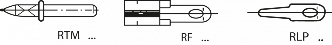

Please have a careful look at the BoM.
For example: I have included "Soldering Nails - Item No.: RTM 1,3 - 100" and "Solder Lugs - Item No: RF 1,3 -100" (see image below), which account for 5€!
The solder - nails and -lugs are used to connect to the RCA-input and measurement points (for bias adjustment).
If you solder these directly on the PCB, you do not need the nails and lugs and save some money.
Michael: since you do not have a PAYPAL-ID, I will give you my bank account of Hamburger Sparkasse.
I will close this group-buy on coming Monday (August 11th) and will then do a final quote for the PCBs and components.
Maybe that I will be able to decrease the prices a little bit.
I will then give you my PAYPAL-ID (resp. bank account) amd ask you to pay me until the end of next week.

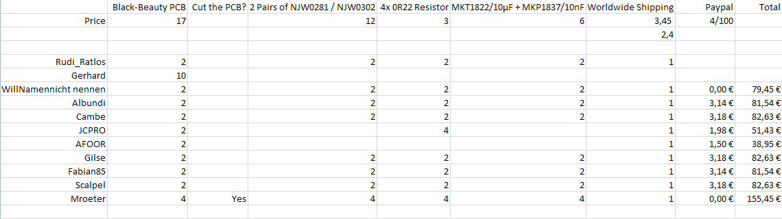

Find attached an update of your orders.
The column "Cut he PCB means": I will cut the PCB into 2 parts: the SYMASYM and SpeakerProtection on the one hand and the PSU on the other.
