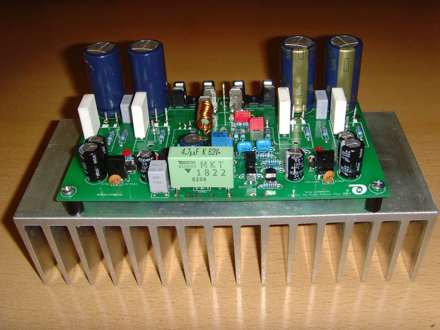

The SYMASYM PCBs that I offer base on Version 5.3 schematic of Michael Bittner's SYMASYM.
I have changed his schematic to include pairs of output transistors (TO3, NJW0, ...) to support speakers with lower impedance and to include onboard-CAP-multipliers for the frontend voltages.
You need to mount the output transistors, drivers, ... directly onto the heatsink, beneath the PCB (have a look at the image of my prototype).
I will of course send you all a drill-template.
Best regards - Rudi_Ratlos

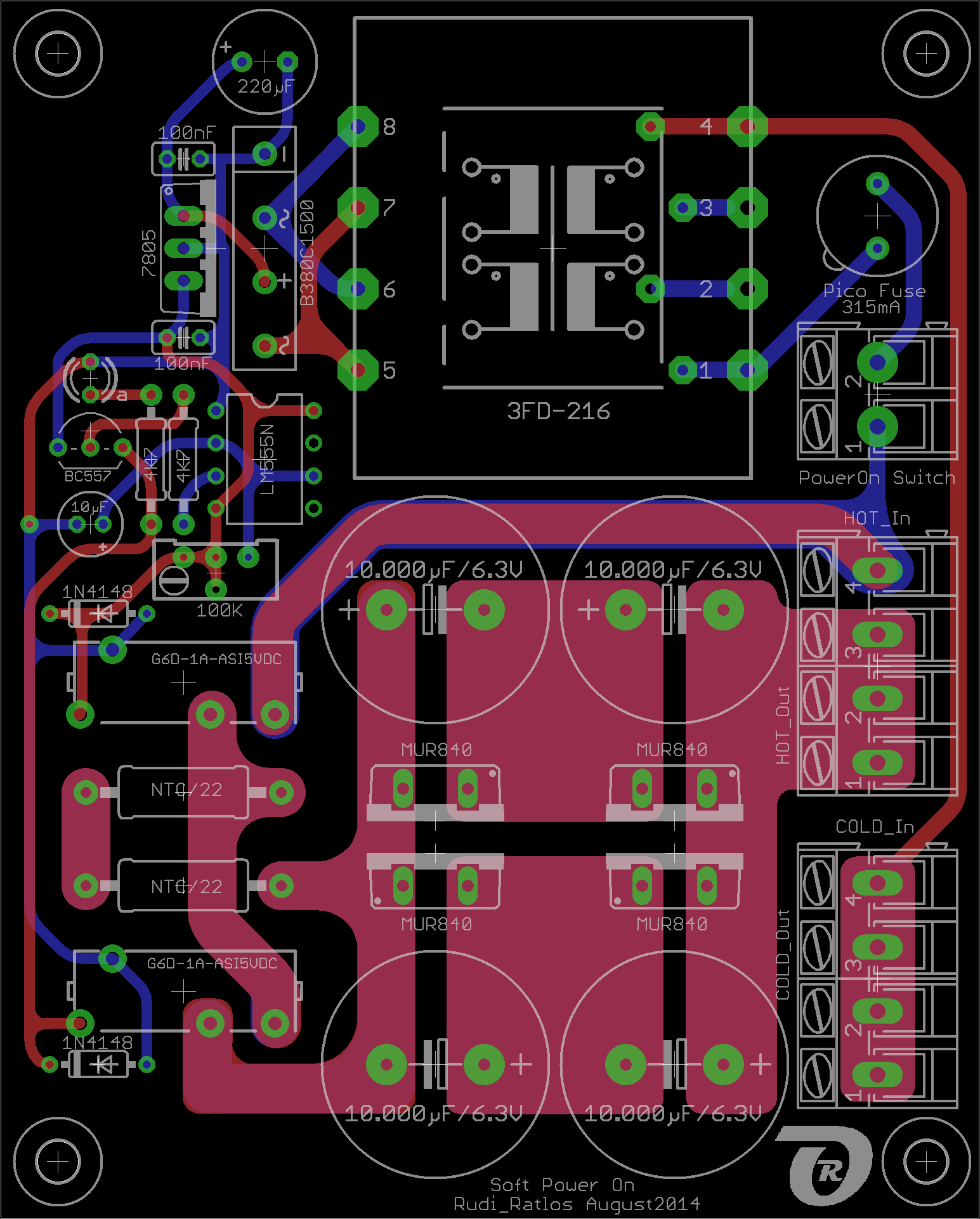

I have revised the layout of the Soft-Power-On PCB.
The schematic now includes a DC-mains - filter behind the Soft-Power-On circuit.
It uses a TAMURA print-transformer that can be wired for 230VAC/50Hz as well as for 115VAC/60Hz mains.
The PCB-size is 95 x 75mm. The price of a PCB incl. the TAMURA-transformer is 10€.
I have ordered 10 PCBs / TAMURA transformers.
Four of them are reserved for GISLE.
If you are interested (Fabian, ROL ?): tell me.

Fabian - the Soft-Power-On PCBs will be green!
Rudi
P.S.: It is not the colour, it is its functionality that makes this PCB so attractive - for the price being offered.
Rudi
That heatsink looks quite small... Is it sufficient to dissipate all the heat?
IF heatsink is not an issue, what would be the maximum configurations for the transformer/bias should I aim at? I am not sure if I would go dual-mono config, shipping cost for 2 transformers would be more than themselves...
