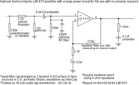

Hi Daniel,
I suggest you move towards increasing the input cap from 0.047uF to ~1uF.
similarly increase 22uF to ~60uF and 1r0 towards 4r0.
But, remember the most important rule is that the input filters define the bandwidth.
You should then find that gain and NFB values will have much less effect on the colouration.

On LM1875 pictured, I had wanted flat response till 43 hz and then minus 3 db somewhere around 30hz. So, of course I could crank the NFB gain along with the efficiency in an attempt to break plaster with hi-fi, and succeed. Great fun!! Thanks man!!

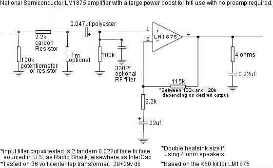

So, what remains for it is to change the zobel resistor from 1R up to something higher? OH!! Of course, its a polypro cap, which is a capactive load (1ESR + 1R = 2 ohm load), and so you're saying to make it a 5 ohm capacitive load instead?
Is that right?
National say 2r7 and I can't recall anyone saying it does not work. But I think that value is quite low for an output stage that cannot source much current. That's why I'm suggesting upto 4r0 but at least more than 1r0.change the zobel resistor from 1R up to something higher?
Yes! I understand that as the same as guidelines for a piezo tweeter.
Thanks for pointing it out.
I would like to keep the same frequency response for the zobel because I sure do enjoy the way this amplifier sounds.
Do you think that the cap value must change along with the resistor value for this?

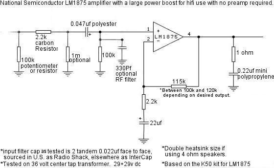

So, that above was very loud treble, and not where its most pleasant.
I tried varying resistor values, but except for the K50's factory specs (0.22uf polypro and 1 ohm), there was a problem.
Okay, so I tried 0.68uf mylar and 1 ohm. That's less load than polypropylene. It had the effect of a rather boring sound and all the brass instruments weren't represented right.
I tried 0.22uf polyester and got a similar effect to the factory layout, except that the effective pitch was too low. Nice clue!
The simplest solution. . .
So, I tried 0.1uf polyester, leaving the factory 1 ohm resistor in place, a very light load indeed, and it's got more "air" slightly more forwards, but yet very, very nice. Tripath hits the bin. More air! Lighter load! Nice bargain.
Andrew, thanks for the clues!
Here it is. For me, its like getting brand new ears. This does what I want from an amp, so now how do I drive a FET with it?

Dang!
Showing an unlevel frequency response now. A bit of screech on some popular music as well as less compatible with reverb because its making the chip get really hot!
I guess that the makers of K50 decided on a speaker output zobel of 1 ohm and 0.22uf mini polypropylene. . . for a very good reason. It sounds good. Well, I tried the options.

Questions for Nordic
Okay. I do have a question or two, though.
In order to make A-B comparisons using the same source equipment, C8 (input filter cap) goes random unless R1 (input in-series) is between it and the source.
Its not necessary to move R1 though because an additional resistor could just be added between capacitor and source.
I need to protect that capacitor against external effects before I can successful A-B test the amplifier.
How would you like to proceed there?
There are many who would like a potentiometer at X1. I'd like to simulate it during testing with an equivilent load. Should this additional load at the input be 22k, 50k, 100k, or 250k?
On R2, the input will overdrive before reaching 8 steady watts if the source hasn't already overdriven itself. Not everyone owns Lowthers. A lower value is needed for R2, before a comparison can be made. My best guess is 470 ohms, which should give about 34 steady watts output into 8 ohm speakers (with music transients at several times). Is this okay?
That's what would make the project interesting to me.
However, this conflicts so that C7 needs to be 100uf if C8 is 1uf so that the NFB isn't corrupted by a bandwidth limitation that makes a sound.
OR, if C7 is left at 22uf, then the input filter cap would be 0.22uf, which might be more appropriate for such a small amplifier.
Which would you prefer?

To Nordic
To Nordic:
My apologies! I made an error. Here it is:
"OR, if C7 is left at 22uf, then the input filter cap would be 0.22uf, which might be. . ." wrong. Sorry.
That, at the same gain, would make the shunting part of the NFB to 470R, and large DC offset. I apologise again! I had failed to check the National spreadsheet against empiric data.
The 1k is fine, but I need more gain--much more.
The "OR" suggestion should have been a lot of values of 47's and 1's. Its like this: NFB 47k, 1k, 47uf. Input 47k, 1k And, the 1k Rb (or another piece) positioned to protect the input filter cap away from the source--with that input filter cap, perhaps a tandem pair of 0.1uf (x2 = 0.22uf) for a flat response to 25 hz, with "down by 3db" at 15 hz.
That's also the gain that I need, one of the possible combinations for good hi-fi with good power, and I'd sure like to know what the rest of the design looks like in a "47k with 1k" layout or the (far above) "100k with 2.2k" layout (your choice, of course).
Thank you!!
To Nordic:
Thank you!!
You are trying to drive the chip outside of its know good parameters...
Firstly this chip is rated and marketed as a 20W chip, although National does admit it will reach over 30W on supplies up to 30W.
One has to ask yourself, at what cost to linearity and distortion...
What happens when the internal 4A current limit is hit? Or the SOA protection is activated? All of this without getting the thermal protection to jump in there and shut the amp down (at about 170C).
The closed loop gain set to 23 by the 22k (R3) and 1k resistor on the inverting input.
I.e. voltage gain = 23... ever thought what happens if voltage gain dictates to amp that it has to go higher than the supply rails?
The 22uf in series with 1k sets the lower end of the frequency response, and another factor is the 2.2uf cap and the 22k (R4) forming a high pass filter.
The result is a rapid frequency response roll-off below about 10Hz.
Following this is a 1k resistor and 330p cap to form a low-pass filter.
"In order to make A-B comparisons using the same source equipment, C8 (input filter cap) goes random unless R1 (input in-series) is between it and the source.
I do not get what you are trying to say. C8 and R4 acts as a filter.
Huh? the source is driveing a 1M load... is it powered off the falpping of butterfly wings?
R2 is simply forming the gain ratio as a simple resistor voltage diver in combination with R3.
Voltage over R2 = 1 23rd of voltage on output.
Voltage on pin 1 should equal pin 2 and so the feedback forms a control loop by trying to mimic the input on pin1.
Why keep the amp under 20W?
Because THD rises like a brick wall form the ground, just east of 20kHz.
measurements given are often not maximums, but conventional ways of comparing things. For instance the amp at 1W into 8 ohm, is virtualy flat in response from about 15Hz to just shy of 100k.
Go and try it, it would take less time to breadboard that circuit than it took you to type your worries....
That crystal clearness you think you are hearing is distortion...
