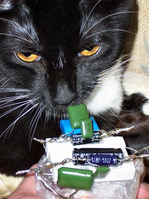

Edit: See fun pic of new speaker crossover using "bypass cap" to an extreme. Of these, the blue 1uF on tweeter, and black 10uF on woofer can't get bucked. This is for a laid back sound, with wide disperson, long throw and transparency. A side effect is that its a "live" crossover, shifting audio signals between woofer and tweeter, so it doesn't work well at close range. However, transparency is good at longer range (distance from speaker) than usual. Its an extreme application of bypass caps for larger-size rooms or PA.
