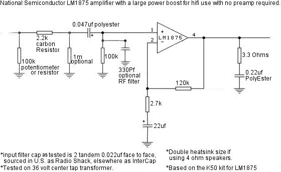

Wow. I'm a little embarrassed that I didn't notice that the GAIN was set to 53.3(!), during my earlier comments.
Daniel, do you have any test equipment, such as an oscilloscope? Distortion analyzer? It might be helpful for you to download, and burn a CD with, some audio test signals. Or you could use your computer's sound card, maybe for both the test signal generation AND the oscilloscope and distortion analyzer. There are free downloads to make your soundcard do both, although they are relatively crippled by the low bandwidth of the soundcard. But, even with just a voltmeter, you could measure the RMS amplitude of a lower-frequency sine-wave test signal, at both your input (source output) and your output.
Someone correct me if I'm wrong, but, it seems like, with your relatively-high gain of 53.3, and 29-volt rails, an input amplitude of only 0.106 volts zero-to-peak or so (only about 0.075 volts RMS) would give you an output amplitude of almost 5.7 v pk (4 v RMS), which would be dissipating about 32 Watts into an 8-Ohm load, and would then have 1% distortion. (See the graph of "Power Output vs Supply Voltage", on page 3 of the LM1875 datasheet. See, also, the graph entitled "THD vs Power Output", just above that.)
So, probably, with any input amplitude larger than 0.106 volts 0-peak or so, even though the output technically might have some headroom to go higher than 5.7 volts peak, for a short time, the result would be distortion (of the peaks, at least) that's significantly higher than 1% THD (which is already too high). It might be somewhat difficult to discern, with a music source. But a relatively-pure sine source might make it clearer, so to speak.
Then maybe you could try adjusting both the gain and the input amplitude, so that the output peak level always stayed the same, to see if you can hear any difference between different gain levels. (i.e. I think you would want to adjust both, to keep the output amplitude the same, to give a "level playing field" for evaluating the differences between gain levels, if that is what you are after.)

Someone correct me if I'm wrong, but, it seems like, with your relatively-high gain of 53.3, and 29-volt rails, an input amplitude of only 0.106 volts zero-to-peak or so (only about 0.075 volts RMS) would give you an output amplitude of almost 5.7 v pk (4 v RMS), which would be dissipating about 32 Watts into an 8-Ohm load, and would then have 1% distortion. . .
Thank you!
Yes, that's right. Power versus fidelity limit on the LM1875 chip gain seems to be 47.5 (gain).
However, (and in my opinion) the actual consequences of too high gain on LM1875, as in past 50, sounds like LM3886 at normal gain.
In contrast, LM1875 gives me the choice. What a relief!
See the clue I left "depends on desired output" straight on the middle of my LM1875 charts. I did mean "desired." 😉

I am puzzled. I don't know why anyone would want to use a carbon composition resistor in an audio signal chain. Metal film resistors are far superior, in every way I can think of. If the carbon composition resistor "sounds better", maybe that's because it is helping to mask the sound of some other problem.

However, Rb (input in-series) is often helpful as carbon because its a further isolation from circuits of the source. That depends on the source, but it is measurable. That's why the 2.2k specifies carbon and the others don't mention material.
For the empirics, carbon provides a "laid back" presentation. That can be important to amplifiers that have trouble with a realistic presentation of depth, and fix them. Look who needs a flame suit now. 😉

Hi Daniel,
what does "2 tandem face to face" mean?
A parallel pair of 22//22nF=44nF.
A series pair of 22+22nF=11nF.

Parallel. I'll fix the language.
Hey, are you giving this one a listen? I really like it.
EDIT: I think its a pair of polyEster, "face to face" meaning that the labels touch (one is reverse polarity), that is the more level response in conditions that involve sources with strong DC output. But, really, I just did that because it sounds pretty. 😉

Sorry if it seems like I'm "turning negative", here, Daniel. And I'm sure that you have more-interesting things to think about than this. But those polyester capacitors should not have ANY "polarity", in any measurable or audible sense that I'm aware of. It's even quite possible that the labeling is printed on either side, randomly.
But, I usually try to be open-minded. If you give us their make and model, maybe we can check the manufacturer's website, or research similar types of caps, and see if there might be any asymmetry in their construction, that might account for some noticeable or measurable "polarity" effect.
for DC block on the input?danielwritesbac said:I'd like to try BlackGate. .... do you think that 0.1uf would be okay?
You already have the formula tying cap and resistors values to the F-3db rolloff.
I think you might get a bigger improvement by deleting the electrolytic in the NFB DC blocker and try selecting a decent film cap value that still allows your chosen but restricted bandwith to pass.
gootee said:. . . But those polyester capacitors should not have ANY "polarity", in any measurable or audible sense that I'm aware of.. . .
Should not? I agree! 😉 Its annoying and variable as to which film cap will demonstrate a different response to an AC signal depending on polarity. In using a pair from the same production run, face to face (label to label), it "should" zero the variance.

AndrewT said:for DC block on the input?

Daniel,
Have you not experimented with different sizes, types, and positions of bypass caps, for the LM1875's power pins? Or did I miss that part of the thread?
Besides the more-obvious possible frequency-response effects, I have read that the LM chipamps might be quite sensitive to inductance, there, which would vary with cap type, size, lead-spacing, and, lead or trace length and bulk.
You might also want to try using RC snubbers, in an attempt to "cancel" any inductance from what leads to the power pins. The famous CarlosFM swore by them.

I have the chipamp.com power supply with his name on it. Its nice but doesn't help the forwards midrange of the LM chips. I also have the two matching burglar alarms that come with it. Shame on me for being so gullible.
However, the LM1875 is somewhat better. What really did make a difference was to use an outdated Panasonic "epoxy bottom" audiophile cap at Ci for LM1875. This actually put forth some high fidelity. What a nice surprise!
Since there are no more of them, there's no more LM chips for me unless a substitute cap or other workaround can be found.
Thanks for all your help, but I am at an impasse with the LM chip amplifiers.
