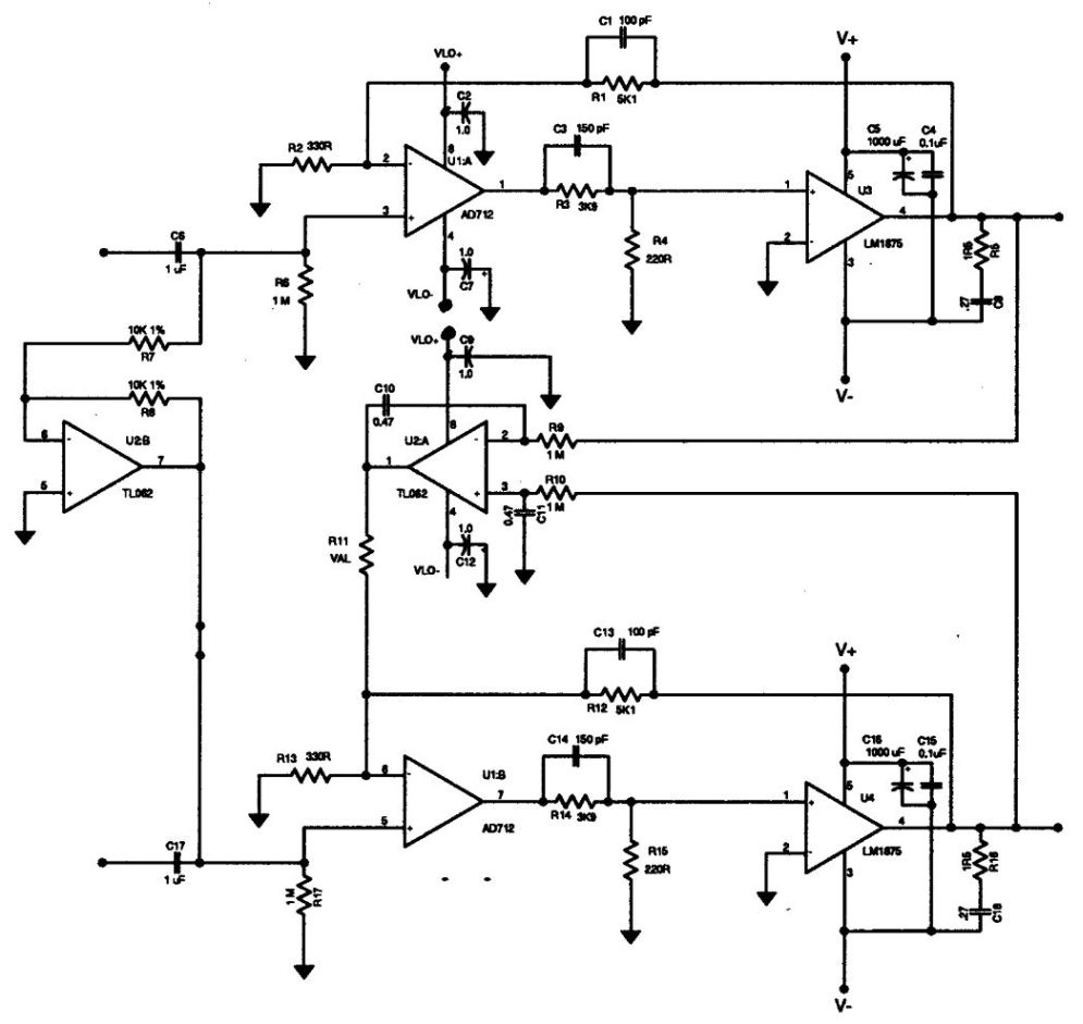

I use a dual op amp as differential gain buffer for both inputs of a chip amp configured as a differential amp. This effectively makes a higher power instrumentation amp. I mention this because it is similar to transformer coupling the input signal (amplifying only the differential signal input and breaking any ground loops) which is similar to using a transformer based preamp (amplifying the differential signal, breaking ground loops, and volume control).

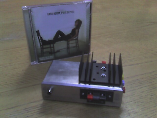

All I needed was another "believer" , like you, to bring my hobby back to life!!
Everybody always talks about other chips, but my strong believe , was that the lm1875 , was something special.
Once I read in an interview that some people like the Shigaraki amp (= lm1875)more then the Gaincard (=lm3875) because it sounded more musical, warmer or some thing like that.
This confirmed my own hearing.
???Are there other believers in the lm1875 out there ???
!! my tiny lm1875 amp which drives some big horns in a very sweet and warm way !!!

I don't, except maybe a paper copy of the pattern (I'll look). The schematic shows a bridged version with servo DC feedback; you could simplify it to just the composite amp itself. It was from a Popular Electronics article, I think, from long ago, I will check for this as well.
Are you living in the Snowbank they just auctioned off?
A paper copy of the pcb? That sounds very interesting!!
I'd sure like to be able to use 2 regular speakers to do the job of three regular speakers or 2 horns. (I'm saying that I'd like electronic means to un-cramp the amp rather than physical, because, hey, I could use the extra room).
Looking forward to seeing this "assisted" LM1875.
Maybe the circuit can work with LM3886 too?
