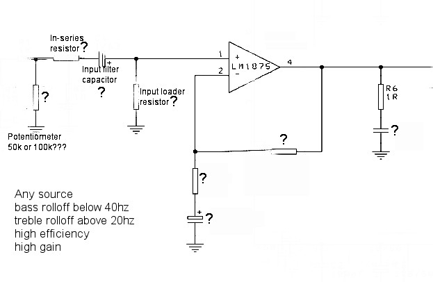

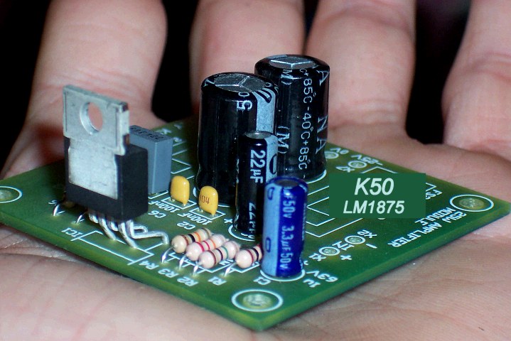

K50-lm1875
I'd like to learn how to adjust the tonality (temperment) of the amps to match up because these, $12, LM1875 make excellent surround sound amps, keeping company with their larger cousins.
See picture. 😉

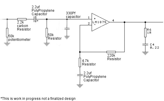

Diagram 2! 😉

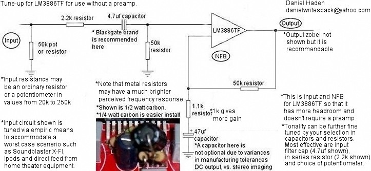

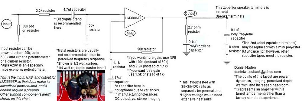

Okay! I finally got National's spreadsheet.
Here's a LM3886 chart that doesn't blink anything into the orange, yet it should sound the same as the first mod.
Does anyone know if there's a difference in heat (thermals) between chart #1 and chart #2? Or does any greater gain also generate greater heat?
Now, the question is how to tune up LM1875 to sound the same as big brother for use in surround sound application (with both).
First, since the little one changes tone (temperment) with voltage (unlike big brother), I guess we'll have to specify 30+30 volts DC rails (a 36vct transfo)? Or, could I safely use higher?

Now, of course, we need "matching intent" for LM1875. Let's specificy that we're going to mod K50. Let's specify voltage.
Andrew, do you know what an optimally powerful voltage could be for LM1875? It needs to come to within 4db of LM3886 chart#2. Its supposedly possible to do that.
Now for LM1875 surround channels:
I tested 30+30 volts DC, and the little chip on stock K50 was graceful thermals despite a 4 ohm speaker. When the input filter cap was increased in size, it lost power down to a perceived 6 watts although its presentation was better.
This needs a plan.
We need a wide open input bandwidth because "source" is considered worst case scenerio.
Howabout:
20k pot to, 2.2k to, 3.3uf to, 10k load, to chip, for input?
Where does that RF shunt cap go??
So, for zero losses at 45hz, and siginificant gain, what does the NFB look like? (Ohms and microfareds please).
Thank yoooooooooooo!!

I have extracted this short section for a reply. The rest is just gobbledegook. I cannot follow the reasoning nor the results you are reporting.
The RF attenuation capacitor is fitted after the series R and can go in parallel to the last resistor that sources the current to feed the input offset current.
Taking your last example.
20k pot
2k2 series in input feed
3u3F series in input feed
10k input to signal ground
add a 330pF in parallel to the 10k to act as an RF filter. This gives a 0.7uS time constant. You may want to experiment with this value until you have achieved best sound for that amp and equipment combination.
However, 3u3F and 10k for Zin removes some of the bass signal.
Is there a DC blocking cap fitted into any of your source equipment?
Second "however", 20k pot gives a maximum Rsource of 5k feeding your Zin=10k+2k2 =12k2. This breaks the usual rule of Rs<<Zin
I recommend 20times lower, but 5 to 10times can just about work.
The pot value also interacts with the RF filter capacitor and will roll off more treble than intended.
I do not like to see high Rs feeding any amplifier, be it an opamp, pre-amp, or power amp, unless it can be shown that high Rs does not interfere with the audio signal.
Now for NFB.
If you keep the sole DC block at 3u3F with Zin=10k then RC =33mS.
NFB >=46mS. Your 1k0 and 47uF meets this requirement.

Dolby Surround Sound rear channels
Oh I really like that book! Thank you!
I do still need a baseline from folks wiser than myself.
I seemed to have skipped a few steps. My apologies.
Its just enthusiasm and that I'm so eager to complete the dolby surround sound gainclone amp.
Step1
What I need first is to boost the gain (NFB) of LM1875 so that enhanced SPL doesn't involve overdriving the input.
This should be in the form of an easy, beginner level mod to the common K50 kit.
A worst-case source should be anticipated, bearing in mind that someone (not me) is going to ask an Ipod or X-FI to drive 5 amplifiers directly.
Here is an example of that step completed on the LM3886 kit--the main (front) channels of the gainclone surround sound amp.
The least effective empirics have been reduced/subtracted.
What's a good starting place to begin this, Step1, with LM1875's K50 kit?
Thanks again!
