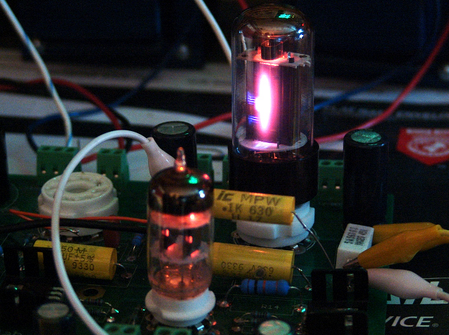

I have found that there is a limited range of plate voltages that can be applied to a given set of tubes when trying to extract maximum power output if we are to stay within the published maximum ratings, and provide low distortion.
At the lowish plate voltages, the plate load impedance must be reduced to make big power. There is a limit in how far this can go to stay within the peak cathode current ratings. My experiences with violating this rating has shown that you shouldn't do this.
At higher plate voltages, you will eventually run into plate dissipation limits at higher output power levels. Maximum plate dissipation does not occur at maximum power output. It is usually around half power. This is the limiting factor if the amplifier is designed to remain in dissipation spec when tested with continuous sine waves.
If we accept that most music has a peak to average ratio (crest factor) of at least 10 db, and therefore the amp will be operated below an average power output of 10% of max when pushed to clipping on peaks, we can willfully violate the dissipation spec for continuous sine wave testing. Keep such testing to brief periods. Bob Carver made his career on this fact.
As the plate voltage is increased, the idle current through each tube must be reduced to avoid excessive dissipation at idle. As the plate voltage is increased the idle current must be reduced to keep the tube's dissipation at a level where tube life is acceptable. There will be a point where the crossover distortion at low volumes can't be tolerated. This is the limiting plate voltage factor on most conventional G1 driven sweep tube amps.....hence dual drive, crazy drive, or warp drive! Screen drive can inherently operate at lower idle currents without excessive crossover. This is very tube dependent.
Using Pete's Engineer's Amp as a test board, I found that for 6HJ5's/ 6HD5's 600 volts and 30 to 35 mA of idle current with a 3300 ohm load will result in about 130 watts of power output with a faint red plate at about 75 watts continuous for 5 minutes, and no visible or audible crossover. The amp will play for hours at the edge of clipping with loud music into a speaker. 650 volts gets into trouble at both ends of the power spectrum.
The same amp with bigger tubes (I used 35LR6's) hits 250 watts with 650 volts and 2500 ohms. These are the limits of my testing ability. My biggest power supply goes to 650 volts and 1.7 amps. My biggest OPT is 1250, 2500 or 5000 ohms. No single tube works on 1250 ohms. 650 volts is about as far as it was intended to go too. Pete's board was not laid out to eat 650+ volts either.

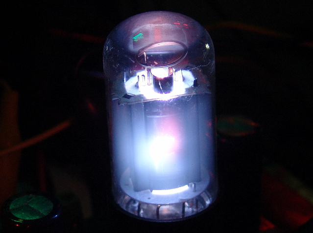

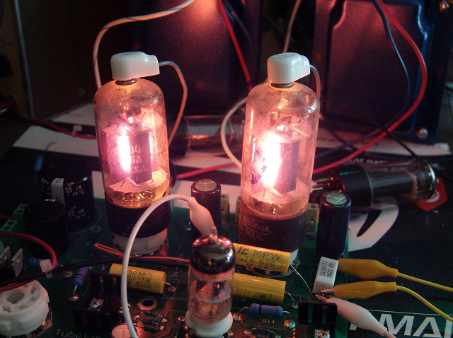

Good thing most of these only cost $1 !!

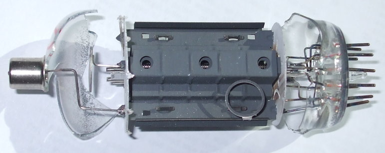

Much of my extreme testing is done on tubes that ranged from free to $1. I got the 13GB5's from ESRC for $1 and that was a credit earned by bringing him a truckload of tubes.

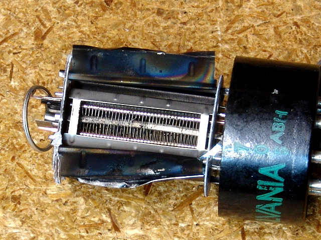

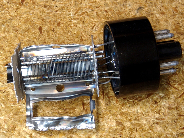

I got a bunch of 6BQ6's for an average price of 66 cents. They were supposed to be NIB, but some ere ugly and well used. They entered the zone! How many watts can you get out of a 6BQ6GT in SE? I was over 20 watts when the cathode bypass cap exploded!
Note the absence of getter on these 6V6GT's. They were in a sealed 100 unit bulk pack that I got from NASA at an auction in Cape Canaveral Fla. Over half of them were unusable, and most of the rest have since died due to air leaks. Sylvania made some real trash in the last years of their vacuum tube manufacturing. I have many other examples to support this statement.

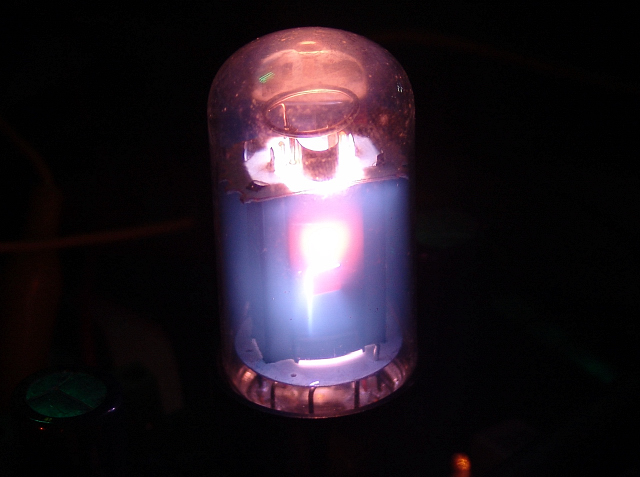

They made some excessive power, and distortion for a while. I performed an autopsy on one of each.

note: that busted tube pic above was actually hit by a hammer, but only after the tube got "smoked".

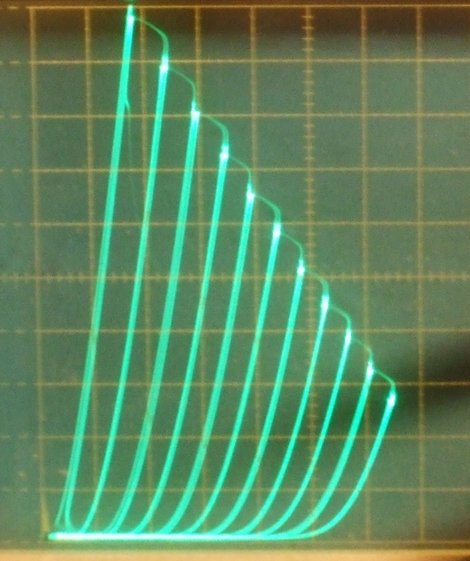

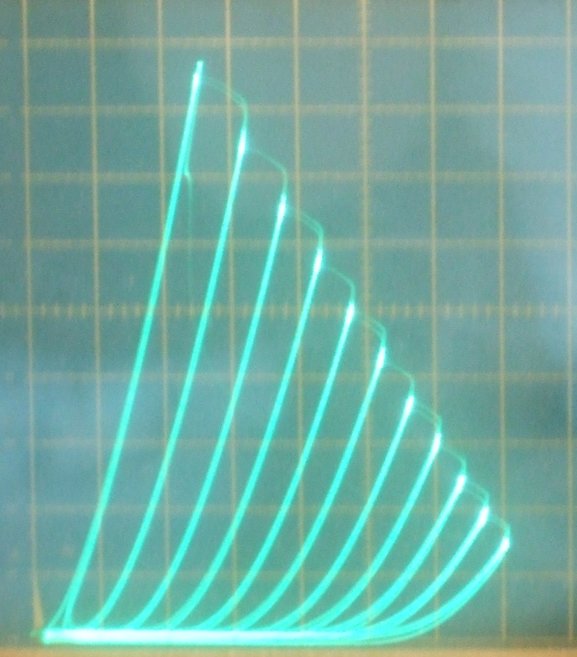

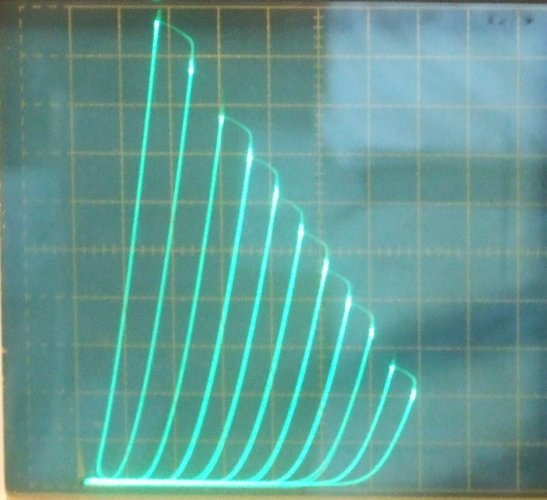

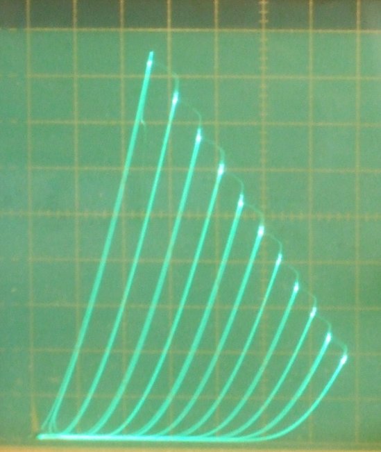

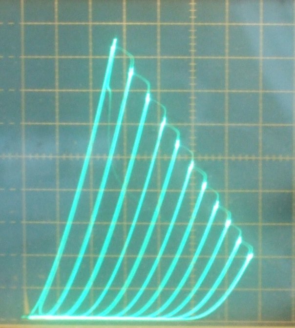

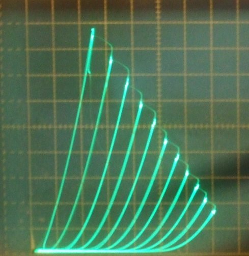

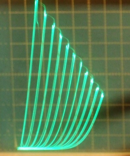

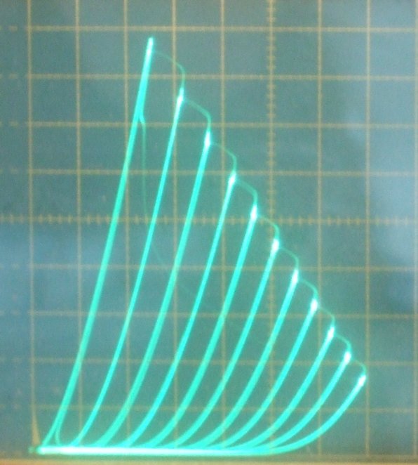

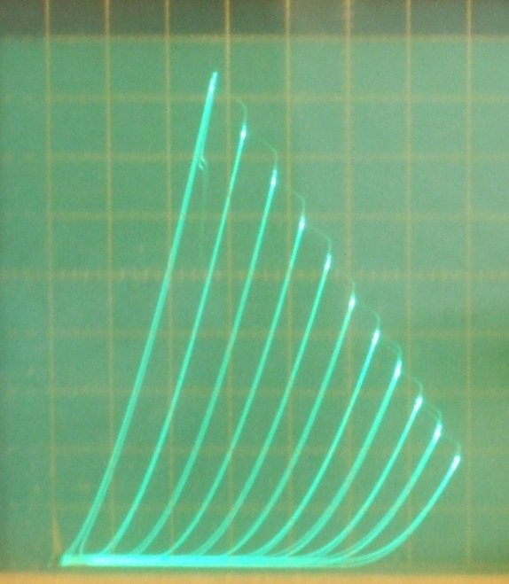

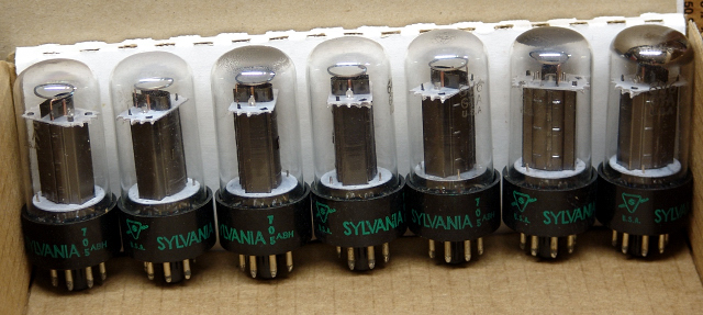

I got some more 6CB5A tubes out to curve trace since you were making a model for them.
As I often find, a bunch of tubes of the same type are not always hugely consistent, but these were closer than some I've seen. The earlier 6CB5A was marked Sylvania in a plain white box, with plain white lettering on the tube. The other two "Sylvania" types here are the same white box types. I also found an exactly identically constructed tube marked "National", but printed in red on the base instead. Never seen Sylvania tubes marked with plain white letters before, so I think these are all "National". They all have black rectangular plates.
Then an RCA with a rectangular grey plate. And a real Sylvania with a rounded grey plate.
Triode curves attached, 50 mA/div Vert., 50V/div Horiz., -7 V steps on grid 1 from 0V
1) original "Sylvania"
2) "Sylvania"
3) "Sylvania"
4) National
5) RCA rectangular grey plate
6) real Sylvania round grey plate

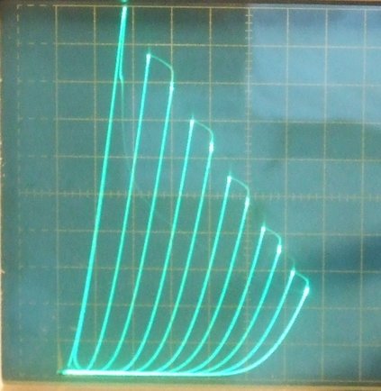

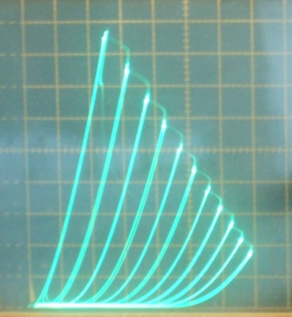

To show how much variation can occur even within a same brand tube type, here are some RCA 36MC6 in triode, a typical, and a best of 30 tubes. Then some RCA 26HU5 that don't look so similar either.
7) 36MC6 RCA typical
8) 36MC6 RCA best found
9) RCA 26HU5
10) RCA 26HU5
Which all goes to show that for selecting similar triodes, you need a curve tracer. Fortunately Schade "triode" versions look quite similar, and Crazy Drive pentodes look similar (so should make extremely similar, and linear, Schade "triode" versions).
