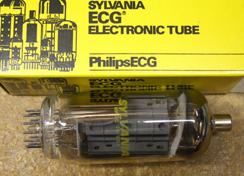

I got a lot of 45 Sylvania ECG 35LR6's that are from much later. All of these tubes have obvious manufacturing defects, and some have failed in a spectacular manner.....yes I am bending the specs on them, but that's not causing the failures.....the internal elements are falling out, or coming loose and touching each other. BIG SPARKS happen. None of the tabs on the top and bottom of the beam plate, or the main plate are bent over and the grids are not crimped, so things vibrate out of place. Some of the mica spacers have come loose. I found one where the heater had come out of the cathode.
The seller pointed this out when I bought them and sold them cheap. He had several hundred Sylvania ECG tubes, all in retail boxes, all with problems. He claimed that they were pulled from the shelves at a major electronics distributor due to these manufacturing defects.

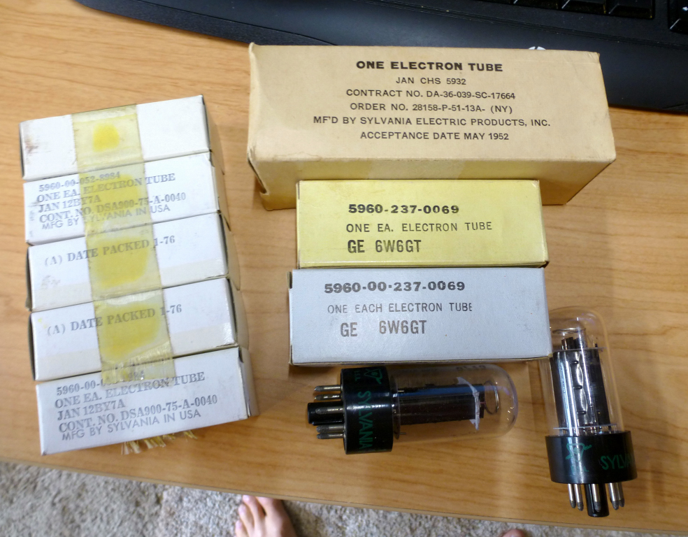

but most of my military spares are in white boxes
The color of the boxes depends on who, and when they were packaged. Most of the WWII and before military tubes were packaged in unbleached cardboard. The big tube is in a lighter shade of natural colored cardboard, as are many of the tubes from that era. It was packaged in 1952. The yellowish 6W6GT is from 1966. I have seen white, yellow, brown, and grey packaging from the 60's. The light grey box is from 1975 and the white ones are from 1976.
I have a friend who has been in the surplus business since we were in high school together. I helped him with some of his larger transactions over the years, usually in exchange for a piece of equipment, transformers, or tubes. Sometimes I just got lucky and got free, or very cheap stuff for being in the right place at the right time.
One day about 15 years ago I got a phone call from him. He had acquired 25,000 sq foot of surplus "stuff" in a derelict building. Apparently the original owner had collected all sorts of WWII and Korean war "stuff" and then passed away about 10 years previous to this. The building was deemed unsafe, and the land was sold at a tax auction. Demo had begun on the building when one of the dozer operators discovered a partially disassembled airplane inside. My friend got a call. He had to get in, get what he wanted, and get out. I was told that I could take all the tubes and pretty much anything else I could grab....bring a large truck, it was 200+ miles away.
There were tubes, and parts everywhere, mostly broken. Over three weekends I collected 100,000+ loose tubes. They had been carefully pulled from an immense pile of military spare assemblies dating from 1939 to 1960, all arranged on wooden shelving, which had rotted and collapsed. There must have been 100 or more 833A's, 211's and 845's broken on the floor.
It took my about 6 years to sort all the tubes, and pick about 10,000 or so that I kept. The 6AG5's with the extra heaters inside were in that lot.

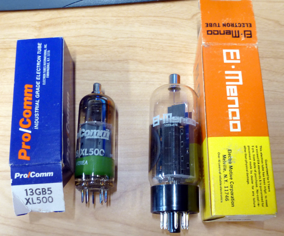

I have 18GB5 (EL Menco) with green ring bands...are they not good? .....El Menco were Electro-Motive house brand
I remember El-Menco capacitors from the 50's and 60's. I never saw an El-Menco tube until about 1975. I did some Googling and came up with this, from another forum.
El-Menco was a well-known name in capacitors. Whether the parent company, Electro-Motive Corp. marketed tubes themselves or just licensed their name, Their line was limited to the most common types. They lacked brand name recognition, although with their famous capacitor name, among electronic techs, they should have been known. Most of their tubes are from Japan, but some are USA. IEC bought Electromotive Corp. in 1965 and began marketing tubes under the El Menco name, presumably for the brand recognition.
The El-Menco tube that I have in this picture is a Sylvania. The ProComm 13GB5 next to it is the Korean junk tube. The text above indicates that many El-Menco tubes are Japanese. The Japanese sweep tubes often use the green ring, but it is usually not as wide. The green paint, or the metal ring, is made of some material that is Lossy at RF frequencies, and helps prevent oscillation. Most Japanese tubes are pretty good, but I don't have any here for comparison.

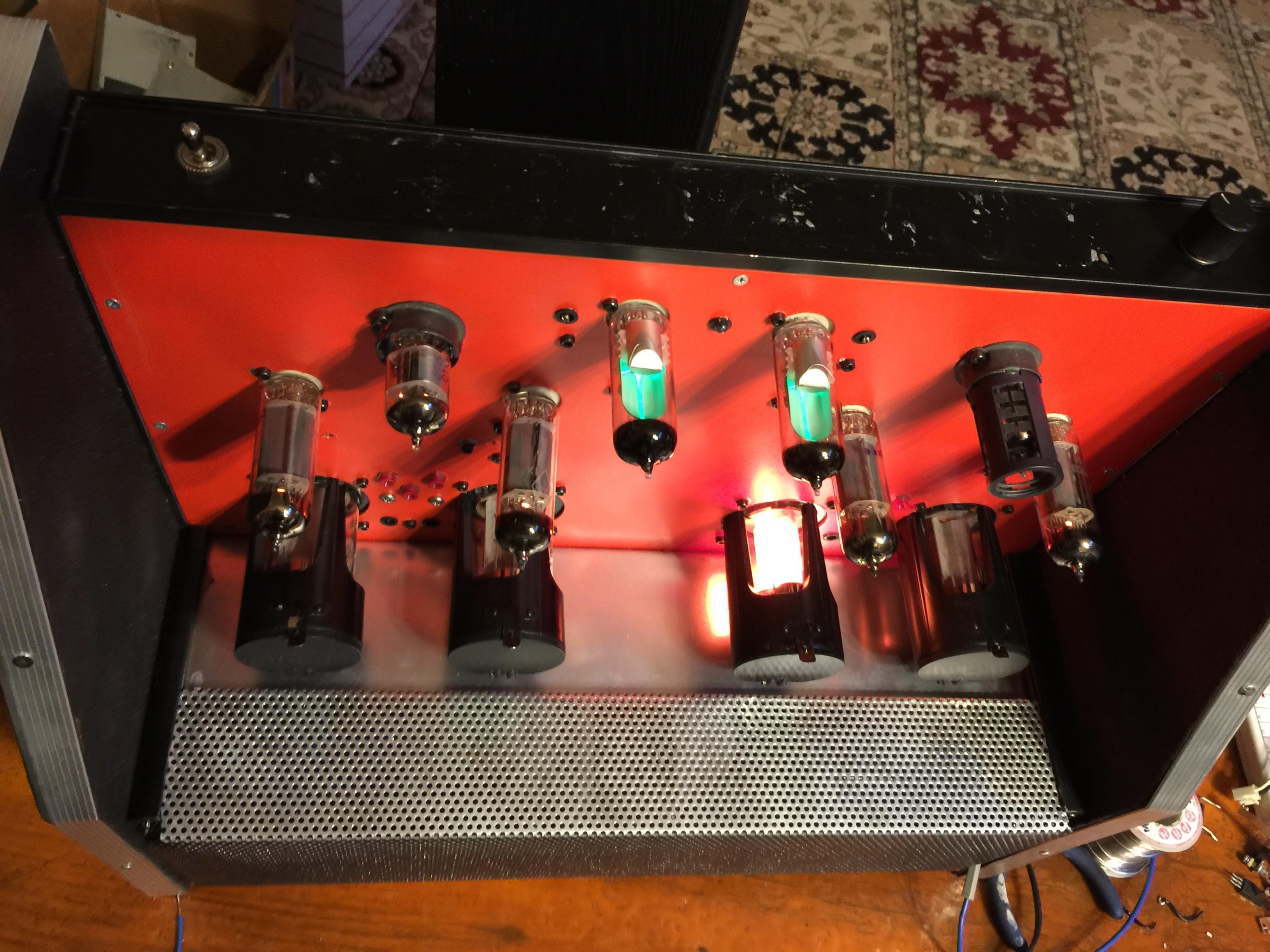

I recently put random Gu-50 tubes in my amp, and fired it up. The amp was playing, when I smelled a hot iron. One tube had yellow anode. I powered it off, and 15 minutes later powered on, tested bias; the current of the tube was even lower, so I re-adjusted it carefully. Since then the amp works fine, no problems with the tube. Looks like it had some gas (NOS, from 1970'Th), and orange anode caused it's absorption. The tube was designed by Telefunken for military, with nickel alloy anode looking as if covered by some grey powder.

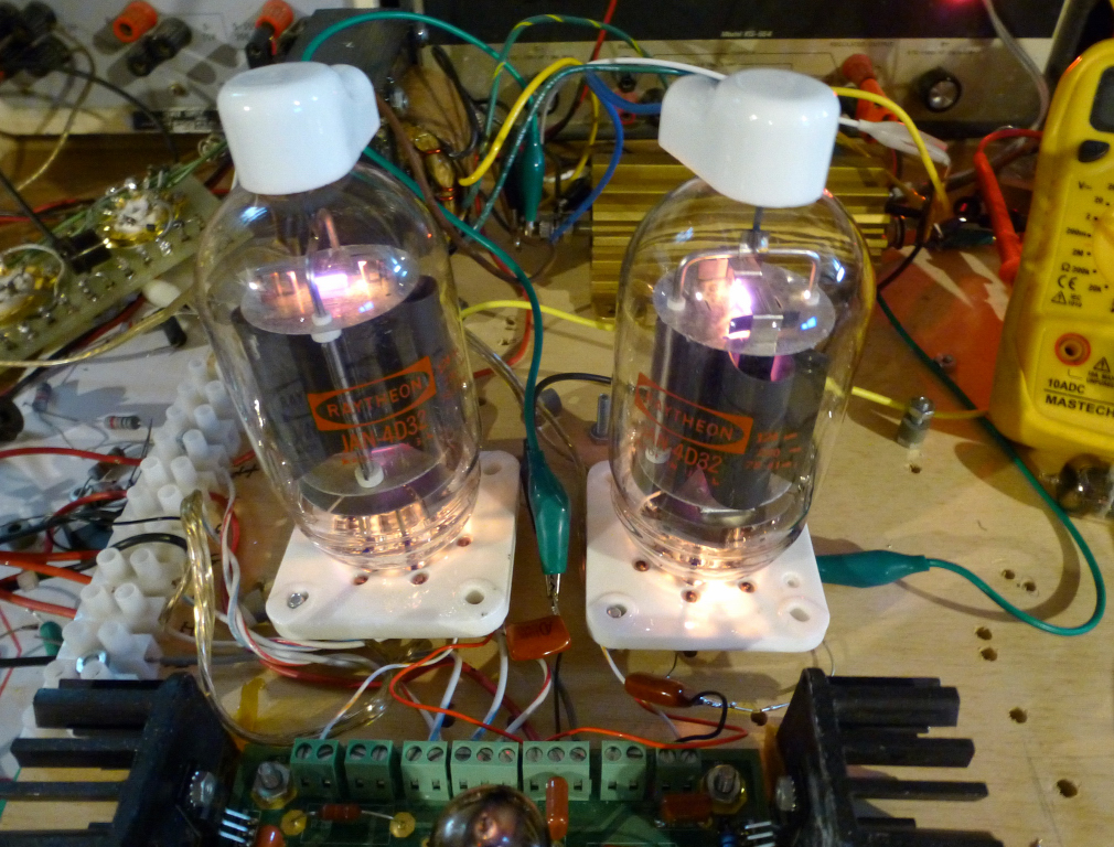

It took 2 and a half hours to get Tony's attention.....I think he has waited a long time for me to light these things up....
more...more please.... did you torture them?
Yes, and no. The setup I used for this test has limitations. The OPT that is hiding behind one tube is rated for 80 watts, and was designed for a guitar amp. The load resistor behind the other tube is rated for 125 watts, and that is on a heat sink......plywood doesn't cut it as a heat sink.
So what got abused, the tubes, the OPT, or the load resistor?
Well, 2 out of 3 isn't bad.

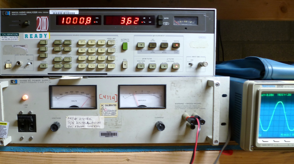

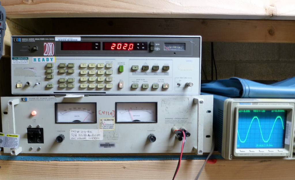

For those that don't know, these tubes are the 4D32's shown in the schematic in post #54. They are transmitting tubes that are used in a Collins transmitter. The data sheet gives the characteristics for an AB2 audio amplifier that should deliver 125 watts into a 3000 ohm load from a 600 volt supply. The data sheet is too big to attach here, over 1MB.
I wired a pair of sockets into my breadboard, and adjusted everything to duplicate the conditions shown in the data sheet, (600V plate, 250V screen)except my OPT is 3300 ohms. I hit the switch and adjusted the bias for the prescribed 50 mA per tube. I turned up the audio generator until I hit clipping. Nothing bad happened, so I turned the power supply up as far as it would go, 658 volts. Again nothing bad happened. Not even a hint of glow from anything. The OPT remained cool, but the load resistor didn't.
A previous experiment years ago, with different tubes, but another of the exact same OPT's ended with the OPT ON FIRE when the load resistor blew open at full power leaving the amp with no load. These OPT's were never designed to eat 650 volts of B+!!!!!
So, at the moment I have taken the breadboard apart, and am modifying it to accommodate "Crazy Drive" a bigger OPT, and a bigger load resistor...if I can find it. If not, I'll use two of the gold ones.
I let the load cool off and went back and measured THD VS Power Out.....I don't have FFT functions yet.....still looking through boxes for some missing pieces, like the license dongle. Test results:
0.5W 0.186%
1.0W 0.188%
2.0W 0.195%
5.0W 0.338%
10W 0.673%
20W 1.005%
50W 1.181%
100W 1.384%
150W 1.419%
200W 2.93% just beginning to clip.
More screen voltage did not produce any more power, just sucked more current. I believe more power requires more voltage, which I don't have, or a lower load impedance. I do have a 400 Watt 2500 ohm OPT.....
Stay tuned.....
