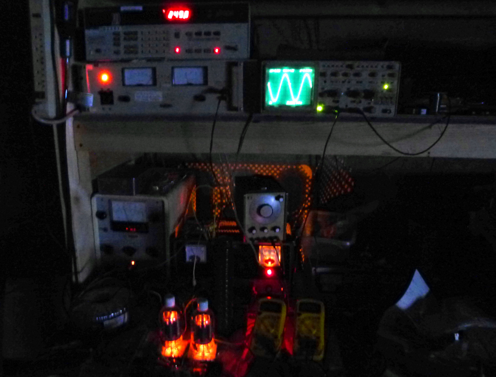

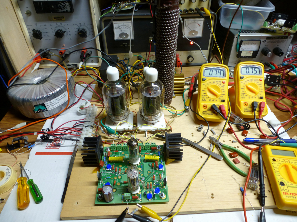

OK, 400 watt Plitron OPT installed and wired for 2500 ohms. 500 watt "George proof" dummy load installed.......CRANK. As expected clipping occurs at 250 watts. This is about the same as 35LR6 sweep tubes under the same conditions.
I let it run at 250 watts for 10 minutes, then turned out the lights and took the picture....nothing glowing. The camera "sees" infrared which shows up purple, and there is some on the heat radiator in the right hand tube, these tubes are not glowing, but close to it.
The 35LR6's had a noticeable but not bright glow under the same conditions.
The efficiency is about the same as the 35LR6's. The cathode current in each tube was 330 mA. Spec is 300. The plate voltage is 650 volts. Screen grid current is 40 ma per tube at full power. There is 377 watts going into the OPT (650* .58), and 250 watts coming out. 127 watts is being burned up in the tubes. 63.5 watts each. Spec is 50. Plate efficiency is 66%. Distortion at 250 watts was about 2%.
The distortion at low power is not as good as with the 3300 ohm OPT. It could be the harder load, or it could be current imbalance affecting the toroid OPT. They are picky about that.

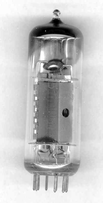

I just had a late Christmas present show up on the front steps this morning, from California! Anatoliy sent a 6pi41C, 12BQ6GTB and a 12L6GT. The 6pi41C looks somewhat similar to the 13GB5, except no plate cap. I should be able to get some curves done this weekend.

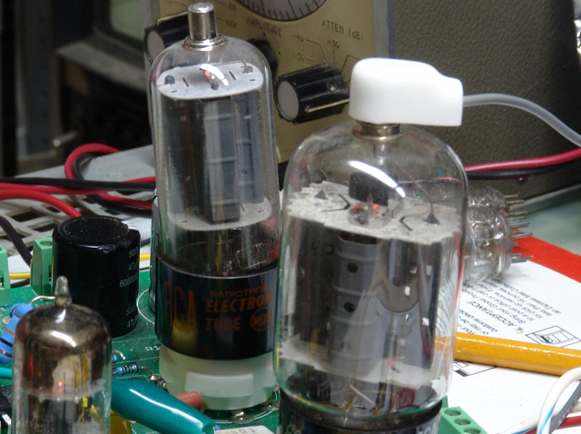

"The question is, is 12BQ6 I sent an "old style" or a "new style"?"

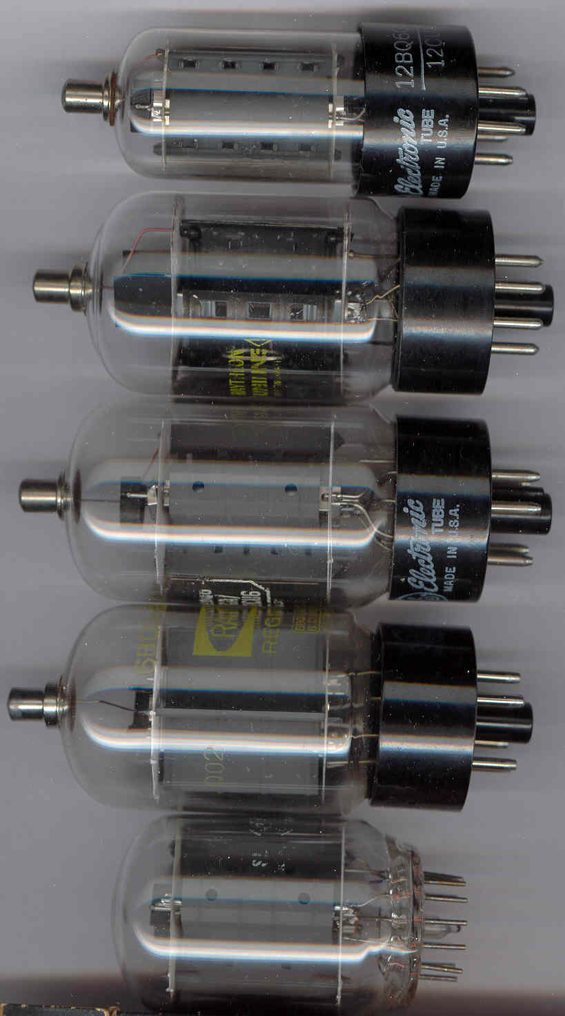

Well, it's not like any I had here. Smaller, it's most probably the 11 Watt version. See pics below.
From top to bottom:
a) the 12BQ6GTB/12CU6 you sent
b) Raytheon black plate 12BQ6GA/12CU6
c) GE 12BQ6GA/12CU6
d) Raytheon grey plate 12BQ6GA/12CU6
e) GE 12GE5 (17.5 Watt rating)
The bottom 4 all have about the same size plate. The GE one (c) looks identical inside (and tests identical) to the 12GE5 (and 12JN6, 6GY5)

I have some of those. They are 12BQ6GT or 12BQ6GTA small plate 12 watt (I think) rating.
The fat ones are 12BQ6 12BQ6GA, most have the GE "corporate" 18 watt plate. They stuck them in everything from 6BQ6's and 6AV5GA's (not GT's) to compactron sweep tubes.
Here you will see both side by side. Notice the not so straight construction of the 6BQ6GT. I called that tube the "leaning tower of power" since it was one of a pair that I extracted 120 watts from in screen drive before the big bang happened killing the tube and some other parts.

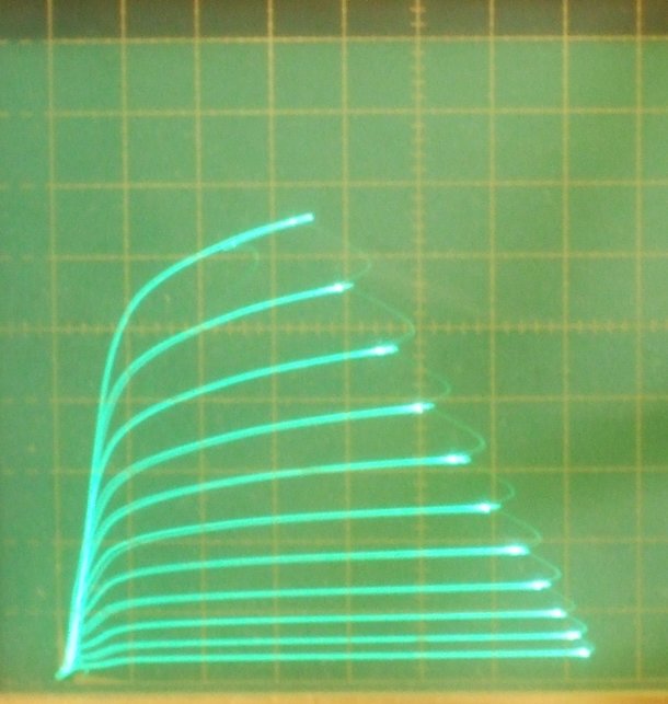

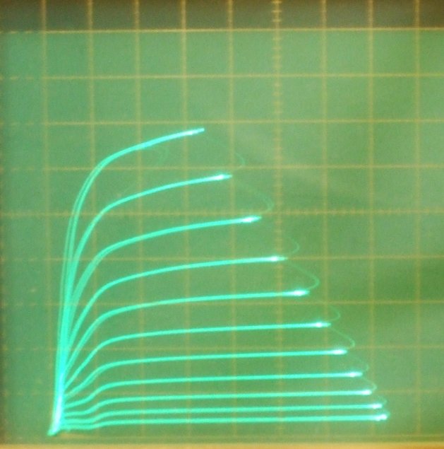

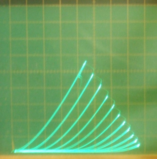

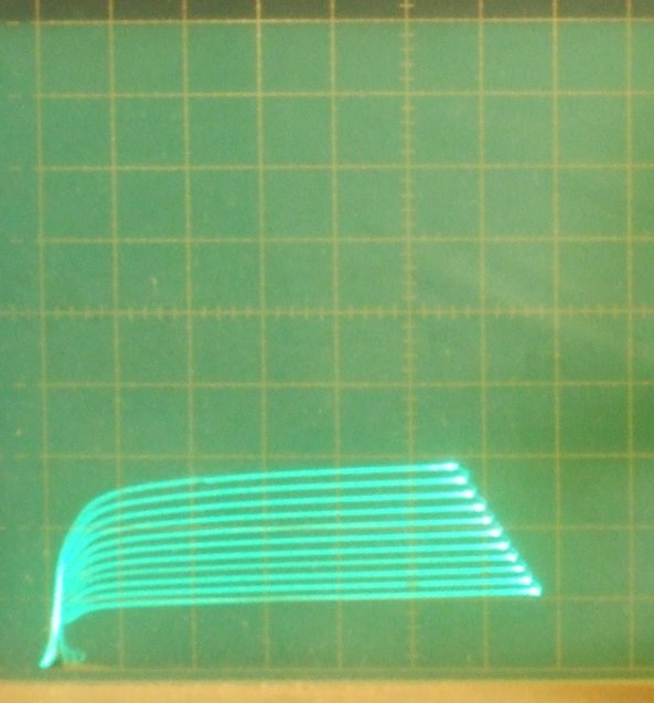

Here are some curves for the 6pi41C tube. All using 50 mA/div Vert. and 50 V/div Horiz.
1) normal g1 pentode mode, -4 V steps, 170 V on g2
2) g2 drive -7 V steps down from 100V
3) g2 drive -7V steps down from 170V
4) Crazy drive g2g1 -7 V steps down from 74 V, Rg2g1 = 780 Ohm, Rg1k = 2K
5) Triode mode -7 V steps
I had to put some ferrite cores on the clip leads for triode mode to stop it from oscillating.
I have a GU-50 that Anatoliy sent a while back. So I'll do that one next in Crazy Drive.

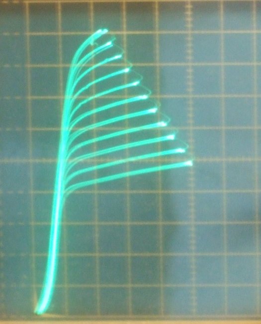

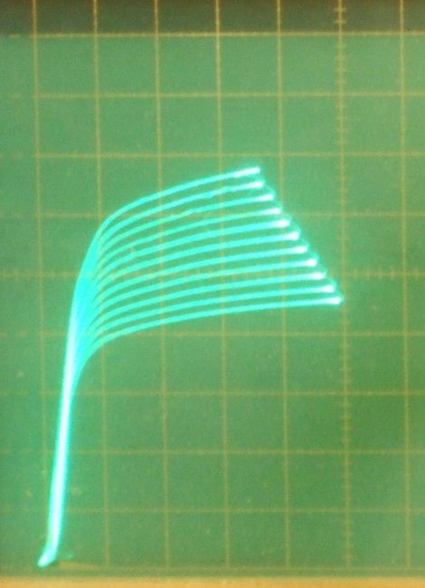

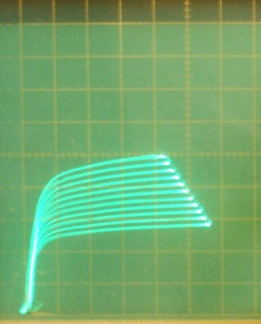

Here are some curves for the GU-50.
50mA/div Vert. (unless otherwise noted), 50 V/div Horiz.
1) normal pentode mode, 4.4V g1 steps, Vg2 = 260V, Vg3 = 0V
2) normal pentode mode, 4.4V g1 steps, Vg2 = 260V, Vg3 = +20V
3) g2 drive, 7V steps down from +260V, +15V on g3 (not much g3 effect)
4) g2 drive, 7V steps down from +200V, +15V on g3 (not much g3 effect)
5) g2 drive, 7V steps down from +130V, +15V on g3 (not much g3 effect)
6) triode mode, 7V steps, 20 mA/div Vert. 0V on g3 (tiny effect)
7) triode mode, 7V steps, 50 mA/div Vert. 0V on g3 (tiny effect)
For g2 drive, grid 2 started glowing above +200V (due to high plate currents with only a limited 70V g2 sweep and using the 50 Watt limiting load resistor on the curve tracer)
