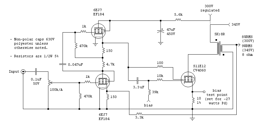

Going back to a thread you started nearly 6 years ago I posted a circuit with a somewhat crazy drive circuit I called "dual drive." It was in posts #29 and 30 of this thread.
http://www.diyaudio.com/forums/tubes-valves/163940-g1-g2-mu-scaled-drive-strawman-design-3.html

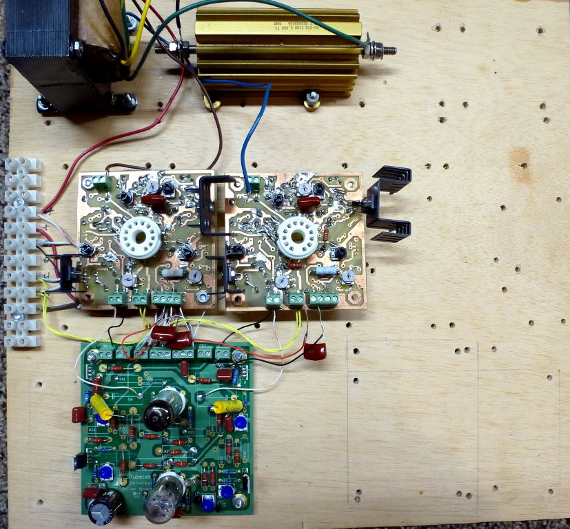

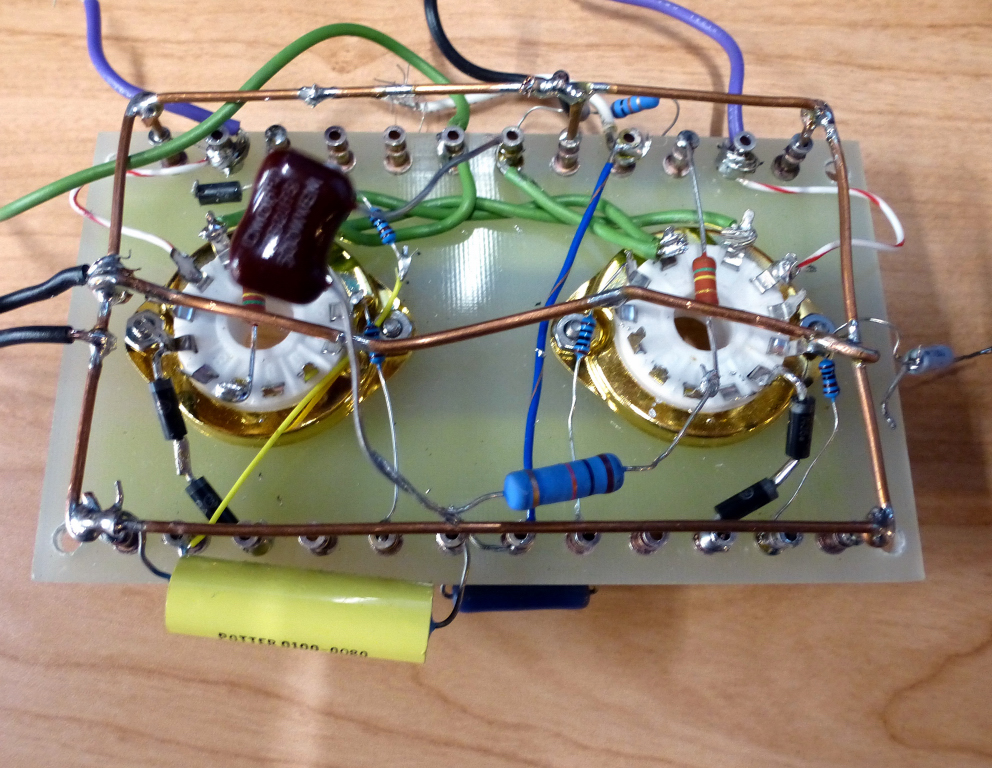

Over 5 years have gone by and I have been playing with this as time permits.

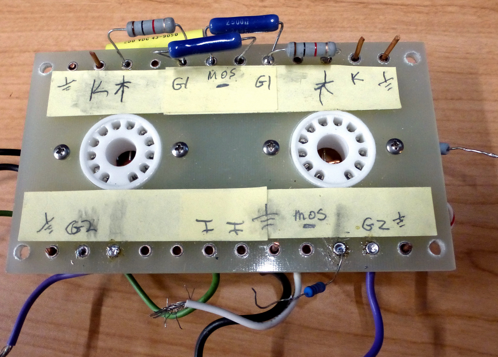

I built a P-P amp with a universal driver board, and a pair of output boards that have a separate mosfet driver with DC and AC level controls for G1, G2 and the cathode. First picture.
I have found several combinations that work pretty good, and yes, one of them has been reduced to a simple circuit very similar to your "crazy drive." Second and third pictures.
I have seen 75 watts flow out of a pair of tiny 6GF5's without any hint of redness. I dialed it back to 50 watts and left it run.....for a whole day. What happened? Nothing, it was still cranking out 50 watts.
Circuit, mosfet follower drives the screen through a 10 ohm resistor with a ferrite bead on each lead. The resistor is just so I can watch the screen current with differential scope probes. There is a resistor and the super secret component in series between G2 and G1, and a resistor between G1 and a negative voltage source.
The super secret component.....a zener diode. The trick is to play with the resistor and diode values such that G1 just begins to go positive at max output. The zener allows independent setting of the G1 and G2 idle voltages, while the series resistor allows for some optimization of distortion by balancing the AC drive between G1 and G2. Each tube type seems to need different parts. You can hang a small pot between the two G1 to - resistors and the negative voltage source to tweak the AC and DC balance (together) while the DC only gets set by the G2 idle voltage. These 3 pots allow for tubes that have different idle currents, and different dynamic Gm's.
Run some Schade feedback from the output plates to the driver plates to lower the output impedance, and some cross coupled feedback to the driver screens to kill any lingering crossover distortion and you have new ways to melt 13GB5's. See the LT spice file....yeah I built it, and yes it ROCKS! No the tubes didn't melt, but the yellow Sylvania paint isn't yellow any more. Its like spicy brown mustard color.

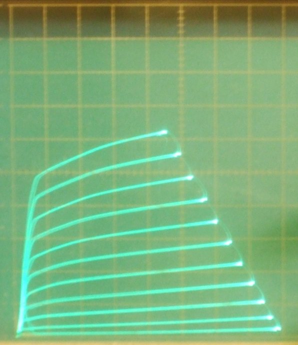

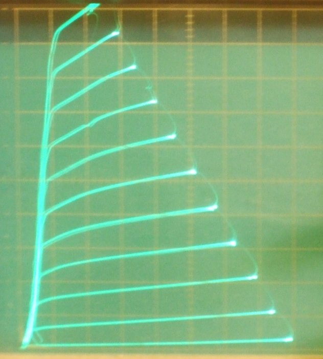

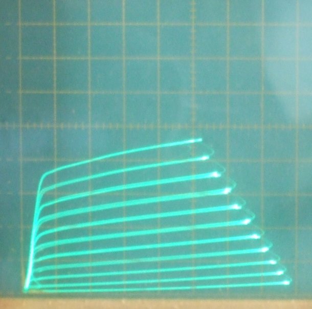

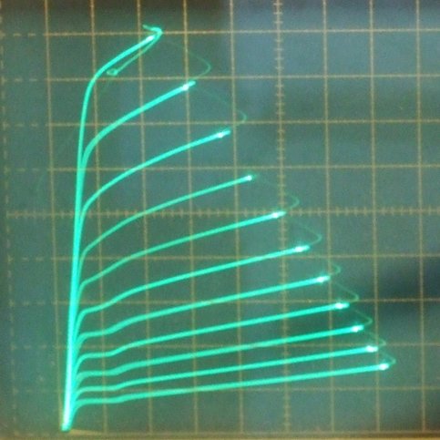

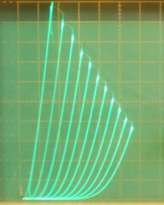

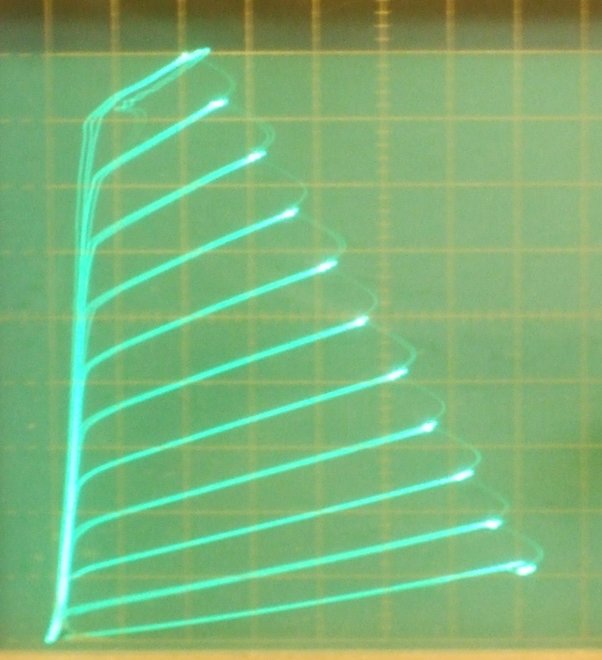

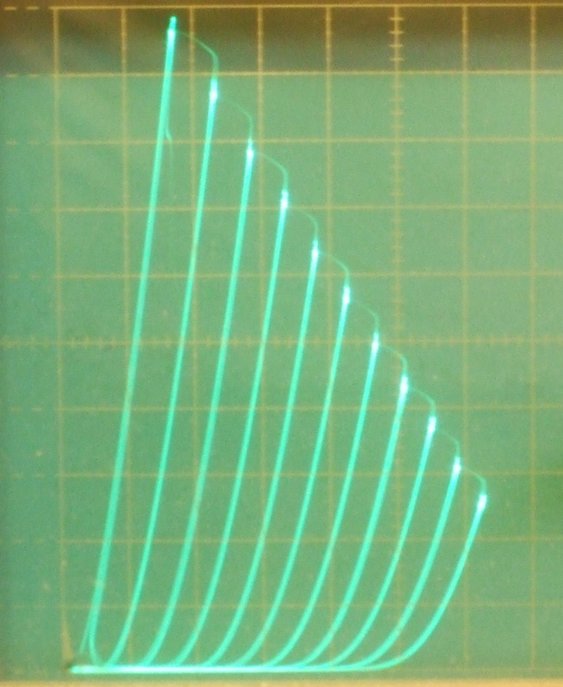

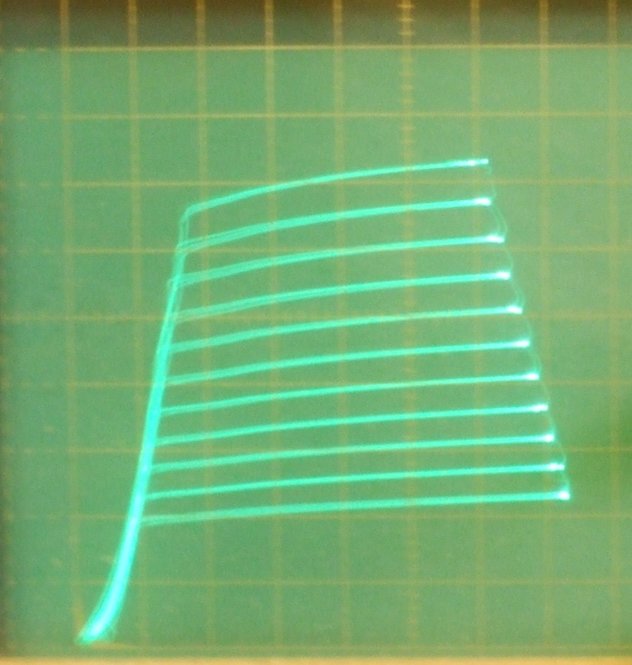

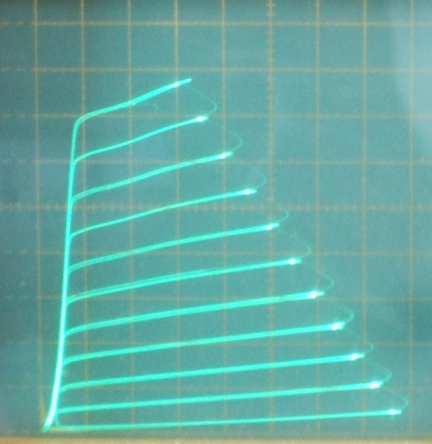

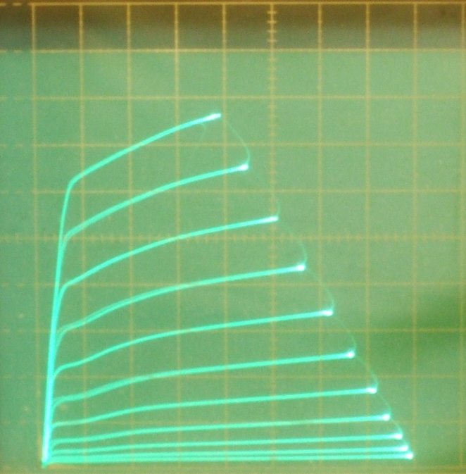

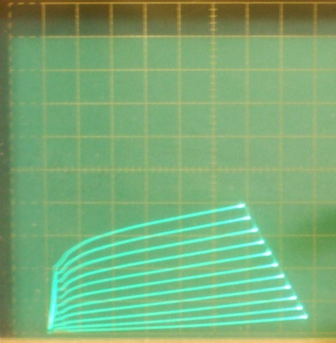

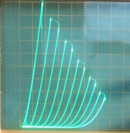

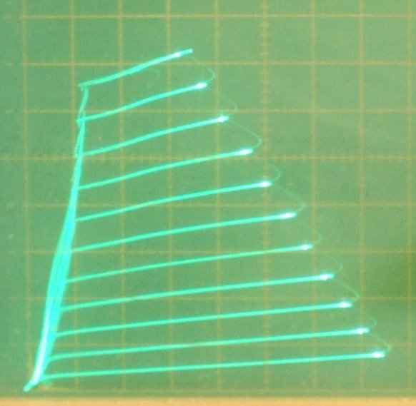

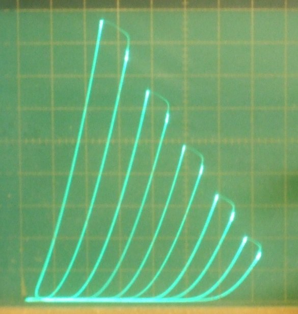

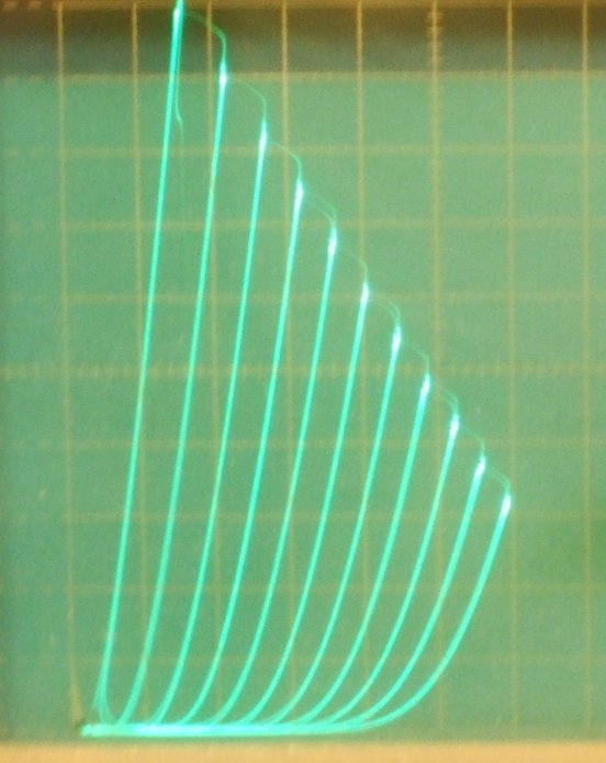

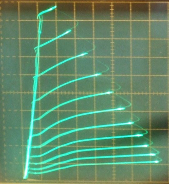

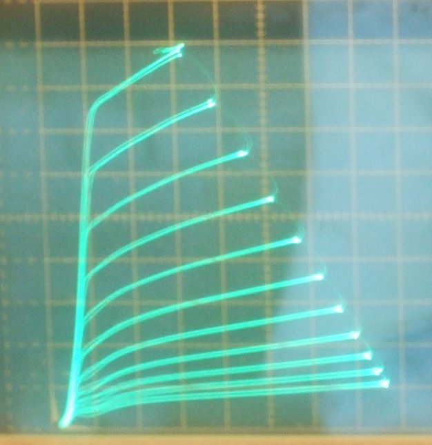

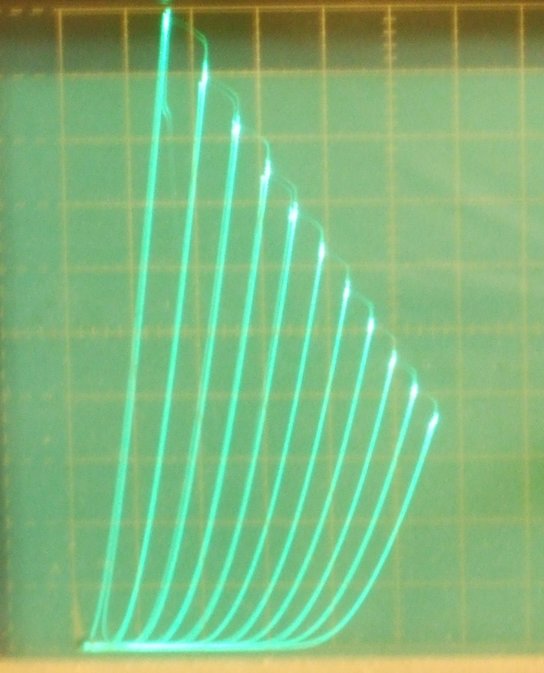

For those 6CB5 SET aficionados out there, here are some linearized g2/g1 special drive curves and g2 only drive curves for 6CB5A.
All at 50 mA/div Vert., and 50V/div Horiz.
1) 6CB5 g2 drive 80V Max g2, 7V steps on g2
2) 6CB5 g2 and g1 special drive, Rg2g1 = 3.3K Ohm, Rg1k = 1.8K Ohm (no offset LV),80V max g2, 7V Steps
3) 6CB5 conventional -g1 drive pentode
4) 6CB5 triode
5) 6CB5 Schade
4) 6CB5 triode
5) 6CB5 Schade

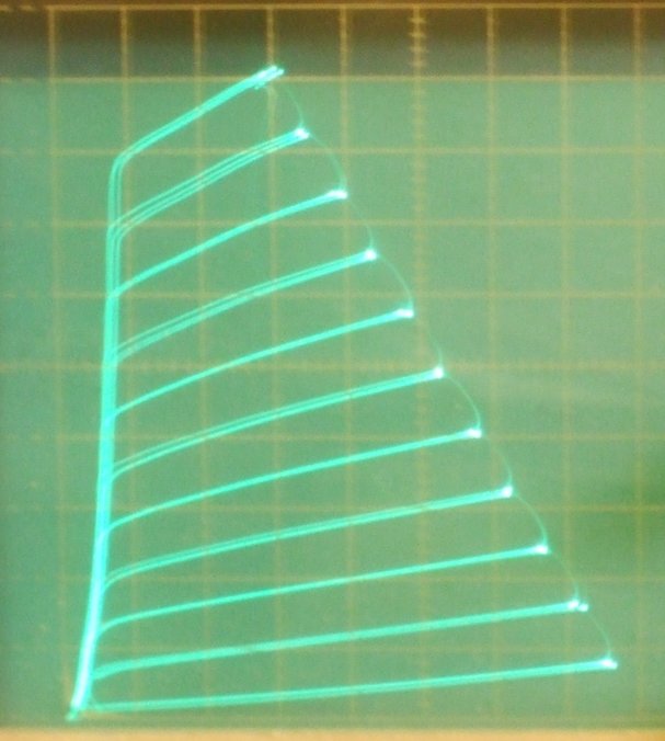

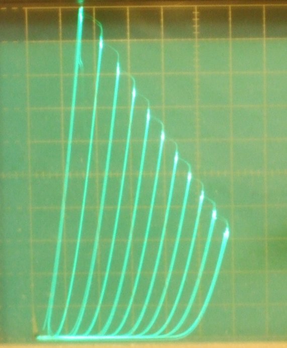

Here is g2/g1 special drive for the 38HE7 pentode. One really cheap tube that has good triode curves.
The pentode is rated 10 Watts dissipation, but one can run the pentode only by putting 21V across pins 10 and 12 (removing around 10 W of damper diode heat). That should allow 15 Watts Diss. for the pentode then.
All are 50 mA/div. Vert. and 50V/div. Horiz.
1) 38HE7 g2 and g1 special drive, 74V max g2, 7V steps on g2, Rg2g1=1.555K, Rg1k=540 Ohm
2) 38HE7 g2 drive only, 74V max g2, 7V steps on g2
3) 38HE7 triode mode 7V steps on g1

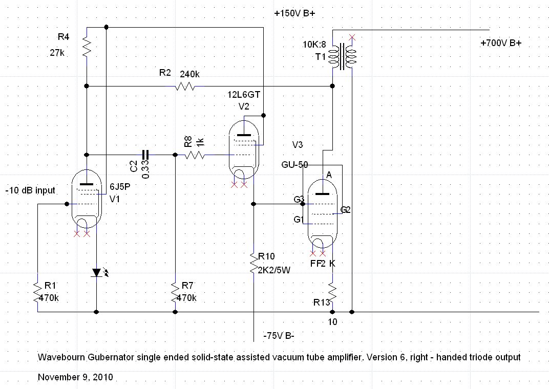

G2/G1 drive maybe not so new, curves already in LS50 data-sheet from 1941 (very last page, figure 14): http://frank.pocnet.net/sheets/043/l/LS50.pdf
also used in Wavebourn's GU50 "Gubernator" design (he calls it "Left Handed Triode Mode"): http://www.diyaudio.com/forums/tube...-triode-configuration-what-bias-points-7.html
http://www.diyaudio.com/forums/atta...nfiguration-what-bias-points-gubernator-6.jpg
later versions have mosfet drive: http://www.diyaudio.com/forums/atta...es-gu-50-se-amp-700v-b-gubernator_mk_6b_3.png
no resistor between G2 and G1 though, does this make a big difference ... ?
I first saw it in a schematic of a PA amp from the 40's or 50's that ran a pair of 807's in push pull. Drive fed directly to G2, with a resistor from G2 to G1.

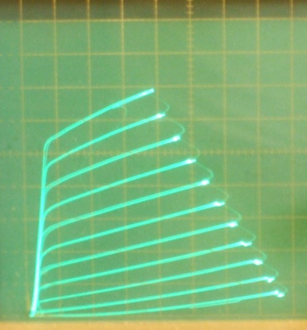

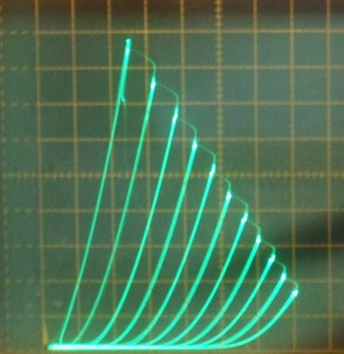

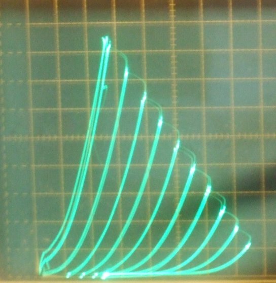

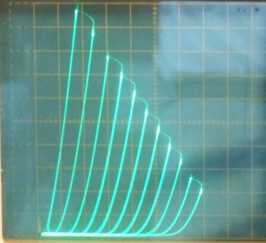

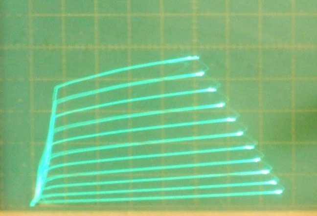

Here are the 26HU5 and 26LX6 triode curves again (RCA). I found a Zenith 26LX6 too, but looks just like the two RCA ones. All triode plots are 50 mA/div Vert., 50V/div Horiz. and 7V steps on g1.
Then pic 6) is 6L6WXT+ with the "Crazy Drive" 20 mA/div Vert., 50 V/div Horiz.
118V max g2 with 7V steps on g2. Rg2g1 = 2.64K and Rg1k = 291 Ohm
Pics 7) and 8) are 36MC6 in triode (very similar to 26LX6/26HU5/6KD6)
1) 26HU5
2) 26HU5
3) 26LX6
4) 26LX6
5) 26LX6 (Zenith)
6) 6L6WXT+ Crazy Drive
7) 36MC6 (typical)
8) 36MC6 (best one found)
1) 26HU5
2) 26HU5
3) 26LX6
4) 26LX6
5) 26LX6 (Zenith)
7) 36MC6 (typical)

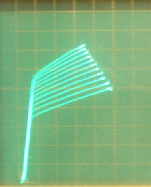

Tried some high gm tubes this time to see if they work with "Crazy Drive".
10 mA/div Vert., 50V/div Horiz., 7V steps on g2
1) 6HB6 Crazy Drive 84V max Vg2
2) 6HB6 g2 drive 88V max Vg2
3) 12HL7 Crazy Drive 80V max Vg2 (frame grid1)
4) 12HL7 g2 drive 85V max Vg2 (frame grid1)
5) 6HB6 in conventional -Vg1 drive
6) 12HL7 in conventional -Vg1 drive 100V on Vg2 and 0.4V steps on g1
The g2 drive pics are limited by the 70V sweep available from the curve tracer. Would need like twice or more step volts to expand them up to the Crazy Drive size. The 12HL7 Crazy Drive pic could be expanded up even further by Rg2g1 adjustment, but I kept it on the screen.
