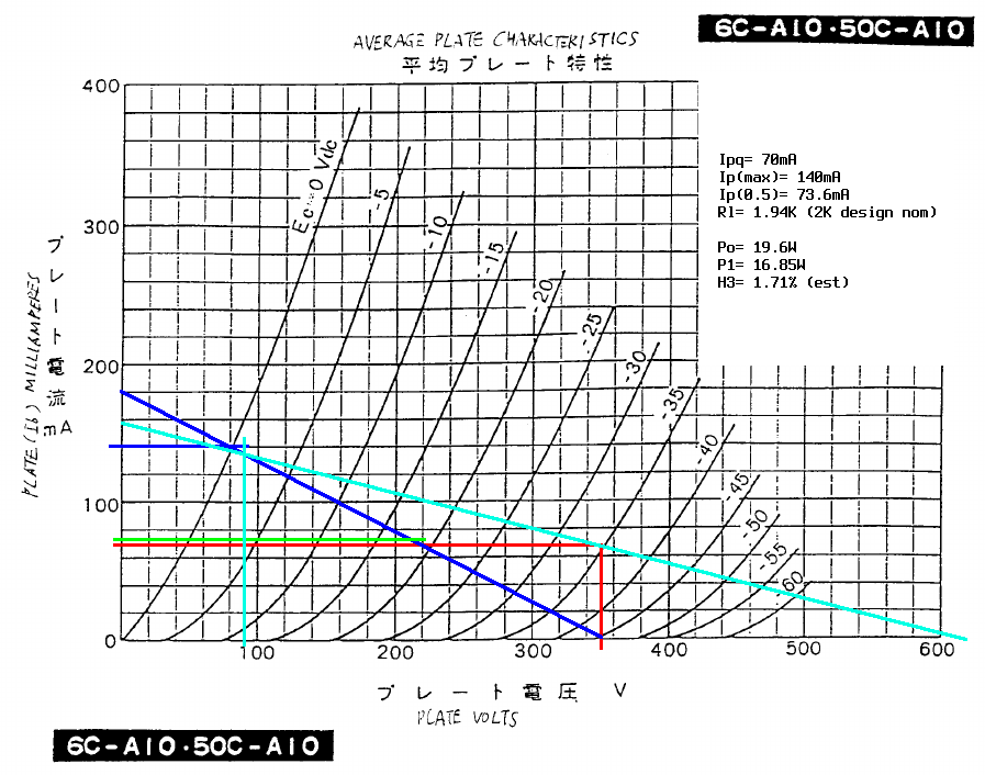

Ask and ye shall receive:
This is a PP loadline. A load of 2K / phase ( 8K P-2-P -- should be a "stock" value) looks pretty good here, and operates mostly in Class A. The h3 estimate looks pretty good, though is mainly a rough estimate of the actual sonic performance, though it does correlate somewhat with how it actually sounds in practice. As for that, you have to build and listen before deciding on what corrective measures (if any) are desired. Some audio finals don't need anything beyond just enough gNFB to take the "edge" off whereas others may need additional help via lNFB.
So far as triode finals go, this one looks to be in the same power class as the 6CK4 with similar performance. That does, however, make for availability problems as the 6CK4 was a one-off for the manufacturer of a specific TV set. This one may be the same deal: a vertical deflection one-off for a specific manufacturer of a specific brand.
That's the halibut: the beamer revolution occurred so fast and early that there aren't very many audio power triodes available. Most power triodes were designed for RF (high-u, high rp low IPq without negative bias) or series pass duties.
The big cooler fins on the grid would make one think they could do class A2 or AB2. The datasheet says 0V max on the grid though. I guess that's how they get 30 Watt Pdiss with a plate size equivalent to 18 to 24 Watt TV sweeps.
The 50C-A10 has specs somewhat similar to a 21HB5A (in triode), except Mu 4.8 then (actually, more like 5.2 at 80 mA). (230 mA max DC, gm 12450 @ 80 mA, Rp 385)

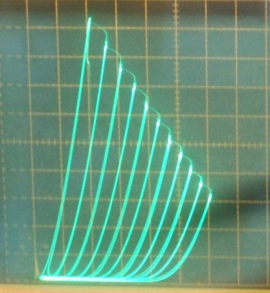

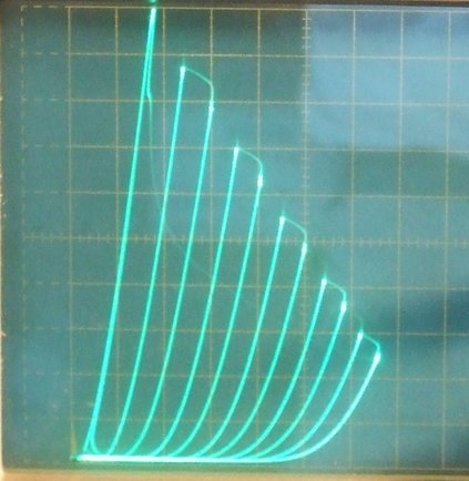

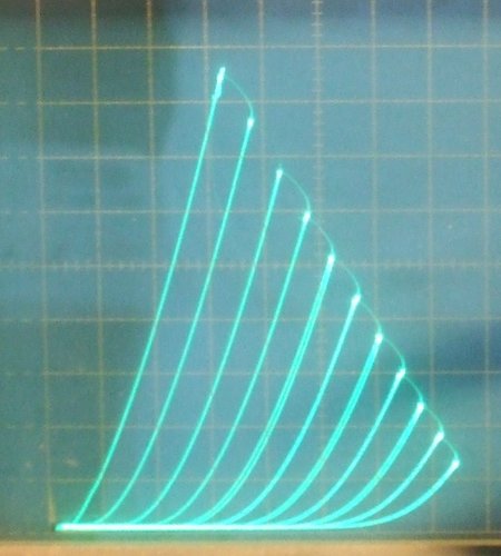

You can tell from the trioded curves how linear the grid1 is. Evenly spaced triode curves are very linear. Ones that bunch up and fall over to the right (HV) side have high 2nd harmonic and a trailing series of higher harmonics. 2nd, 3rd and 4th harmonic in SE will turn into 3rd, 5th and 7th harmonic in P-P. (less so in class A though) The bunching up is caused by the grid being too close to the cathode compared to the griid wire to wire spacing. (to get higher gm)
So high gm tubes are immediately suspect. Although frame grids CAN keep the linearity under control with high gm. But most frame grid tubes are STILL optimized for max usable gm. (so not that great) One exception is the TFH.
The other thing to check for is rounded over pentode plate curve knees or rounded curves across the board. These are caused by excessive screen grid current distortion. The rounding can remove some 2nd harmonic distortion over a limited plate voltage range, but will go badly awry at higher output levels.
Then there is variance between individual tubes caused by poor g1 g2 wire alignment (causing high g2 current),or poorly aligned (tilted wrt cathode) grid1, see the 36MC6 examples below).

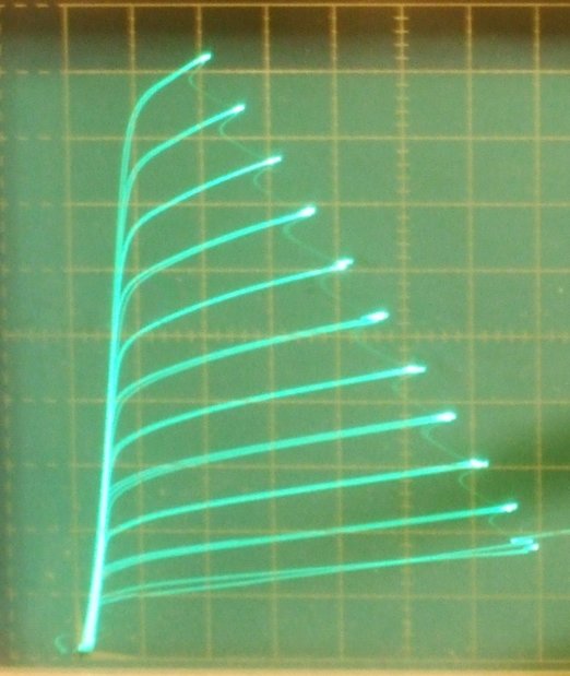

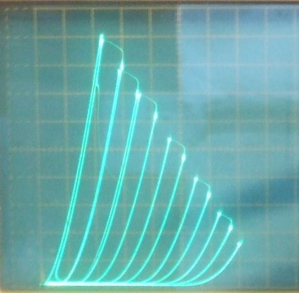

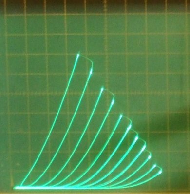

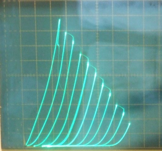

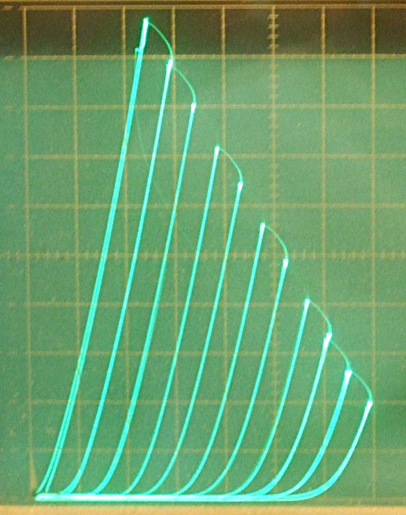

Some sweep tube trioded curves attached.
12BQ6
12GE5/6JN6
6HJ5
24JE6/24LQ6
29GK6 (6BQ5)
36MC6 (good example)
36MC6 (mediocre example)
36LW6
TFH (on the $1 list at ESRC)
perfect triode (1E7G parallel trioded)
12BQ6
12GE5/6JN6
6HJ5
24JE6/24LQ6
29GK6 (6BQ5)
36LW6

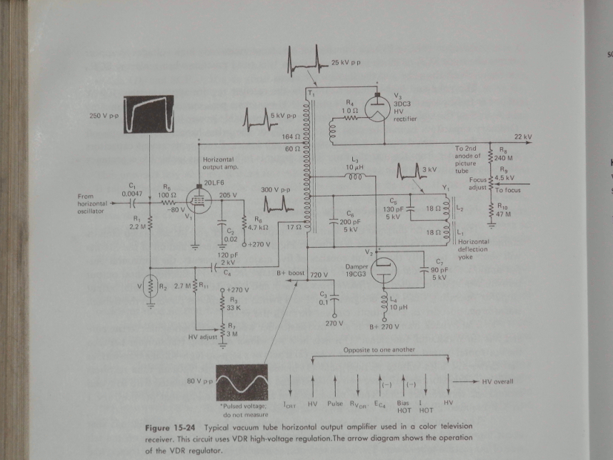

The "modern" horizontal sweep tube operates as a constant current switch. The grid voltage is usually a square wave switching between saturation (near zero volts) and cutoff.
The only schemos where I saw that have always been solid state. The hollow state HD finals have always been driven by what looks like a sawtooth with an undershoot (see attached). This comes from Color and Black and White Television Theory and Service, but they don't say where that schemo came from, and I haven't seen one like that "in the wild", as every other hollow state HD final had some sort of protective bias. Lose the horizontal time base, and the final poofs.
From the odd heater values, this looks like the schemo of some cheap TV running a PTX-less DC supply, and they couldn't be bothered to add at least a cathode resistor!
Seems this is pretty universal for hollow state as stated from Oscilloscope Techniques:
The grid of the horizontal output tube is driven by a combination sawtooth and pulse waveform, as seen in Fig. 922
It looks the same: saw3toioth with undershoot.
The screen grid of a sweep tube is usually tied through an unbypassed resistor to a fixed B+ voltage. This sets the saturated beam current, and keeps the screen grid current to a safe value. This is why you will generally find "screen drive" curves for many horizontal sweep tubes (curves drawn with G1 at 0 volts and G2 voltage stepped).
Never seen that either. The screens have always been bypassed.

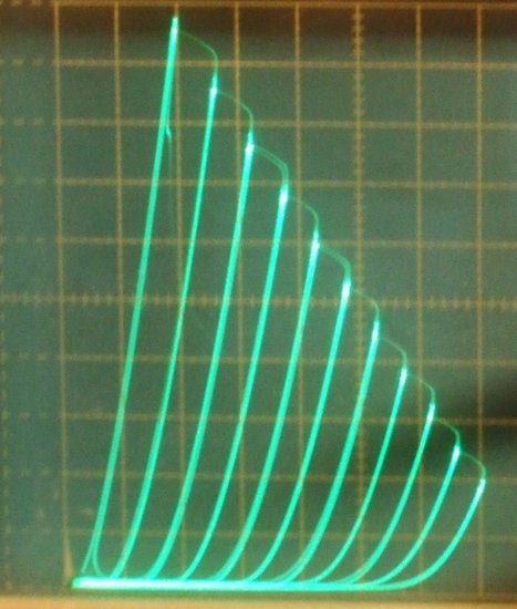

Woops, the "36MC6 (good example)" in post 454 has the wrong pic attached. Should have been this:
and (2nd pic) 26LX6 is very similar:

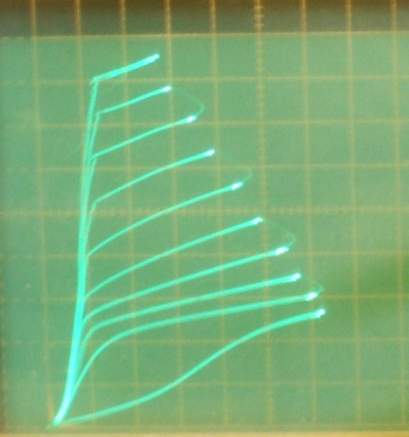

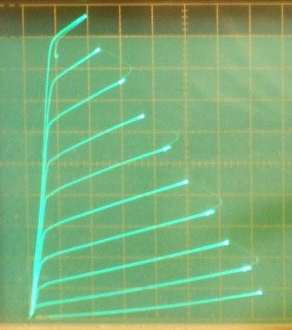

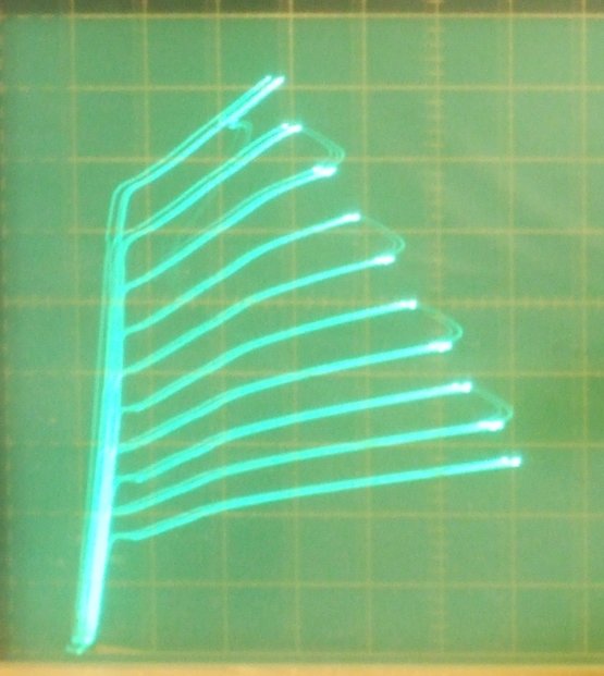

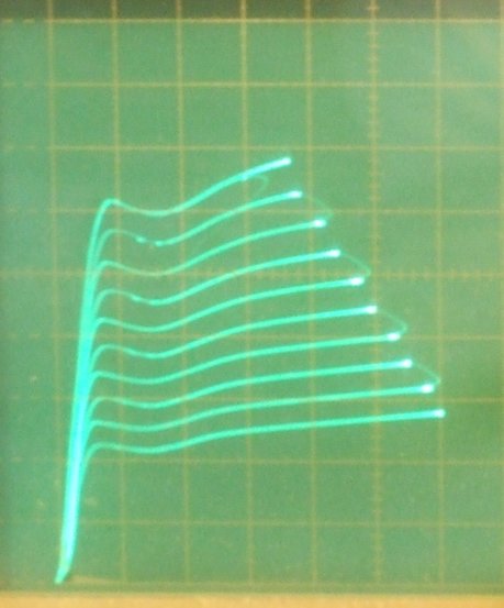

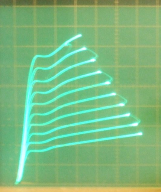

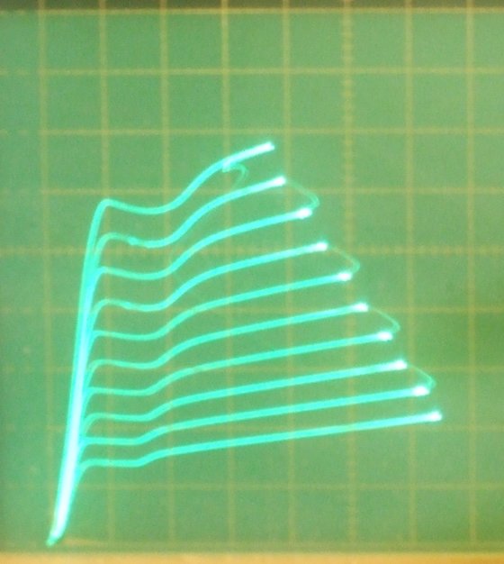

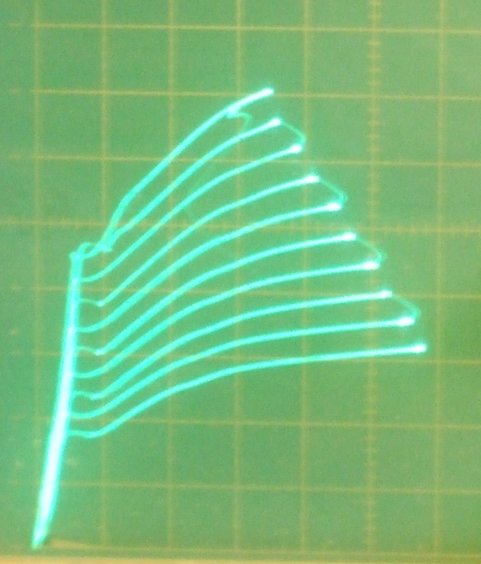

Here are some pics of g2 drive plate curves with the g1 set at 0V, -V, or +V (see below).
Scales are 50 mA/div Vert. and 50 V/div Horiz. about -7.5V steps on g2 with a positive DC bias added.
21HB5 0V on g1, +100V on g2 + steps
21HB5 -14V on g1, +200V on g2 + steps
21HB5 +8V on g1, +72V on g2 + steps
26LX6 (= 6KD6) 0V on g1, +70V on g2 + steps
26LX6 -13V on g1, +130V on g2 + steps
36MC6 (26LX6 clone by RCA) 0V on g1, +70V on g2 + steps
36MC6 -13V on g1, +130V on g2 + steps
36MC6 usual g1 stepped pentode curves

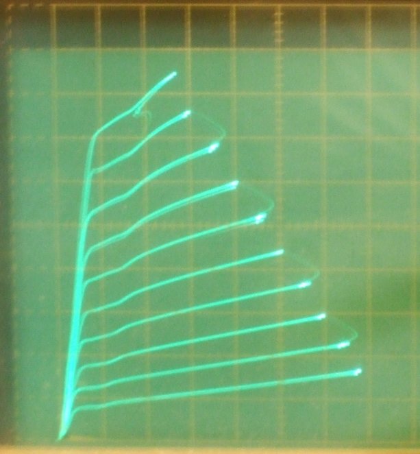

Notice (on the 21HB5 curves) that - g1 reduces the gm for grid 2 (and puts big kinks in the curves), and that + g1 increases the gm for grid2 (although not linearly). I assume this has something to do with aligned grid wires and focusing effects. (and some g1 current at low plate V with the + g1)
There is a 120 Ohm grid stopper on g2 for all the curves. Doesn't seem to have much effect when shorted out.

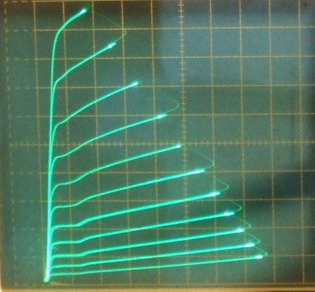

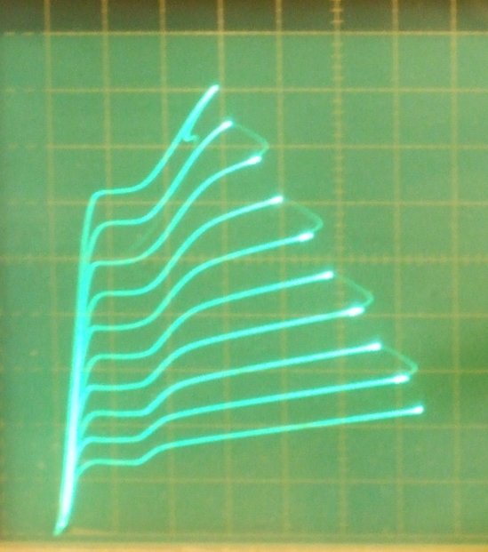

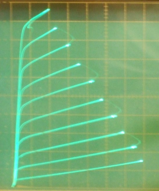

The screen drive curve set for that Danielak Screen Drive EL509 looks like a Spice model printout.

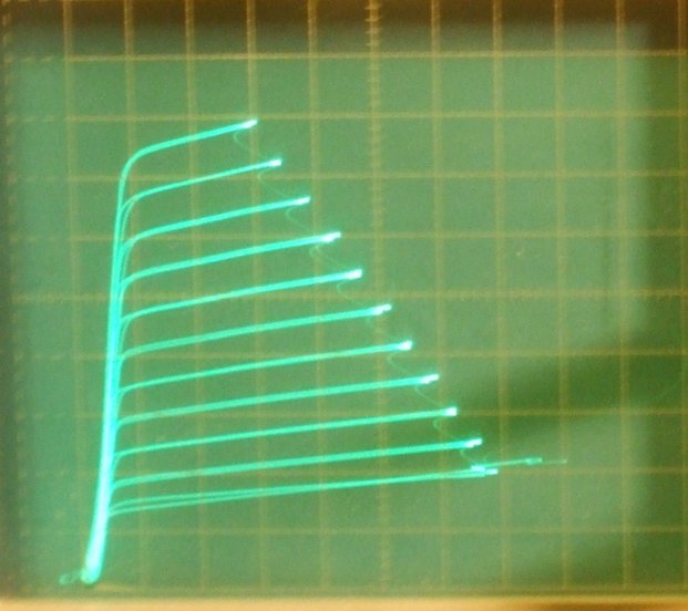

I went through and checked a bunch of Sweep tubes here using -15V on g1 as used in the Danielak design, and they all have horrible kinks in them that way. (well, 6HJ5 and 26LX6 have just flat spots) The -15V on g1 (and g2 driven) curves are shown below. (I don't have an EL509 to trace here.)
With 0V on g1, all these tubes have very nice clean beautiful g2 drive plate curves.
All are scaled 50 mA/div Vert., 50V/div Horiz. approx. 7.5 V steps on g2 with + DC bias shown in filename. (and -15V on g1)
36LW6 (RCA shown, but Sylvania was similar)
6LB6
6HJ5
35LR6
24JE6
21LG6
6CB5A
and for comparison:
a 6HJ5 with 0V on g1,
and 21HB5A with 0V on g1
One --might-- get away with a 6HJ5 or 26LX6 in that Danielak design, but anything else....pfffft.
(can not trust Spice models for g2 drive if Vg1 is not 0 ....)
