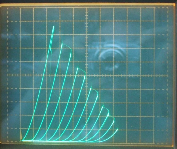

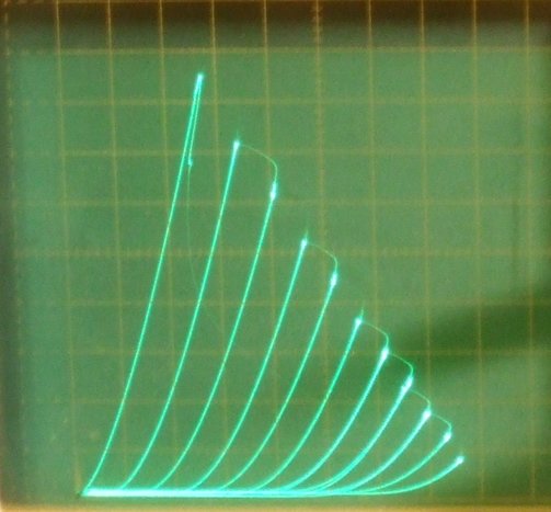

That's my suspicion as well, it would be great if someone can curve trace the 300B, plot out the gm curves, to see if they are even close to the one shown in the WE datasheet.So I am suspecting that the 300B data-sheet is not using the same tube for the gm graph on page 5 and the Ip graph on page3. Or else there is some significant error in the graphs.
Success! Finally
Using the 12GN7 GE datasheet, page4, bottom, I get n = 2.0 at -2.4 Vg1 (+175Vg2, +250 Vp)

That's great! Could you please do a quick recap? So an exponent of 2 at the desired operating point should have the best linearity, right?
Well, the n = 2.0 gives a linear ramping gm versus Vg1 in the local region. That bodes well for linearity in class A, P-P, where the opposing gm ramps of the two tubes add up to a constant gm. However, strictly speaking, one would want to do the test along an actual load line (as seen by a tube) rather than a vertical path. I have to try that yet, but it should work. I3 is always the higher Ip point, and I1 the lowest Ip point in any of the formulas. Points are equal Vg voltage steps apart.
Testing the "n" calculation along a vertical line was mainly to test the plate curves versus the gm curves on the datasheets, since that's what they (unfortunately rarely) give. It also gives one a standard method for an apples to apples comparison between different tubes, if one sets some criteria for what plate current level to test at. Since a typical load line is going to be passing through something like 1/4 to 1/3 max datasheet plate curves current, at half the max plate voltage shown, something like that is what I would choose for doing consistent comparisons of different tubes (for crudely ranking linearity).
For real performance analysis, one will then want the gm data analyzed along the actual load line, and then summed with the complementary tube (class A, P-P).
For SE applications, it's not real clear how useful this analysis is. One would like n = 1.0 for that case for constant gm. Nothing around like that, but I guess one could try for 1.5 at least. SE depends heavily on triode feedback to fix things up.

Try this one, it's not curve traced but made from the GE datasheet...sorry to butt in, but any of you guys did triode curves for 21HB5?
Here is the GE 21HB5A on the curve tracer. 7 V grid 1 steps, 50 mA/div Vertical, 50 V/div Horizontal.
Jazbo8, how do you make triode curves from the datasheet? Some kind of curve fitting program?
I used a three step process - first I added the Ia and Ig2 current from the datasheet together to make a crude triode characteristic chart, then I use it with a curve fitting program to make the SPICE model, which then can be used to re-generate the triode curves with the desired range and grid voltage spacing. It's not perfect, but the result in this case, matches up to your curves pretty well - close enough for rock & roll as they say.😀Jazbo8, how do you make triode curves from the datasheet? Some kind of curve fitting program?
