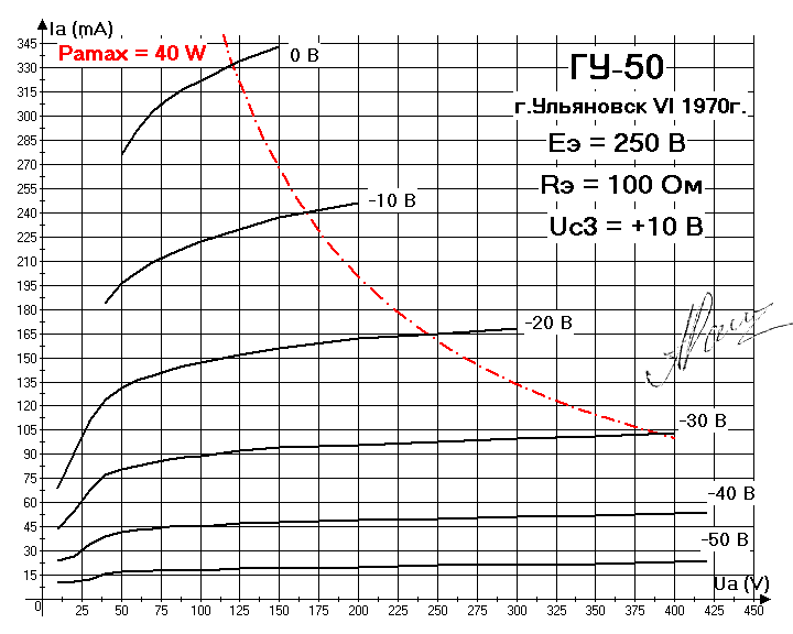

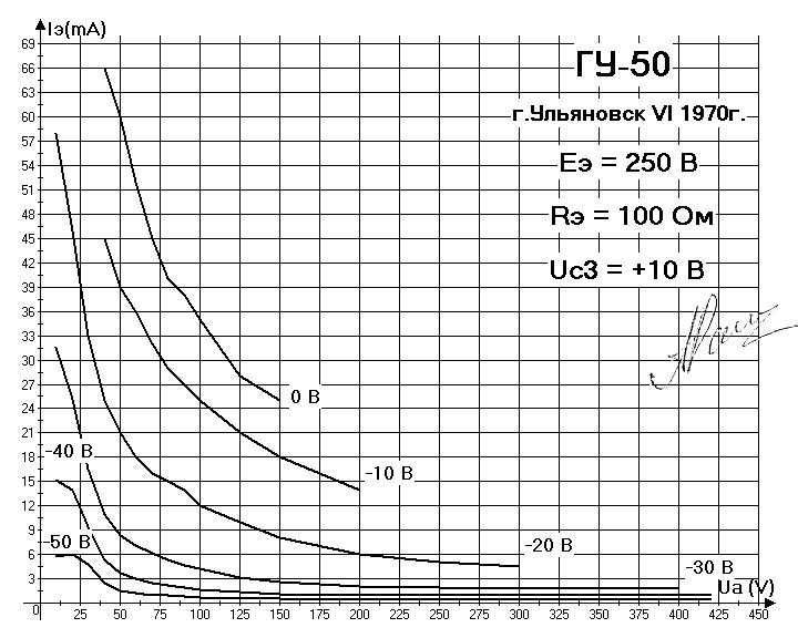

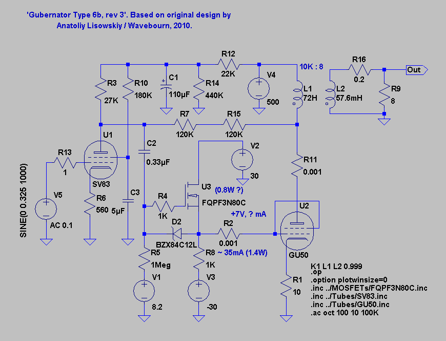

In one of your old posts from way back, you mentioned a right-handed triode GU-50 amplifier able to produce 200W, would you still have the schematic of such amplifier, or recall what the operating conditions might have been?
TIA,
jaz

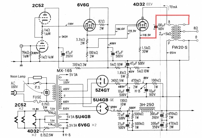

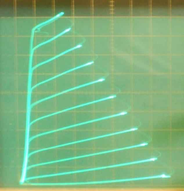

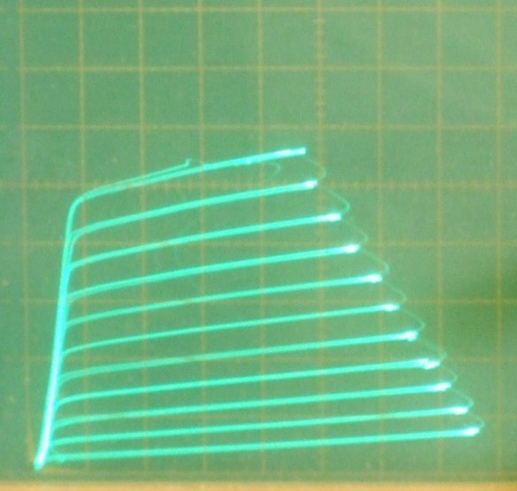

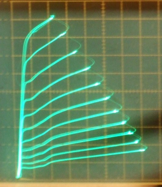

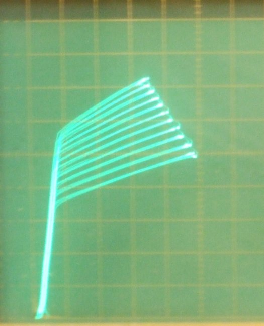

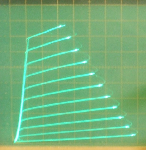

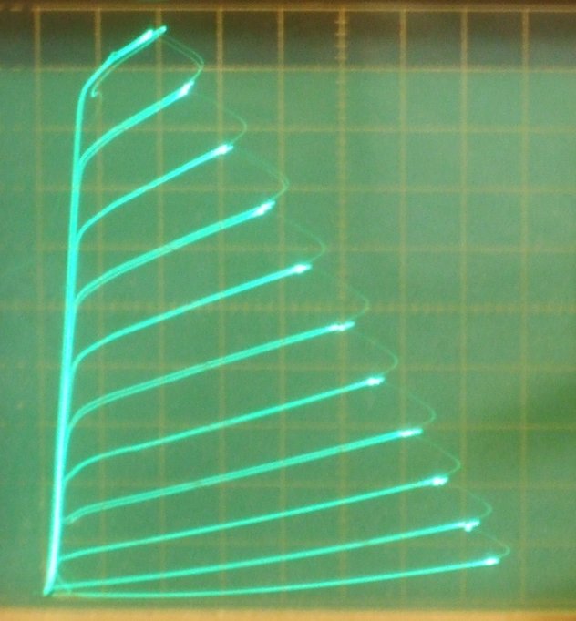

Here (attached below, the g2/g1 driven 4D32 ) is what got the present g2/g1 compensation scheme rolling. AJT posted this in the "Screen driven 6KD6 SE" thread, post 23. (possibly from MJ magazine) It's the only schematic I've seen so far that is doing everything correctly (g2 drive, g1 positive, R from g2 to g1, and R from g1 to cathode). (the CFB included there won't do much this way with a resistive drive to g1 however)

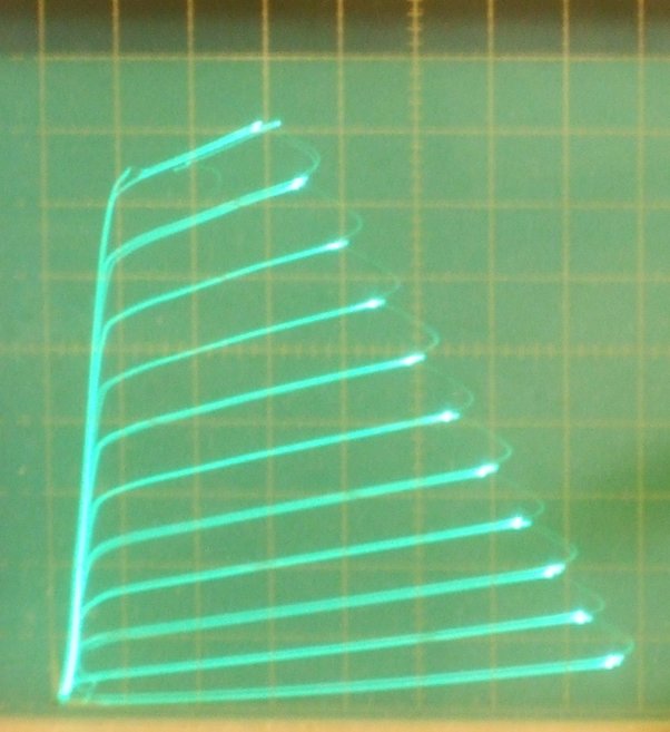

When I tried that setup on a 26LX6, this is what I got (2nd attached pic):
(and it only takes like 50V drive to get 1/2 an Amp out!!)
The 3rd attached pic shows the compensation effects of g1 (only) operating this way.

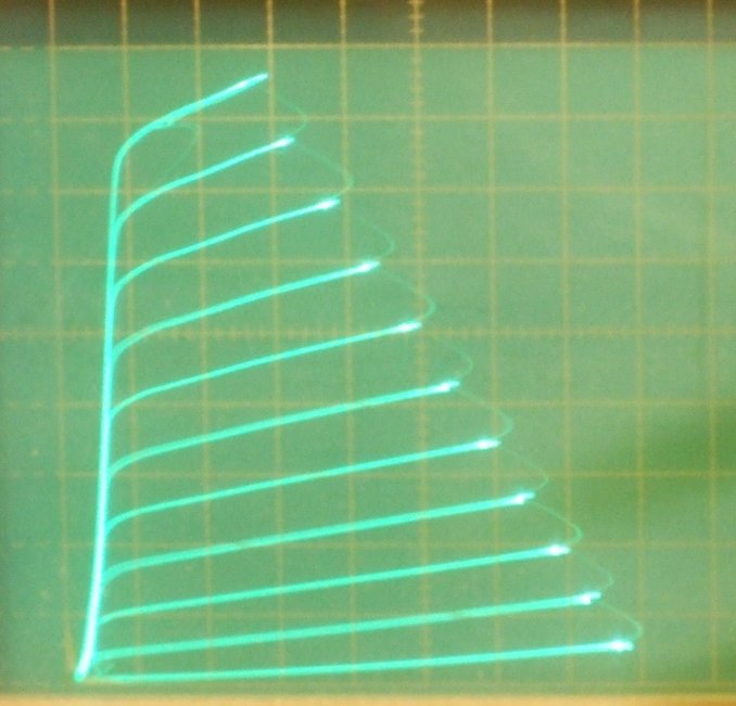

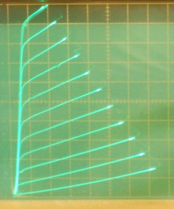

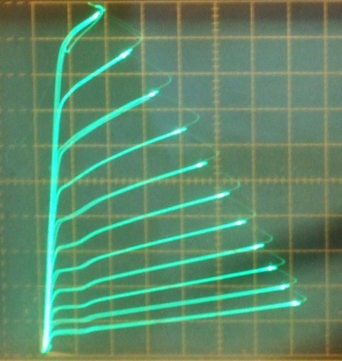

For comparison, 26LX6 in g1 drive, g2 drive and "Crazy Drive" with the drive voltage step sizes.
All 50 mA/div Vert., 50V/div Horiz.
1) g1 1V steps
2) g2 7V steps
3) "Crazy Drive" 5V steps
4) "Crazy Drive" 5.4V steps ( for better comparison with the g2 case)
Crazy Drive is as straight as an arrow. Only below about +1V drive does it start to noticeably compress.
1) g1 1V steps
2) g2 7V steps
TIA,
jaz
AFAIR, 1.2 kV on anode

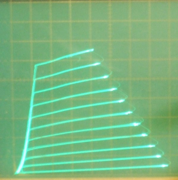

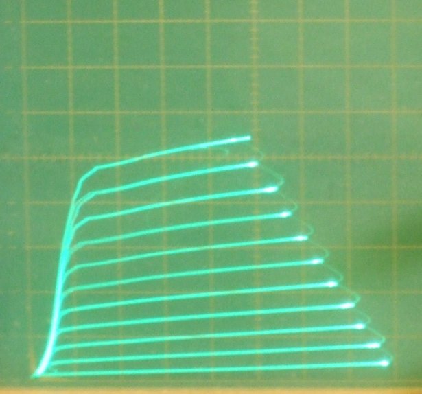

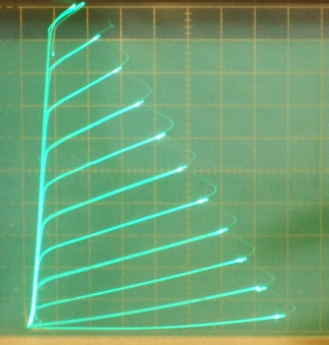

Here are some more "Crazy Drive" plate curves for more tubes.
All are 50 mA/div Vert., 50V/div Horiz. 7V steps on g2 (down from the max Vg2 listed)
1) 26DQ5 71V Vg2 max., Rg2g1 = 1.89K, Rg1k = 1.1K
2) 24JE6 72V Vg2 max., Rg2g1 = 3.7K, Rg1k = 1.46K
3) 17KV6 75V Vg2 max., Rg2g1 = 2.59K, Rg1k = 775
4) 12GT5 77V Vg2 max., Rg2g1 = 1.94K, Rg1k = 2.7K
5) 22JG6 73V Vg2 max., Rg2g1 = 1.35K, Rg1k = 915
6) 22LU8 76V Vg2 max., Rg2g1 = 1.3K, Rg1k = 574
7)17KV6 g2 drive, 80V VG2 max.
8)26DQ5 conventional g1 drive
