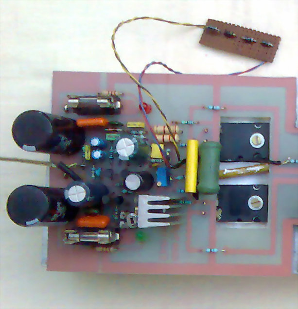

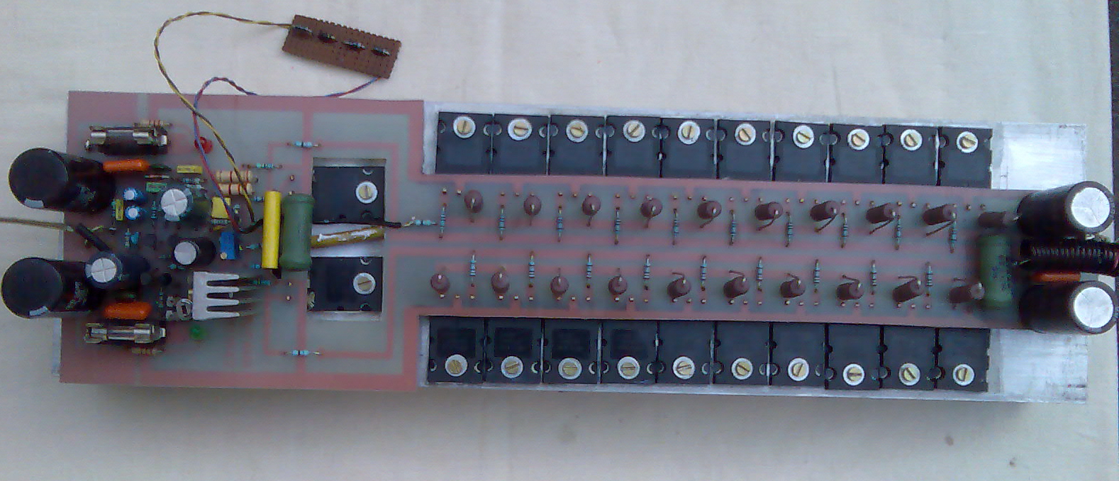

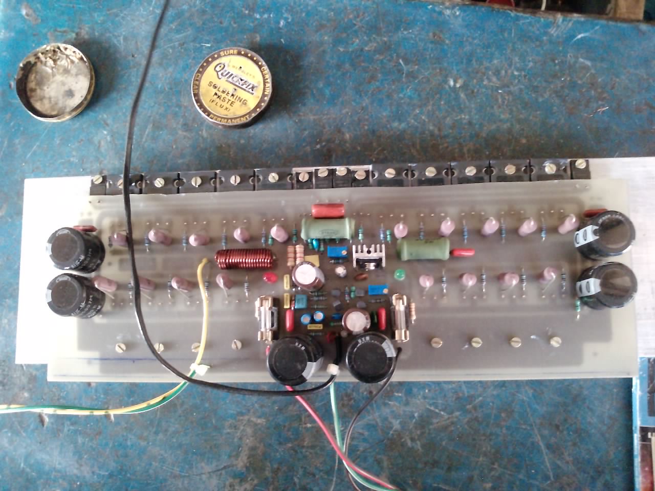

dear SIR
greetings i want to tell you dhr turbo was tested no oscillations very detailed
sound bass and highs very detailed 10 output pairs
1 transformer used 400 va 50 0 50 ac
2 speaker impedance 4 ohms

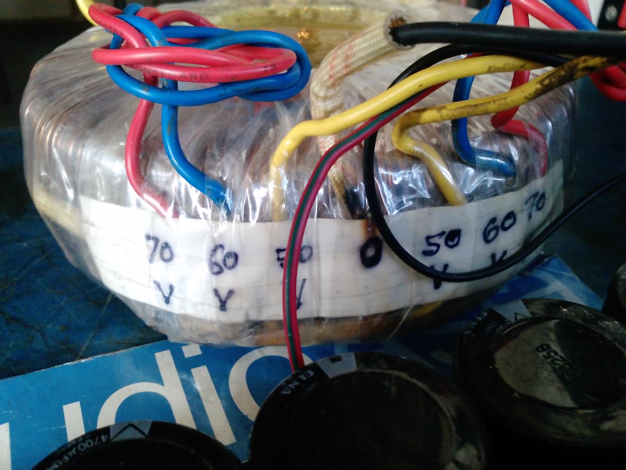

today i will be winding my torrodial transformer 1200 va tappings 50 0 50 60 0 60 70 0 70
condensers 50000 each on each rail

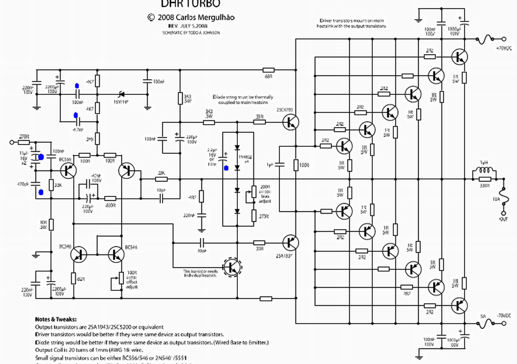

for heat compensation instead of 4 diodes in series can i use high speed diodes BYW 80
easier to mount or transistor 2sd381 or transistor 2n5294
CAN the supply voltage be pushed further say 60 0 60 ac with some modificatons
THANK YOU for providing diyers such a GOOD SCHEMATIC
thanking you
andrew lebon
pictures will be posted today
dhr turbo 10 pairs in output
pics of turbo

Yessssss...you can push it over the limits of voltage!
Have to check all transistors if they can work under your new voltage..also if they can dissipate the power (current multiplied by the voltage you have measuring colector to emitter... current is the one crosses colector to emitter)
Have to replace all electrolitic condensers by higher voltage ratio.
Have to include heatsinks into drivers, Vas and reinforce your output heatsink size and your transistor pairs may need (maybe) some more pairs... depending the speaker impedance and depending the supply power capacity.
A huge KILOWATT channel!
Have to increase the resistance that feeds the zener...install 5K6 or 6K8 in the place your schematic suggested value..... or increase your zener wattage capacity, install 5 watts zener and nothing to worry about...solder the one distant from the board...doing this you will not need to increase your zener series resistance (the one limits the current).
Prepare yourself to 1100 watts rms over 2 ohms loads..but you gonna need a 2 Kilowatt transformer to do that!....also you gonna need some pairs more to be safe... 10 pairs may hold the job..but i am not sure, as i have not tested such level of power here..i have not transformer able to provide me all that current......of course this depends the 84 volts simetrical stable (no drop)...and this never happens in real life....well...prepare yourself to a very huge power..able to melt speakers.
Thank you very much, the review and also the pictures..i am happy and dancing knowing you have aproved the amplifier and that you are feeling good.

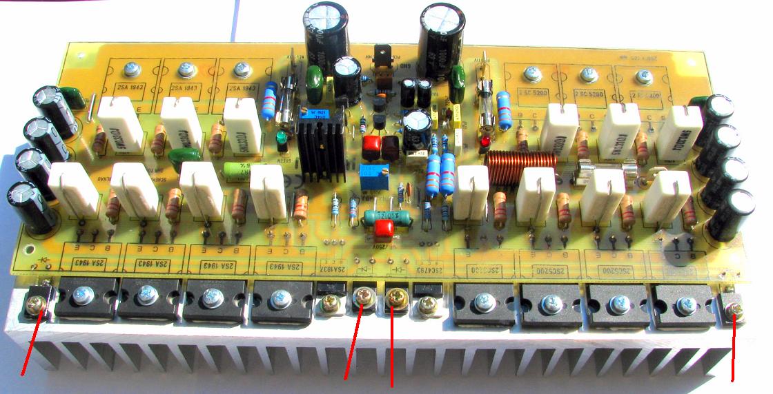

Thank you by the lovely pictures.
Remember ... the output power depends on the supply power...if your supply is no good, them the power will be small..install several transformers... use separated rectifiers and join the rectifier output (dc) into the filter bank of capacitors to obtain the power you want.
There's no big magic possible... into AB amplifier the power will be 55 to 65 percent power your transformer can supply.

Some friends are asking me part lists or bom to the DHR Turbo
We have no boom, the thread and the schematic provides the needed informations that will allow the one to build.
Electrolitic condenser voltages are the same or bigger than the rail voltage, exception is the bootstrapp condenser that use to be rail to rail voltage..into the schematic it is 220uf to 100 volts.
Capacitors are for 100 volts... the blue ones you will see into the schematic attached, can be reduced voltage ones... alike 12 volts or other small voltage.
Resistances are 1/4 watt or 1/2 watt (250mW or 500mW) units...the ones are bigger have received other watt ratings printed into the schematic.
Zener is 1 watt...and read the whole thread before assemble..better to take a look at Greg pages too.
Dx amplifier is a simple amplifier, with a well know topologie, proved and approved by several factories that have used along this last 40 years..there's nothing special on it, only nice warm sonics. low measured and audible distortions, and reliability.

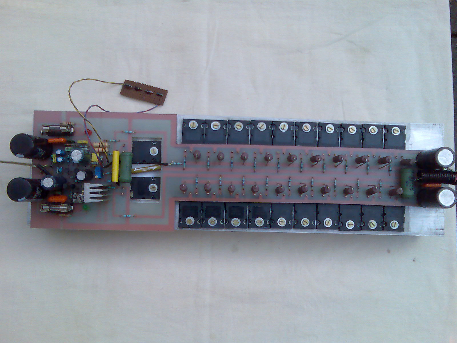

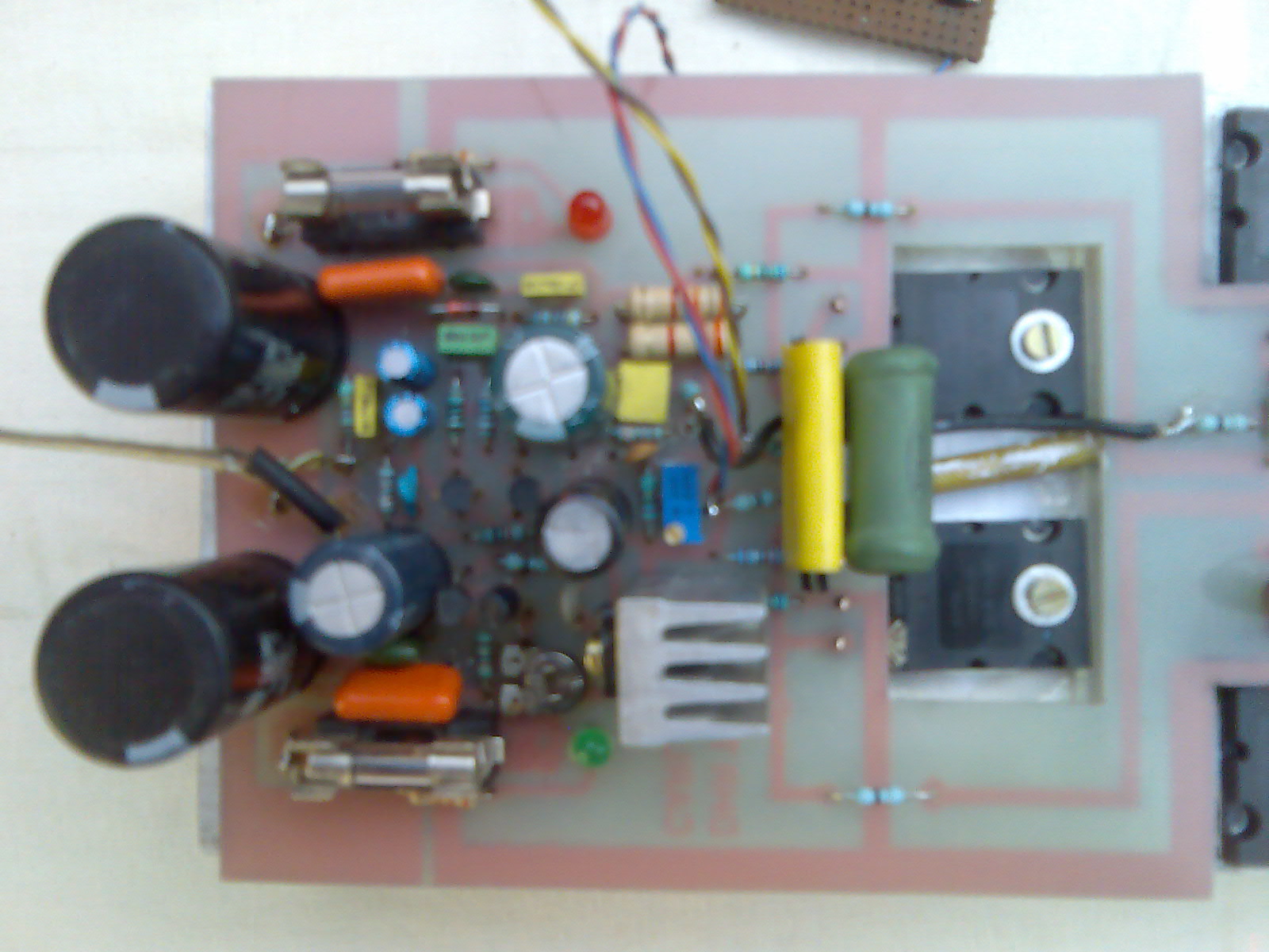

9 pair turbo
dear sir
greetings and wishes for a happy new year posting some pictures
of 9 pair turbo .Hand wound torridal transformer 50 60 70 o 50 60 70
tappings . condenser bank 60000 uf per rail
thanking you
andrew lebon

Thank you Andrewlebon, nice work
About the Dx Blame ES, i would suggest you to stop for a while, there are folks int he Brazilian Audiophile Orkut Communitty building, and several boards are beeing tried.
Wait a little bit, i have asked them to test boards for me and three friends already moving to do that... some days more i will publish results about.
The amplifier sounds beautifull, but it is strange, sometimes unstable, i have lost some transistors while building the prototype, finally i have ONE stable.
So, better to wait, or to continue under your own risk.
About sonics it is unbeatable, lovely amplifier, if not the best audio amplifier ever made, may be one of them...BUT....i am not entirelly confortable with the unit.
My dear friend Meanman
We have used transistors in the place of diodes to produce the needed voltage to bias the output... those are transistors connected as diodes, to sense the heat and control the stand by current....that will, as a consequence have some effects when the amplifier will be operating full power.
